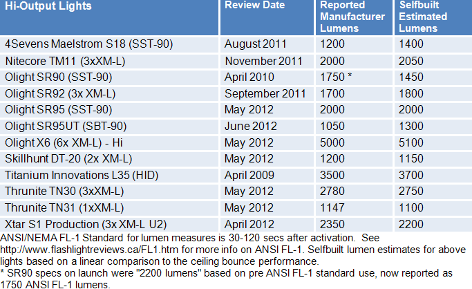

  27. #147
    Default Re: Olight SR90 Intimidator (Phlatlight SST-90) Review: BEAMSHOTS, RUNTIMES and more!
    Quote Originally Posted by Oztorchfreak View Post
    How can I you tell whether the model I have is "old" or a "new" version of the SR90?
    Short answer is that you can't - the lights look the same (externally)
    There has been a lot of discussion here on CPF of how variable the SR90 can be in overall output. I've tried to address this in my newer SR95 review, but it bears repeating in this thread as well.
    First off, here is a table showing how my estimate lumens stack up against manufacturer specs. You will note my SR90 (which was an early review sample) is something of an outlier:
    I believe this can be easily explained by the wide output range used for SST-90 emitter binning by Luminus. We are all used to Cree bins that typically only differ by a consistent ~7% over each bin range. In constrast, Luminus uses a variable bin range, sometimes exceeding a 20% difference within a given bin. That's a lot more variability, and means two lights with emitters from the same bin could be as much as 20% different in output. Moreover, the availability of a specific bin is never guaranteed by the light manufacturer - it is quite possible that they have had to use more than one defined output bin over the production run of the SR90. If so, that would translate into potentially up ~40% difference between samples.
    You will note that my SR95 is at least 40% brighter overall than my early model SR90. Given that runtime on a common battery is not all that different, that would suggest the output gain has come from use of a higher output bin and not by driving the emitter harder. Given the variability reported for SR90 output, I strongly suspect that two different output bins were used over time. You could thus expect anywhere between ~1-40% difference between any two SR90 samples. My SR90 is likely just a lower performing member of the lower (inital) output bin used.
    See the discussion thread from my SR95 review for more info.
    Full list of all my reviews: flashlightreviews.ca. Outdoor 100-yard Beamshots 2011. Latest: ArmyTek Barracuda.
