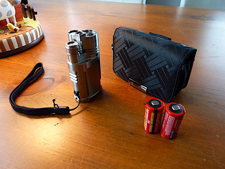

    Quote Originally Posted by derangboy View Post
    This is how I carry my Tri-V these days, although the light is alone in my left front pocket much of the time. I don't generally like things on my belt. These are still my preferred settings:
    P1 flood < 5mA - I just set to a level that was comfortable to light up in true darkness. It's hard to tell the emitter is even on in daylight!
    P2 flood 10mA - suitable for roaming around the house or walking to the barn
    P3 flood 800mA - I've backed this off from 1000mA because I was concerned about the heat. That little bit of Ti gets quite warm! Can't say I really notice a difference, still an impressive amount of warm floody light from a small unit.
    P4 reflector 100 mA - Takes a moment to adjust as it's like the fire went out! But as far as throw goes, it feels like a reasonable step.
    P5 reflector 600 mA - Again, I've backed the output off a bit for battery life and heat. Still very functional for running around outside in the dark.
    P6 Spot & Reflector 1200mA - I tried running the spot alone at 1800mA for a while, but I find I like the combo beam a little better. I find I'm looking at something in the distance and I can't, quite, make out what it is... "click" the angels sing and everything becomes clear!
    I like that all the settings are within 100% duty cycle. I'm sure I'll be back up to the program limits before long though
    Good luck to all patiently waiting for the next round!
