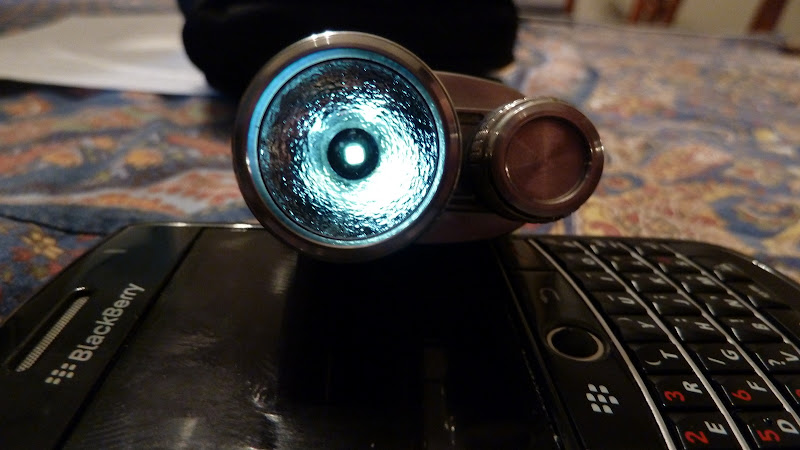

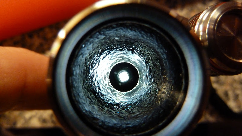

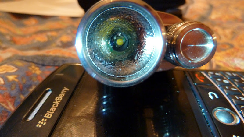

    I'll admit that I am still one of the noobs as related to Spy ownership. Right after I got my 007, I sent it to DaFabricata for a heart transplant - a neutral tint XPG emitter. You see, as much as I loved that smooth, 6 speed control - the beautifully milled titanium body - the great feel in my hand - the "survive a nuclear blast" construction - the existing brightness and tint were not what I'd hoped for. Having had a McGizmo Ti PD-S upgraded to an R5 XPG and being blown away by the results, it seemed logical to have the 007 upgraded to a warm/neutral XPG.
    Oh my goodness. It's perfect.
    Tim did an amazing job - he did Data proud! The emitter is perfectly centered - there's a new heat sink and he also included some protective heatproof tape over the solder connections. Nice, neat work...
    But the beam is absolutely fabulous. Beamshots will be added this weekend.
    I know, I know – the 007s aren’t about beamshots – no doubt, they are among the most, if not the most, technologically advanced lighting instruments out there, but the beam is so good that it needs to be seen. The shape of the beam and the tint are both perfect, and the ability to choose between 6 levels is sweet.
    So as a teaser, here are photos of the business end – one with just reflected light, and the other with the emitter on uber low. And there will be beamshots this weekend.
    Hat’s off to Data for making these lights friendly to upgrades, and HATS OFF to DaFab for his terrific upgrade work!!
    (Please excuse the dust!)
    Interesting that the beam looks somewhat blue in this photo. Make no mistake - it is a 'warm neutral.' It's perfect for my tastes!

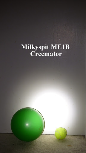

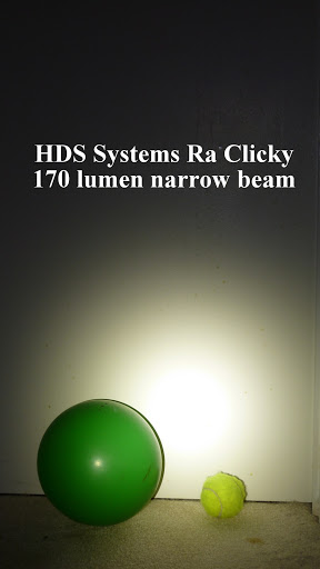

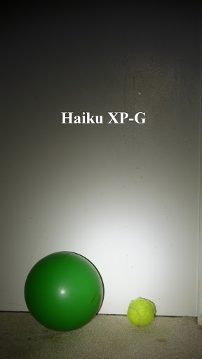

    For the dog walks at 4:30 AM...Haiku XPG, Ra Clicky 170 narrow or Milky ME1B Creemator - but I suspect that the Spy will take over that job!
    the others are collector's items - it doesn't seem fair to 'shelf queen' these terrific tools, but someday I'll enjoy passing them to my kids.

    I tell you what, folks. This light is amazing! Took it out for the dog walk this morning - carried a camera but alas, with 2 dogs on a leash and no tripod for the camera, getting outside shots in the dark was impossible. I'll work on that this weekend.
    Meanwhile, my impressions - the beam reminds me of a Haiku XPG - only considerably warmer and a bit brighter. I realize that the eye has difficulty recognizing differences of, say, an extra 30 lumen or so, but it does seem brighter regardless. Perhaps the warm Haiku XPG will look similar? The one beam shot of that light that has been posted would seem to confirm this.
    The 6 levels are great! Used level one 'in the night' as I moved around trying not to wake my wife. JUST enough light to see without being obtrusive. For the dog walk, level 3 was plenty - level 4 was almost perfect. Levels 5 and 6 gave a 'wall of light' that, again, reminds me of the Haiku XPG. Throw was terrific, but again, like the Haiku, the transition from spot to flood is almost totally smooth so the net effect is a 'wall' of light rather than a spot that is concentrated.
    I love it! I can see why so many enjoy this light. My only issue - it is heavy! But perhaps the 005, upgraded to this same emitter, might just be the ticket? Hmmm? At any rate, this one is a keeper, unless I fall prey to the siren song of the Tri-V.
    Over at this post I did some color comparisons this weekend - if you go there you can see the full range of lights. I added the upgraded Spy this morning and here are just a couple of the shots:
    this is the Spy, unlabeled
    Comparison collage - again, the Spy is unlabeled.

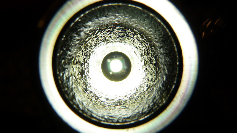

    I thought you all might enjoy this 'head shot'...
    DaFab is the man. I love this light more every day. And of course, Data is the man, too!!
    level 2
    Level 1
    Is that gorgeous, or what???

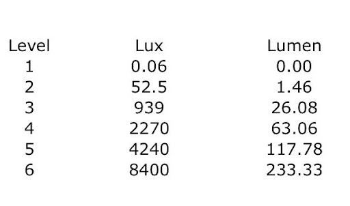

    Default Readings
    Quote Originally Posted by ninemm View Post
    Oh man. This thread makes me want an 007 even more. I love dials. Get a nice quad emitter Surefire U2 and one 007 and I'd be in dial your light to perfection heaven!

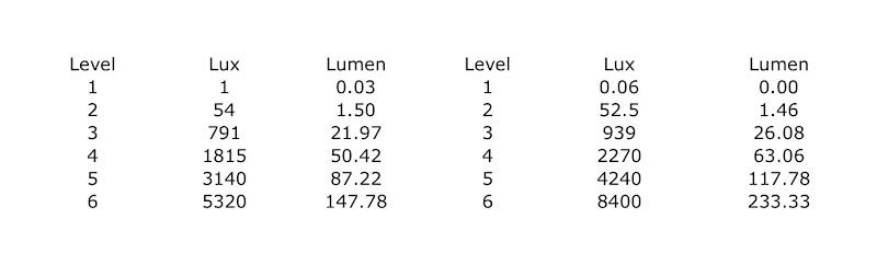

    Here - this will only make it worse!! I did readings in my sphere since the upgrade was done. I won't go through all the disclaimers about my home made IS - you can see all that by clicking the link in my sig line. But check this out...and my readings have proven to be within around 5% accurate or better.
    As you can see, the level one (programmed that way for me at my request by DaFab) is so low that it barely registers! Yet, in a dark house, it is perfect for moving around without disturbing anyone. Level 2 - as low as that seems, becomes a huge amount of light in a dark house. 3 and 4 are perfect for lighting the path that I walk on (dark)..5 will take care of lighting up virtually anything at a distance - 6 is a "flamethrower" that will freeze a critter in its tracks - or make sure that a speeding car sees me when I am walking near the road.
    This light continues to grow on me for the UTILITY that it offers. I still love my McGizmos - and always will - they have a bit more friendly 'form factor' for EDC, but for my 2 biggest uses, moving around the house and walking my dogs when it is dark, this darn thing is just great.
    Now, if I (we) can just be quick enough on the trigger when the next wave of Tri-Vs are available!!

    This upgrade is fabulous. Tim did a great job. 50% more lumens, improved throw, much brighter spill, lovely tint, nice beam pattern, and quick turnaround. What more could a flashaholic want? Thanks a bunch Tim.
    Surprisingly, while lumens are up by 50% at the top, they are up 100% in the mid-range and over 200% in the low range (unless Tim reprogrammed the light, which I doubt). If I'm interpreting this correctly, under normal use this would translate to longer runtimes at any given output; much longer in the low and middle range.
    +1
    Here's the way mine shakes out after the upgrade. I had programmed the low as low as I could (I thought) and the high "wide open". I lowered level 2 also. I asked Tim to program level 1 as low as it would go, try and duplicate my old setting for level 2, and have level high wide open - I think 3-5 are default. As you can see, the level 1 with the upgrade is ridiculously low!! I love it - just enough to see at night in a dark house. I find level 3 to be the most useful for my walks in the early morning with my dogs - but level 2 will light the sidewalk right in front of me. 4 doesn't get a lot of use, but 5 and 6 are the 'flamethrowers' that help me see in the distance, or ensure that the occasional car sees me!
    "Original", then after the upgrade
