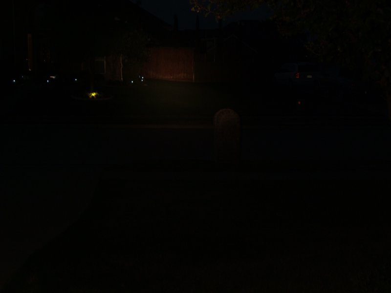

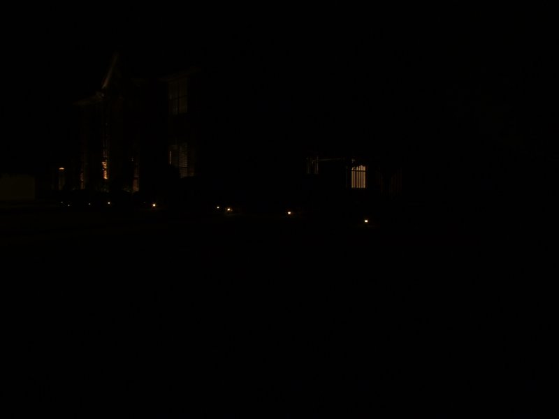

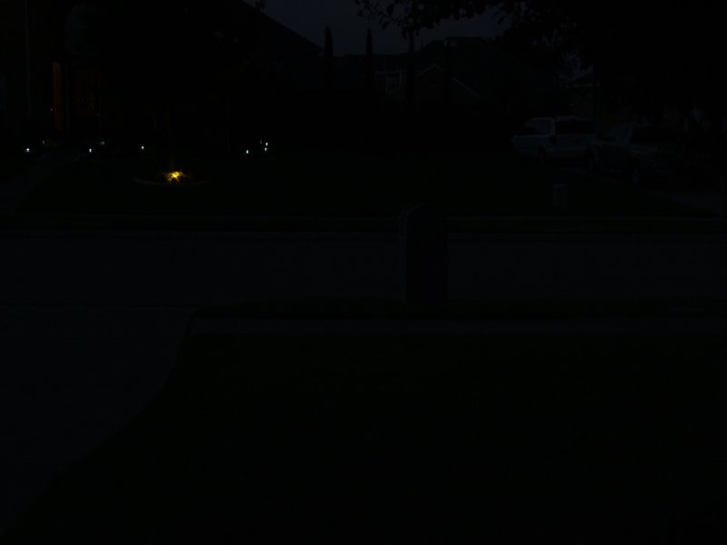

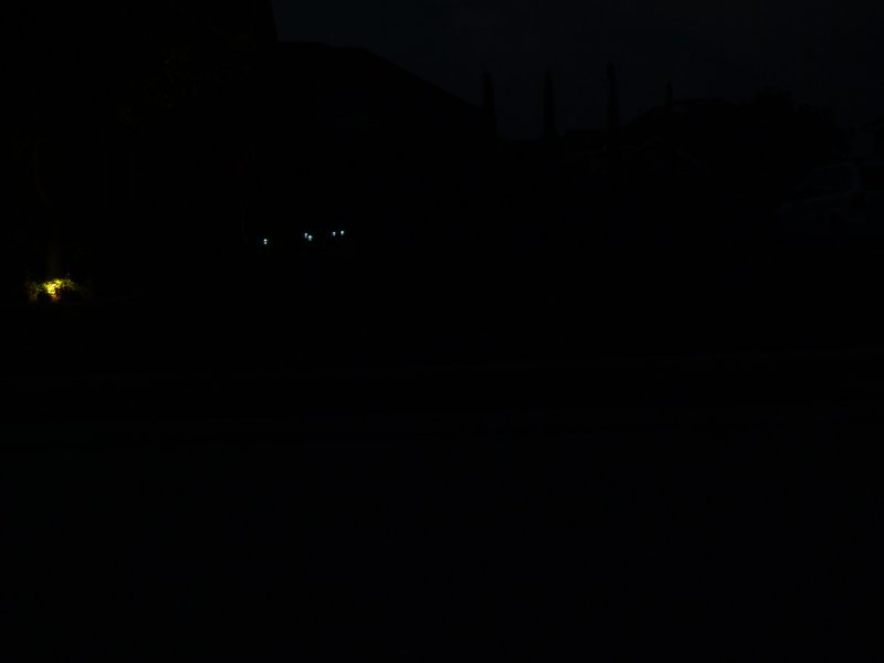

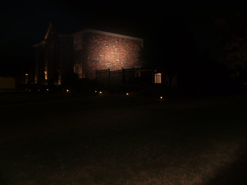

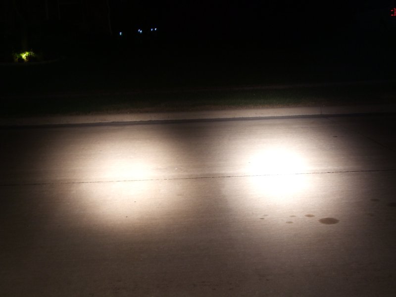

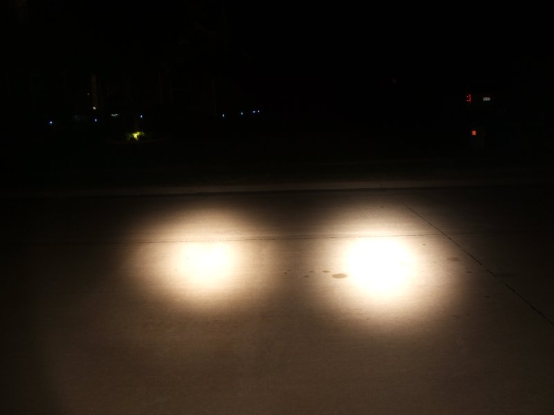

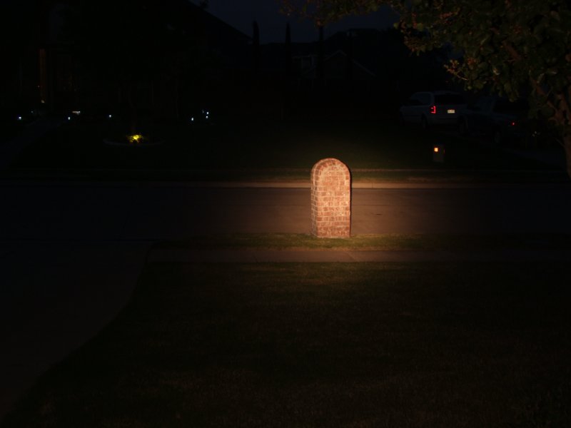

    OK, nothing shocking, but neat to do anyway. Camera on tripod, manual exposure (1/2 sec, F5.6), lens at 50mm.
    MN61 driven at 9.0 Vrms
    Control:
    MN20: Aim at mailbox and then at fence
    MN61: Aim at mailbox and then at fence
    MN21: Aim at mailbox and then at fence
    Control:
    MN61 (left) - MN20 (right)
    MN61 (left) - MN21 (right)
    Will

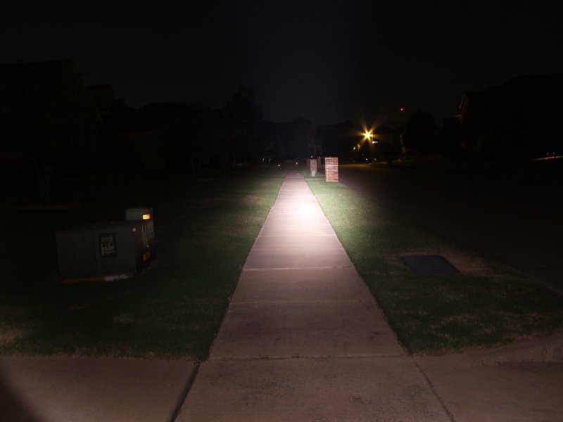

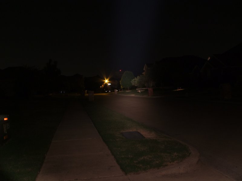

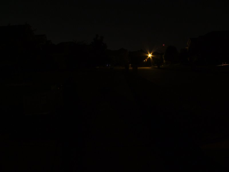

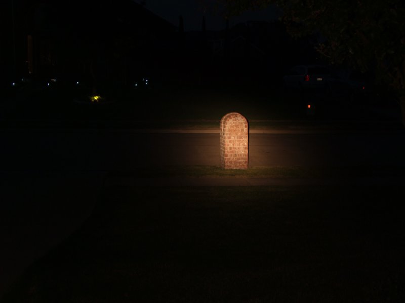

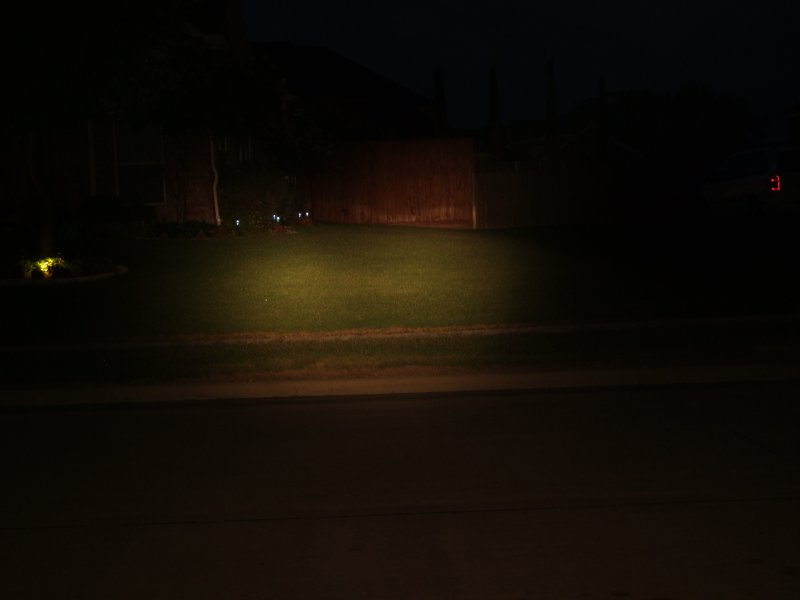

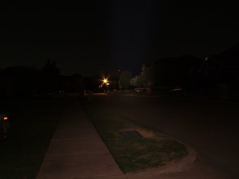

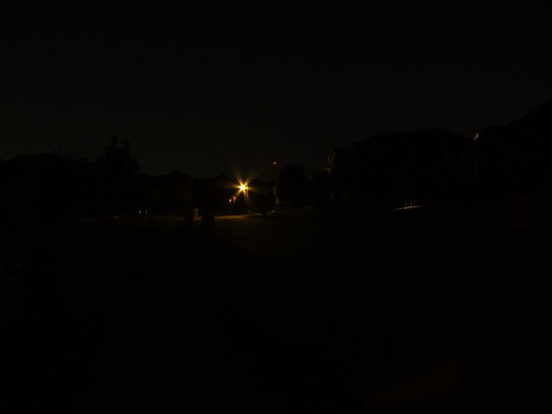

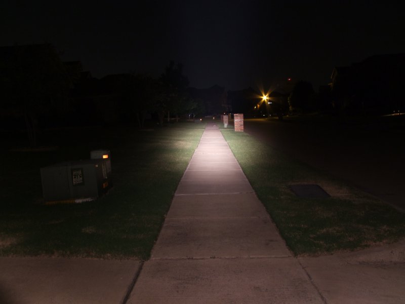

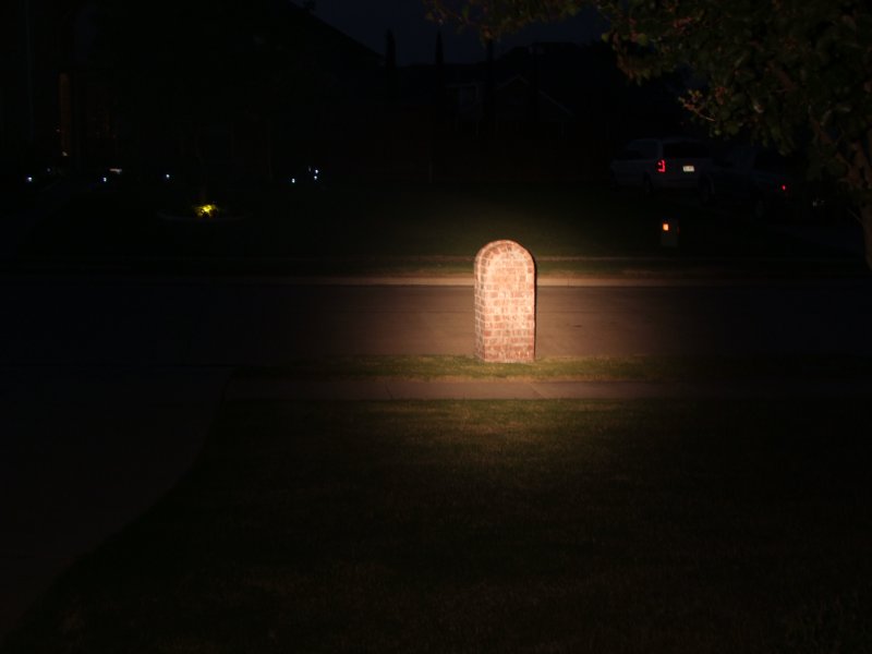

    OK, on that last photo the MN61 was a little bit more yellow than the MN21, so I decided to test the MN61 at 9.2 volts instead.
    MN61 driven at 9.2 Vrms
    Still different, but a little closer.
    Control:
    MN61:
    (wider beam)
    MN21:
    (more focused beam)
    Control:
    MN61:
    (wider beam)
    MN21:
    (more focused beam)
    Control:
    MN61:
    (wider beam)
    MN21:
    (more trow)
    Will

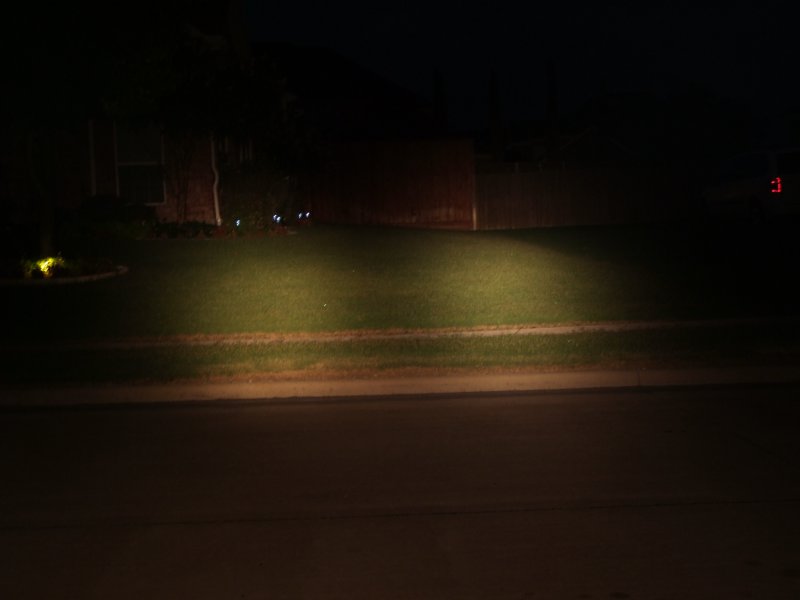

    Very fair question Lux. This is based upon the results of beamshot tests I did a while back with the M6. To be clear, I was referencing the throw of the HO-M6R per the prior statement. I'm not disagreeing that the MN21 puts out more overall lumens. Now, the "smokes" part came from testing the MN21 on fresh primaries (stock SureFire config) vs. the HO-M6R. However, it also beat the MN21 by a smaller margin even when run the MN21 was run on fully charged 18650s. Again, it beat it in overall throw, not total lumens. With a light of this form factor, throw is one of my major considerations in a lamp for the M6. And in that department, the HO-M6R wins (and maintains it's practicality at the same time ).
    Here are the shots from that test:

    Thanks so much for taking the time to put up the MN21 vs. MN61 beamshots Will! They were very helpful.
    I have just a couple of follow-up quetions:
    Since the MN61 will be the main purpose of my 9.0V level 3, based on your shots it looks like I should change this to 9.2V to get a nice white beam. Would this be your recommendation base on what you saw, or do you feel this would be pushing this bulb too close to the edge?
    Also, are the above beamshots with the MN21 used at the 6.8v setting? The reason I was wondering, is my shots of the MN21 with primaries should also be running at around 6.75v, and you can see how dim it is compared to the MN21 on 2x18650s. At this voltage it even looks much dimmer than the HO-M6R. I just wanted to make sure that 6.8v is still the optimal voltage for running the MN21 based on my and your beamshots.
    Eric - thanks much for your detailed explanation on the reasons this pack is less than optimal for the HO-M6R. I forgot that it was mentioned before about losing some voltage due to the additional contacts, etc. I think I'll keep the 10.8 setting for now, just to be able to run a higher voltage bulb in the future, or even the HO-M6R in a pinch. I'll still keep my DD pack for this bulb when I want to run it.
    Thanks again for the lighting fast answers and all the great information you all are providing in this thread!!
  30. #90
    Jan 2005
    Texas, USA, Earth
    8,180
    Default Re: Feedback/impressions on the PhD-M6 custom battery pack
    Quote Originally Posted by RichS View Post
    Yes, the MN61 at 9.2 volts was awesome. I would not push it harder. In fact, back when had two of the ill-fated HDM6's, I keep one of my M6's with an MN21 and one with the MN20. Now with my own pack, and given the 3x17670 source, I am keeping one of them with the MN20 (at 7.5 volts), and for sure going to keep the other one of my M6's with the MN61 bulb at 9.2 volts.
    Yes, absolutely. 6.8 Vrms (regulated )
    Way too many things different between your setup and mine. Even changing the manual exposure would make things brighter or dimmer - too many variables make it impossible to directly compare my beamshots to anyone else's. That being said, yes, 6.8Vrms on the PhD-M6 "is" the optimal and correct drive level for the MN21. Driving the MN21 harder will only give you even shorter cell life, more heat wasted in the cells, shorter runtimes, and a shorter life for the bulb.
