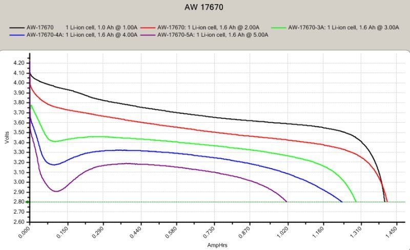

    I just finished running AW 17670 discharge graphs at 1, 2, 3, 4, 5 Amps with the cells I have, and as a result will be making another change to my custom profile Level 4, giving up on the 10.8V category. I should have thought about this aspect earlier.
    I took the time to go back through my PayPal transactions to see that I bought my only six 17670 AW protected cells way back in May, 2007, so people need to consider the age of these cells with my posted results, as newer ones may perform better. I sent a PM to AW to look at these results, and comment.
    In any case, I'm not seeing these size cells as having the 'cajones' to power the 1185, nor does AW list it as such here.
    Edit: I'm dropping my 10.8V setting because if we divide that by 3, we get 3.6V per cell. So the question is whether a specific bulb being driven at its necessary Amp level will have the cell voltage held above 3.6V for a reasonable amount of time. The 1185 draws 3.4A itself (not including additional drain from pack resistance), and you can see the green line above is all below 3.6V...so this would make it out of regulation==>going to direct drive.
    Even the 1331 @ 10.8V uses 2.1A for the bulb alone. You can see how quickly the 2A red line crosses the 3.6V threshold.
    Now looking at the 1164 @ 9.3V uses 4.2Amps, but now we have a lower voltage threshold (9.3V/3 = 3.1V/cell) before it drops below regulation. It crosses the 3.1V line just short of 1Ah which is better than nothing.
    Suffice it to say that I'm going back to the drawing board. I don't know how much "beefier" the newest AW 17670-P cells are, but I would rather err on the conservative side.
    Wow you're right, it can't sustain very much voltage when draw is over 2-3 amps. The good news is, the king of throw among the M6 bulbs in my experience (outside the 1185) is the HO-M6R at only 2.1amps. It smokes the MN21 and even beats the WA1111 by a small margin. There's no way I would give up my 10.8v setting and the ability to run this bulb with this pack, even if it will drop out of regulation quickly. The low amp draw, low heat, excellent reach, beautiful beam pattern and long bulb life are just too good not to have a setting for. The IMR-M6 is another reason to keep the 10.8v setting IMO.
  17. #77
    Default Re: Feedback/impressions on the PhD-M6 custom battery pack
    Quote Originally Posted by LuxLuthor View Post
    It looks like ~2A draw (1.25C) from the AW17670s is a reasonable max in terms of holding cell voltage under load. What this might translate to for PWM...?
    A WA01331 might be able to run in regulation at 10.8V for say 10 min before going direct drive for the remainder of the battery pack's capacity.
    My two workhorse bulb candidates are the MN15 and WA01274, for lower output/longer run time and higher output/moderate run time options, respectively. If I didn't have an FM MN bi-pin adapter and a bunch of 1274s already, I might go with an MN15 and MN61.
    I'm taking a slight chance with my Level 3 at 8.0V for the 1274. But I can always run the bulb at Level 2 at 7.3V. At $5 per bulb, the 1274 looks like a good all-around choice to me.

    Quote Originally Posted by RichS View Post
    Rich, I don't have much objective data with the MN & Lighthound bulbs, but I'm confused by your saying the HO-M6R "smokes the MN21," when I see Eric's chart listing it as only 400L diminishing to 250L, vs. his report of the MN21 being 500-700L. I'm also not clear on how he got his lumen readings, and whether they are "bulb lumens," or extrapolated "Torch lumens" (using the 65% x Bulb Lumen formula that I have never accepted).
    Too many questions....and miles to go before I sleep. Miles to go before I sleep.
    Edit: Now I see where you are getting that from. When I look at my box of the HO-M6R, it's spec is 700L @ 13V. Ain't gonna get up there with these cells.
    As you may have noticed, I've been pointing out since doing testing that the 10.8V setting just isn't going to provide much if any regulation for most bulbs. It's hard to articulate why, but I'll go ahead and throw out some numbers for folks to consider:
    Fresh charged pack: 12.6V
    Resistance to bulb: ~0.5Ohm (Batteries+contacts, assuming ideal conditions with clean contacts and all)
    Maximum duty cycle we can run for proper voltage measurements and maintaining calibration in all modes: ~98%.
    Bulb resistance (1185): ~3.2 Ohm
    0.5 Ohm / 3.7 Ohm x 98% duty cycle = ~13.25% voltage drop
    That's equates to 10.9V to an 1185 with AW17670s in good condition and good clean contacts. It only takes a few seconds to drop out of regulation.
    This calculation assumes that the electrolytic reaction keeps up 100% with the rate demanded. There are losses there that are very hard to quantify being heavily dependent on temperature.
    I've noticed a difference in runtime just by going from cells purchased about 1-1.5 year ago to cells that just arrived a few days ago. Cell age and condition are critical factors way outside our control.
    Yes, after taking the 2% loss from the maximum duty cycle we can run, and added resistance from contacts and such, even the 1331 and HO-M6R will not run in regulation. If they do, it isn't for long.
    The newer the better. I'm actually surprised to see that you got ~1.4AH from ~3 year old cells. Brand new cells are pretty close to 1.6AH. The actual stored energy is even more, but it's not usable energy unless they are drained infinitely slow. The way in which cells are used or stored over the years can have quite the impact. My ~1 year old cells probably wouldn't perform much better than your test results.

    Quote Originally Posted by Justin Case
