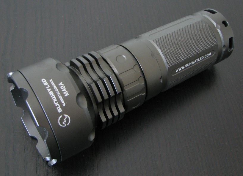

    The M40A is part of a new series of lights launched by SUNWAYLED. This is the first shipping sample I have reviewed – I have previously reviewed engineering samples of the M10R, M20C and M40C. The M40A is a high-output MC-E light that runs on common AA batteries.

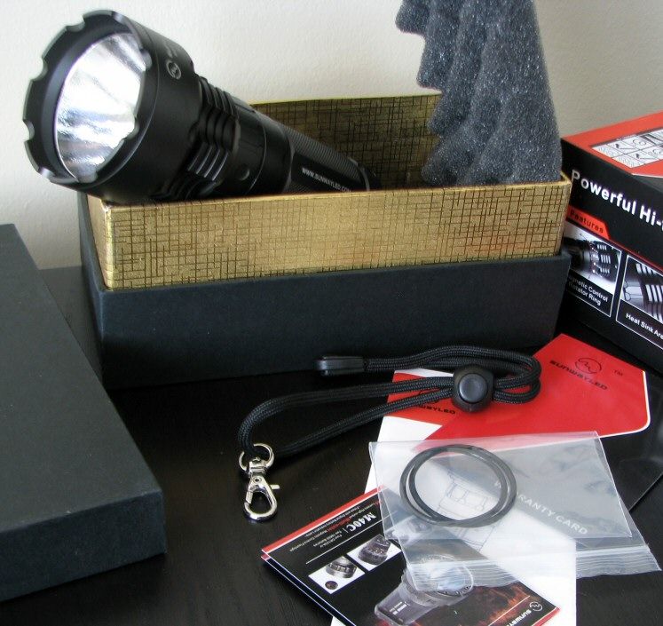

    The light comes in a solid cardboard box with cushioned packing foam. Included inside the package were the light, wrist strap/lanyard, manual, warranty card, promotional insert, and extra o-rings. Note that no holster is included.

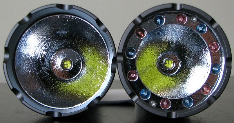

    As you can see, the light bears something of a resemblance to the 2x18650 M40C reviewed previously. I will point out key differences as we go along …

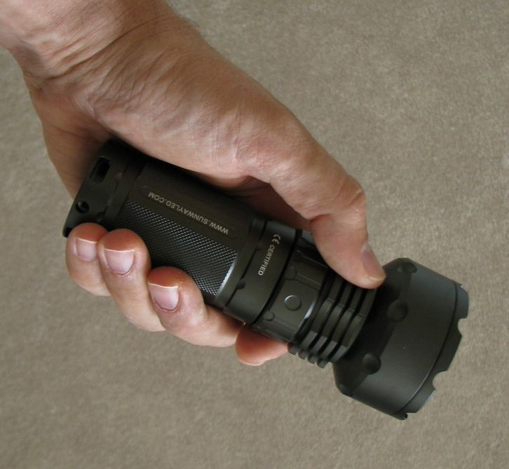

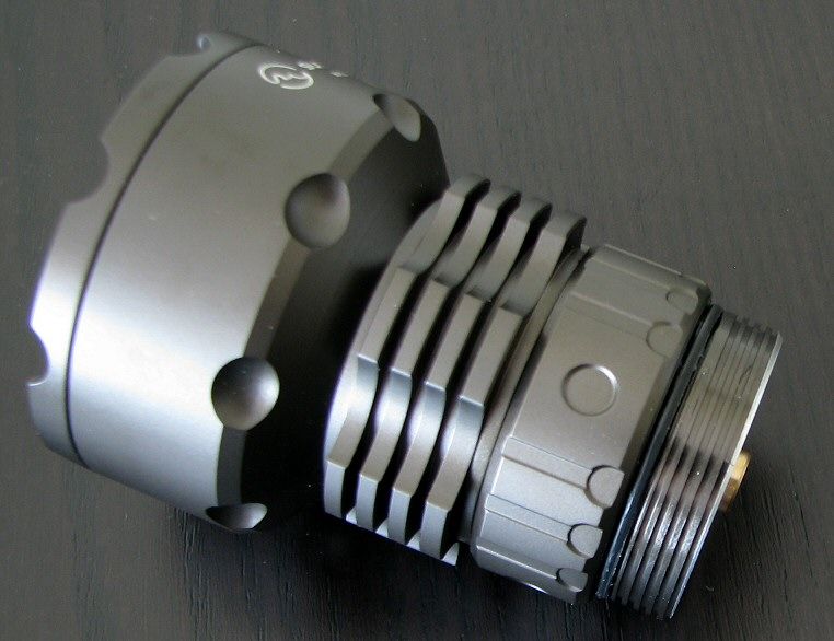

    First of these is the styling – note the location of heatsink fins has moved, and the M40A features traditional knurling around the body/battery tube/handle. Knurling is reasonably aggressive compared to most made-in-China lights.
    One comment about the anodizing – while I would consider my M40A sample to be excellent overall, but there is some mottling of the head of the light near the bezel, and a few fine concentric rings around the base of the head near the heatsink fins. While these are minor cosmetic blemishes, the earlier M40C/M20C/M10R I reviewed were all outstanding in comparison (i.e. flawless). The color has also changed slightly to more gunmetal gray appearance on my M40A sample.
    The control ring is similar to the M40C, but with more pronounced detents at every level. As before, there are no identifying labels on the control ring. One small note – there is a bit of small gap between the control ring and the area containing the heatsink fins. And it looks like one of the control ring magnets is visible at the top of the ring (near the heatsink fins). Not necessarily a problem per se, but not something that was visible not on the M40C.
    The M40A lacks the low-battery LED warning indicator present on the M40C.
    Something that hasn’t changed – high quality machinist square-cut screw threads, anodized for head lock-out.

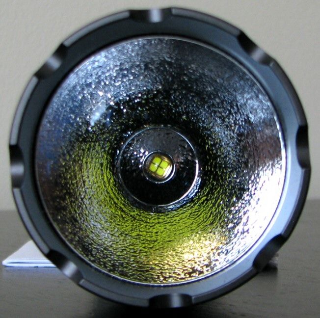

    The light comes equipped with a MC-E emitter inside a fairly deep reflector. Shown above is a comparison to the M40C – although hard to tell in the pics, the M40A reflector is both wider and deeper than the main M40C reflector. The overall front opening width is similar on the two lights, but the M40A doesn’t have the ring of colored 5mm emitters.

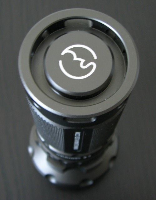

    Here’s another significant change – no clicky switch. On/off and mode switching is now controlled entirely by the control ring in the head. The M40A can tailstand.

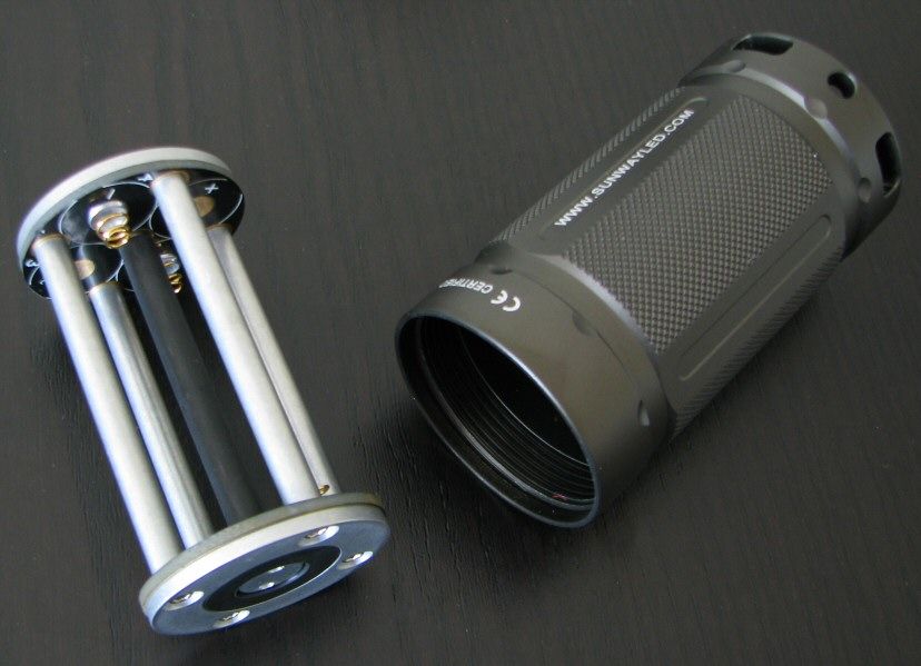

    This is where the light gets interesting – note the high quality 4xAA carrier. Unlike a number of competitors, the carrier is all metal. It is also reversible - you can insert it either orientation into the light handle. So as long as you put the batteries in correctly (well labeled inside the carrier), there’s no chance of accidentally reversing polarity. This is a creative design, and something I hope other makers pick-up.

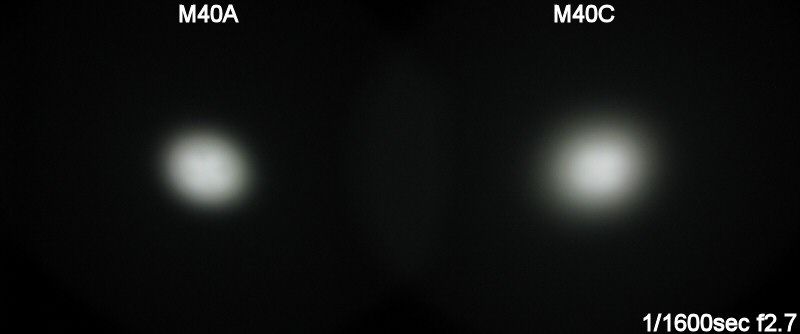

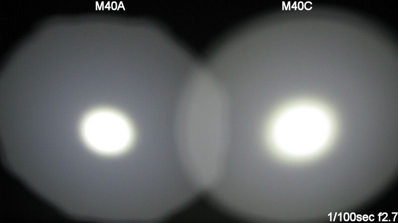

    Beamshots

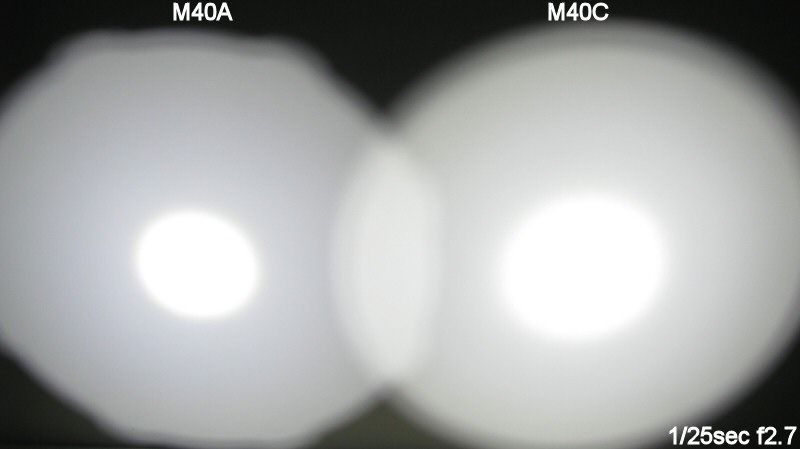

    I’ve recently moved, and haven’t had a chance to set up a proper beamshot closet yet, but here’s a quick comparison to the M40C, about ~1 meter from a white ceiling (both lights on Hi).
    The deeper-cut bezel ring introduces the slight peripheral edging effect you see above, but this is not noticeable at regular distances. Overall spillbeam widths are similar, but the M40A has a more focused hotspot than the M40C (consistent with the deeper reflector).

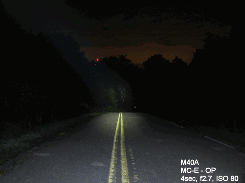

    UPDATE SEPT 19, 2010: I've added some additional lights to my 100-Yard Outdoor Beamshot Round-up, including the M40A. Check out that round-up thread for more details. Here is an animated GIFs of the relevant comparison to the M40C:
    Scroll down for some throw and output numbers.

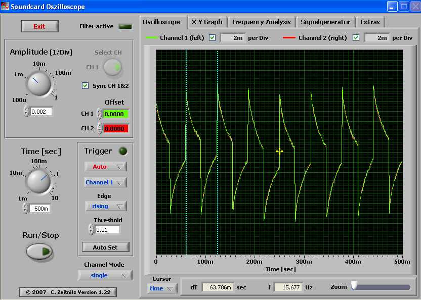

    Strobe
    Strobe was measured at a “tactical” (and nauseating ) 15.7 Hz.

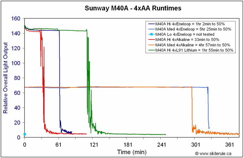

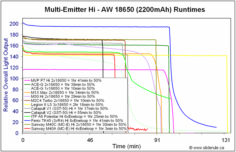

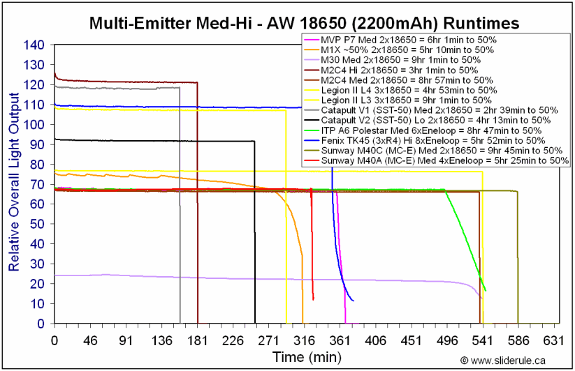

    Output/Runtime Comparison
    Although the outputs and runtimes are a bit less, the overall pattern of the M40A is remarkably similar to the 2x18650 M40C. Both lights have excellent flat regulation on Med and Hi (Lo not tested, but I expect the same there).
    Despite the differing battery sources, both lights go into a continuous flashing/strobing mode once the batteries fall out of regulation. On the M40C, you get some advance warning from the LED warning light. On the M40A, you instead get a few warning flashes of the main emitter a couple of minutes before dropping out of regulation. These flashes rapidly increase in frequency until they become continuous strobing as the output drops.
    Like the M40C, you can switch to a lower output mode to temporarily restore constant light. But typically, there isn’t much battery life left at this point, and the low-battery flashing will begin again soon.
    UPDATE: Just added the L91 lithium (Energizer e2) runtime on Hi. An impressive run - nearly 2 hours, well regulated.

    The closest comparables are really the other AA-powered lights: the ITP A6 and the Fenix TK45.
    On Hi, the M40A does remarkably well in one sense – comparable in output to the ITP A6, the M40A manages to squeeze almost as much regulated runtime on 4xAA Eneloops as the A6 does on 6xAA. Of course, the difference is what happens after the lights fall out of regulation – the A6 has a slowly decreasing output that continues for quite some time, while the M40A drops quickly into low-output strobing. And as expected, the much larger 8xAA Fenix TK45 remains the output and runtime champ on Hi.
    On Medium, you can see the effects of the lower number of batteries on the M40A. Although impressively regulated, it can’t match the runtime of the 6xAA ITP A6 or the 8xAA Fenix TK45. Still, this performance is impressive from just 4xAA cells.
    Like the M40C, there is no slow drop-off in output once the batteries fall out of regulation – the main light starts flashing with increasing frequency over a couple of minutes, and then drops to low output strobing.

    I’m particularly impressed with their 4xAA battery carrier – solid metal construction, clear labels, and reversible polarity (i.e. fits in either way). This is the best AA carrier I’ve seen so far. Probably the only thing extra I would have liked to see is a clicky switch option like the M40C.
    The beam is similar to the M40C (i.e. nice wide spillbeam), but with a more defined hostpot with greater throw. The centre-beam “donut” effect is of course present on all MC-E lights, but it is less noticeable on the M40A than most lights I’ve tested in this class. Definitely a good job on the reflector as well.

    Quote Originally Posted by driven View Post
    For rechargeable Lithium, the 3.7 voltage would fry the light, correct?
    For primary lithium I think the voltage is fine and within range, and I would have a lighter weight light, but what would the general effect be on run time and output?
    Correct, 3.7V Li-ion would fry the circuit. But L91 lithium (i.e. Energizer e2 lithium) should be fine. In fact, Sunway's specs specifically allow these.
    Runtime should be a lot longer on L91 than alkaline, with similar output. I would have tested these before, but my supply is running low and they are rather expensive.
    Ah, what the heck. I've just started a run on L91 on Hi .... I'll post the results later this evening.
    Full list of all my reviews: flashlightreviews.ca. Latest hobby: whiskyanalysis.com. New: Selfbuilt's Summer Sale!

    Default Re: SUNWAYLED M40A Review (MC-E 4xAA): RUNTIMES, BEAMSHOTS, and more!
    Jus updated the main review with the Hi mode L91 run:
    Very nice regulation and runtime on primary lithium - basically 4x longer than alkaline, or 2x longer than Eneloops (on Hi).
    And no, I don't plan to do the Med mode ... out of batteries.
    Did you ever see that the light wink on when metal or magnet is very near it? And I heard other flahlight show the pre-flash with the max. brightness when turning the magnetic control ring to turn on the light. How about M40A?
    Hmmm, haven't noticed it any other time. It only seems to occur in standby mode when first making contact with the battery carrier (and not every time either). On the Jetbeam RRT-2 you could see it every mode when pressing the switch - the circuit here seems to be different.
    Thank you very much for running the test with the primary lithium. I'll try to help out with a battery fund donation next week.
    I think for some applications, having two hour run time in a light this size will be a great selling point for the flashlight. The weight issue will change the load of the light as well, particularly if you are carrying spare batteries with you in your pack.
    I think I am going to really like this light.

    Thanks for the review and Output/Runtime Comparisons,
    Nearly 2 hours stable output at high with lithiums and nearly 5 hours at mid with alkalines makes this light very interesting.
