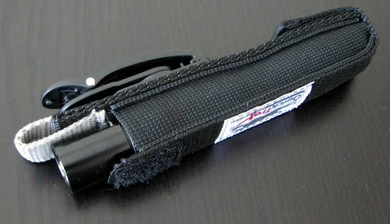

    QuickTreX has sent me their new general-purpose flashlight holster to evaluate. As you can see from the dimensions, it is most ideally suited for the standard 2xAA flashlight form factor. In fact, here it is with a Fenix L2D installed:

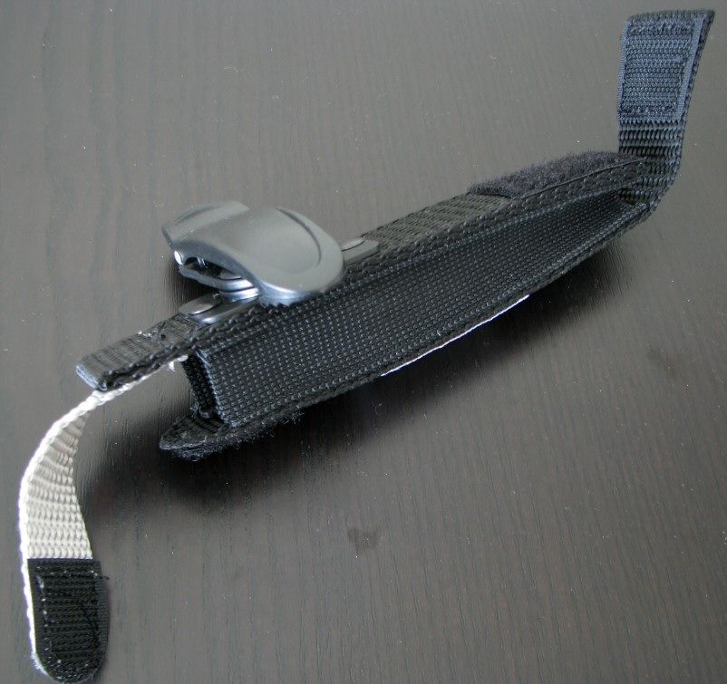

    Even at a glance, you can see the PAL has a few nice advantages over the bundled solutions. I’ve always been a fan of the minimalist early Fenix holster (the elastic side version, not the modern cheaper all-fabric one). First off, note that the PAL has velcroed closing flaps at both ends of the tube opening.
    This allows you to insert larger than typical length lights. It also lets you protect the tailcap end somewhat, while still providing access to a clicky switch while holstered (i.e. open the bottom Velcro flap).

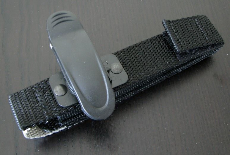

    The belt clip is also a higher quality solution than typical. The plastic is solid and holds securely. The clip swivels left or right, with three firm and noticeable detents on either side of straight down, up to 90 degrees (i.e. 180 degrees in total, with 7 detents). This is useful if you want to use a light hands-free on your person. You can clip the light on the side of your belt (or collar, or hat, etc.) and shine it at what you are looking at. Depending on the weight of the light in question, I found this worked reasonably well.
