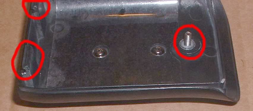

    I was curious about the question of whether you need a tool to change the cells, as was an earlier poster.
    One of swhs's web page photos clearly shows the underside and that a hex (Allen) key is needed. I hope the bolt is captive (looks like it could be).
    I also wondered about the inside attachment so I took the liberty of taking a section of one of swhs's web site pics and lightening it. You can clearly view the means of attachment of the base to the rest of the light.
    Can I add to the wish list for the Mark II version that a better design of latching the back end of the base to the top is used. That looks like very little alloy in those two little grooved posts (ringed) holding the back of the base to the top ..... although the bolt will take a lot of the load. They look like they could be easy to accidently break at the thinnest point.

    Okay, so the against-the-wall test is completely useless -- this thing throws down way more light than my P4's. It's a whiter light, and the beam pattern is both much wider and longer than my P4's can deliver at the same brightness. You can't really appreciate how the beam will project until you shine it down the street on a level surface; only then can you really see how much light it's putting out. While the light can certainly reach 80m, I wouldn't say the light at that distance is bright enough to really see by; however, I would certainly say that the usable light extends 40-50m, more than enough for all but really fast downhills. If I were to do a lot of fast downhills in the dark (I don't), I would want to add a helmet light which had a pretty tight spot, and just point that into the distance to see what was coming.
    I did end up modding the light to use a supplemental external battery pack (actually, two 4 x AA packs wired in parallel, since AA are so cheap, available and easy to charge). I went on my ride super early this morning so I could spend the entire time in the absolute dark, and it worked like a an absolute dream. I noticed that the battery indicator dropped from 3 bars down to 2 bars after about 30-40 minutes, to 1 bar at ~75 minutes and to no bars at ~100 minutes. However, once it reached zero bars, it just kept running and running all the way until I got home, a little over 150 minutes total. Basically, wiring an external battery pack in parallel with the internal batteries renders the battery indicator pretty useless.
    Thanks again to swhs for recommending this light -- it was a bit of a pain to mod it, but it was well worth it for me.
