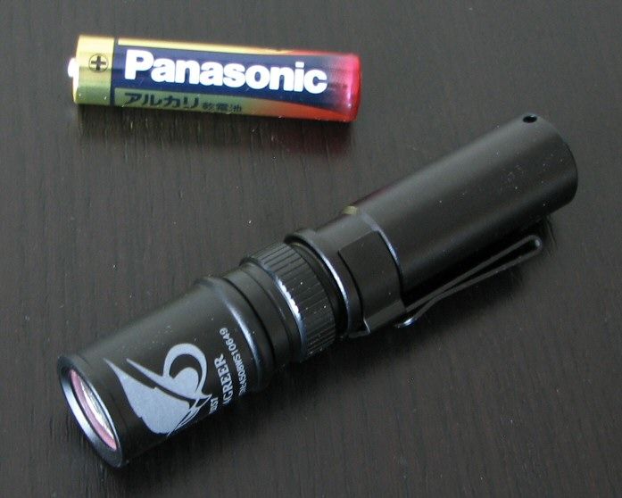

    The light comes in distinctive packaging – clearly designed for shelf placement in actual bricks-and-mortar stores. The plastic container has a magnetic closing clasp with cut-out foam for the light. Included with the light is a Panasonic alkaline battery, removable bi-directional clip, extra o-rings and small split-ring. Specifications, instructions for use and warranty information are printed on the cardboard sleeve.

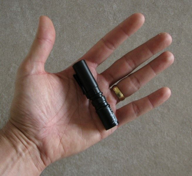

    4GREER WS1: Weight: 25.2g , Length 79.3mm x Width 16.2mm (bezel)

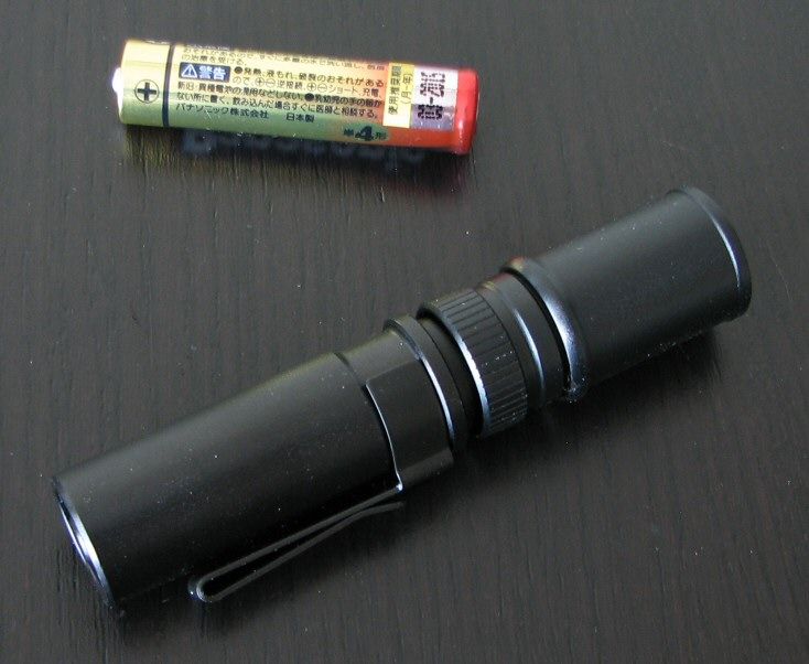

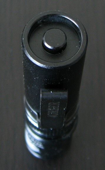

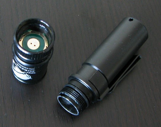

    The WS1 is more robust than most lights of this class, in keeping with its intended market. The walls of the light are particularly thick.
    Screw threads are anodized, in keeping with the mechanism of action (i.e. twist tight to turn on). Light can tailstand.
    Lettering is fairly clear, but in a less noticeable gray-white finish. Despite the large logo, this keeps the labelling fairly under-stated. No chips or flaws on the black type III (hard anodized) finish on my sample.
    While there is no real knurling on the body, there is a lot of ridge detail to help with grip. The bi-directional clip furthers helps with grip, and serves as an anti-roll device. Light can be operated single-handed.

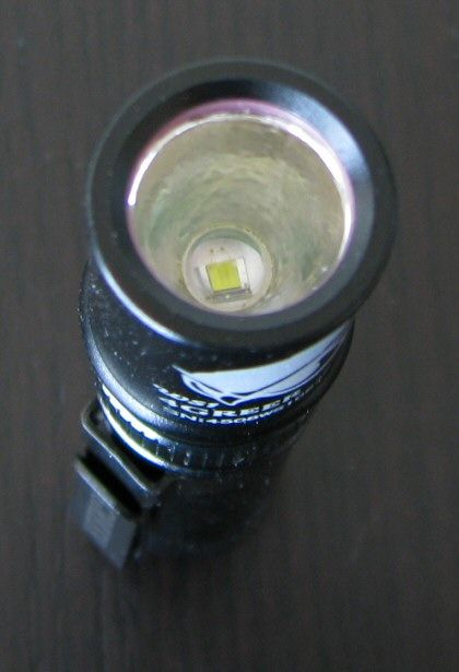

    As you can see, the light uses the older XR-E emitter (Q4 output bin), in a fairly deep OP reflector.

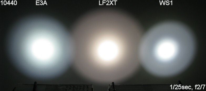

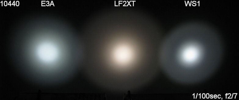

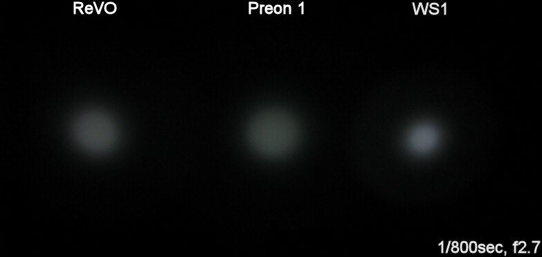

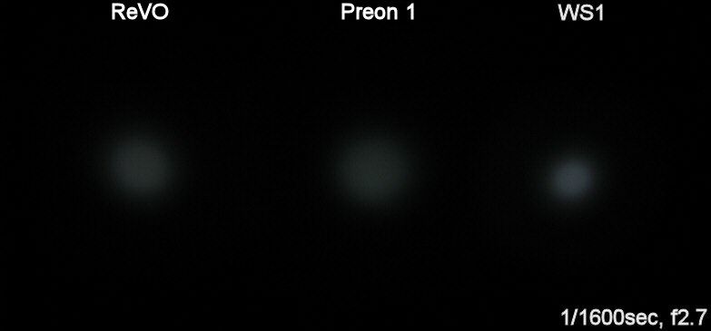

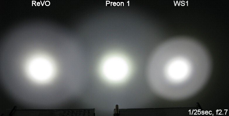

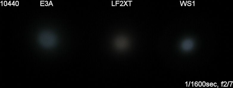

    And now for the requisite white wall hunting . All lights are on Hi on either Sanyo Eneloop AAA or AW unprotected 10440, about ~0.5 meter from a white wall.
    Sorry for the quality of the white wall beamshots – I’ve recently moved, and haven’t had a chance to set up a proper beamshot closet yet. What you are looking at below is recently primed drywall.
    Eneloop:
    AW 10440:
    Note: For the 10440 shots below, the camera is set to automatic white balance, to try and even out the tint differences. Rest assured, the cool-white emitter lights don’t look that blue in real life!
    In keeping with the deep and narrow reflector, the 4GREER WS1 has a narrow spillbeam. Transition from spot to spill is fairly smooth, but the standard Cree XR-E rings are clearly visible. 4GREER guarantees the WC tint (i.e. premium white, cool-white)
