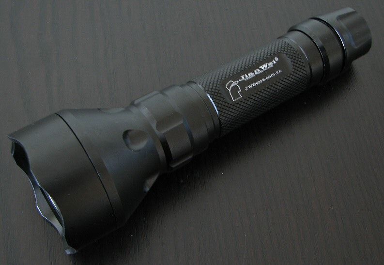

    I donít typically review "budget" lights anymore (due mainly to lack of time), but this one caught my interest - the distributor informs me that it is made in Tiabloís factory. Letís see how it compares to other mainstream XR-E R2 "thrower" lights, including those made under Tiabloís own name.

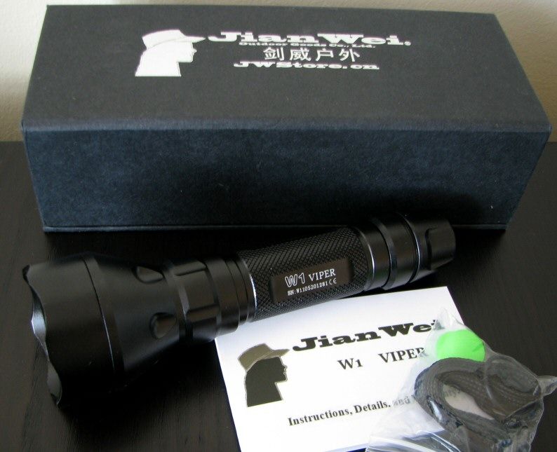

    Packaging is fairly standard, with a hard carboard box with magnetic closing flap and cut-out foam. Inside, the light comes with a manual, spare o-rings, GITD boot cap, and simple wrist lanyard.

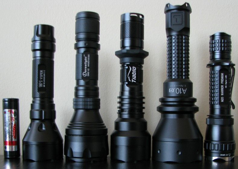

    From left to right: AW Protected 18650, Jian Wei W1, Dereelight DBS V2, Tiablo A9-R5, Tiablo A10G, Olight M20-R2.
    W1: Weight: 126.4g (no batteries), Length 125.6mm x Width 45.2mm (bezel)

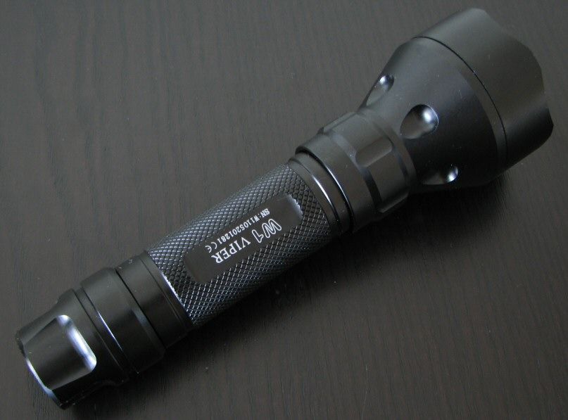

    Build quality seems reasonably good, generally consistent with other Tiablo lights Iíve reviewed. However, the overall aluminum construction seems thinner, and the light is definitely a bit smaller than most lights in this "thrower" class.

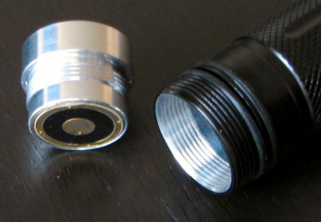

    Screw threads are anodized at the tailcap for lock-out.
    Anodizing is perfect on my sample, no chips in the medium gloss black (HA = type III). Knurling is not as aggressive as some some lights, but overall grip is alright. Lettering is sharp and clear, but looks "budget-like" in its choice of font and logo design.
    Light can tailstand, but is a bit wobbly with the slightly protruding forward cliky. You may be able play with the boot cover to improve tailstanding.
    Flat-top 18650s didnít worked on my sample, so I recommend you stick with button-top cells.
    Note there is no clip included with the light, and the wrist lanyward is very basic (thereís a whole in the tailcap to thread it through).

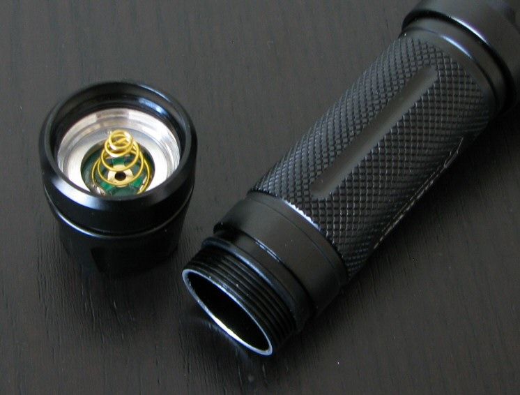

    Note that the light engine/pill is easily accessible (reverse threaded into the battery tube), which should make modding/upgrading relatively straight-forward.
    The W1 features the standard "thrower" emitter, the XR-E R2 output bin, with a large and deep smooth reflector. This should produce excellent throw.

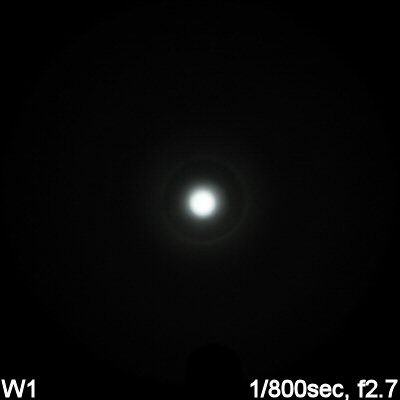

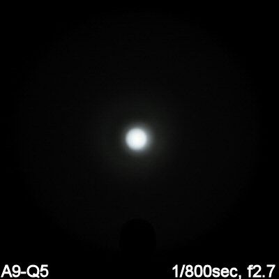

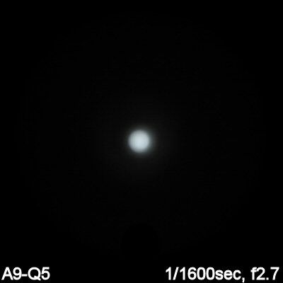

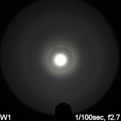

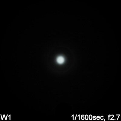

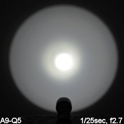

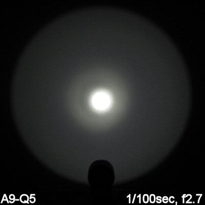

    Which brings us to the requisite white wall hunting . All lights are on Hi on AW protected 18650, about ~0.75 meter from a white wall (with the camera ~1.25 meters back from the wall). Automatic white balance on the camera, to minimize tint differences.
    From now on, all my beamshots will be taken in this standard configuration, to facilitate comparisons.
    As you can see, the W1 throws an even tighter hotspot beam than the "classic" Tiablo A9-Q5.

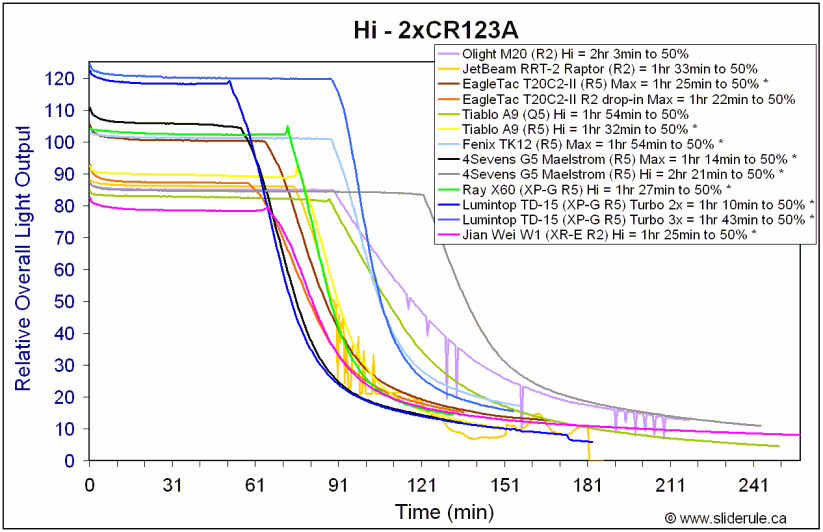

    Output/Runtime Comparison:
    Effective January 2010, all CR123A runtimes are now performed on Titanium Innovations batteries. You can compare the performance of these CR123A cells relative to the Duracell/Surefire cells used in my earlier reviews here. These new light results are marked by an "*" in the graph legend
    Oddly, the W1-R2's output/runtime performance seem slightly lower than the A9-Q5. The PWM-controlled W1 does not seem quite as efficient as the A9-Q5 or A9-R5, even taking into account the emitter output bins used.
    There is no output mode retention Ė the light always advances to the next output mode in sequence when you turn it back on. This is rather frustrating in practice Ė I would prefer that it memorized the last mode used, or always came on in Hi.
    Strobe is included on the main sequence, so you need to go through it to return to the beginning of the sequence. I would have preferred to see it "hidden" away somehow.
    Output/runtime performance is acceptable, but nothing more.

    I hope your friend likes strobing this holiday season. I hope your friend likes strobing this holiday season. But it does provide a good amount of throw for those on a budget.
    And yes, that is one of the strangest logos I've seen to date. On the manual, the hat is colored olive green, so I guess it's suppose to evoke a military theme?

    Is the light engine removable?
    This could be a great light driven a little harder, and without disco!

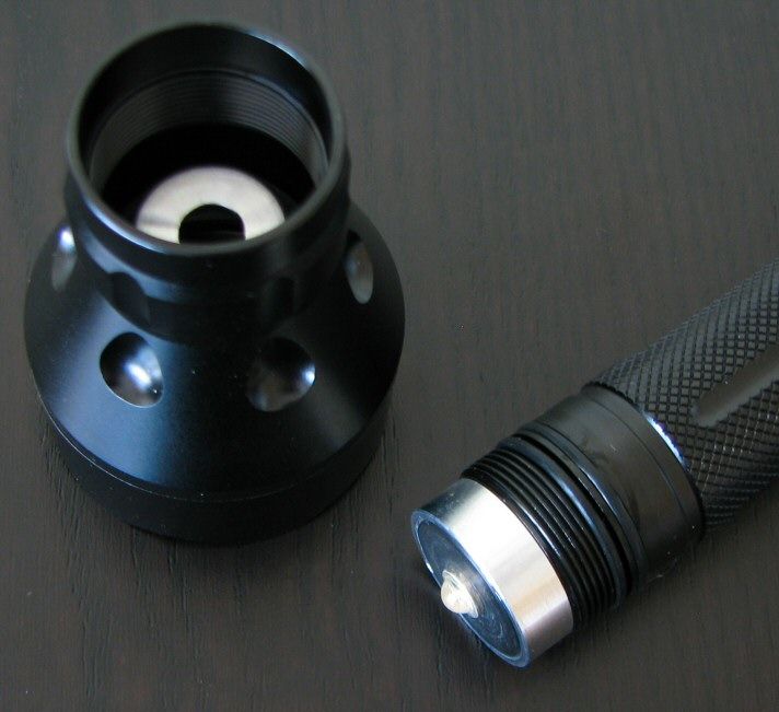

    Written by crossliner67 on 11-15-2010 05:06 PM GMT
    I must have missed it but will an A8/A9 collimator fit this baby Mr. Selfbuilt? Tia and have a nice day.

    Yes, the light engine/pill is easily removable. The assembly is reverse threaded into the top of the battery tube - just unscrew, and the whole thing comes out. Should make for a good base for modding. Yes, the light engine/pill is easily removable. The assembly is reverse threaded into the top of the battery tube - just unscrew, and the whole thing comes out. Should make for a good base for modding.
    Just added to the review:
    No it, won't - the W1 is considerably smaller in the design. The W1 battery tube is narrower than the A8/A9 body, so the collimating head won't fit. No it, won't - the W1 is considerably smaller in the design. The W1 battery tube is narrower than the A8/A9 body, so the collimating head won't fit.

    I haven't opened it up, but the positive contact discat the base of the light endinge is ~18mm in diameter. That would seem to be your max width. I haven't opened it up, but the positive contact discat the base of the light endinge is ~18mm in diameter. That would seem to be your max width.
    This is because it's using new smaller EZ900 die, whereas A9 is using bigger, older EZ1000 die. This is because it's using new smaller EZ900 die, whereas A9 is using bigger, older EZ1000 die.
