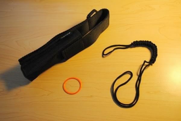

    The Fenix LD40 arrived in normal Fenix packaging with the usual included accessories (holster, lanyard, spare o-ring)

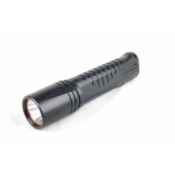

    Design(body):

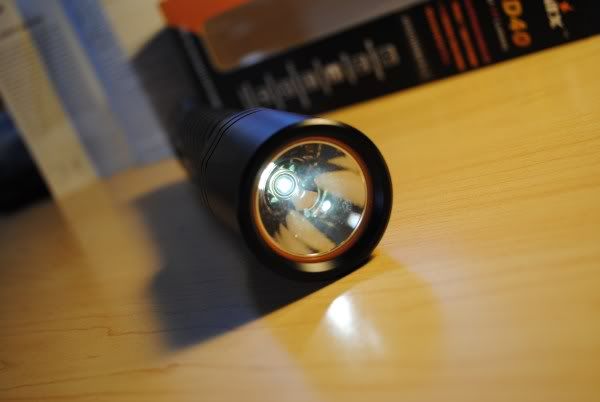

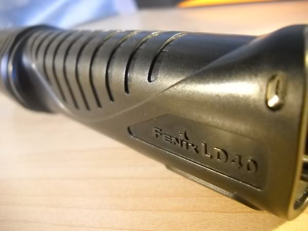

    The design of the LD40 is for me a first, with 4xAA batteries in a 2xAA side-by-side format. This gives the flashlight a unique shape which fits into the hand very comfortably. With the more common 2xAA format, the handle portion of the flashlight tends to be a rather slim, perfectly round tube which does not offer the best grip. As far as I am concerned, the knurling on standard cylindrical flashlights is done as a way of adding extra grip but to me the shape of the actual part of the flashlight that is in my hand is what is ultimately most important for grip. Further on the topic, the majority of my tools don’t have perfectly cylindrical handles, whether it be hammers, axes, etc. I always find that I prefer a somewhat flat surface up against my palm when I am holding something. On this aspect, I believe Fenix has hit the mark perfectly.
    The handle on the LD40 is not metal but seems to be some sort of plastic polymer (perhaps acrylonitrile plastic) which seems durable and definitely not cheap. I can imagine that this will be a topic of debate for most people but there are positives and negatives for both sides.
    First the positives. The plastic allows Fenix to be more flexible with the design of the flashlight which in this particular case resulted in a rectangular body which is great for grip. If I am not mistaken, all of Fenix’s previous metal designs have been cylindrical. The plastic is also going to be better for colder temperatures where metal can get quite cold to bare skin. The plastic also saves some weight, albeit not a significant amount. An important consideration which must not be overlooked is the price factor. I’m assuming Fenix will be able to offer this flashlight at a more competitive price because an all metal casing will likely cost more to produce. Whether or not that leads to a decline in quality is yet to be seen and is a good transition into the negatives.
    The rounded end of the LD40 means that it cannot tail stand.

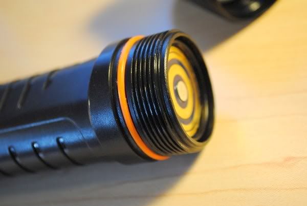

    Over the years I have learned that there is no replacement for metal parts. They are just stronger and will last longer. This is not to say that these newer plastics are not durable, but I will have my reservations until it passes the test of time. Also, I can foresee there being problems with the threads between the head (metal) and the body (plastic). It seems that over time, the plastic threads will be worn down by the metal threads from the friction and twisting and this may compromise the seal. Some people also prefer the entire body to be made of metal in order to aid in heat dissipation from the LED. I will for now accept the new plastic design as something innovative and will see if it performs as it should in the future.

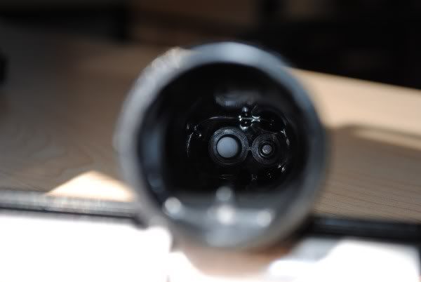

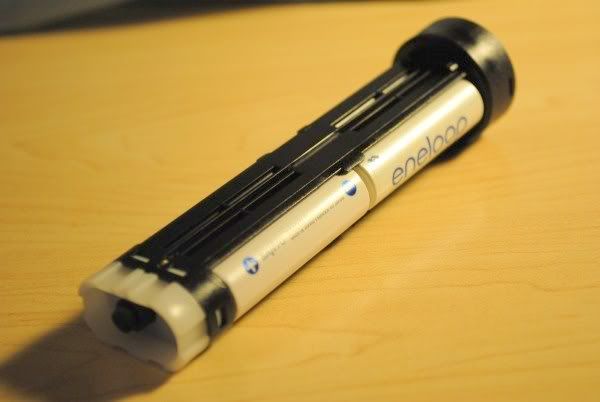

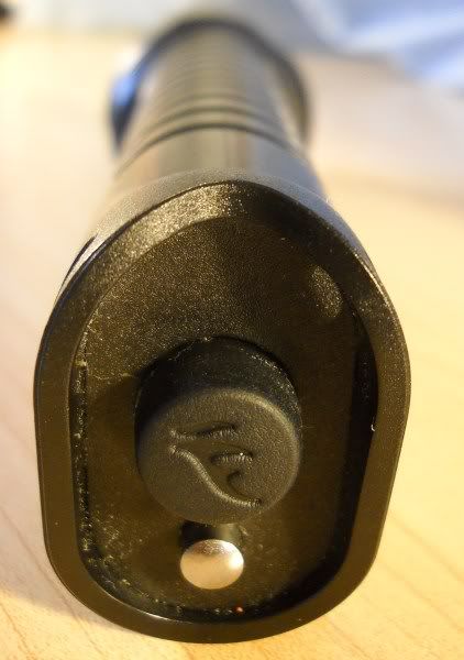

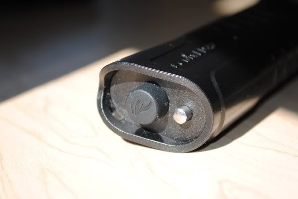

    Stock photos show various screws in the tail-cap area which have been removed in this production model. It seems the plastic has now been molded from the same piece so the tail “plate” no longer needs to be screwed onto the body. In my opinion, the fewer openings, the better. It’s hard to get a picture of the tail-end of the flashlight from inside the battery tube but this picture should give you an idea of how the “switches” on the outside do not include the actual switches, which are on the battery carrier itself. These buttons merely press up against the battery carrier switches when the battery carrier is placed inside.

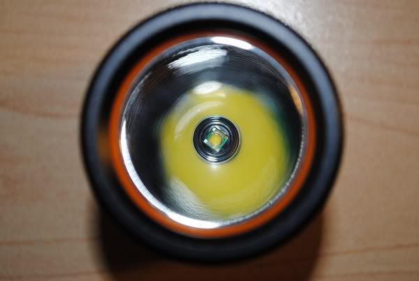

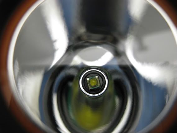

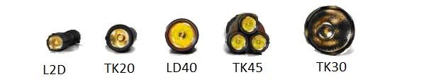

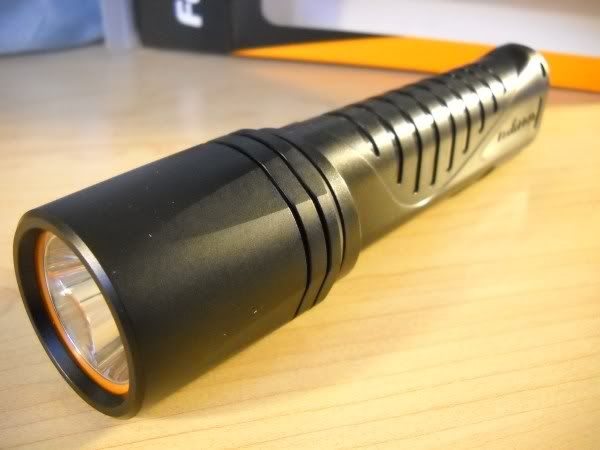

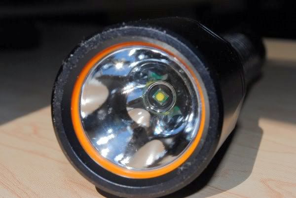

    The LD40 head is very large in comparison to Fenix’s 2xAA flashlights, having a diameter of approximately 40mm. The side-by-side battery carrier design has afforded Fenix the ability to make a wider flashlight with a much larger head and deeper reflector. This of course means more throw and the inclusion of a smooth reflector seems to assert this fact that Fenix intended this flashlight to be primarily a thrower. This is not to say that there is no spill, but the throw is definitely its strong point. Fenix claims the beam reaches 207m under FL1 standards.

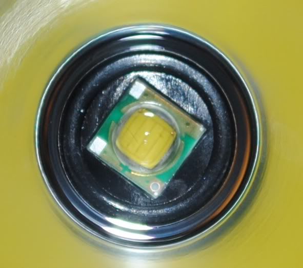

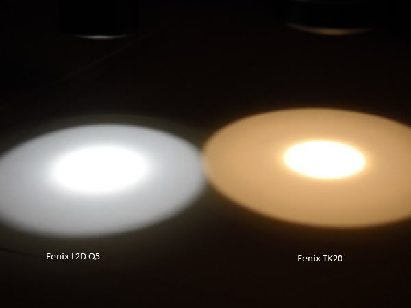

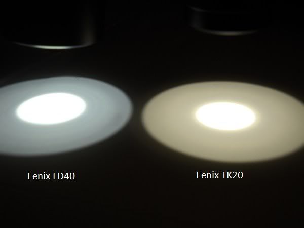

    The LD40 uses an R4 Cree XP-G neutral white LED, providing a rated 248 lumens on its maximum setting. The color tint of this LED is slightly cooler than the TK20 but definitely a much warmer color than the normal cool tint on the Fenix L2D or LD20. Overall the beam is near-perfect with a nice warm color and no artifacts whatsoever. For outdoor purposes, which is where I will be using the flashlight, I believe neutral white is the way to go. The color rendition is far superior and enables me to identify objects at a distance far quicker because I can identify colors faster. Cool white LEDs make colors pale and for me this makes objects harder to identify. The LD40 is most definitely an outdoorsman’s light. The far reaching beam and color rendition are perfect for this.
    There is a very, very slight dark spot in the center of the beam. This is barely perceptible to the eye but in full discloser it is there. I almost did not notice it until I looked at the beam on a white wall out of the corner of my eye, which is more sensitive. For my purposes and I believe for any practical non white-wall hunting purposes, this small darker area is so small that it is irrelevant. The beam is otherwise flawless. The hotspot is very well defined and there is also a very bright spill just around the hotspot, an area perhaps 3 times larger in diameter than the hotspot itself. After that, there is an even brightness all the way to the outer rim of the beam.
    This comparison of beam tints show a TK20 on the right side in both pictures. In the top picture, the beam on the left is an L2D Q5 while on the bottom the left side is the LD40. You can see that the TK20’s beam is much warmer than the L2D but only barely warmer than the LD40.

    The 4 constant modes are low (4 lumens), medium (43 lumens), high (110 lumens), and turbo (248 lumens). These modes are accessed by a completely separate metal button on the tail-end of the flashlight (different from the power button). By pressing this button and releasing, the mode will increase to the next higher setting. The light also has memory meaning it will switch on at the mode it was turned off at. Also to note, the LD40 has momentary-on meaning that the power switch does not need to be fully “clicked” on for the light to power up. A slight amount of pressure will turn it on. This is an important consideration for tactical use. The 4 lumen low mode is something which in my opinion should be looked at once again by Fenix. From personal experience, if I want a low mode, I want a low mode that is between 0.5 and 1 lumen. 4 lumens is simply too bright. That is not to say that it is not necessary, I believe the 4 lumen mode is perfect for walking around the neighborhood at night, but for inside the tent with a sleeping companion inches away, a lower low mode would definitely be appreciated. Having said this, I do believe it’s important to note that Fenix is heading in the right direction by continually lowering the output of its low modes. The L2D Q5 has a low mode of 12 lumens while the TK45 has a low of 8. This steady decrease in low mode lumens is a welcome trend by the manufacturer and I hope that it will continue.

    The battery holder is made of plastic and has a very slight rattle when the flashlight is shaken. The battery holder only fits into the battery tube in one direction and on one end has the buttons used for on/off and mode switching.
    This is the first time I have seen the battery carrier itself with the switches for mode operation. The tail end of the flashlight simply has covers for these buttons. Since the TK40 allows you to use half the required batteries (4 instead of 8) in emergency situations, I was curious to see if the LD40 would work with 2 instead of 4 batteries but it will not.

    I'm with you on the placement of the rear switch. They should just move it to the side and make the thing tail stand.
