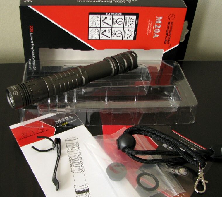

    Although I have reviewed a number of SUNWAYLED lights (now called SUNWAYMAN), this is my first review of a XP-G R5-equipped light – the 2xAA M20A.
    Packaging is fairly typical, and the light comes with a reasonable number of extras. Inside the cardboard box with plastic insert is the light, manual, warranty card, spare o-rings, extra boot cap, good quality wrist strap, and pocket clip. I would have liked to have seen a belt holster, though.

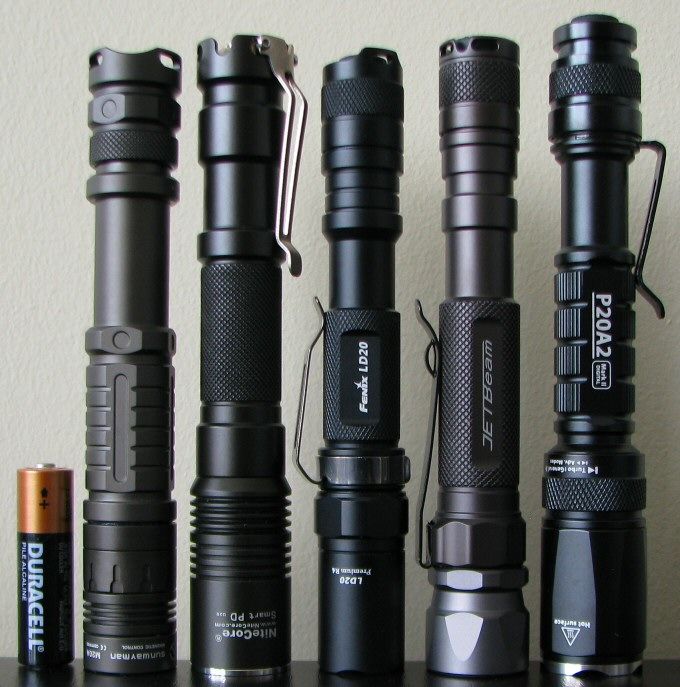

    From left to right: Duracell alkaline AA, Sunwayman M20A, Nitecore D20, Fenix LD10-R4, Jetbeam Jet-I PRO EX V2, Eagletac P20A2-II.
    M20A: Weight: 74.5 g (no battery), Length 151.1mm x Width 23.0mm (bezel)
    Overall dimensions are about typical for this class of light.

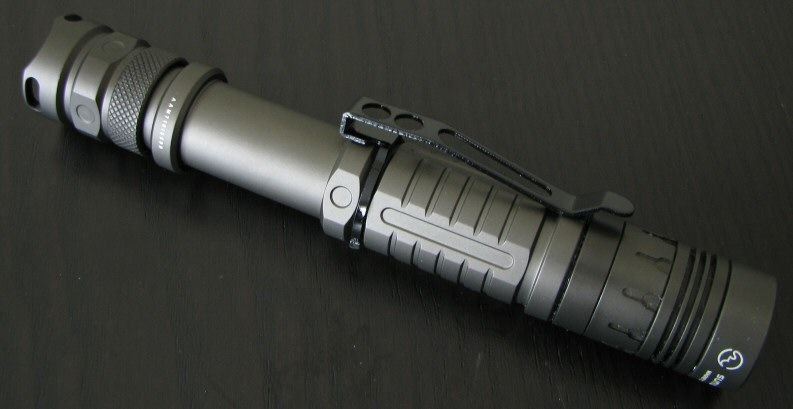

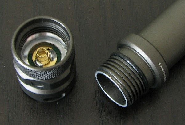

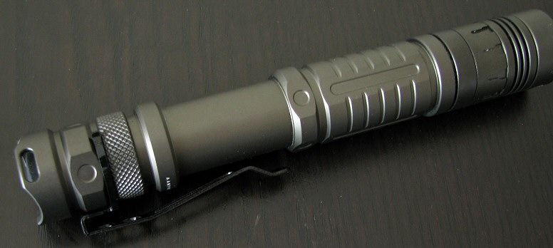

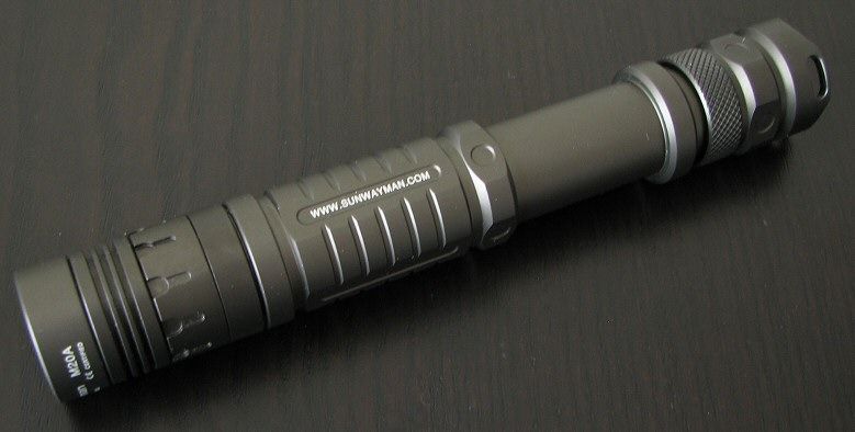

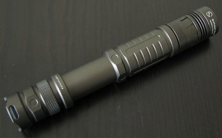

    Build quality is excellent. Note the square-cut threads at both ends of the battery tube. Screw threads are anodized at both the tailcap and head for lock-out. As before, I would like to see a few more threads at the head region of the battery tube.

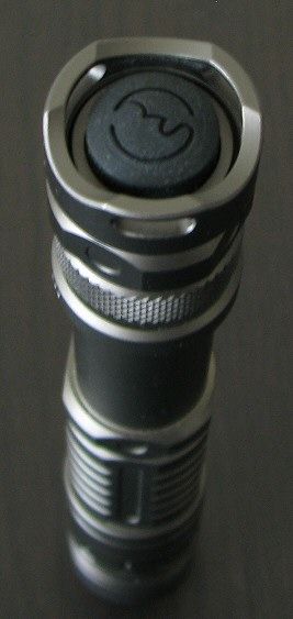

    The tailcap switch is a typical forward clicky, with good feel. The light can tailstaind.
    The magnetic control ring in the head allows you to choose between output levels. The ring has a good feel, although it can be hard to see (i.e. color matches the rest of the body anodizing)
    Light feels very solid. Knurling is not very aggressive, but there are a lot of body ridge details to help with grip.
    Anodizing is excellent on my sample, no chips in the dark gray natural finish (HA = type III). Note that natural color anodizing is by its nature more variable from sample to sample, and even within the components of a given light.
    Lettering is sharp and clear, nice and bright against the black background.
    As before, the clip seems to be fairly basic. It holds onto the light well, and can be positioned for bezel-up or bezel-down carry in a number of ways. But with all clips of this sort, there is always a risk the light might catch on something and be pulled off. I recommend you use the wrist lanyard if there is a risk of dropping the light. I am disappointed that a belt holster wasn’t included with the light.

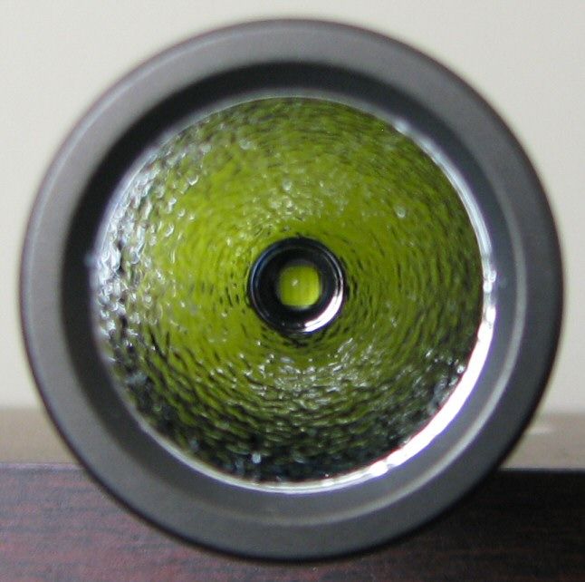

    The M20A features the Cree XP-G R5, with a medium textured orange peel (MOP) deep reflector. I am glad to see Sunwayman has made the switch to these newer reflectors.

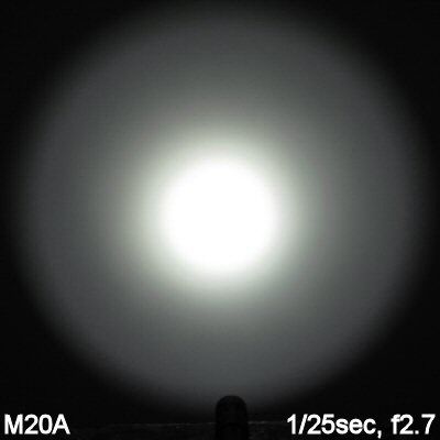

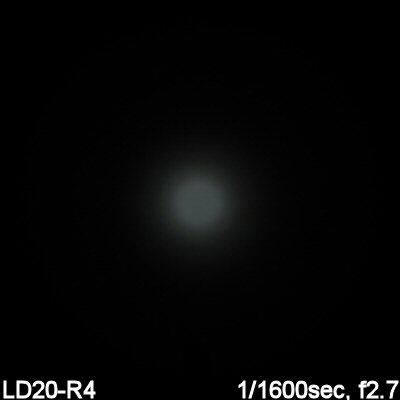

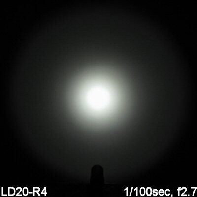

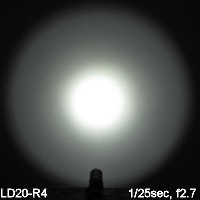

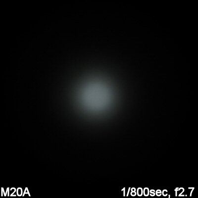

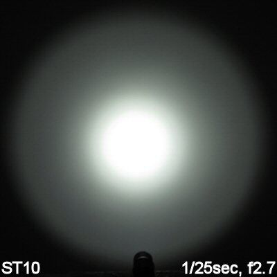

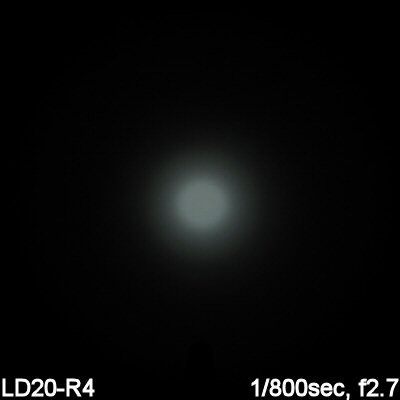

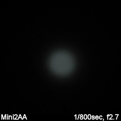

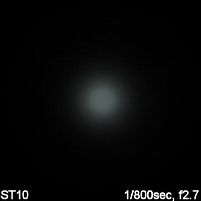

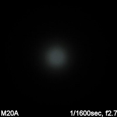

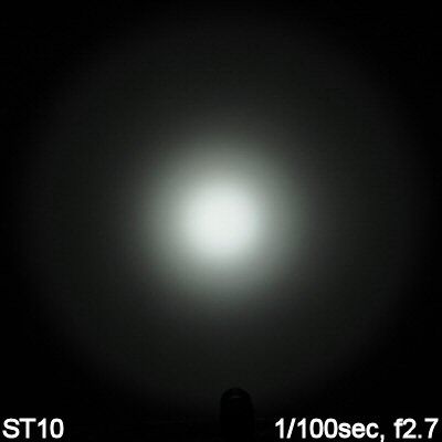

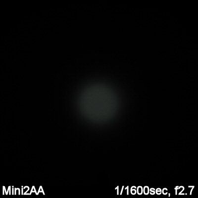

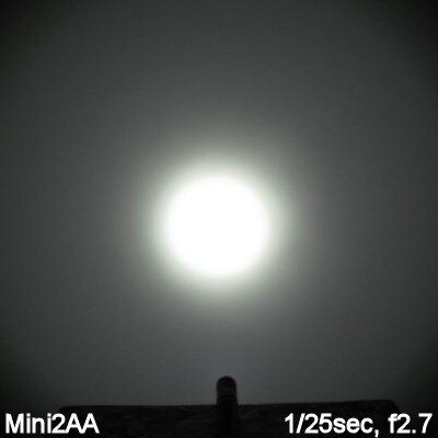

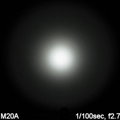

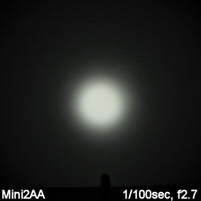

    Which brings us to the requisite white wall hunting . All lights are on Hi on 2x Eneloop NiMH, about ~0.75 meter from a white wall (with the camera ~1.25 meters back from the wall). Automatic white balance on the camera, to minimize tint differences.
    From now on, all my beamshots will be taken in this standard configuration, to facilitate comparisons.
    As you can see, the M20A has a reasonably smooth beam for this class. There are some minor artifacts in the beam, but these are only noticeable on a white wall at really close distances. Scroll down to my Summary Tables for more specifics on output.

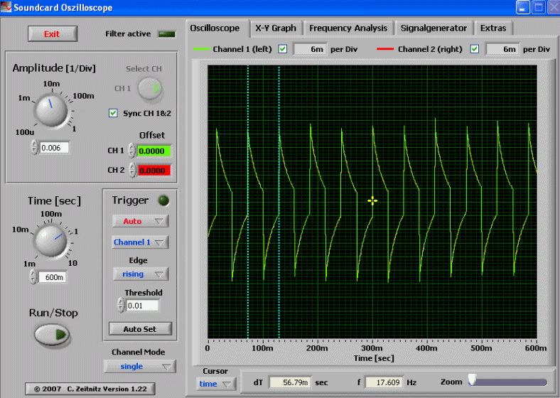

    No PWM
    There is no sign of PWM flicker by eye or with my sound-card oscilloscope on any level. Sunwayman lights thus seem to be current-controlled. This is particularly impressive, given how low the “Moonlight” Lo mode is.
    Strobe
    Strobe was measured at a fairly high “tactical” 17.6 Hz, which is a bit higher than the earlier M20C/M10R.

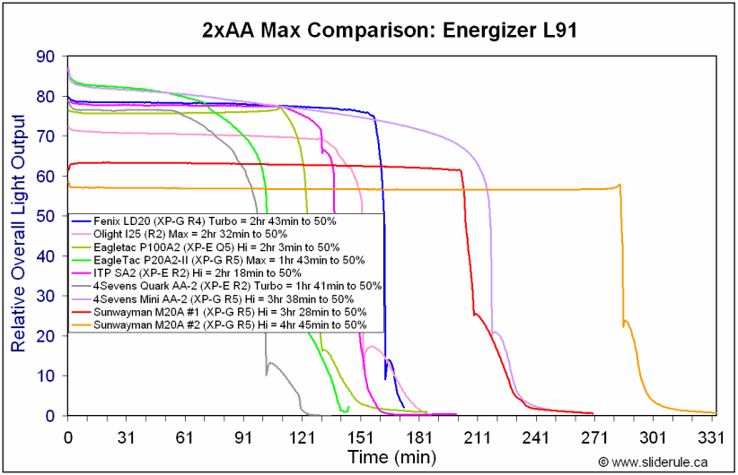

    The max output and throw of the M20A is typical for this class of light. The Lo mode is quite low compared to other makers (i.e. more of a “Moonlight” mode).
    See my runtimes below for info on the relative output levels.

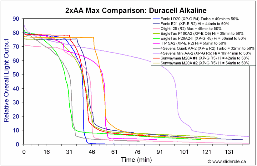

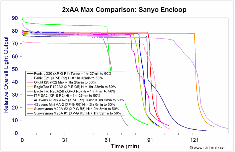

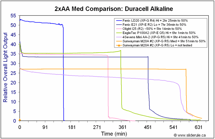

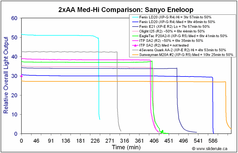

    Output/Runtime Comparison:
    Note: my original M20A sample failed during testing, with only the Hi output runs completed (identified as #1 in the runtimes below). Sunwayman replaced the light with another sample, used to complete the testing (identified as #2). I have left both samples in the results below.
    Output/runtime efficiency is excellent on the M20A, as expected for a good current-controlled light.
    In fact, performance of the replacement M20A sample (#2 above) is simply outstanding on Hi on Eneloop and alkaline batteries. I’ve left the original M20A sample (#1) in the runtimes above, as its performance was more in keeping with a typical light of this class. I would expect a given M20A sample would perform somewhere within this range of performance.
    All-in-all, this is very consistent with Olight/4Sevens performance.
    Max output on L91 is lower than NiMH/alkaline. However, all output levels are maintained on L91 lithiums (i.e. many other 2xAA lights loose the lower levels initially).

    with the original sample failing during testing. I guess I would understand if it was real extreme testing or there was a logical explanation as to why it would be different from models sold.
    Actually, circuit failures during testing are not at all uncommon. I've experienced it with almost every major manufacturer, at one time or another. I point it out in the review for full disclosure, but am not overly alarmed by it - unless confirmed by others for a given model. Actually, circuit failures during testing are not at all uncommon. I've experienced it with almost every major manufacturer, at one time or another. I point it out in the review for full disclosure, but am not overly alarmed by it - unless confirmed by others for a given model.
    A good example of the later is the Tiablo E3A - my first sample failed (disclosed in the review), another user quickly experienced a failure, and then my replacement sample subsequently failed! That pointed to a design fault with the originally shipping circuit (consistent with the abnormally low performance I measured and published on each sample before they failed). Tiablo discovered the problem, and another replacement unit from a revised second batch showed much better performance, and no failures.
    In this case, the replacement M20A has excellent circuit performance and no sign of problems as yet. It's possible the first sample was defective to start, but I have left what data I have in the review. Should subsequent failures be noted - or should Sunwayman get back to me with findings on their analysis of my first failed unit - I will of course update the review. Until then, the current sample I have on hand seems to be performing admirably.
    It is always difficult to generalize from one sample - what is important is the general experience of a large number of users. We will see how this case unfolds ...
