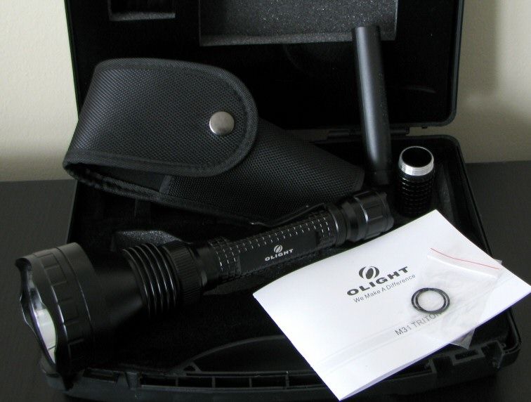

    Packaging is similar to other high-end Olight lights. Inside the plastic carrying case with closing flaps, everything is firmly secured in cut-out foam. You will find the light with battery extender tube, manual, battery carrier, spare o-rings, and belt holster.

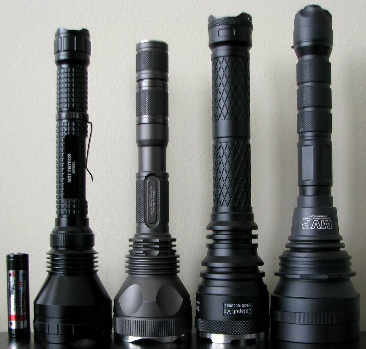

    From left to right: AW Protected 18650, Olight M31, M30, Jetbeam M1X, Fenix Tk45, Eagletac M3C4.
    From left to right (with extender): AW Protected 18650, Olight M31, Jetbeam M1X, Thrunite Catapult V2, Lumapower MVP P7.
    M31 no Extender: Weight: 258.1g (no battery), Length 209mm x Width 62.3mm (bezel)
    M31 with Extender: Weight 275.1g (no battery), Length 245mm x Width 62.3mm (bezel)

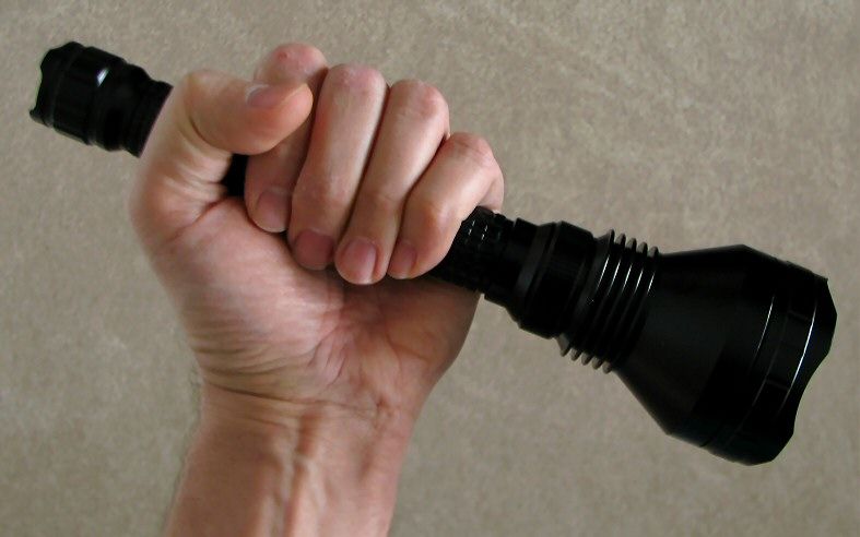

    As you can see the M31 is larger than the earlier MC-E-based M30. The main reason for this is the much larger head, with a wider and deeper reflector.

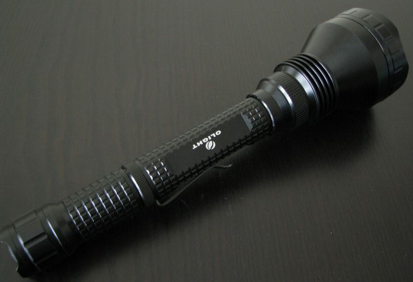

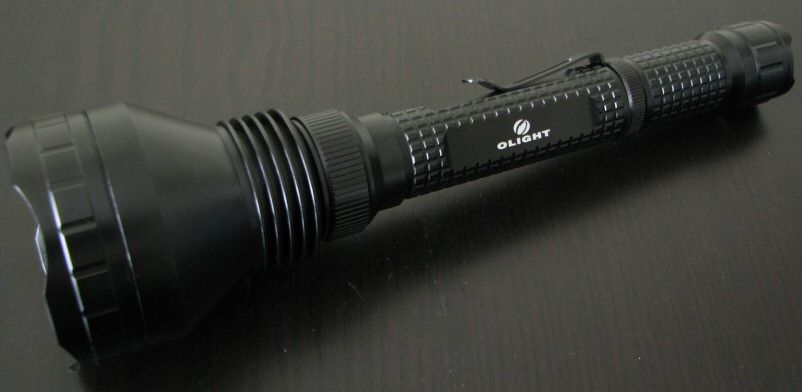

    Build quality is very good. The overall shape and design is similar to the M30, only with a larger head and traditional tailcap.
    The M31 comes with black finish type-III (hard) anodizing. Rather than traditional knurling, the M31 has a raised checkered pattern to help with grip. I typically find Olight lettering is bright and clear, and the M31 is no exception. Both the bezel opening and tailcap have raised scalloped edges. Like M30, the M31 can also tailstand.

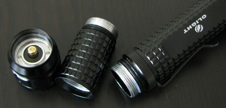

    Screw threads are not anodized on the battery tubes, but there is anodizing on the tailcap screw threads. So lock-out is possible, although it may not be as robust as where both sets of threads are anodized. Note that is a definite improvement over the M30, where no lock-out was possible as they needed to keep a constant current path for the tailcap side-switch.
    The attached clip can be removed by unscrewing the retaining ring above it and pulling the clip off.

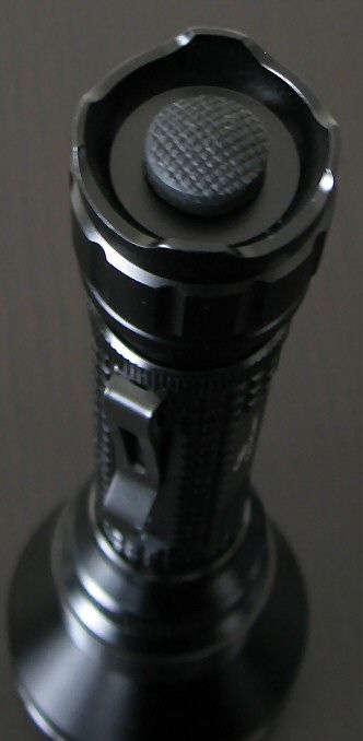

    The tailcap switch is a typical forward clicky, with good feel. The light can tailstaind.
    The included 3xCR123A/RCR battery holder is optional – you don’t need to use it in this configuration, but it does remove battery rattle if you choose to. The bore width of the body tube is wide enough to accommodate protected 18500/18650, so thinner CR123A cells are prone to some rattle. At the very least, it makes a good storage holder for an extra set of cells.
    Note the spring in the head, so high capacity flat-top batteries can be used.

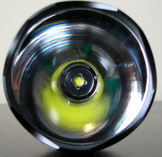

    The M31 features the Luminus SST-50, with a large and smooth reflector. This should translate into good throw.

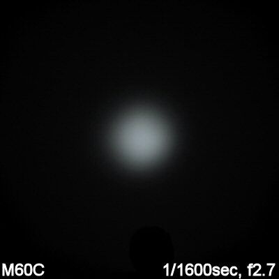

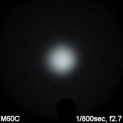

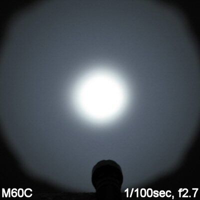

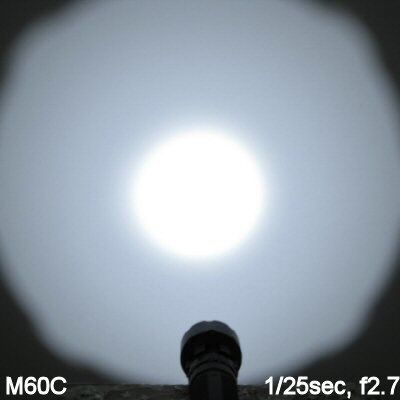

    Which brings us to the requisite white wall hunting . All lights are on Hi on 2x 18650 (6xCR123A in the case of the M60R – mislabelled as M60C). Bezels are about ~0.75 meter from a white wall (with the camera ~1.25 meters back from the wall). Automatic white balance on the camera, to minimize tint differences.
    Note:I accidentally mislabeled the M60R images and M60C in the pics below – sorry. :shhh:
    From now on, all my beamshots will be taken in this standard configuration, to facilitate comparisons.
    Ok, so the M31 can throw! There are specific details in my Summary Tables further down, but the M31 is the best throwing SST-50 I’ve seen yet.

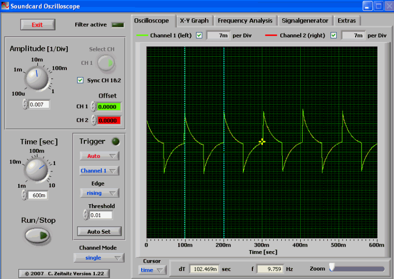

    No PWM
    There is no sign of pulse width modulation (PWM) on any output mode - I believe that the light is current controlled.
    Strobe
    Strobe was measured at a fairly typical 9.8 Hz.

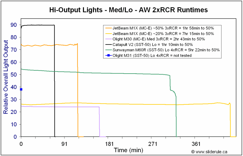

    Output/Runtime Comparison:

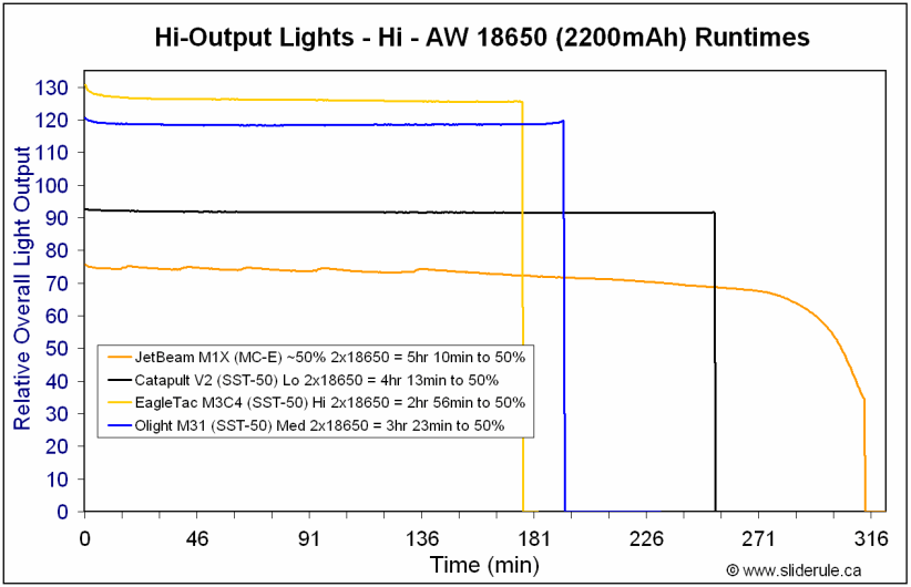

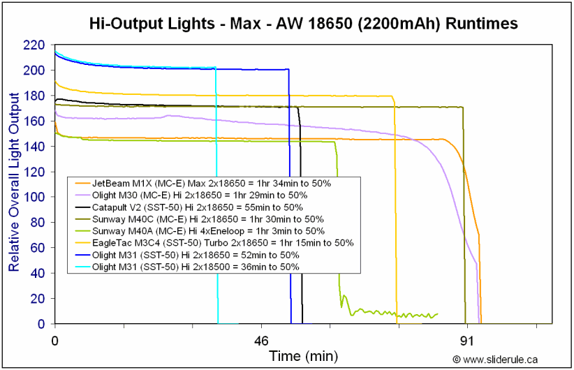

    Note: Effective January 2010, all CR123A runtimes are now performed on Titanium Innovations batteries. You can compare the performance of these CR123A cells relative to the Duracell/Surefire cells used in my earlier reviews here. These new light results are marked by an "*" in the graph legend

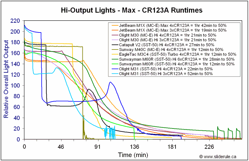

    Output/runtime efficiency is excellent on the M31, at all levels and on all batteries. Basically, exactly what you would expect from a good current-controlled light - no surprises.
    On the primary CR123A Hi mode tests, you will note the light stepped down early into the runs (i.e. just like my Catapult V2 SST-50). This is likely due to a thermal sensor, designed to protect the light from overheating cells.
    UPDATE: Based on further analysis, it appears that this behavior is not a circuit feature - rather, the M31 is driven high enough on Max to trip the PTC safety devices of most primary CR123A cells, when run over a sustained period. A PTC (Positive Temperature Coefficient) functions as a type of thermistor - once the temperature reaches a certain threshold (which can vary according to the battery manufacturer), the PTC resistance rises and current limitation kicks in, causing a rapid drop in output. Over time, the temperature drops and the cells recover, showing an uptick in output. This is what you are seeing on the M31 traces above. Note that there can be significant variation in the thresholds for different batteries - please see the extensive discussion in this thread.
    Light is heavily driven on Hi, so you should use this mode sparingly (especially on anything other than 2x18650). Heatsinking may not be as extensive as some other lights in this class.
