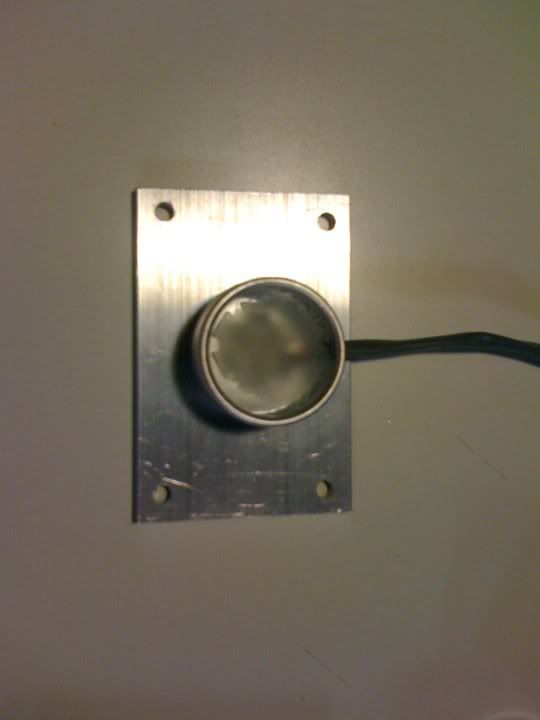

    I fabbed up some fixtures:
    Triple-emitter is AAd to the holder, which is AAed to the mounting plate (2.00 x 0.125 aluminum bar); the holder is really a tiny aluminum sample container with a glass lid that wasnt terribly easy to frost with sandpaper (not pretty, but these were destined to be out of sight)

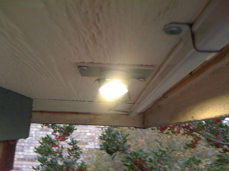

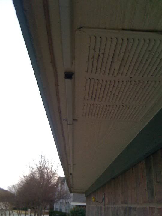

    I hung some metallic raceway:
    Out of sight from more than five paces, so don't give me any lip about them not being lined up; the other wire is pre-existing
    After some frustration with popped solder joints, ripping a few solder pads off the MCPCB's, and the distinct pleasure of soldering something attached to the ceiling while standing on a ladder, I scaled back the design to 4 fixtures. I'm quite pleased with the results:
    Cellphone pics are all I have. Sorry.
    Each fixture should be sipping about 3 watts for 12 watts net. Figure in some driver inefficiency and I'm looking at maybe 15 watts total power consumption. Fewer absolute lumens than even one of the halogen lamps it's replacing, but the light is uniform and where I want it rather than two spots on each half of the driveway. Color is a tad cool, but not too far off from some of the CFL's in the neighborhood.

    Default Re: an outdoor LED lighting project
    I like your idea.
    Could you post a pic of the can attached to the house?
    Hmmm... Took a photo, but forgot to post it.
