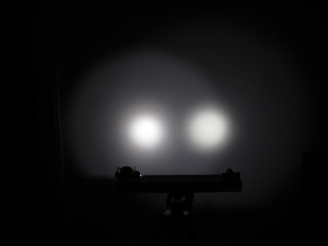

    I had both, but sent the Spark back because it had the weird flicker problem others have reported. I did do a beamshot comparison before I sent it back:
    H51 on the left, Spark ST5 on right. Note the wide spill of the spark, visible in the lower right.
    The new version has the XM-L emitter, which will change the beam profile.
    I liked the Spark a lot while I had it - the memorized level was nice, and the protrusion of the lens away from my head reduced the glare on my glasses. I am looking forward to getting it back for a more in-depth comparison.
