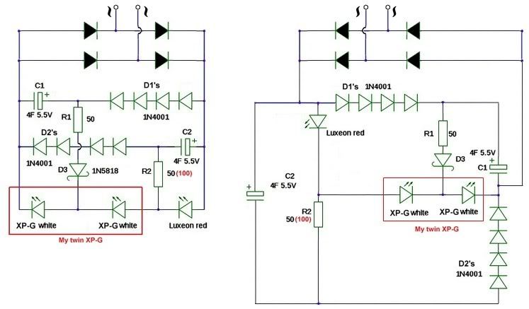

    Good to know that I could "get away with" caps of lower spec than ideal! I think you are not the only one who has practical experience with using these supercaps for a purpose they were not designed for. Anyone know the max current spec of the Maplin 1F 5.5V cap?
    I still just couldn't get my head around C2 discharging through the 2 white LEDS ...... so bare with me on this. I've redrawn the circuit and included the bridge rectifier for completeness. Original on the left ....... on the right hand side I've tried to make C2 look like "a battery" in this stationary situation. The only route I can see C2 discharging is through the red LED and R2. If I got the redraw right, all other discharge routes for C2 are blocked by a reversed diode(s) ..... aren't they?
    Help me out here folks .... have I got it wrong?

    Now ..... anyone help me with the revised diagram?

    There's a fwd path through the red, then through the 2 XP-G white LEDs (what's going to stop that?)
    Also, the re-draw has helped, kind of. Something I just spotted is that C2 can discharge into C1 and charge that up too, although the bank of 4 diodes will mean it won't be much, but it will be another inefficiency.
  9. #99
    Default Re: Squeezing the power out of a Supercap
    Appreciate the response jpd ........
    Quote Originally Posted by jdp298 View Post
    As I understand it .... the 4 reversed D2 diodes will block any flow. The "reverse" leakage current through D2's is absolutely miniscule compared to what flows through R2.
    That's how I see it too....... but the 4 reversed C2 diodes and also the reversed white XP-G's "reverse" leakage currents are insignificant in giving charge to C1 compared to the current allowed through R2.
    If I got it right, 1N4001 reverse current < 50uA (~600 times smaller than initial red LED current @ 100 Ohm) and I think Cree use 100uA as the reverse current failure criteria for their power leds (~300 times smaller than the initial red LED current @ 100 Ohm)
    All in all, until I build the circuit, I'm only trying to postulate what should happen!
    [ Sticks neck out for chopping by real experts ...... which I am not! ]

    Quote Originally Posted by Bobblehat View Post
    They won't, because they aren't reversed. On the right hand diagram, you can consider the far right vertical line to be the effective ground plane. Everything drains down to this point, so to speak, and ends up back at the bridge rectifier.
    So what happens is the charge in C2 can drain down via any of 3 routes.
    After the red LED:
    1. Through R2 and then the D2s
    2. Through both white LEDs
    Or
    Through the D1s, at which point it can charge up C1 and/or go through R1 and the thence the second white LED.
    I don't think I'm using terms you're happy with; can someone else try and translate what's in my head for him?

    So .... If I removed D1's, R1, C1 and D3 ...... I can still light the red LED and the two white LED's from the C2 standlight components? How bright roughly would the white LEDs be, compared to the red LED?
    Forgive me if I am way too late here, but isn't C2 feeding only the red led, and C1 feeding only one of the white leds?

    I thought that's what my diagram (msg#82 & msg#93) has suggested ... 2 white XP-G's in series, one of the White LEDs on the standlight, each supercap charged to close to, but below 5.5V, the other supercap powers the red LED? If you are suggesting an alternative to the way I drew the circuit, I'd love to see a sketch.
    Steve
    Thanks Steve .... not too late
    That's what I thought too ...... but jdp has put a little doubt in my mind ..... am I right in thinking the reverse diodes do the necessary blocking of more complicated discharge route(s)?

    As I remember it, white leds have a reverse breakdown of about 5V.
    For 1N400x it is humdreds of volts.
    And neither leak much.
    most of the odds-and-sods diodes are acting to subtract 0.6V approx during charging.
    Steve

    Sorry I'm at work and the diagrams are blocked, I'll take a look at home later on.
    The extra 1N4001 diodes are to prevent overvoltage on the capacitor, the Schottky's are to ensure that each cap only discharges through one LED and don't cross charge each other.
  20. #110
    I've had a look at the pictures and I think it should work, however just putting one of the XP-Gs in series with the original circuit, i.e. between +vcc from the bridge rectifier and +vcc on the circuit removes the need for all of those extra diodes and has the same effect of one XP-G being a standlight and one not. I've even considered adding a second light this way although I don't really need it.

    Quote Originally Posted by SimonInd View Post
    GENIUS! So simple! Doh!
    I guess it would even work like this ..... just a slight variation to make re-wiring my 2 x XP-G easier .....

    One note (thanks to Bandgap) .... using XP-G's with their higher Vf than XM-L's, I might need to adjust the supercaps diodes to make sure the caps don't get more than 5.5v. This will also depend on the Vf of the red LED I get too. I could add a schottky or maybe even another 1N4001 to the 1N4001's already shown to do the adjustment.
