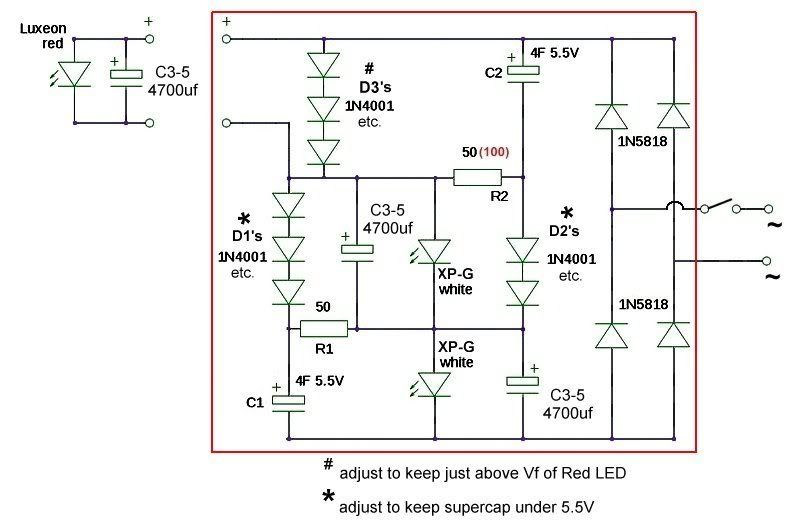

    Default Re: Squeezing the power out of a Supercap
    C2 will provide some smoothing, C1 hardly any.
    It would not be hard to put a smoothing cap across +Vcc and Gnd, that would ameliorate flicker but won't cut it out.
    For what it's worth, I still counsel against having all 3 LEDs in series, this is what will eat up the energy for the Red. When stopped, C2 effectively tries to power the whole circuit, whereas C1 can only power the last white XP-G.
    Quote Originally Posted by jdp298 View Post
    I agree. You would need a big cap across the whole thing. I don't think it is worth it.
    As it is, the LEDS will still flash badly because even the caps are only supplying a few dozen mA between the rectifier pulses.
    De-flashing and standlights are two related, but different things - a bit outside the scope of this thread I feel. - my fault for mentioning it. My option is to use a push button to force the system into standlight mode briefly when cycling through pedestrians or close up behind cars.

    Hi Folks
    This is the circuit that Bandgap mentioned above, redrawn by me from his sketch (any errors will be mine ). I've spun the diagram around to give a more conventional +Vcc at the top, instead of sidey-ways-on
    The usual rider applies of adjusting D1's and D2's to keep the supercap volts under the max rating (5.5V for these caps).
    Bandgap also notes that ...... "this arragement has to be used with a bridge rectifier that blocks reverse flow. - because if Vcc is shorted to ground, up to minus 11V could be imposed across the middle white LED, which can usually only stand minus 5V. "
    Quote Originally Posted by Bobblehat View Post
    So once the circuit is built up, what's the best way to measure potential across each of these individual leds (to get the diode-drop string right)? Is is simply a matter of bridging them with a voltmeter and spinning the test rig?
    Quote Originally Posted by Savvas View Post
    Savvas
    Put the DVM across the supercap and cycle - if it gets to above 5.5V, add another diode in its charging string (eg, D1s for C1).
    Repeat for the other supercap.
    Diodes add about 0.6V drop. For 'half a diode drop' use a Shottky diode instead (around 0.4V).
    Then cycle hard and long to make sure there is no time 5.5V is exceeded.
    Use 1A diodes as they are easy to find - even though 0.5A would be enough.
    For reliability - DON'T go above 5.5V.
    If you only get 5.0V, then so be it if taking a diode out gives over 5.5V

  23. #143
    Hi Folks This is the circuit that Bandgap mentioned above, redrawn by me from his sketch (any errors will be mine ).
    Is anyone actually using this circuit? I'm curious as to how it is performing?
    Specifically:
    - what's are the F and R standlights like?
    - does the headlight suffer at all?
    - how many diodes were needed to get the cap voltages sorted out?
    Thanks,
    Savvas.

    I'm gathering parts now and will give a test report when built! It may take a little while to get them all. I decided on a complete new build of that circuit rather than taking my twin XP-G apart.
    I've an updated diagram with Bandgap's rear light safety diodes, some smoothing caps and the bridge rectifier drawn in, but I'm hesitating on posting it until tested ........ this thread might get a bit diagram heavy ..... but if anyone insists!
    I'm an insistent type (so I'm told) - Savvas
    Untested cicuit .....
    Remember that the series diode strings D1's, D2's, D3's do not necessarily represent the actual number of diodes needed, but show that you need to adjust the number, and type, of diodes to achieve the desired Vf (as per the notes in the diagram).

    The resistor is used to give a longer "on" time (at the expense of brightness) for the standlight. Two emitters and a 5.5V supercap powering just one emitter as the standlight seems a very good match.

    Problem is i've only got one emitter so the circuit Vf is only ever ~3.2v. Its a conversion of an old bulb lamp for a mate so getting clever with vregs etc isn't worth it and its only got room for one LED as i'm keeping the old reflector. It gives virtually no hot spot but as a get you seen lamp is should be pretty good.

    I'm getting slightly unexpected results... I'm running the lamp + supercap from a battery and regulator to test things and while connected to the batter the circuit sits about 3.2v once the power is disconnected the voltage drops to 2.7v, is this normal or is the supercap just taking a very long time to charge?
