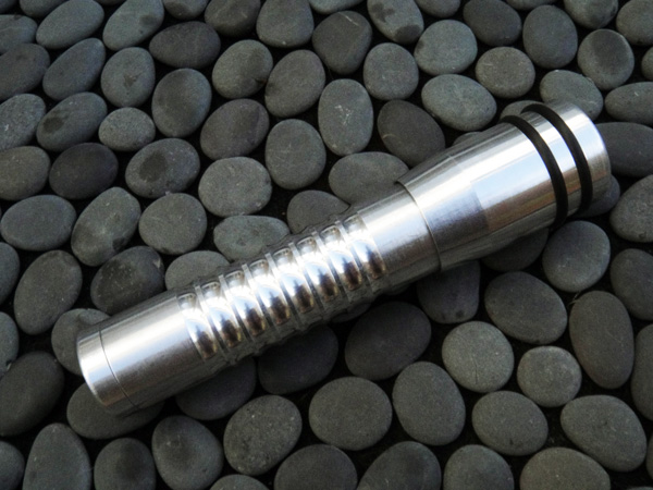

    might as well post the requisite teaser image. I haven't settled on an exact exterior design yet...but it will be something close to this. It's based on a single 18650 and will have either an MCE or XML driven @ 2.8 amps. First production models will have a Ledil Boom SS flood reflector. I like this grooving a lot and will probably proceed with this in the early stages. It's a full radius (round bottom) groove. I don't know about the head design yet. Obviously this has o-rings but I actually like a smooth head a lot. Oh, and they will be electroless nickel plated. This shot is raw aluminum. I'm also considering a full high polish...but that's a lot of extra hand work. Any thoughts on the appearance? Likes, dislikes, suggestions?
