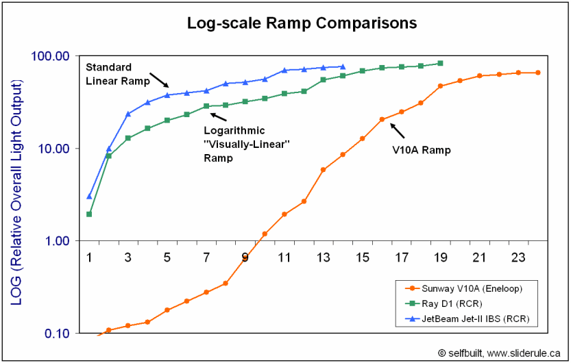

    The big question is whether the output selection of the V10A is "visually linear". Generally, here on the forums, that has been taken to mean a logarithmic ramp as opposed to an actual linear ramp of outputs. The reason for this is that we perceive brightness in a non-linear way (actually, not just brightness - most of our sensory perceptions are non-linear). This is why twice the lumens doesn't appear twice as bright to us - lumens are an objective (linear) measure of output, and our subjective perceptions are not linear.
    A logarithmic adjustment has long been used to adjust for our relative visual perceptions (e.g. the stops of camera are logarithmic). And like most here, up until now I have found that all continuously-variable lights with a logarithmic correction of output generally look "visually-linear". And then the V10 came along.
    To start, here is what the V10 looks like in my lightbox. To measure this, I slowly turned the ring at as close to a constant rate as I could manage, over ~25 secs or so. My lightbox collected output readings every second, and I then plotted the relative lightbox output against the estimated degree shift of the ring (i.e. with 360 degrees being a complete turn). Note the ring only turns about 1/3 the circumference of the light, or about 120 degrees.
    I have blown-up the first third of the ramp in the inset graph, to show you that output does indeed increase over the whole ring (albeit seemingly slowly at first). Now, you can certainly argue that the output trace looks like it could be logarithmic. Indeed, if you plot it on a log scale, you get something approximating a straight line. However, the V10A does NOT subjectively appear to me to be visually-linear when handling (e.g. it does indeed spend a lot of time at the very low outputs over the first third of the ring).
    Upon reviewing the scientific literature, I see that relative power relationships have superseded simple logarithmic corrections for linearizing our sensory perceptions. For perceived brightness, the currently accepted linearization method is actually a cube root of output. For a full discussion of this - including detailed graphs and primary literature references - please see my post #3 below.
    When plotting with a cube root transformation of my lightbox's output scale, you get the following graph:
    This graph MUCH better matches what I see by eye for the V10A, compared to a logarithmic plot. I have added the LiteFlux LF5XT to the graph, as it does both a linear ramp and a logarithmic step pattern. Max output on the LF5XT on 14500 is also pretty close to the V10A on Eneloop, which facilitates comparisons. The linear and logarithmic ramps of the LF5XT also pretty closely match my relative perceptions.
    The point to the above is to show that the V10A goes to much lower outputs than any other linear or logarithmic continuously-variable light I've seen before. It also betters matches what I subjectively see across the whole range of outputs on these lights. So for now on, I will also include this type of plot (along with standard linear plots) for all the continuously-variable lights I review.
    All that aside, I actually consider this dynamic range control of the V10A to be superior to a purely “visually-linear” ramp across the whole range. The logarithmic correction allows you to exquisitely fine-tune your low output selection. And once you get into brighter outputs, the proportional increase seems quite linear.

    Quote Originally Posted by HKJ 02-17-2011 07:44 AM
    As usual a good review, but you explanation of "visual linear" is flawed. The best way to see a visual linear ramp is to make the vertical scale logarithmic, then the brightness will follow a straight line in the chart.
    My flashlight information page: lygte-info (only some of the contents is in English).
    English part with lots of outdoor beamshots and flashlight reviews: lygte-info English

    Quote Originally Posted by selfbuilt 02-17-2011 08:33 AM
    Yes, that would be the way to represent a truly linear output ramp as "visually linear" in an output graph (since the eye sees things roughly logarithmically).But what I'm referring to here is not the representation of output ramps graphically, but rather the user's relative perception.
    It is not easy to describe in text, since the terms get confusing (i.e. a truly linear ramp appears to us as logarithmic, and a properly-construed logarithmic ramp would appear to us as linear).Most lights tend to have a linear ramp, and thus do not look "visually-linear" to us in use (i.e. the first panel in my schematic).A few lights have a logarithmic ramp, which most people consider "visually-linear" when handling (i.e. the second panel in my schematic).
    My point here is that the V10A does not produce a classic "visually-linear" (that is to say, current-logarithmic) ramp.But users complaining that the V10A is not visually-linear would be missing the point - it is not "visually-linear" in the opposite way to most lights.By that I mean the V10A spends a lot of time at the visually-low outputs.A typically linear-ramp spends little time at the visually-low outputs, while a logarithmic ("visually-linear") ramp spends a reasonable amount of time at the visually-low outputs (but much less than the V10A).
    I hope that is clear - again, it is hard to explain in words, hence my schematic to show the comparison of traditional linear/logarithmic ramps to the actual measured ramp in this case (all on linear scales).
    EDIT: Actually, I've revised my position somewhat on the V10A ramp - while I now believe it is logarithmic, it is not visually-linear at the lower outputs.A cube root power relationship better fits perceived brightness.See post #3 for a full discussion.
    Quote Originally Posted by selfbuilt 02-17-2011 09:36 AM
    I thought some actual data might help to clarify the point I was making above.Here is a graph comparing the V10A to a typical linear-ramp light (Jetbeam Jet-II IBS) and a "visually-linear" logarithmic light (Ray D1) with similar max output:
    Note the x-axis is not exactly the same thing in all cases (i.e. the V10A was turned manually, the other two ramps are over time).But both the x- and y-axes are consistently linear, which is what matters here.
    The point is to show that while the V10A is not "visually-linear" in the traditional sense (i.e. purely logarithmic), it is most certainly NOT the same as what people expect when think of a traditional linear (aka non-visually-linear) ramp.
    Sorry for the long explanation, but I have seen some complaining on the main forum that the V10A is not "visually-linear".Again, that misses the point that is in fact quite unique, and the opposite to what most non-visually-linear lights look like.It also quite functional for those who like to have a wide range of low modes.
    Quote Originally Posted by HKJ 02-17-2011 09:44 AM
    The V10A looks closes to being visual linear, try plotting them with a logarithmic vertical scale with two decades.
    On a logarithmic scale 0.1-1, 1-10 and 10-100 would have the same size on the axis, 0 does not exist on a log scale.
    Quote Originally Posted by selfbuilt 02-17-2011 01:33 PM
    Yes, plotting the V10A outputs on log scale would make it appear visually-linear on a graph.But that is NOT what users on the CPF mean by "visually-linear" - they mean it by their relative visual perception in actual use, not log-transformed data on a chart (which is what plotting on a log scale really means).
    Part of the reason for the confusion here may be that I am using a crude lightbox to integrate the overall output.The lightbox relative output measures are a roughly good indicator of what the eye sees.If someone were simply using a lux lightmeter to measure center beam throw, then it would be appropriate to log-transform the data (since lux is non-linear scale, and light decays inversely with distance).
    But given that my lightbox approximates what the user sees, plotting actual output is the only way to accurately portray the relative differences between ramping patterns.This would be heavily distorted by artificially applying a logarithmic transform to the already-integrated output data.In fact, here is the same graph on an output log scale:
    As you can see, the V10A looks "visually-linear" on the graph.But every other light in existence now looks horribly distorted - this is not how they appear in actual use (e.g. the Ray D1 really is "visually-linear" in real use, as the programmers used a logarithmic scale to compensate for our visual system).
    Of course, using log-transformed data for illustrative purposes is perfectly valid, as long as you recognized it's been transformed. But it would be very misleading in this context of comparing lights where the output has already been integrated in a lightbox.
    Take-home message is that my lightbox has already integrated the output, so the data needs to be plotted on a linear scale for comparison purposes.This can be empirically demonstrated by looking at the earlier ramping comparison in post #5 - my lightbox reports what you would expect for the Jet-II IBS and Ray D1, given the reported output ramping method used in those cases.
    Quote Originally Posted by HKJ 02-17-2011 01:54 PM
    For me visual linear follows a log scale. I have designed dimmers where I used the log scale and they where perfectly visual linear for me. In photo you also uses the log scale for exposure, one step is 1.4 times the brightness. RA light uses the same principle to make their adjustment visual linear.
    This has nothing to do with "integrating the output", but you will have to apply you linearization before doing the log plot.
    Logarithmic plots are often used, because it match our perception better. Try finding any plot of sound that uses a linear scale!

    Quote Originally Posted by selfbuilt 02-17-2011 07:03 PM
    No argument with your first point - I agree with you.But in your dimmer example, if you were to measure the variable outputs of your log-dimmed light, would you then plot it all on a log scale as well (i.e. take the log of the log)?
    That is what I am talking about here.If we take a light where the circuit designer has done the same thing - used a logarithmic scale for setting the outputs of a ramp to be visually-linear like your dimmer (e.g. Ray D1, Liteflux LF3XT, etc.) - and plot the outputs from my lightbox on a linear scale, we get a straight line (i.e. my Ray D1 graph in post #5).Taking the log of that gives you something that doesn't represent what you I see visually, and is not linear (i.e. the Ray D1 graph in post #7).
    In this case, taking logarithmic plots of everything that comes out of my lightbox does not match what I see, and doesn't match what the log-adjusted ramps were designed to do (i.e. produce visually-linear outputs).As such, I will stick with linear plots of my output data.

    Quote Originally Posted by HKJ 02-18-2011 09:25 AM
    Plotting a logarithmic quantity in a logarithmic scale is not taking a log of a log, but showing a log in the best possible conditions. This is also very obvious in your curve, with the log scale you can plot all the points in a meaningful way, with a linear scale you have nearly half the points on the zero line.
    With the log scale it is also easy to see that this light has a very good brightness selection, except for the highest bit.
    You box does not produce a logarithmic output, to get a truelogarithmic plot, you would have to convert your lightbox readings to lumens,before plotting them in a log chart.
    You are welcome to stay with linear plot, but IMHO they are simply not as useful as a log plot and I believe that the V10A illustrates this perfectly. According to you lin plot the brightness on the V10 does not change visually before we are nearly halfway on the scale. According to the log plot is changes visually smoothly all the way, except at the brightest part of the turn.
    Quote Originally Posted by selfbuilt 02-18-2011 11:46 AM
    Originally Posted by tbenedictI like the look of those larger holes in the tail too.I look like paracord would go through it without a split ring (less scratching).Gosh I wish I had deeper pockets.
    Yes, they are quite large (but there is also only so much room around the tailswitch cover).They are also arranged exactly at 90 degree increments (would be better to have a couple closer together for a lanyard).
    Originally Posted by Outdoorsman5
    Question, can the control ring be turned with one hand, or is this a two-handed operation?
    Easily one-handed.
    Originally Posted by HKJYou box does not produce a logarithmic output, to get a truelogarithmic plot, you would have to convert your lightbox readings to lumens,before plotting them in a log chart. ... You are welcome to stay with linear plot, but IMHO they are simply not as useful as a log plot and I believe that the V10A illustrates this perfectly.
    I agree that my lightbox doesn't produce an exact logarithmic output.But nor does it produce absolutely linear output either (i.e. it doesn't linearly correlate to lumens, for example).FYI, for those interested, check out the link in the review text to my discussion of the correlational relationship of my lightbox to lumens, which seems to follow a power relationship quite well.
    At the end of the day, it comes to down to the empirical question - which plotting method bests matches the users' relative perception?
    The linear lightbox plots show a clear difference between standard current linear lights (which give an expected logarithmic pattern) and "visually-linear" logarithmic-driven lights (which give a roughly linear pattern).
    A logarithmic conversion (which would need to be applied to ALL lights) would give you a roughly linear pattern for the V10A.But it means every other light I've ever tested (including all "visually-linear" logarithmic-driven lights) are in fact all widely non-visually linear in real life.It also suggests that there is little difference between all those linear-driven lights and logarithmic-driven lights - the curves would look roughly similar.Put simply, this log-plotting option would mean that all those logarithmic-driven lights are in fact not visually-linear after all.
    On the basis of all the data I have collected over the years in this lightbox, I cannot persuade myself that the latter option is the best representation of relative perception.
    And as stimulating as this discussion has been, I think that will be (mercifully) my last comment on it.

    Originally posted by selfbuilt as post #28 on 02-25-2011:
    I’ve been going through the data for all the continuously-variable lights in my collection (including so-called logarithmic/“visually-linear” ones), and I think I can revise my earlier position on the V10A (and NiteCore IFE2, which shares the same circuit). I have also decided on a better way to graphically depict the difference, based on the currently accepted model of human perceived brightness.
    To explain my original conundrum, here is a direct comparison of the V10A to a light that does both a linear ramp and logarithmic step pattern, the LiteFlux LF5XT. Max output on the LF5XT on 14500 is pretty close to the V10A on Eneloop (i.e. facilitates comparisons). Below is a graph where the y-axis is common (relative output), and the x-axis has been adjusted to show the dynamic range of each ramp (i.e. scaled to put everything in direct context for comparison).
    Although not all so-called “visually-linear” ramps exactly match the LF5XT logarithmic steps, I tend to trust that LiteFlux does indeed have a proper logarithmic-adjustment to the outputs. The V10A/IFE2 ramp seemingly looks quite different.
    But it occurs to me now that this is not the best way to present the data, as the dynamic range of all the other continuously-variable lights is too narrow (i.e. they don’t go anywhere near as low as the V10A/IFE2). A better way to plot the difference would be to compare the ramps matched for output levels, like so:
    At this resolution, it becomes clear the LF5XT’s logarithmic steps correlate very well with the V10A, for the range where the outputs are comparable. So would the LF5XT (and other lights with logarithmic ramps) also look the same as the V10A if they driven to lower outputs? They may very well. So far, on the basis of this comparison, I think you could be justified in calling the V10A logarithmic after all – it is just that that it has a much wider range of low outputs not previously seen.
    The question is, are the V10A outputs “visually-linear” over the whole range? Clearly, the V10A is not linear in the linear plot of my lightbox's output readings. So should the lightbox outputs be plotted differently - like on a log scale, as some have suggested? Here's what happens if you do:
    Well, that certainly looks pretty linear for the V10A. The problem is, that is NOT how the V10A subjectively appears to me when handling. The linear plot is more correct in that the overall output doesn't change much over the first third of the dial. Also, the log plot is not accurate as to how the light seems over the last third of the dial either (i.e. the perceived output increases quite a bit toward the end, but the log graph is flat). Plus, the log plot doesn't represent how a traditional linear ramp looks either (i.e. it makes the regular LF5XT ramp seem like the output barely changes over the vast majority of the time ramp).
    So what's the problem here - how come the log scale doesn't accurately represent the perceived brightness over the full dynamic range of these lights? Note that the presumption here has always been that logarithmic = “visually-linear”. But up until now, we only had examples with a relatively narrow dynamic range (i.e. the V10A goes much lower than other lights with a logarithmic ramp). Does this relative relationship still apply over this much wider range?
    I know it sounds like heresy - but could logarithmic not be "visually-linear" over this wider range?
    Before you all hit the roof, I’ve looked into the scientific literature on visual perception and perceived brightness (that is, the relative perception of varying light output), and found an interesting story. Although generally agreed that perceived brightness is non-linear, the method for “linearizing” it falls into two camps:
    1. The Weber-Fechner Law calculates perceived brightness as a logarithmic function. This long-standing method dates back to the late 19th century, and seems to be the prevalent view here on the forums. It also seems to still be popular with amateur astronomers (for low-light viewing of stars through telescopes), and of course many shutter bugs are familiar with it as the basis for photographic light stops. The problem is that while it serves as a good general guideline, it is known to yield wide margins of error across different levels of light output (the limitations of the method are also long-standing - see for example the 1924 paper (ref #4) in my reference list at the end of this post). The general view in the perception field seems to be that a logarithmic-based Weber-Fechner conversion has been superseded by the Stevens' Power Law.
    2. The Stevens' Power Law is a revision of the general Weber-Fechner law based on actual measurements over a much wider range of sensations (including vision). It calculates perceived brightness as a power function, with a specific power exponent derived for different types of stimuli. Although this method is relatively newer than the Weber-Fechner Law (i.e. first published in the late 1950s), it has been refined over the years under a variety of conditions, and is now the accepted method for calculating linear brightness more accurately. It is widely used for calibrating modern display devices (such as computer monitors and TVs), as well everything that plays on them (i.e. computer graphics, games, 3D modeling, etc.). The wiki link above shows you the measured power exponents for perceived brightness of different light stimuli (e.g. point source, etc.). For our purposes, the relevant comparison for the output of a flashlight beam is the perceived brightness of a "5-degree target in the dark" (i.e., with a uniformly dark background), which is calculated as the cube root of the total light output (i.e. power exponent of 0.33 in the wiki table). FYI, this stimuli choice and power exponent is also the basis for modern computer color brightness scaling.
    Also, I should note that Stevens (and others who followed) were not the first to observe a cube root relationship for perceived brightness - I found one reference going back to 1927. Most of the modern literature reports a Stevens exponent for perceived brightness somewhere between 0.25-0.35, with 0.33 (i.e. cube root) the most common. See reference #1 below for a good summary and references.
    So let's see how the lights above look when transformed to a cube root output scale.
    Now, that is a lot better, IMO. No, the V10A ramp is not "linear" on the graph, but it much better represents what I see when handling the V10A. It is also a lot better for depicting the relative perception of the LF5XT ramps.
    I realize many may not like the implication of the last 50+ years of reserch that a cube root power relationship (i.e. Stevens' Power Law) is more linear for perceived brightness that logarithmic (i.e. the older Weber-Fechner Law). But that is what the literature suggests, and fits with my relative perception of all these ramping lights. Don't shoot the messenger!
    For those interested, here are some some links to full-text academic research on the subject:
    1. Does Stevens's power law for brightness extend to perceptual brightness averaging? Ben Bauer. The Psychological Record. 2009, Spring.
    2. Perceiving the Intensity of Light. Dale Purves, S. Mark Williams, Surajit Nundy, and R. Beau Lotto. Psychological Review. 2004, Vol. 111, No. 1, 142–158
    3. A probabilistic explanation of brightness scaling. Surajit Nundy and Dale Purves. PNAS. 2002, Vol 29, No. 22, 14482–14487.
    4. The Visual Discrimination of Intensity and the Weber-Fechner Law. Selig Hecht. The Journal of General Physiology. 1924
    You can also find a general discussion in the online textbook Sensation and perception by E. Bruce Goldstein, 2007.
    In any case, I am just trying to find the best way to graphically compare the difference between light ramps. I think the cube root scale better resolves the relative perceived difference between ramping patterns, and I will be including it along with linear plots in this and future reviews of ramping lights.
    The key point remains – the V10A/IFE2 look very different from other continuously-variable lights, because of their ability to ramp to ultra-low outputs not previously seen.
