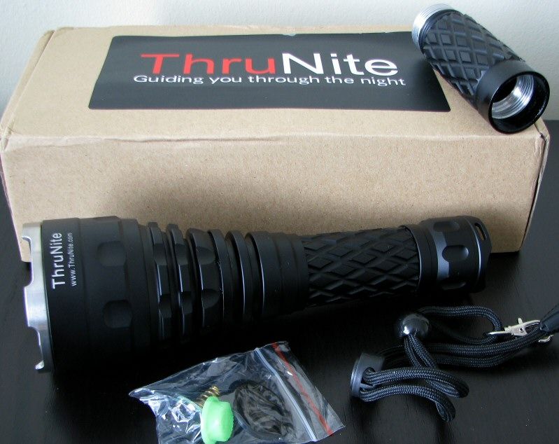

    Packaging is similar to the earlier Catapult lights (i.e. simple cardboard case with cut-out foam). As before, inside you will find the light, extension body tube, warranty card, wrist lanyard, spare o-rings and extra tailcap clicky switch and GITD boot cover.

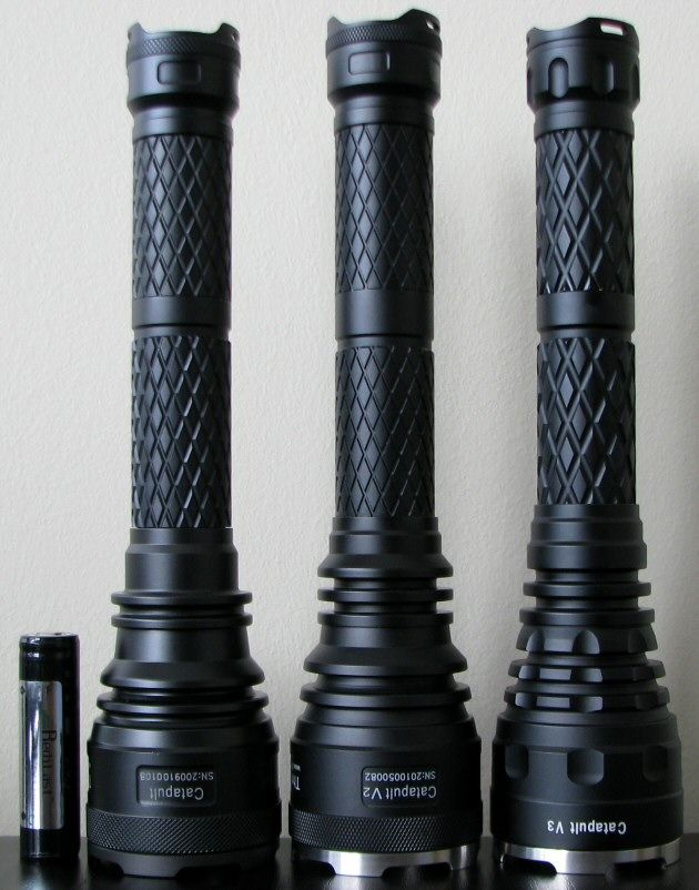

    There have been some cosmetic changes to the body plan of the V3, as shown below.
    From left to right: Redilast 18650, Catapult V1, Catapult V2, Catapult V3.
    All dimensions given with extra battery extender in place, but no batteries installed:
    Catapult V3 XM-L: Weight: 434.8g, Length: 254mm, Width (bezel) 58.0mm, Width (tailcap) 35.1mm.
    Catapult V2 XM-L: Weight: 438.2g, Length: 255mm, Width (bezel) 58.1mm, Width (tailcap) 35.0mm.
    Catapult V2 SST-50: Weight: 446.4g, Length: 254mm, Width (bezel) 58.0mm, Width (tailcap) 35.0mm.
    Catapult V1 SST-50: Weight: 410.5g, Length: 250mm, Width (bezel) 59.0mm, Width (tailcap) 34.4mm.

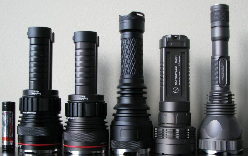

    Since the overall size and dimensions haven’t changed much from the V2 XM-L, here are some additional pics showing how the Catapult V2 compares to other lights (for rough size comparison):
    From left to right: AW Protected 18650, Thrunite Catapult V2 XM-L, Catapult V2 SST-50, Olight M31, JetBeam M1X V2.
    From left to right: AW Protected 18650, M3C4 XM-L, M3C4 SST-50 (OP), Thrunite Catapult V2 XM-L, Sunwayman M40C, JetBeam M1X V2.
    Detailed Catapult V3 XM-L pics:

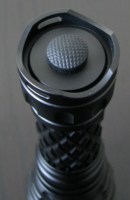

    The main changes from the V2 build are the cosmetic touches to the styling at the base of the head and tailcap, and the revised checkered pattern on the battery handle. The handle changes are the most significant, as the checkered pattern is now much more deeply cut, producing even greater grip than before (which was already quite high).
    The threading seems to have changed slightly as well, and the old battery tubes are thus not interchangeable with this new version. The thin bands of knurling at the tail and near the bezel are also gone now.

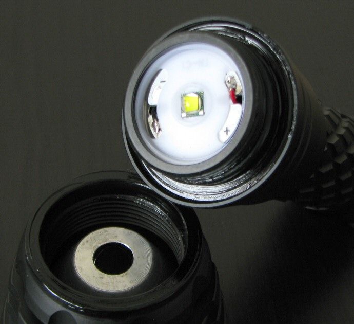

    Inside, not much has changed. There is still a spring in the head, battery contact cap in the tailcap, dual o-rings everywhere, and a stainless bezel ring. Body walls remain extraordinarily thick – you could probably run over this with a tank without damaging the batteries.
    Black anodizing (type III = HA) is similarly indistinguishable from previous versions. Lettering is brighter and thicker than earlier Catapults.
    The light can tailstand as before (the raised ridges also serve as attachment points for the wrist lanyard). My V3 sample was a bit wobbly if tailstanding when off, though no problem when on. The switch has a similar feel to before, and is fairly typical for standard forward clicky switch.
    Screw threads in the tailcap and on the corresponding battery tube remain anodized, allowing for lock-out. FYI, as before, the extender portion battery tube goes between the head and the main body tube, not between the main body tube and the tailcap (as is the case on most other lights). It’s important you don’t try to install it the wrong way, or it will interfere with battery contact (i.e. the anodized screw threads will be in the wrong place).

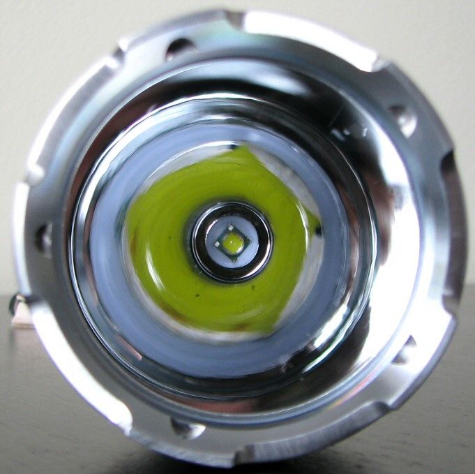

    The reflector and emitter look unchanged from the V2 XM-L version.

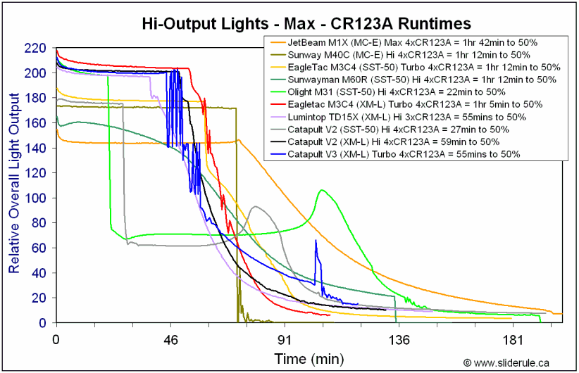

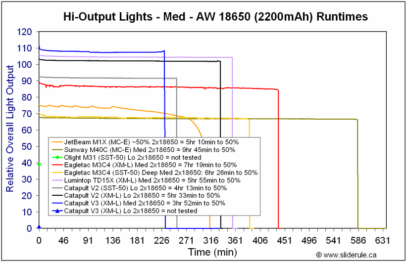

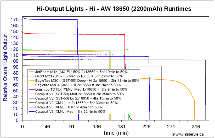

    Output/Runtime Comparison:
    As expected, there is no real change in performance on Max output. And the Hi output provides a convenient way to get extended runtime with just a relatively small drop in output.
    However, output/runtime effiicency has dropped on the V3 Med mode, compared to the V2 XM-L Lo mode (which has a comparable output level). Efficiency of the V3 Med/Hi modes also seems somewhat lower than other members in the XM-L class. But to put that in perspective, it is still more efficient than the SST-50-based V2.
    There is one new feature here - on Max, the light starts to cycle between Max and a lower level as the batteries near exhaustion (all batteries). This could be a useful signal to tell you it is time to recharge Li-ion cells, before hitting the built-in protection circuit cut-off (or over-depleting unprotected cells). It is also a lot less annoying than a strobe warning would be.
    As with many lights of this class, the light is heavily driven on Max, so I recommend you run it sparingly in this mode. Note the V3 has a built-in thermal cut-off sensor, which is a wise safety feature. But as before, 2xRCR should not be used on Max due to high discharge rate - unless you use IMR cells that can handle the current drain. 2xCR123A is now safe to use at all output levels on the V3, thanks to lower drive levels (this was not the case on the earlier V2 lights, where 2xCR123A was driven too hard on max).
    Although multi-mode, my V3 lacks a regular Lo (i.e. my V3 Lo = Moonlight mode, and V3 Med = V2 Lo).

    Thanks for another great review.
    Looking at the charts, I find it very interesting that nearly all the XM-L lights trump the SST-50 lights for overall output. (Not throw, which I'd expect on account of the smaller die-size)
    Is this because the XM-L produces more lumens per watt than the SST-50?
    I said nearly, because the one exception seems to be the Olight M31 (SST-50) which according to your max ceiling bounce (168) has an even highter output than the Catapult V2 XM-L (158). That kinda also begs the question as to why you have the same estimated max lumens of 760 for both of them?
    I have just purchased a Fenix TK35 which claims a maximum of 820 Ansi Lumens and does indeed look extremely bright on ceiling bounce to me.
    I'll be fascinated if you ever decide to review it or add its readings to the above chart.

    Quote Originally Posted by easilyled View Post
    The estimate ANSI lumen output is calculated from measurements in my lightbox at 3.5 mins into the run. I provide the ceiling bounce numbers as an alternate measure of output (although these aren't done at ANSI FL-1 time points, but rather only ~30 secs into the runs). The lightbox is far more consistent in what it reports, but it isn't a very good integrating device.
    In any case, I wouldn't worry about small differences in overall output between lights - most of the lights of a given emitter class tend to be similar in max output, it is beam profiles that differ the most.
    I will be reviewing the TK35 ... it will be coming up after the next couple of Thrunite reviews.
    Thanks, sorry for the confusion, that makes perfect sense.
    I'd still like your opinion as to why the XM-L emitter seems to increase overall output in the equivalent brands and in the vast majority of the lights?
    It certainly seems to me that this must be due to greater efficiency, although I understand that you may not wish to speculate on this matter and that its off-topic.
    We are all flotsam and jetsam being carried by a relentless tide towards our ultimate fate!
    6,936
    Default Re: Thrunite Catapult V3 (XM-L, 2x18650/4xCR123A) Review: RUNTIMES, BEAMSHOTS +
    Well, that's not always there case - there are a few late-model SST-50 lights that are as bright on max as the XM-L lights (e.g. Olight M31). But the XM-L lights invariably have a runtime advantage, especially as you go down to the lower levels. The only conclusion I can draw is that the current crop of XM-L emitters are more efficient than the SST-50s.
