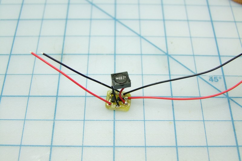

    OK, so I got some ZXLD383's to play with:

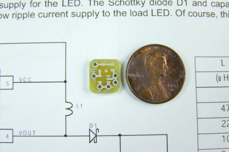

    I implemented this circuit, and I made my own PWB's as part of my most recent PWB pannel for the MagnetoDrive project:
    Here is my first board - not pretty, but it works:

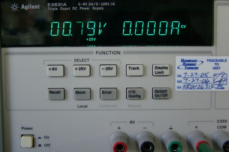

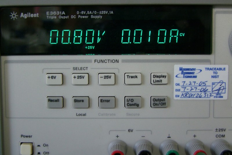

    Just as Justin pointed out earlier, these will not work down in the 0.5-0.6 volt range. Mine did not work at 0.79 volts, but started at 0.80 volts:

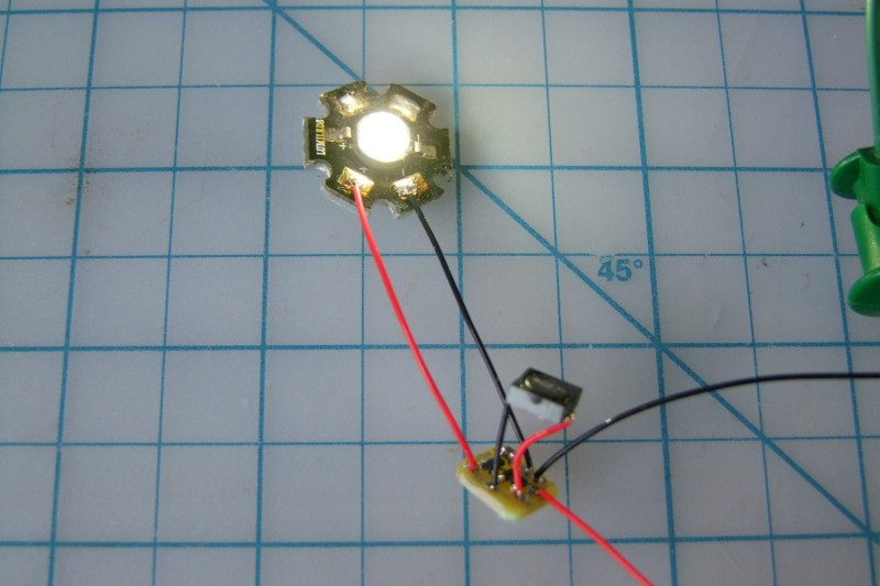

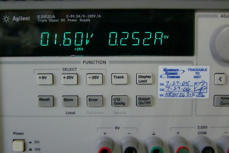

    Using a 4uH inductor, at an input voltage of 1.6V I had a healthy 250mA current going out of the power supply to an old 3W "U" bin Luxeon (remember those???):
    I will try to measure the current into the LED sometime later this week
    Will

    I know tables here loose all formating, but here is the Power_in vs. Power_out (and efficiency as Pin/Pout) that I got as I went from Vin of 0.8 volts up to 3.5 volts (where I was pretty much getting to a direct drive condition):
    (these values are all using the 4uH inductor)

    Yes, I worked from the Data Sheet, made my own schematic on Eagle CAD, did my own layout, ordered my own boards, the regulator, discrete parts, and soldered all of the parts myself. It is very time consuming to do all of it, but it is also fun stuff to do
    I have plenty of boards left, and I am willing to sell them if there is enough interest - either the bare board (you buy/solder everything on your own), or I can provide a completely finished board, ready to use. If you or anyone is interested, please send me email (in my signature).
