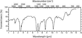

    I tried for some time to find a paint with a low carbonate load, in order to get a less dense mix when adding the BS. I didnt found it but recently I discovered a patented paint technology, called Lumitec (By Azko Nobel, different brand on each country) which seems to use BS as main load instead of carbonates. Just a guess, as manufacturer dont offer any detail on composition (protected info), but the fact is absolute white achieves a minimum reflection of 92% and (maybe thick layer may be close to 99%) with a lambertian reflection. Ivent tried it yet, although I plan to do it on next DIY IS, trying first it alone and adding a layer mixed with BS if reflectivity is not enough. That way should allow to spray the paint and get a uniform and flat finish. For those just trying to improve the lambertian reflection of their DIY IS, that paint could be a good way of getting it.
