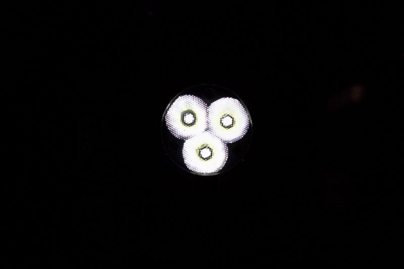

    I just received my 3up XM-L t6 boards and Ledil optics.
    I will post more as I get into the machining but here are some pics. I am happy with the build quality and the Ledil Cute optics look promising based upon firing things up with the bench supply.

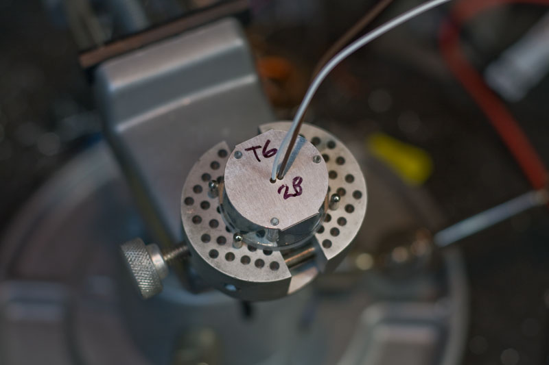

    Back of PCB and binning:

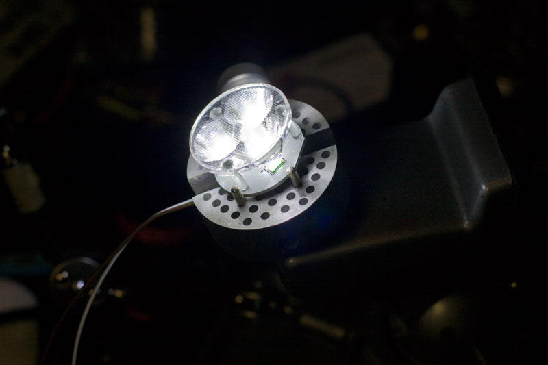

    It works! I tested it on the bench PS briefly and the vf was 10.3v at 3 amps:

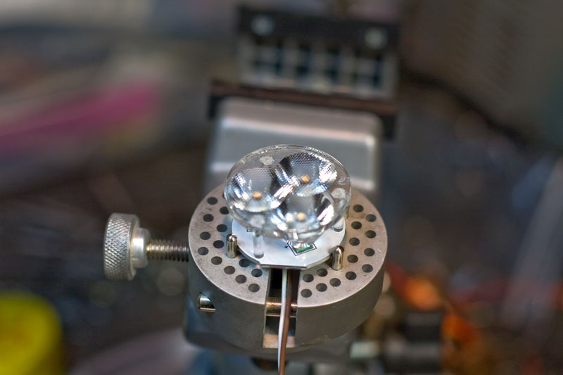

    Pic of the Ledil Cute SS optic:
    I will be using a Taskled h6flex driver and trick waterproof Vishay pot and basing it on my earlier 7up builds like this:
    That's it for now. Will post more after I get to make chips.

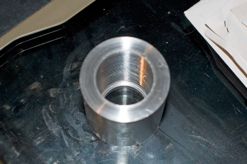

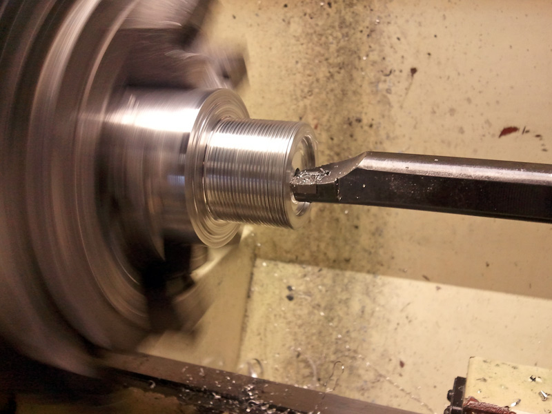

    I got the body machined, threaded and the heatsink done.
    heatsink machining:
    I threaded a long enough piece to build 2 or 3 lights for the heatsink.

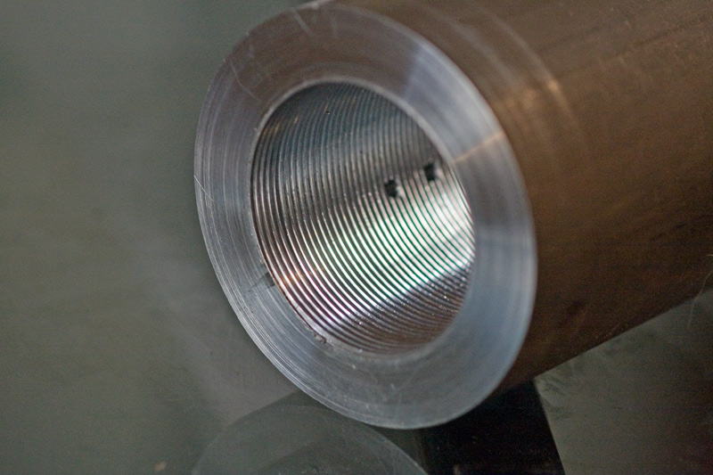

    Rough light body threaded:
    Close up of the threads:
    The 3up xml cutter pcb is on the heatsink. Next up is wiring the h6cc and cabling + the external pot + machining the back and the mount...
