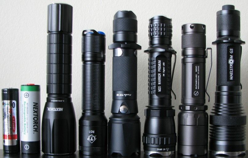

    From left to right: AW Protected 18650, Nextorch 18650, MyTorch 18650, ITP R01, Fenix TK15, Olight M20, Sunwayman M20C, 4Sevens Maelstrom G5.
    MyTorch 18650: Weight: 133.6g (no battery), Length: 154.2mm, Width (bezel): 36.0mm

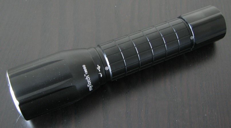

    The overall build elements are similar among the members of this MyTorch family. Overall dimensions of the 18650 model are in keeping with this class of lights.
    The MyTorch lights have distinctive styling. The overall pattern is very streamlined, with smooth lines and rounded edges everywhere. They are quite different from the more "tactical" appearance common to most other lights.
    The lights do not have traditional knurling, but instead feature a checked pattern along the body handle/tube. This provides some extra grip, but not as much as actual knurling would.
    The head and tailcap have raised flutes along their longitudinal axes. This feature provides very good anti-roll characteristics - I'm surprised no one thought of this before.
    Black anodizing (manufacturer claims hard anodized) is slightly glossy, and lettering is bright white and clear on the black background. I would have a preferred a few less labels on the 1AA version.

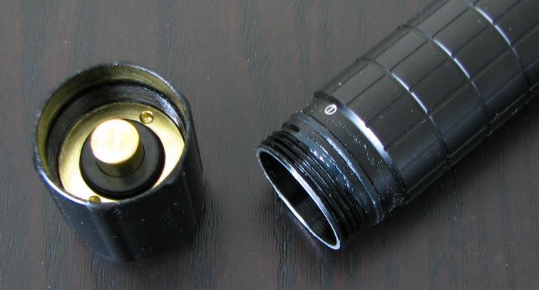

    Screw threads are rather fine, but are anodized at the tail end of the body tube, allowing for lock-out. The tailcap spring has a flat cover on it (to prevent scratching your cells).

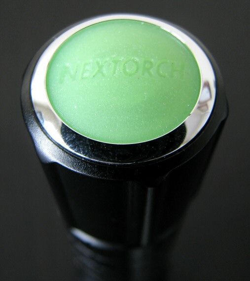

    The lights can't tailstand. However, I rather like the look of the projecting GITD tailcaps, which have a very rounded appearance with a shiny area around them (which feels like chrome-plated plastic?). Note the switches are all reverse-clickies.

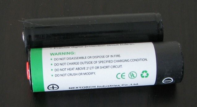

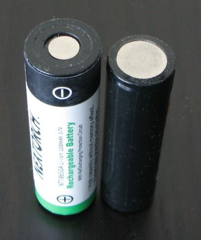

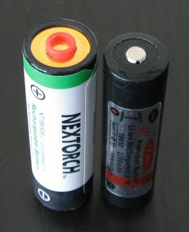

    So how does this custom battery compare to a regular protected 18650? Shown below in comparison to an AW protected 2200mAh 18650.
    The Nextorch battery is thicker and a little taller than a regular cell (i.e. expect some rattle when using a regular 18650).

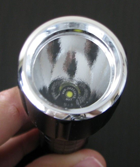

    Unlike the AA/AAA MyTorch models (which use the Cree XP-E emitter), the MyTorch 18650 uses a XP-G Cool White emitter (R5 output bin).
    The head/reflector seems to be about the same size as the MyTorch 3AAA. Thanks to the relatively deep reflector (MOP finish), I would expect decent throw for this light. You will also notice the centering disc around the emitter (with Nextorch name printed on it). A similar centering mechanism was used in my MyTorch 3AAA sample.
    BTW, the bezel ring (and tailcap ring) seem to be chrome-plated plastic. They are not made of metal.

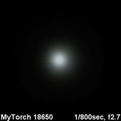

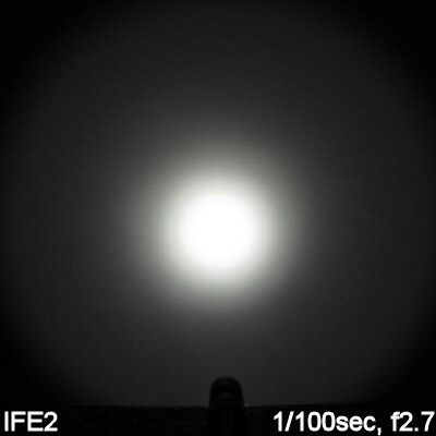

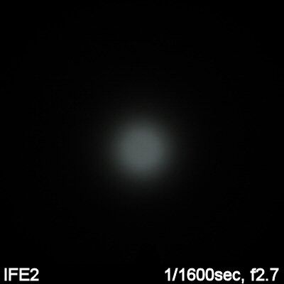

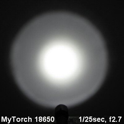

    For beamshots below, all lights are on Hi on 1x AW protected 18650 (2200mAh), about ~0.75 meter from a white wall (with the camera ~1.25 meters back from the wall). Automatic white balance on the camera, to minimize tint differences.
    Beam pattern is reasonable on the MyTorch 18650 – about fairly typical for an XP-G R5 light with a MOP reflector.

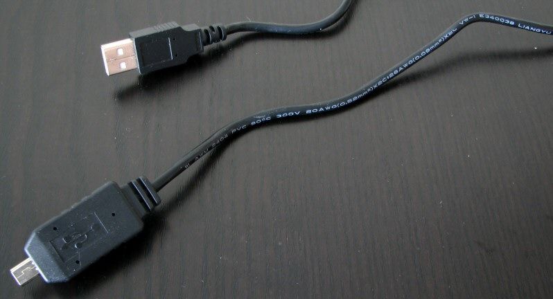

    The MyTorch 18650 comes with a different USB cable from the other models in this series. The USB included here is more heavy-duty (i.e. thicker), with a larger head at the mini-USB potion. The reason for this is that this cable also charges the Nextorch battery inside the light (whereas the other models simply use the USB cable to transfer settings).
    As with the other MyTorch models, the mini-USB end connects to the light just below the head. Note there is an o-ring around the base of the head, ensuring waterproofness at this end when the head is screwed back down for use. It is hard to tell if there is an o-ring around the point where the lens meets the bezel. Ultimate waterproofness is therefore unknown.
    The USB cable’s mini-USB end has an LED that lights up green as soon as power is supplied at the computer end. When connected to the light and charging the Nextorch battery, it turns red. When the battery is fully charged, the LED turns back to green.
    Charging time in my testing was a little over 3 hour, from the point where the protection circuit was tripped. This is rather impressive for a USB-based 18650 charger (i.e. slightly faster than my Pila IBC).

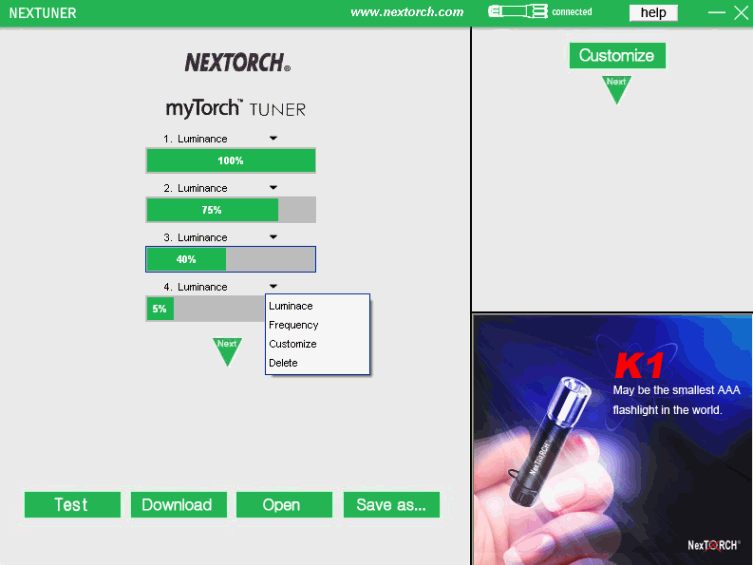

    Nextuner Software:
    The software is pretty easy to install and use (instructions are either included with the light, or are available for download on the Nextorch website).
    For the screenshot above, I have set the light to four constant output modes (100%, 75%, 40%, and 5%). This was actually my testing regimen for the runtimes (i.e. scroll down to see output/runtime graphs at these levels). To set each level, you move the green percentage bar to the right or left. Click on the green "Next" indicator to add more modes.
    If you click your computer cursor over the white pull-down indicator tab at the right of each mode, you will see the above dialogue box showing your options for that mode. "Luminance" refers to constant output modes, "Frequency" for strobe modes, "Customize" for signalling modes, and "Delete" to remove that mode.

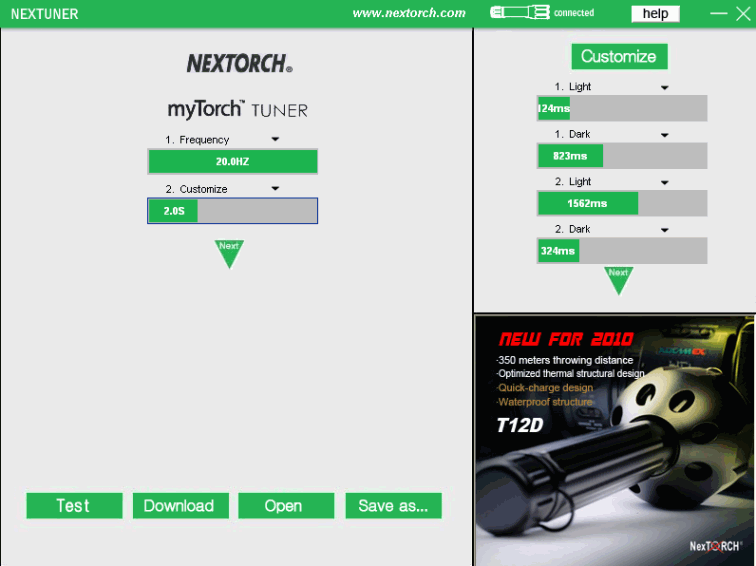

    In my second example above, I have set the light to two modes: a 20 Hz Strobe mode, followed by a customized signalling mode. When you select a Customized mode, the area on the right of the screen opens up, and you can choose the number and type of signals that occur (i.e. set as light/dark intervals with millisecs assigned to them by the movable green bars). Here again, you can add as many interval modes as you like with the green Next arrow button.
    When you are done setting up the light, you have the options to "Test", "Download" or "Save as ..." (bottom left of the screen).
    "Test" is actually quite interesting – since the light is connected through the USB cable, pressing this button turns on the light on and lets you see what each mode looks like. Simply click on a given mode to see the light perform that setting.
    "Download" refers to saving the settings to the light. This is necessary to program the light before disconnecting the USB cable.
    "Save as ..." refers to saving a copy of the programming as a file on your hard drive. I strongly recommend you do this before exiting, as the software has no way to read the existing settings from the flashlight. If you don’t save a copy to the hard drive, the next time you run the software you will need to start all over again from scratch in building the modes. Accordingly, you can start a session by choosing "Open" from the menu at the bottom, once you have pre-saved a configuration set.

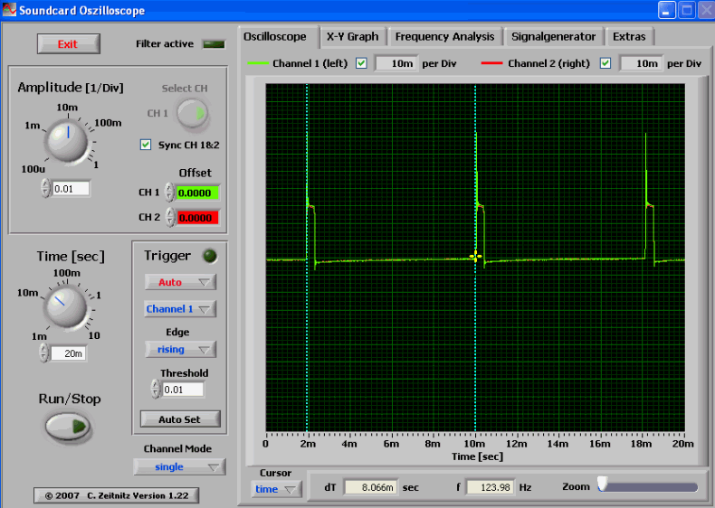

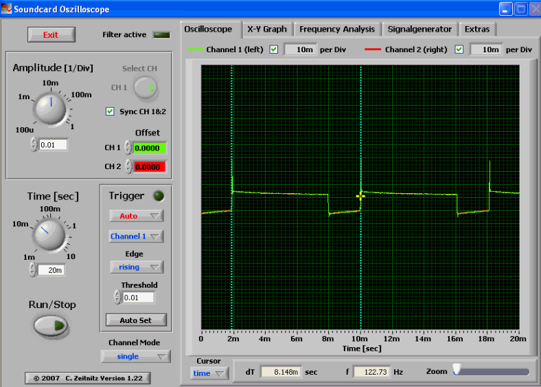

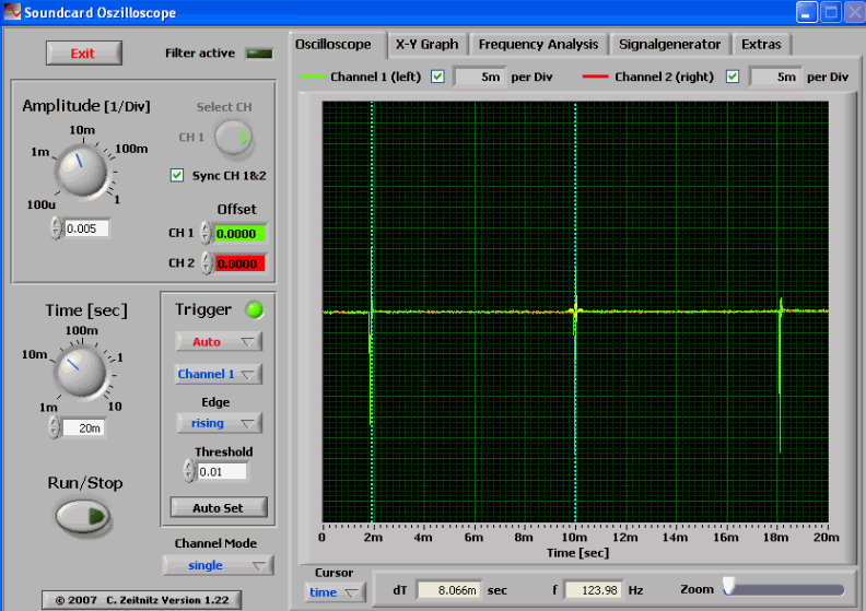

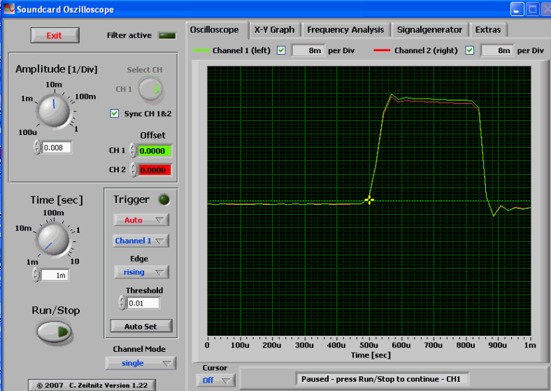

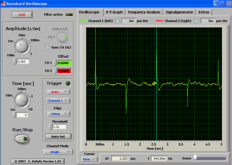

    PWM
    As expected for fully-programmable lights, I found all MyTorch models used pulse width modulation (PWM) for the sub-maximal outputs. Below are representative 75% and 5% output PWM traces.
    Like the other members of this family, the MyTorch 18650 uses ~124 Hz PWM in all modes between 5% and 99%.
    Oddly, I didn’t find this level of PWM as disturbing as I normally do (and I am typically quite sensitive to it). I suspect Nextorch must be using some sort of circuit filter to reduce the visible impact of the PWM.
    In support of this theory, I could also detect a clear negative deflection at this same 124 Hz frequency on the max 100% mode of all lights, as shown below.
    Here it is a blow up of the 100% signal, followed by a blow-up of the 5% PWM:
    Whatever this negative deflection at 100% represents, it is definitely not PWM (e.g. there is no visual distortion pattern when shining on a fan, for example). I would have to let those with more knowledge of circuit design try to explain this finding. The end result is that the PWM is not as apparent as I would expect for the frequency.

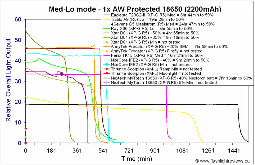

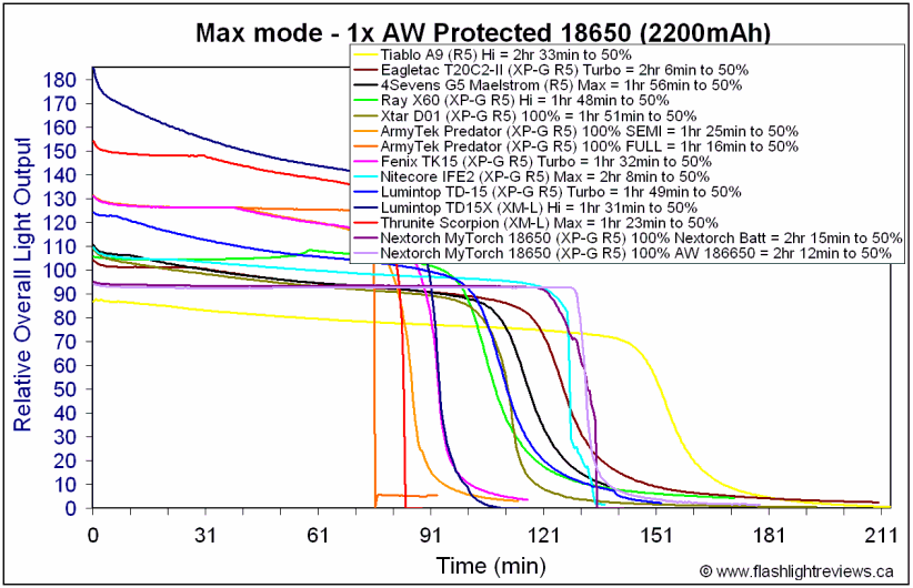

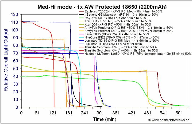

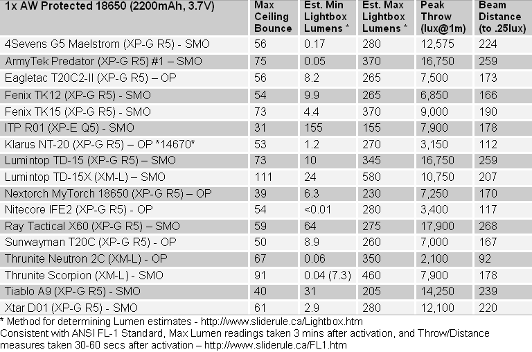

    All my runtime graph output numbers are relative for my home-made light box setup, a la Quickbeam's flashlightreviews.com method. You can directly compare all my relative output values from different reviews - i.e. an output value of "10" in one graph is the same as "10" in another. All runtimes are done under a cooling fan, except for any extended run Lo/Min modes (i.e. >12 hours) which are done without cooling.
    As you can see above, throw for the MyTorch 18650 is reasonable for the class. Overall output at the low end of this class.
    My first runtime observation is that the capacity of the included Nextorch battery is very similar to a standard AW protected 2200mAh. The main difference is when the cells are nearly exhausted and fall out of regulation. The Nextorch cell tripped its built-in protection circuit once output had fallen to about 1/3 original output, while the AW cell continued into a long moon mode of very low output. Frankly, the clear termination of the Nextorch cell is a good sign.
    Runtime performance on Max is right where you would expect for an XP-G R5, given the output level. Regulation pattern is excellent.
    At the lower output levels, relative efficiency drops to the lower end of the XP-G R5 class, but is still quite acceptable.
    Max output is at the low end of the 18650 XP-G R5 class. Ability to take higher voltage 2xCR123A/RCR is unknown (no mention of support by Nextorch, so I did not attempt).

    MyTorch uses mini-USB conector, not micro-USB.

    Bezel was made from chrome-plated plastic.
    Fixed.

    MyTorch registered as HumanInterfaceDevices on windows computer and reserved 100mA current,
    but draw ~500mA, violating USB-specs....
    I was curious about that too, as I thought 500mA was the max per port. But searching online, I have found references to 900mA as well.
    Also, I note the Wikipedia spec page cites a "Battery Charging Specification 1.1: Released in March 2007 (Updated 15 Apr 2009)" for USB 2.0 that includes this statement "If a USB device is connected to dedicated charger, maximum current drawn by the device may be as high as 1.8A. (Note that this document is not distributed with USB 2.0 specification package only USB 3.0 and USB On-The-Go.)"
    This isn't my field, so I'm not clear what the expectations are. But for all USB-based battery chargers, I always recommend using an AC-adapter instead (as I wouldn't want to accidentally fry one my computer's USB ports). But I'll expand a bit on my comments on this point in the review as well.
    Noted in my main 1AA/2AA/3AAA review thread under Potential Issues. But I'm thinking I should go back and add it to the body of the text there and here as well.

    ...I was curious about that too, as I thought 500mA was the max per port. But searching online, I have found references to 900mA as well.
    This isn't my field, so I'm not clear what the expectations are. But for all USB-based battery chargers, I always recommend using an AC-adapter instead (as I wouldn't want to accidentally fry one my computer's USB ports). But I'll expand a bit on my comments on this point in the review as well...
    Selfbuit, You are right.
    Using an AC-adapter is the way to go.
    As for the violation of USB specs:
    The issue with the MyTorch is, that it reserves only 100mA, but draws ~500mA.
    In case another current hungry device, for example USB-HDD, is connected to the same HUB, the bus-power may be overloaded.
    PC mainboards usually have self resetting fuses, but I have seen many notebooks with dead USB...
    Heinz

    Quote Originally Posted by HiltiHome View Post
    This is not something unique, lots of equipment draws more than 100mA without requesting it.
    Flashaholic HiltiHome's Avatar
    Nov 2005
    Germany
    232
    Default Re: Nextorch MyTorch 18650 (XP-G R5, PC-Programmable) Review: RUNTIMES, BEAMSHOTS+
    Indeed,
    But You will be pissed, if Your notebook quits USB-function.
    Heinz
    NexTorch proprietary battery is a copy of INOVA T4 battery.
    Nextorch OEM's the Inova T4 battery - and flashlight.
    Quote Originally Posted by MattK View Post
    Hmmm, that does explain the overall form factor and look of these lights. I thought they seemed familiar ...

    I guess you didn't pass the light under running water to check waterproofing? I just got one of these for review, and will ask Nextorch about O-rings on the front end (they claim ANSI FL-1 waterproof 1m...).
    Do you think the window is glass? I know they say it's acrylic, but it sure sounds like glass and doesn't scratch as easily as plastic (wiping with my shirt usually leaves swirls on plastic windows).
    EDIT: Got a response from NexTorch, the light is IPX7 rated, so there is probably an O-ring up front as well. Water should only get to the area between the bezel and window. Also, the window on the AA model is anti-scratch polycarbonate.
