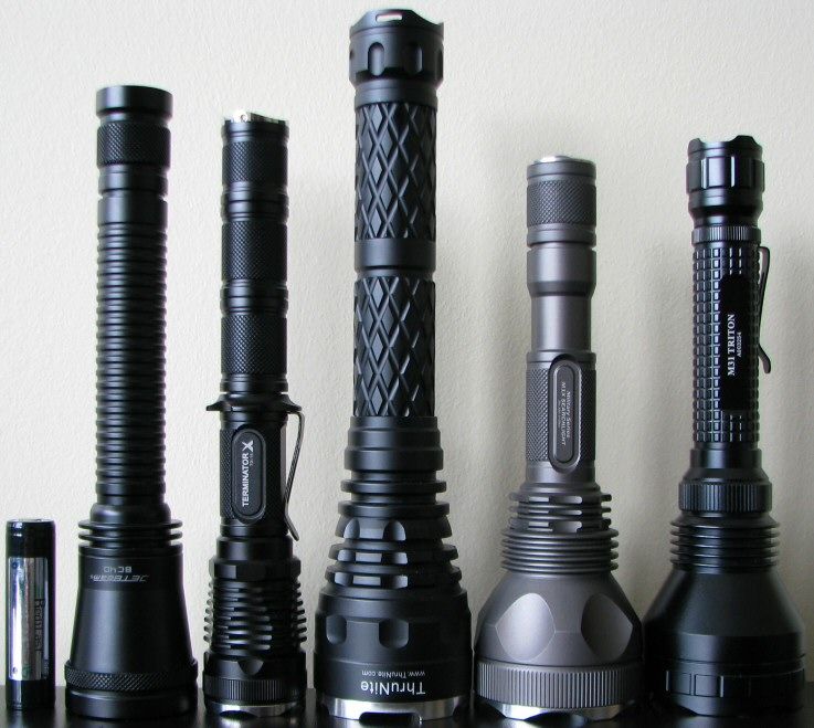

    From left to right: Redilast Protected 18650, JetBeam BC40, Lumintop TD-15X (2 extenders), Thrunite Catapult V3, JetBeam M1X (no extender), Olight M31 (no extender)
    BC40: Weight: 226.3g, Length: 224mm , Width (bezel): 48.5mm
    Catapult V3 XM-L: Weight: 434.8g, Length: 254mm, Width (bezel) 58.0mm, Width (tailcap) 35.1mm.
    TK35: Weight: 256.1g, Length: 162mm, Width (bezel): 48.6mm, Max Wdith 52.0mm
    M3C4 XM-L: Weight: 348.0g, Length: 164mm, Width: 61mm (bezel)
    As you can see, the BC40 is one of the lightest lights in this class. Overall dimensions are also quite compact for 2x18650 light (batteries end-to-end).

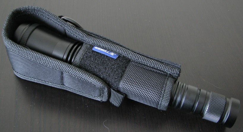

    First, a few comments about the holster - I quite like it. It is simple, easy to use, and even has a velcroed flap for attaching around a belt. Considering the extremely low price, it's remarkable they included one at all.

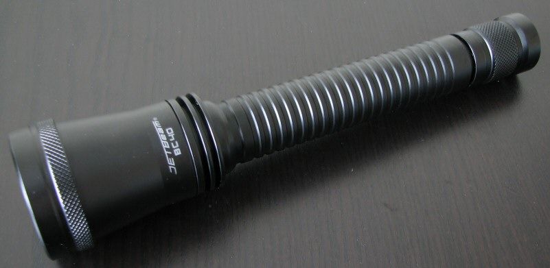

    The body plan of the BC40 is fairly straightforward. Overall, I find it reminds me of the classic Streamlight Strion/Stinger shape. I found it comfortable to hold and handle.
    Black anodizing (manufacturer claims type III = HA) is slightly glossy, and without blemishes on my sample. Lettering is clear and sharp, and reasonably bright.
    The light lacks knurling (except for a small band around the bezel), and instead has a series of thick-cut concentric rings around the body. Looks reminiscent of some McGizmo designs - but is quite basic here. These rings help a bit with grip, but I still find light somewhat slippery overall.

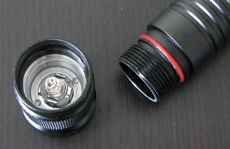

    Screw threads are square-cut (well, trapezoidal) and anodized at the tailcap, to allow for lock-out.
    Switch is a forward clicky, of similar design to other lights in the Backup family (and some recent NiteCore lights). The BC40 can tailstand.

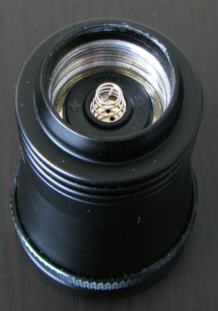

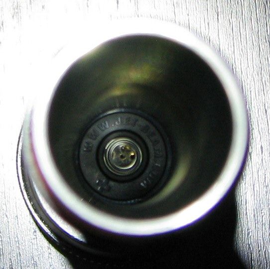

    Like all members of the Backup family, there is a physical reverse polarity device (plastic disc) in the head. But it would seem to be circumvented on the BC40, given there is a spring located in the center of it. Higher capacity flat-top cells worked fine in my testing.

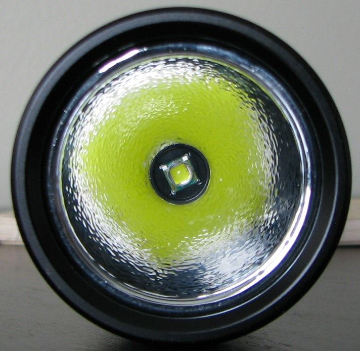

    The BC40 uses a Cree XM-L emitter, with a medium-heavy OP reflector. I would expect throw to be no more than average for the class, given the medium-sized head and OP reflector.

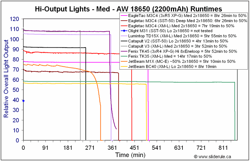

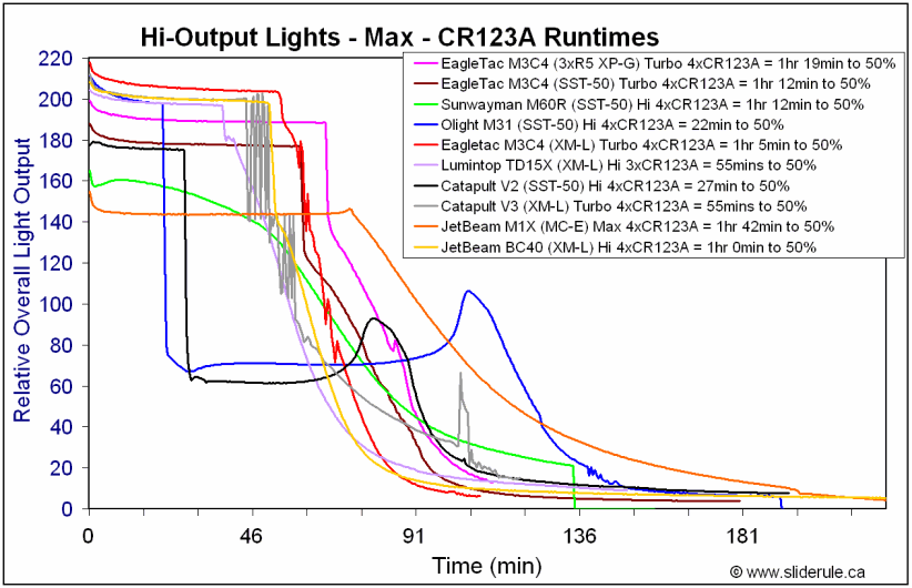

    Output and runtime on Hi are right in keeping with this class. On both 2x18650 and 4xCR123A, the light performed exactly as expected.
    On Lo, runtime was a little low compared to some other lights. Still quite reasonable, but not as effiient as the TK35 for example.
