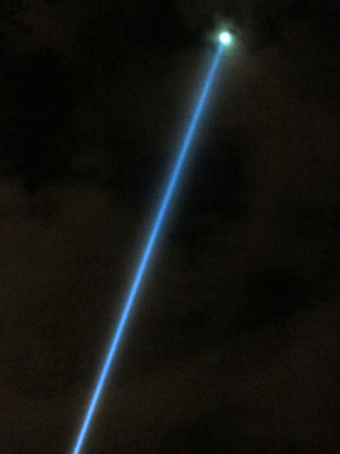

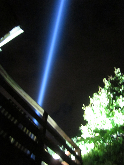

    Here's a shot of the 75,000 lumen beam. ..
    No actual beam shot of the clouds, I didn't take the pic. It's a very uniform circle on the clouds. Looking up at the beam is dizzying. I finally reached my goal of a portable light with the output of the SX-16 searchlight, but with half the power consumption (if you don't mind waiting a minute for start up).
    This is with a shallow 9.5" reflector. The lit up trees is all from the stray light which will be better utilized in the beam with the next prototype with a deeper 10.5" reflector with a bit shorter FL. Still will be under 10 lbs, that's a major goal for me. Strange how the stray light on the trees is white but the beam is so blue, but it's all the same light. The clouds reflect white like the trees. I don't understand the blue beam. I run it for about an hour at a time for temp tests, and during that time cars come sneaking up the road with their headlights off. Makes me chuckle.
    By the eye, it appears to have same exact throw (and beam color) as the Arctic Spyder 1W laser, which in itself is a pretty insane laser, but with them both on, the 1W laser is dwarfed.

    As for the blue beam, my light does the same, I think it's due to Rayleigh scattering, the beam is scattering light, not reflection,
    blue spectrum scatters more than other wavelength, thus beam of white light is blue but reflected light remain white. The same principle as why the sky is blue when sunlight is white.

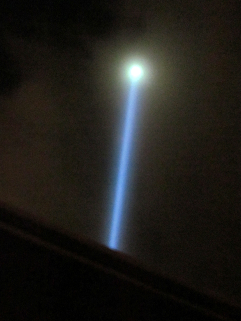

    Took some more beam shots last night. Again the cars came sneaking up. Maybe I'll leave it on for Halloween.
    Beam up close...
    From a bit further...
    From down the road...
    It puts a bright pin spot on the clouds surrounded by a bit of a flood.
