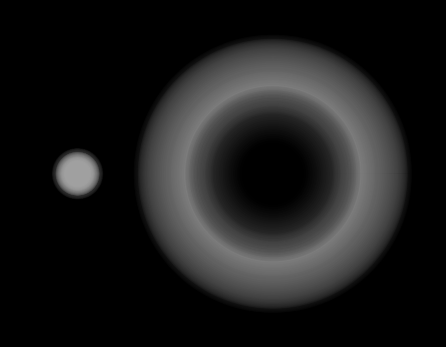

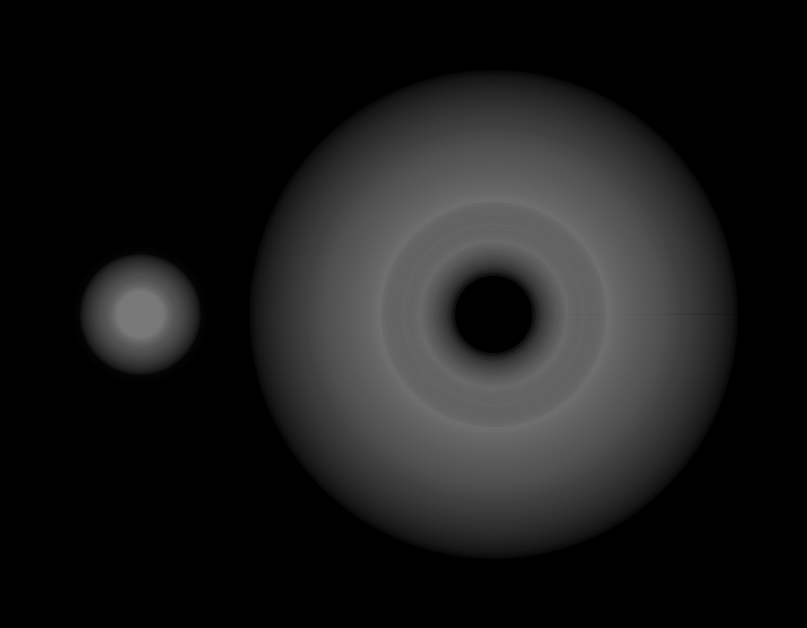

    I need some input please. As can be seen in the beamshots, at full focus the current beam profile has a little mini flood around the center beam. I've optimized the design so that over 90% of the light output is contained within the beam and mini flood at full focus. That is why you see the cloud bounce. Most designs are much less, around 55% at best. Even the SX16 is under 55% and the Maxabeam is has very small percent of light within the actual beam, and its beam quickly dissipates in flood mode.
    Alternative to the current design, I could instead make the light have absolutely zero mini flood while still having 90% of the light contained within just the beam. This would boost candlepower by a third. But as always, there's a downside. There will be a much more pronounced center hole when using the light in flood mode.
    To compare, I've modeled the two designs under full beam focus and under flood.
    Here's the current design. Notice mini flood around center beam at full focus, as seen in previous beamshots. (full focus next to 15 degree flood)
    Here's the alternative design for full beam concentration and 1/3 more candlepower (full focus next to 15 degree flood)
    As you can see, the alternative has a much more pronounced center hole under flood. 1/3 more candlepower is a heck of a lot, it's essentially a 205471mW white laser. It would surely put the light over the 50M CP mark, even over the 100M CP mark with a 300W 1mm gap P-VIP lamp, but then again I'm not going for candlepower king, this is for usability. Might consider an add-on diffuse lens when using flood to help with the center hole. Can I have some input please?

    I like the alternative design myself. Keep up the great work!!

    For me, the alternative is also the choice. I'm not sure I'd be using the light in flood mode. Long live the get-lit laser!

    Thanks for the quick feedback. I was half expecting comments like wow that flood hole is atrocious. I'll proceed with this method. Happy Holidays!

    Go for maximum throw, it is a waste of effort to go for a compromise.
    It is more important to have 1 - 5 degree range then to have 1- 10 degrees.
    It is so easy to make a 'diffuser' from sanded glas if you like to have flood.

    Agree, who cares about the flood

    Go for the alternative super throw beam. The heck with flood. If you are using short arc focus that baby all the way!

    Go for super throw. A difusser can be added later.

    GO for the THROW!!
    This seems pretty unanimous, LOL.
