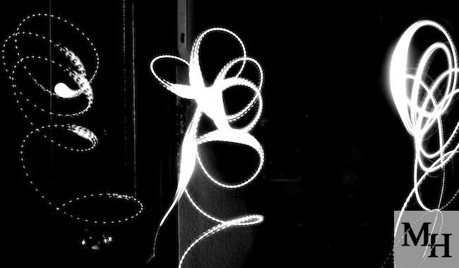

    Default Re: PWM - What is it, How does it work and how to detect it.
    Here's a picture I took of a 123≤ Tactical (R2) before I sent it back because the flickering was so bad.
    On the left is "moonlight mode", middle is "low", and on the right is "medium". "High" and "max" showed no flickering.
    After I got so fed up with the flickering I sent it back and got the S2 123≤ Turbo, which as I said, flickers on the "medium" level. My 123≤ Tactical warm white flickers on "low" and "medium", and my RGB neutral flickers on "moonlight".
    I have a Mini AA and its PWM is much higher frequency than the flickering coming out of the Quarks.
    From what I remember about the thread that discussed this issue, the flickering is not so much a sharp "on and off" cycle, but rather an "on and fade" cycle.

    Nice picture! that's almost art, but what is shown here is definitely PWM. I have never seen such bad PWM on any of my 4sevens lights, but there are people who could say a lot more about 4sevens and the use of PWM.
