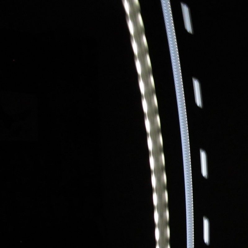

  12. #102
    Default Re: PWM - What is it, How does it work and how to detect it.
    Quote Originally Posted by mhphoto View Post
    Here's a picture I took of a 123≤ Tactical (R2) before I sent it back because the flickering was so bad.
    On the left is "moonlight mode", middle is "low", and on the right is "medium". "High" and "max" showed no flickering.
    After I got so fed up with the flickering I sent it back and got the S2 123≤ Turbo, which as I said, flickers on the "medium" level. My 123≤ Tactical warm white flickers on "low" and "medium", and my RGB neutral flickers on "moonlight".
    I have a Mini AA and its PWM is much higher frequency than the flickering coming out of the Quarks.
    From what I remember about the thread that discussed this issue, the flickering is not so much a sharp "on and off" cycle, but rather an "on and fade" cycle.
    Quote Originally Posted by Cataract View Post
    Nice picture! that's almost art, but what is shown here is definitely PWM. I have never seen such bad PWM on any of my 4sevens lights, but there are people who could say a lot more about 4sevens and the use of PWM.
    Could that be a failed storage device (blown cap or inductor overheated and short cct) in the switching regulation ?
  13. #103
    Flashaholic* Cataract's Avatar
    Apr 2009
    Montreal
    4,097
    Quote Originally Posted by Yagon View Post
    Yes, it could be a blown or defective component (also including frequency pulser), bad solder or cracked board whether the problem was from manufacturing, shipping/handling, overheat of even freeze. I dropped my 4 sevens lights many times with no such issue though, so I tend to think it was a defect from the manufacturing side. This kind of problem might be hard to catch during QC since the light generally behaves the way it should.
    Cataract, Shiny things specialist.

  14. #104
    Do you mean the cmos switch ?
    Thought that would either fail open or closed cct .
    Doesn't have to mean a manufacturing error(of the flashlight) too , it could simply be a case of infant mortality of the component .
  15. #105
    Apr 2009
    Montreal
    4,097
    Yes; I've seen CMOS and other types of clocks ticking at the wrong rate because of manufacturing defects or because the signal wasn't steady enough (because of a manufacturing defect again) for other circuits to function normally and even because of premature death of only part of the IC. Most of the time things are black and white with modern IC's, but not always...
    And yes again, it could be premature death of some component. 4Sevens is not necessarily to blame on this, but a faulty solder or trace could possibly cause this type of problem too; I've seen weird stuff in my career. Without their blueprints on hand it is hard to rule out anything for sure, and even then... That's why manufacturers usually want to have the defective product back; so they can find out what went wrong and prevent it from happening again.

    I managed to grab this image of three lights. The one on the left is my Quark 123^2 Tactical, wearing a filter to remove green and make it more neutral. The center is an ITP A2 Eos, known to be in the 2K+ Hz range. The last is the notorious 100 Hz Fenix L0D. They are all on their medium level.
    I would give the Quark, based on the Fenix being 100 Hz, about 350 Hz. I somehow don't get the graph linked by cave dave in the other thread, as it shows a full cycle in what is labeled about 0.5 ms, which would be 2 kHz. Yet he says it supports his guess of about 200 Hz. That was measured by HKJ, and I am guessing it is the non-objectionable artifact that David speaks of in a light which does not exhibit this "PWM-like" behavior.
    Here is another pic with just the Quark, in which I really cranked up the speed I swept the light. This emphasizes that the brightness is indeed not going to zero, just getting a lot dimmer, so this is not PWM. On the Fenix, it is clear that the light goes completely dark between cycles.

    Great pics guys! I really like the idea of holding multiple lights together so you can have a fairly precise number on frequency based on a known one (provided you take the time to count all the bright spots)
