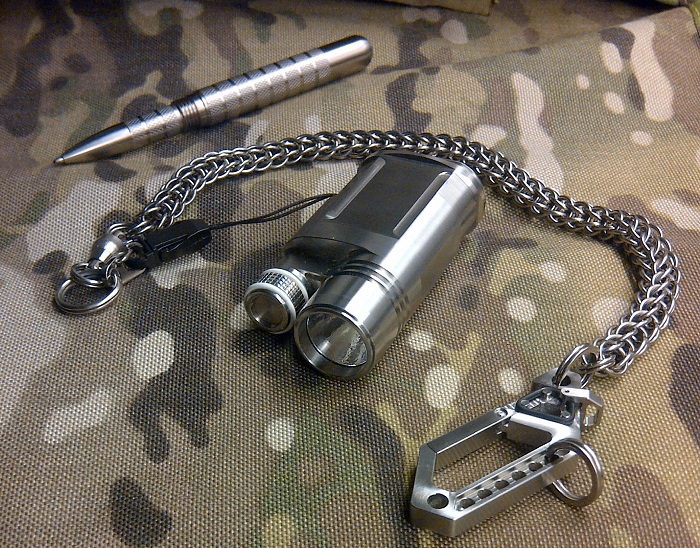

    What color o-rings do you all prefer on your SPY? I have a whole bunch in a lot of different colors, but so far I prefer either bright white or royal blue. I'll try to post pics later...
    (I know this is an old thread, but I thought it would be better than creating a new thread about the same topic...)
    Blue rings today...(I made the chain myself, btw...)

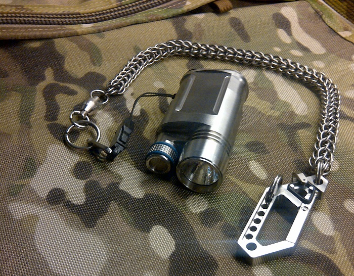

    And white rings today...

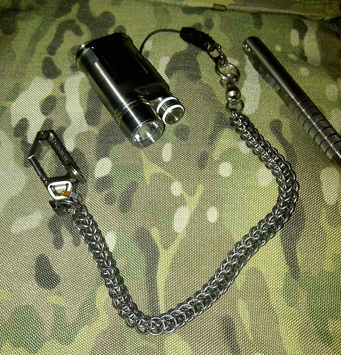

    I decided to try out the white rings on my droid biner last night...
    And I left them on there because they look cool...
    I've found that 011 rings are a little easier to work with...and it makes me appreciate the lock-out feature a LOT. The 010 ones are a more snug fit and more difficult to install/remove (both on the 007 and the droid), but probably more low-profile as far as accidentally turning on in your pocket.
    For the droid, I didn't notice any difference in resistance between the 010 and the 011 rings.
