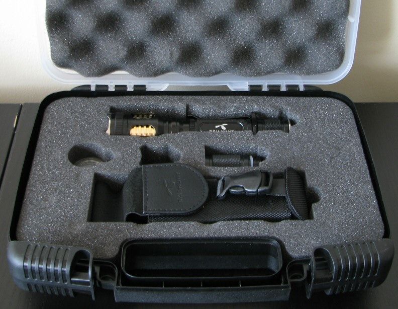

    Packaging is high-end - in a snazzy, plastic presentation-style carry case with cut-out foam (reminiscent of the high-end Olight lights). Carefully packaged inside you will find the light (removable grip ring and clip installed on my sample), battery extender tube, clip replacement cover, good quality wrist lanyard, good quality holster (adjustable for multiple models), o-ring lube (reminiscent of Liteflux), extra o-rings and tailcap cover, and manual.
    Skilhunt also included as a gift with my sample a hand-made paracord wrist lanyard. This is high-end lanyard, with a lot of attachment points.

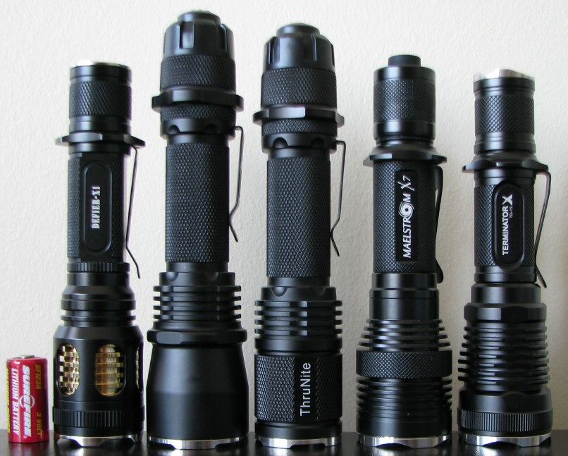

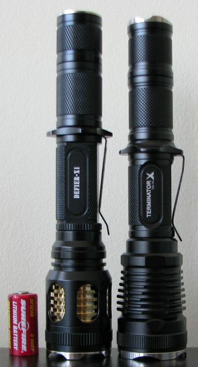

    From left to right: Surefire CR123A, Skilhunt Defier X1, Thrunite Scorpion V2 Turbo, Thrunite Scorpion V1, 4Sevens X7, Lumintop TD-15X
    From left to right: Surefire CR123A, Skilhunt Defier X1 (1 extender), Lumintop TD-15X (1 extender)
    X1: Weight: 155.6g, Length: 149.6mm , Width (bezel): 36.1mm
    X1 with one extender: Weight: 172.9g, Length: 185mm , Width (bezel): 36.1mm
    4Sevens X7: Weight 146.9g, Length: 151.5mm, Width (bezel): 38.7mm
    Thrunite Scorpion V1: Weight: 167.5g, Length: 168mm, Width: 35.1 (bezel), 37.0mm (tailcap grip ring)
    TD-15X: Weight 150.3g, Length 147.3mm, Width: 37.8mm (bezel)
    As you can see, the Skilhunt X1 fits in quite well in overall size with the 4Sevens X7 and Luminitop TD-15X. Like the TD-15X, it also comes with one bundled battery tube extender.

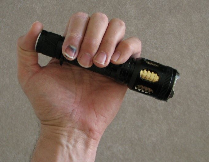

    Styling is of course quite distinctive on these Skilhunt lights. Those of you who have been around long enough may remember NiteCore's RaidFire Spear, which had a similar cut-out showing the heatsink:
    From left to right: AW Protected 18650, Skilhunt Defier X1, NiteCore RaidFire Spear, Skilhunt Defier X3.
    The Skilhunt lights are not as beefy as the Spear, which had a thicker and heavier build.

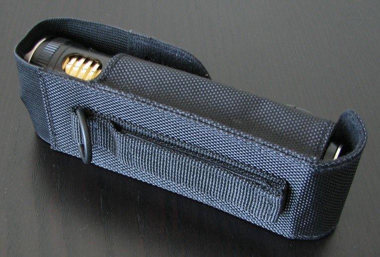

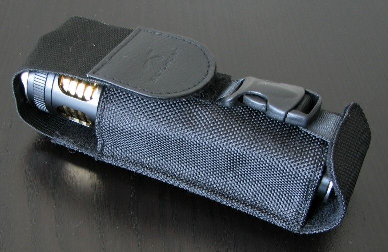

    First, a few comments about the holster. It is quite versatile, and can accommodate a range of light sizes given the attachment points and elastic bands. FYI, they seem to be using the same holster for all their models. But I personally think it best fits smaller lights in this 1x18650/2xCR123A size (i.e. like the X1 shown above). To use longer lights, you have open the bottom flap, which leaves the end-bit dangling somewhat.

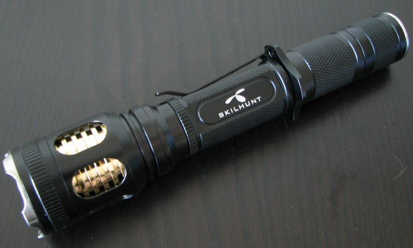

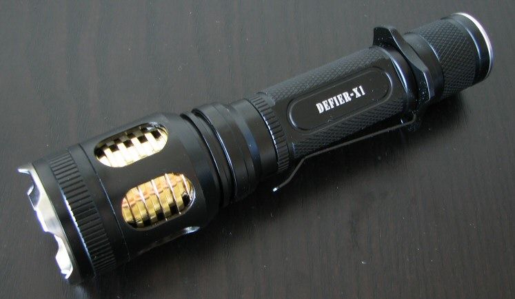

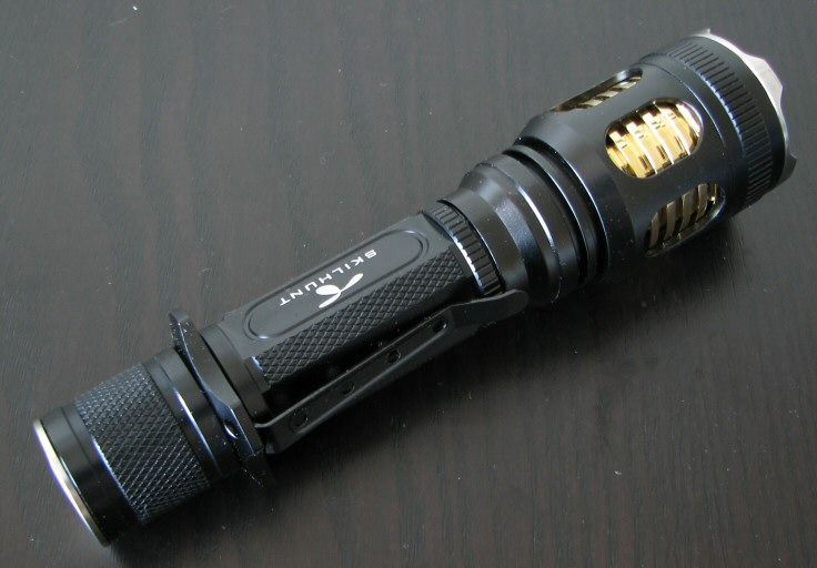

    The overall build of this light (design, quality, machining) is very reminiscent of Olight. I seem to recall making similar comments about the Lumintop lights.

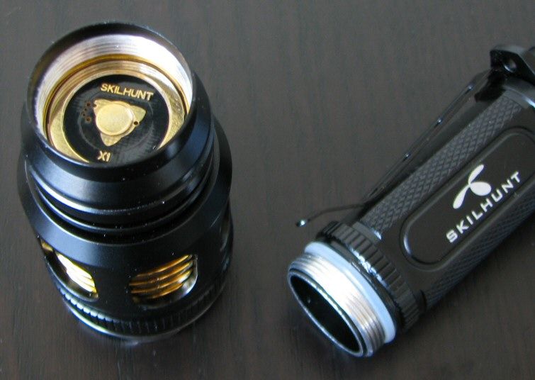

    While smaller than I expected overall, construction feels solid. Black anodizing (manufacturer claims type III = HA) is slightly glossy on the smooth areas. Knurling is not very aggressive, although there is more of it than typical on these sorts of lights. With various bundled extras (i.e. clip, grip-ring, etc.), overall grip and hand feel is good. Lettering is bright - clear and sharp. The included clip feels rather weak, and isn't as sturdy as the typical Olight/4Sevens-style clip.
    Screw threads are square-cut and anodized at the tailcap, to allow for lock-out.
    Of course, the most distinctive aspect of the light is the cut-out regions of the head showing the gold-plated heatsink. Ostensibly, these sorts of cut-outs are supposed to improve airflow over the heatsink (but I suspect they are really to show off the gorgeous gold-plated heatsink ). Either way, it makes these Skillhunt lights quite stylish in the modern flashlight world.

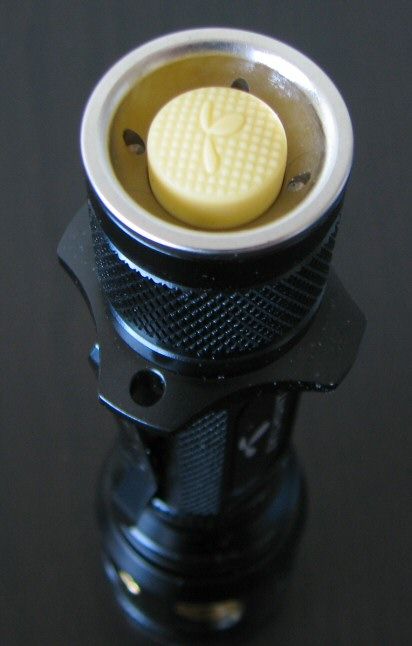

    Note there is no spring at the positive contact surface in the head, but all my flat-top cells worked fine in the light.
    Switch is a forward clicky, and the tailcap comes in two options across the models. The default option on the X1 is the plain one shown in the first pic above. If you want the flared tailcap (default on the X3, as you will see in that review), you have to order it as an optional accessory. Both tailcaps allow tailstanding, but I find it easier to access the switch on the flared tailcap version. Boot cover is yellow to match to heatsink.
    The spring on the inside of the tailcap has what looks like a gold-plated cover.

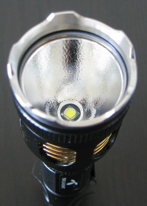

    The X1 uses a Cree XM-L emitter (well centered on my sample), with a medium-heavy OP reflector. I would expect throw to slightly less than average for the class, given the medium-sized head and OP reflector.

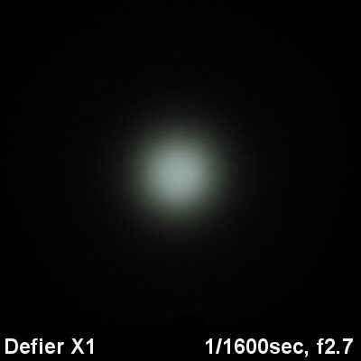

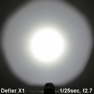

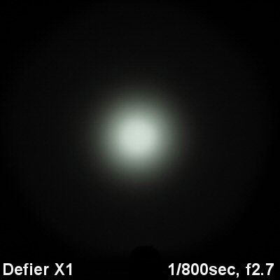

    And now the white-wall beamshots. All lights are on 1xAW protected 18650, about ~0.75 meter from a white wall (with the camera ~1.25 meters back from the wall). Automatic white balance on the camera, to minimize tint differences.
    Beam pattern is good - well-balanced. Due to the OP reflector, the X1 doesn't throw as far as the competition (which all had smooth reflectors in my testing).
    I have posted a new 100-yard round-up beamshot review for 2011, showcasing all my current "thrower" lights. Below are a few animated GIFs showing some relevant comparisons for the X1. Please see that round-up review for additional pics of other lights, taken under the same conditions.
    My apologies - I seem to have been a little off in aiming the X1. But hopefully you can still get a feel for how it compares to others in this class. As shown in the white wall beamshots, the hotspot is not as well defined, and it typically doesn't throw as far. But the overall beam profile is well-balanced.
    As you can see above, the Defier X3 (which has a larger, smooth reflector) is more focused for throw.

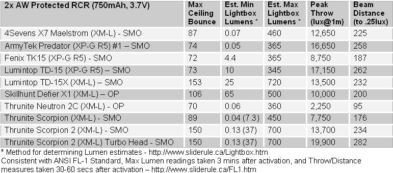

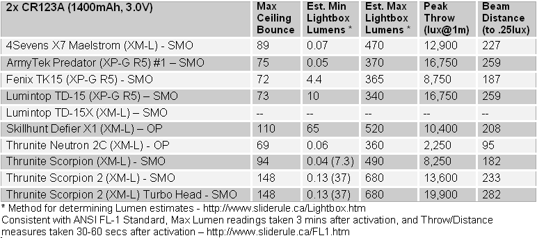

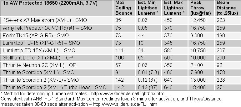

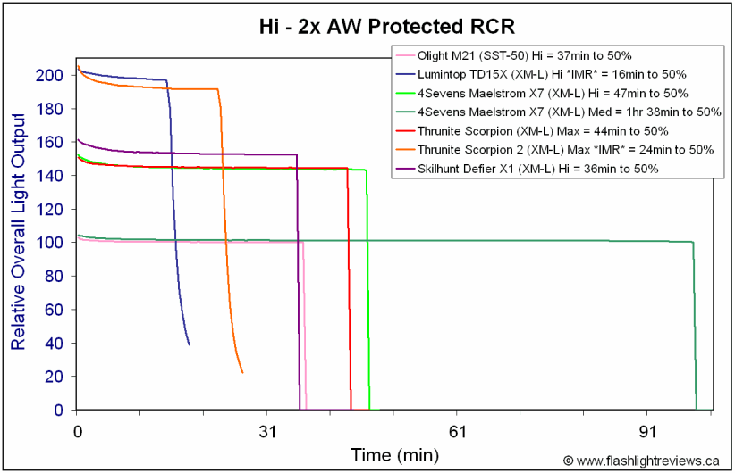

    Overall output of the X1 is certainly in keeping with this XM-L class of light. Basically, overall output was slightly higher than the 4Sevens Maelstrom X7 or Thrunite Scorpion V1. Output wasn't as high as the heavily-driven Lumintop TD-15X or Scorpion V2.
    According to Skilhunt, current to the LED is 1.7A on the X1 on Hi. That seems believable to me, based on my testing (i.e. output is higher than lights that use a typical 1.5A drive current, not as bright as those using 2.0-2.5A).
    Throw is what you would expect for this size light with a textured reflector - in-between the Scorpion V1 and 4Sevens X7, for example.

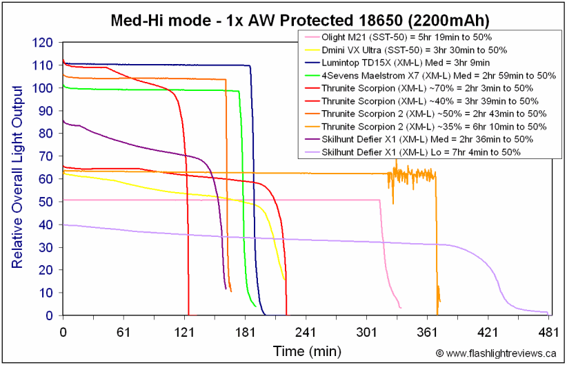

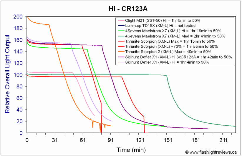

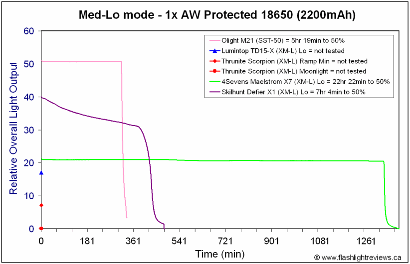

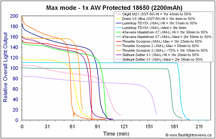

    Output/Runtime Comparison:
    Output and runtime on Hi output is consistent with other lights in this class (on all batteries). Relative efficiency seems somewhat lower on the Lo/Med modes, compared to other lights in this class. A similar pattern was observed on the original Thrunite Scorpion V1 - overall performance of the X1 is very similar to that light.
    The light uses visible PWM on the Lo/Med mode, at a visible frequency (196 Hz).
    Light lacks a true Lo mode (i.e. it's Lo level is noticeably higher than the min output levels of other lights in this class).
    Strobe is included on the main sequence, but is a slow signaling strobe in this case (i.e. <2 Hz).

    Default Re: Skilhunt Defier X1 (XM-L) Review: BEAMSHOTS, RUNTIMES, DETAILED PICS and more!
    Hm-m, it's look like brass, not copper
    (pic from here)
    So heatsinking must be very, very poor
    From offical site:
    独特散热设计搭配扎实罕见的用料,黄铜棒精密机械加工,表面抗氧化镀金处理。
    With Google translator:
    The unique thermal design with a solid and rare materials, precision machining brass rod, and resistance to surface oxidation of gold-plated handle.
    6,936
    Quote Originally Posted by dsche View Post
    From offical site:
    Interesting, thanks for sharing the pic.
    I have no way to perform a metallurgical analysis - has anyone found a way to confirm whether or not it is copper? AFAIK, the aluminum reflector is bonded to the machined-matched heatsink, so it is unlikely anyone would be able to separate the two (i.e., would need to damage the reflector/heatsink to get a piece off). A skilhunt dealer informed me that the reflector apparently threads into some sort of bezel/reflector retaining ring, which in turn threads onto the heatsink in the head. But because the whole unit is bonded together, I have no way of verifying this. Anyone have more info? I don't know what the material of the retaining ring is, but I wonder if that could be what is showing up in the pics above (if it actually threads from the base?).
    As for the translation, I note the official skilhunt site still says copper on their english-language wesite (as they also confirmed to me in personal correspondence when I asked them to verify).

    Perhaps you could center punch the heat sink on an obscure place under the head. This should remove the plating and let you see what's underneath. I don't know if you own it or if it's just on load though. You may not want to add and imperfection.
    I have no way to perform a metallurgical analysis - has anyone found a way to confirm whether or not it is copper? AFAIK, the aluminum reflector is bonded to the machined-matched heatsink, so it is unlikely anyone would be able to separate the two (i.e., would need to damage the reflector/heatsink to get a piece off). A skilhunt dealer informed me that the reflector apparently threads into some sort of bezel/reflector retaining ring, which in turn threads onto the heatsink in the head. But because the whole unit is bonded together, I have no way of verifying this. Anyone have more info? I don't know what the material of the retaining ring is, but that could be what is showing up in the pics above.
    Hi Selfbuilt,
    I too have no way of doing a metallurgical analysis. I can confirm the the reflectors are not bonded to the heat sink. I have a unit with an unglued head that allows me to switch reflectors. I will check to see if there is a way to get a sample from under the reflector. It requires destructive testing .
    As far as the pictures above, that is not a retaining ring, it is a wafer washer that inserts between the alluminum head and the driver to ensure a good ground connection between the driver and body. The Drivers are epoxied in place and can not be removed. This maybe a different revision, as mine has a gold outer ring. The purpose of this maintains a ground path when the head of the light is loosened allowing a break in contact with the inner ring which provides switching of modes. The LED package sits directly on the the heat sink with thermal compound. This picture above does not show any portion of the Solid heat sink. I have PM'd CPF member Dsche to see if he will translate and repost to that original RU site.
    I don't have a handy picture of the X1 heatsink and reflector, but it is very simular to the X3 picture below.
    GL
    6,936
    Quote Originally Posted by Got Lumens? View Post
    Thanks Got Lumens?, appreciate the detailed overview
    While the source of the heatsink material is of esoteric interest, I have no way to assess. I usually tell the difference between copper and brass by a low-tech method - trying to bend them, lol.
    In any case, I am personally not overly concerned whether the material is copper or brass. The X1 and X3 are not particularly heavily-driven for their class, and I've seen a number of good lights with decent brass heatsinks. What typically matters a lot more is the interface between the pill and the heatsink (i.e. good quality - and an appropriate amount - of thermal paste).
    My lengthy experience of CPU over-clocking over the years (and its required cooling) have taught me that a proper interface and transfer material matters a lot more than the actual heatsink material. This is not so easy to assess on any light, unless one plans to dissamble the pill and desolder the leads (i.e., as if one is doing an emitter upgrade). That is certainly not part of my standard testing ...
    Flashaholic dsche's Avatar
    Dec 2009
    Perm, Ural
    161
    Got Lumens?, thanks for pictures! You are right, this is ground washer, not a part of heatsink
    On Russian forum we was confused a little with "vergolden copper", so we just ask SKILHUNT's spokesman about it
    Answer was: 'It's brass; there is a mistake with English translation on the site' (
    6,936
    Interesting, thanks for the update dsche.
    Obviously, multi-national translation can get tricky for these companies. I will add a note in this review and my X3, pointing to these posts.
    Cheers!
