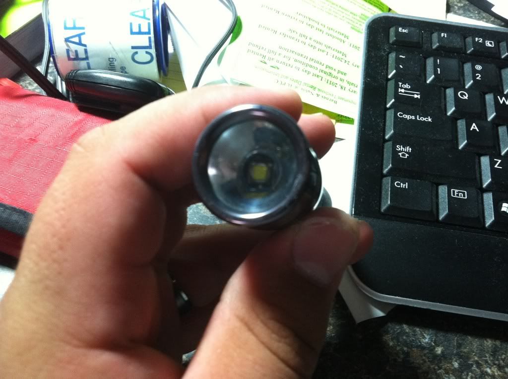

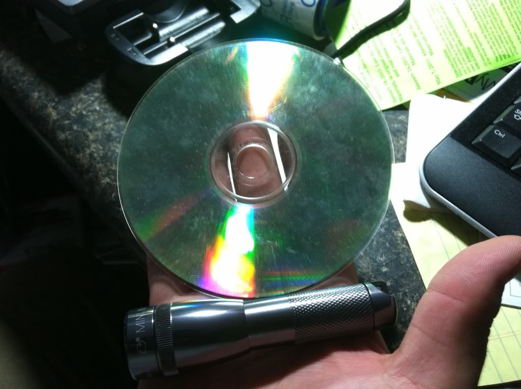

    Evilgrin07 XM-L Micro "Maclight"
    A couple days ago I posted a comment in another thread here about my micro maglite and someone suggested I create a new thread about it with a few more pics showing the teardown view as well, so, here goes...
    She's an incan mini that I've shortened to single AA size (threaded tail) for use with 14500 Li-Ion cells. The head's been bored to take a standard P60 pill along with Carclo optics. In the pill is a 3.5A regulated driver with temp and power cut-off if voltage drops too low. It has 5 modes (L/M/H/Strobe/SOS) and modes can be quickly and easily changed using one hand. This is running an XM-L T6 emitter that is pretty much limited only by the battery. Heat isn't too bad an issue but it does get warm quickly and gets hot after 5 minutes on high. Fortunately the low and medium are perfect for long run times and still put out plenty of lumens.
    As you can imagine, she is insanely bright and runs right up there with any of my other XM-L torches (16340, 18650, and even 3x18650 powered). Strong, large hot spot with tons of spill, it lights up the entire back yard on high. She's a keeper!
    Below are a few pics of it and the holster I made for her. Enjoy!

    Nice work, Johnny! Has a very nice sleeper look to it...
    Are you using IMR 14500s to push that 3.5A?
    Also, any chance of beamshots with that optic?

    Thanks! Right now I'm just using trustfire 14500 cells in it. No IMR cells yet. I know I'm not getting the full power to the LED but still getting close to 2A I'm guessing. I need thicker test leads on my DMM to measure actual amps and have some on the way. Will also try to get some wall shots and some outdoor shots as well in the next couple nights. I'll update the thread with them once I have them.

    Did you use the stock reflector it appears you did? Also how did you know where to get the proper focus with the height of the pill.
    Look forward to beam shots JohnnyMac.

    Johnny - just wondered how you went about cutting the tail cap thread? Was a lathe used, or were you able to find a suitable tap to cut the threads manually?

    Default Re: XM-L Micro "Maclight"
    What driver are you using?

    Yes, the TIR optic replaces the reflector. You can use the original reflector and lens but it must be modified carefully to work and space is a severe limitation in this application.
    I had to do a lot of tracking to find the correct tap but it is all done by hand.

    I am using the "Constant Current LED Driver Board - 5 Mode" from LCK-LED

    Very nice, Johnny!
    How does it turn on and off? Is the positive spring simply short enough to lose contact when the head is screwed out?

    Thanks! It is still a twisty but instead of turning off when tightened, it turns on. Because the threads are anodized they do not conduct electricity to the head. Only when the edge of the body tube touches the driver's negative ring does the light come on. The action is crisp and precise with no flicker. An 1/8th of a turn (if that) and it's securely off. The positive spring on the driver never disengages from the battery until you remove the battery to charge it.

    Thanks for the info! Man, that is just too cool. I want one now... hehe.
    Just noticed you opened up the inside lip at the top of the tube. I wonder if this whole setup might work better with a Minimag LED. There's no lip at the top of the tube, and the head is longer, possibly fitting some kind of reflector.
    Last question... is the Carlco optic specific to the XM-L?
    If I can figure how to smoothly bore out a head by hand with a dremel, or get someone to bore a head for me, I'm sooooo doing this. Thanks very much for the inspiration!
    EDIT: Be careful about draining those 14500's that hard. Not much of a problem while running them, but the abuse puts them a bit more at risk for potentially hazardous problems during recharging. IMR's are the way to go.
