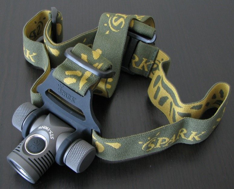

    Inside the soft cardboard packaging box (with cut-out foam insert) you fill find the light, head-strap with soft rubber attachment point for the light, spare o-rings, frosted glass diffuser, and manual.
    The headband is good quality, and includes an over-the-top-of-the-head strap (which you could remove if you didn't want).

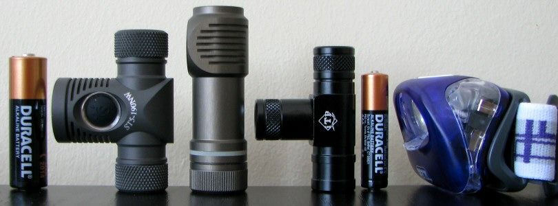

    From left to right: Duracell AA alkaline, Spark ST5, Zebralight H31, ITP H01, Duracell AAA alkaline, Petzel Tikka XP2.
    All weights with no batteries.
    Spark ST5 (1xAA): Weight, 41.5g, Length 58.4mm, Width 42.8mm (max body), Width 24.0mm (bezel)
    ITP H01 (1xAAA): Weight: 22.7g, Length 53.7mm, Width 37.2 (max body) or 15.4mm (bezel)
    Petzl Tikka XP2 (3xAAA): Weight 52.3g
    Zebralight H31w (1xCR123A): Weight: 28.6g, Length 66.9mm, Width (bezel) 22.1mm.
    The ST5 is quite small for a 1xAA-sized headlight.

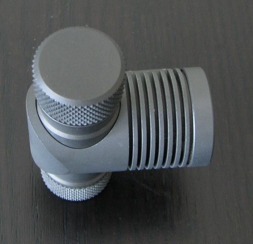

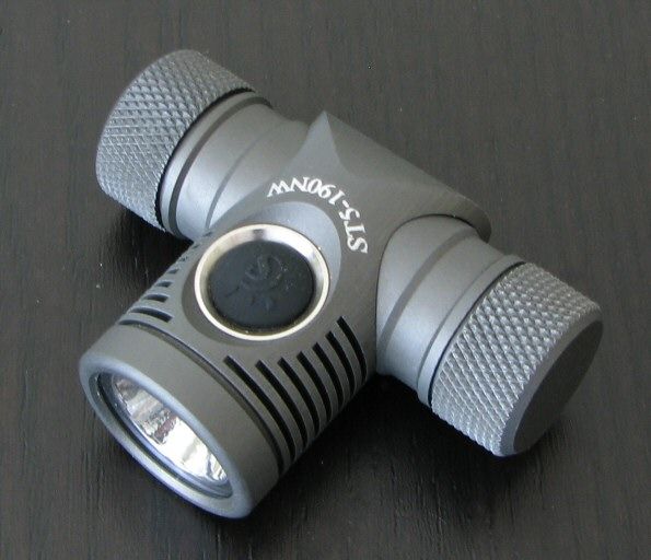

    The build of the Spark ST5 headlamp is distinctive, but still familiar looking. The protruding forward head does make it a bit easier to locate the button. The headband is good quality, and worked well in my testing. It holds the light securely (both within the holder, and strapped to your head), but still allows for accurate positioning.
    I like the muted gray natural anodizing (manufacturer claims hard anodized). There are some ridges in the anodizing on my sample, but the overall effect is still good (think naturally-weathered looking). Anodizing does seem fairly thinly coated, however.
    Labels are fairly minimal and small, but clearly legible against the background.
    There is only knurling on the end pieces, once of which opens up to allow you to insert the AA battery. Screw threads are anodized for tailcap lock-out.

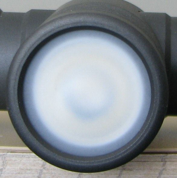

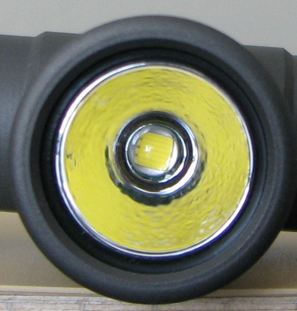

    I like the included frosted glass diffuser (feels like glass, not plastic). This can be used to replace the clear lens, but I find it also fits over the existing lens assembly if you don't want to open everything up (i.e. just unscrew the bezel and pop on top). Note the bezel ring doesn't screw down all the way with both lenses in place, of course.

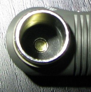

    The ST5 has a shallow reflector (light OP coating), which – when coupled with the XM-L emitter – suggests the light will not be a great thrower. XM-L emitter was well centered on my sample.

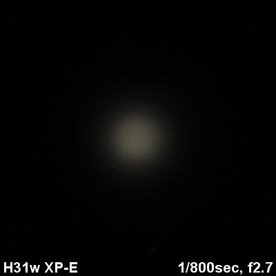

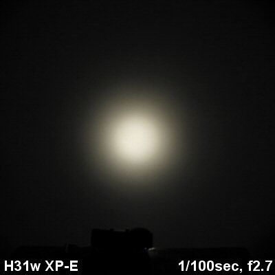

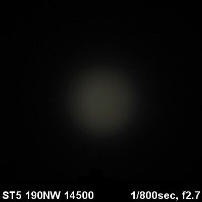

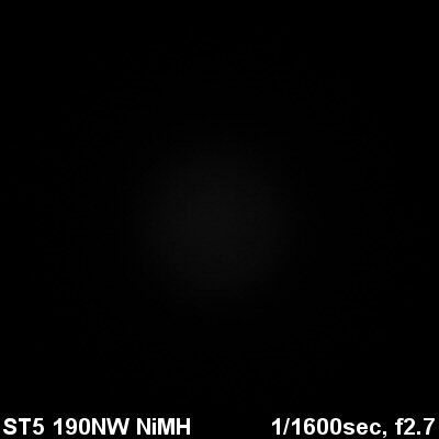

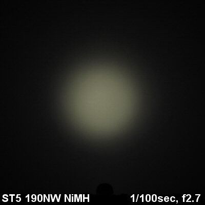

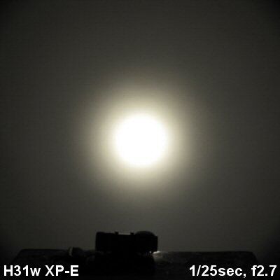

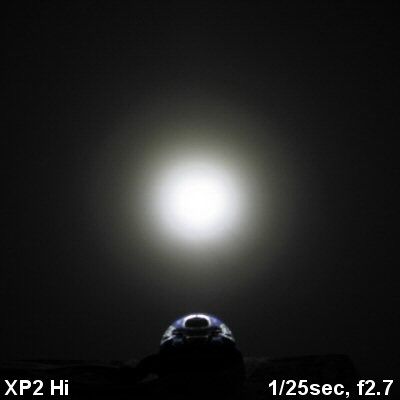

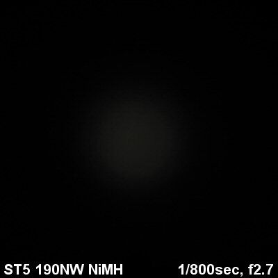

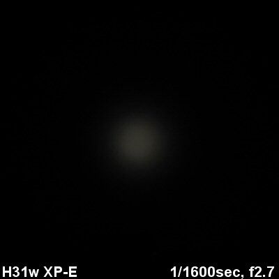

    Which brings me to the white-wall beamshots. Unless otherwise identified, all lights are on max output on 1x Sanyo Eneloop NiMH, about ~0.75 meter from a white wall (with the camera ~1.25 meters back from the wall). For 14500, I used an AW protected cell. "Daylight" white balance used on my Canon S5, to better show tint differences of my Neutral White emitters. All beamshots taken immediately upon activation.
    Let's start with un-diffused white beams:
    As expected, the default Spark ST5 produced a nice beam, with a fairly broad hotspot that wasn't overly throwy. Even without a diffuser, I found this beam quite good for up-close work (i.e. better than the XP-E-equipped lights). Note that although the original Petzl Tikka XP had an optic that produce a nice focused beam, the XP-E-equipped Tikka XP2 is rather ringy in comparison (especially on the periphery).

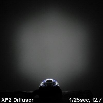

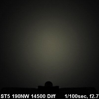

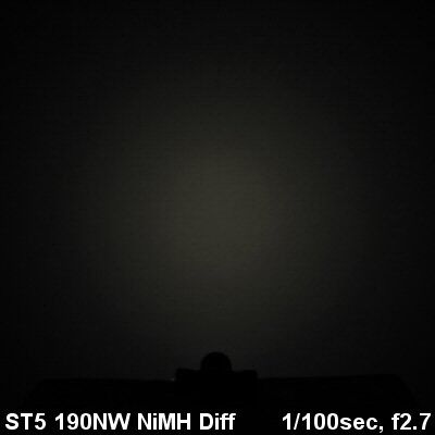

    Here are some comparison shots with diffusers in place:

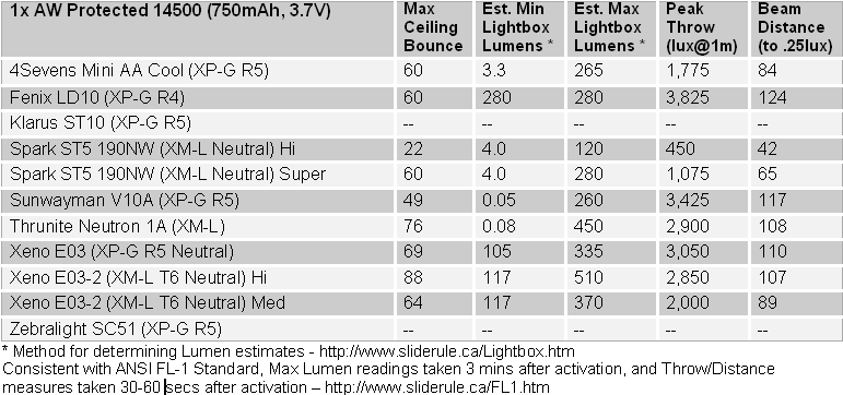

    Consistent with its role as a small-mass headlamp, the ST5 is not as bright on max settings as larger handheld XM-L lights, on either battery type. But it is very bright by headlamp standards. The beam is not as throwy as some XP-E-based lights, but that actually suits my general headlamp purposes better anyway.
    Output/Runtime Comparison:
    Output/runtime efficiency is exactly what you would expect for a good current-controlled XM-L light driven to these levels.

    Thanks Selfbuilt for another great review!
    I have just a question regarding the brightness modes. At the specs of the light I can read:
    • Super: 190lm 0.9hours
    • Max: 120lm 1.8 hours
    • Med2: 36lm 8 hours
    • Med1: 10lm 30 hours
    • Low: 2lm 86 hours
    But at your output/runtime comparisons you call them Hi and Med. I understand your Hi is Super at the specs, and your Med is Med2?
    Default Re: Spark ST5 190NW Headlamp (XM-L 1xAA/14500) Review: RUNTIMES, BEAMSHOTS, and more!
    Quote Originally Posted by Swedpat View Post
    No, in my runtimes I label Super Hi for "Super", Hi for "Max", Med2 for "Med2", Med for "Med1" and Lo for "Low". On standard batteries, there is no difference between "Super" and "Max" - output is the same, so I've just labelled them as Hi.
    It doesn't make any sense to me to label a mode "max" when there is a higher level above it.
