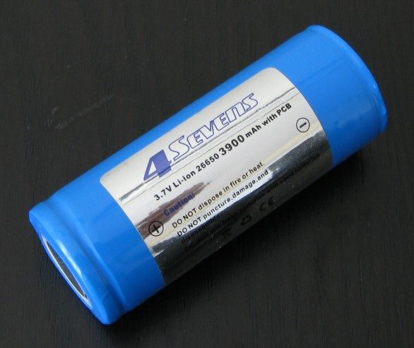

    Here’s what the required battery looks like:
    My review sample came with a blue-wrapped 26650 (the original S12 used a green-wrapped 26550). I’ve asked 4Sevens, and have been informed that the two batteries are different, with the X10 blue-wrapped battery reformulated for the lower load with the XM-L. The S12 batteries will work in the X10, but not the reverse.

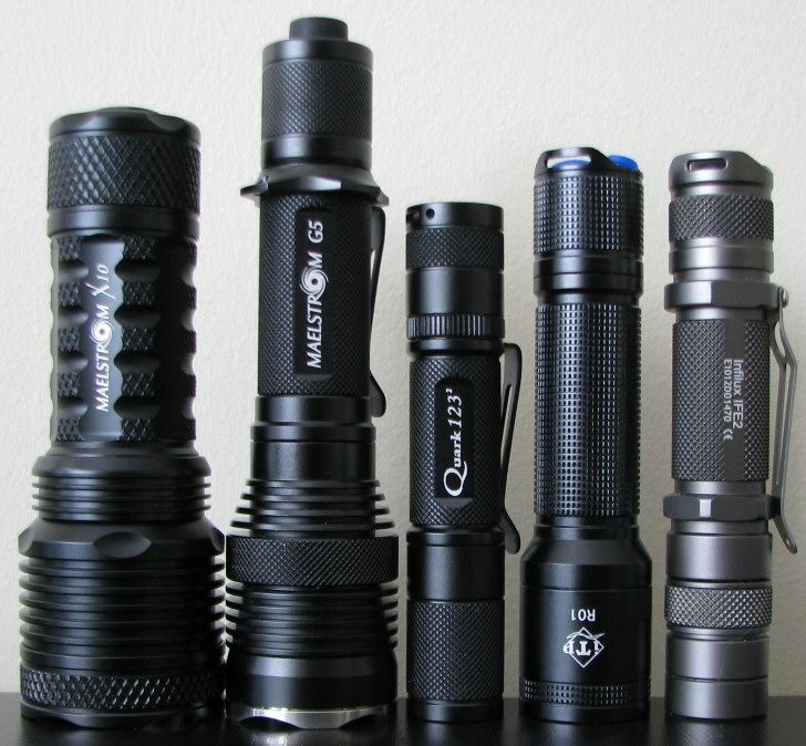

    From left to right: 4Sevens X10 Maelstrom, G5 Maelstrom, Quark 123-2; ITP R01; NiteCore IFE2
    From left to right: AW Protected 18650, 4Sevens Protected 26650, 4Sevens X10, Fenix TK35, Sunwayman M40C, Eagletac M3C4.
    X10: Weight: 156.9g, Length: 135.5mm, Width (bezel): 46.0mm
    X7: Weight 146.9g, Length: 151.5mm, Width (bezel): 38.7mm
    G5 : Weight: 145.5g, Length: 156mm, Width (bezel): 38.9mm
    The light is wider than typical, due to the 26650 cell (i.e. 26650 refers to the battery width in mm, 26650 refers to the length in mm, 26650 refers to a cylindrical cell). But overall length is well within the standard range for lights that use this typical 65mm cell length.
    Compared to the 2x18650 class of lights, the X10 seems downright tiny. The reason for this size comparison will become obvious once you see the output …

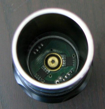

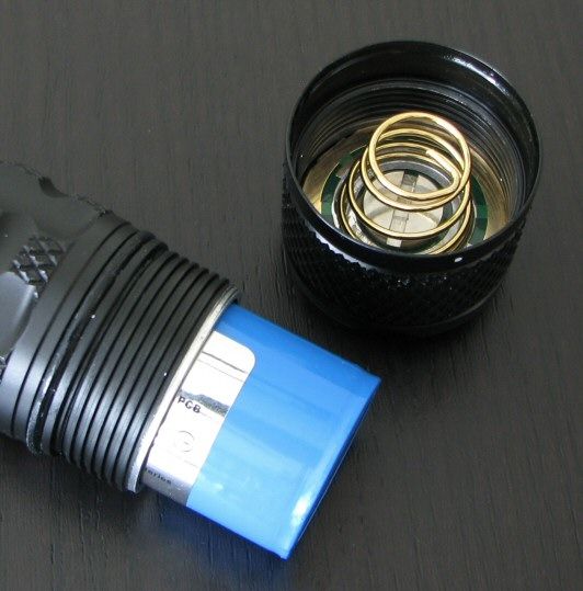

    There are a generous number of square-cut machinist threads (anodized for tailcap lockout).

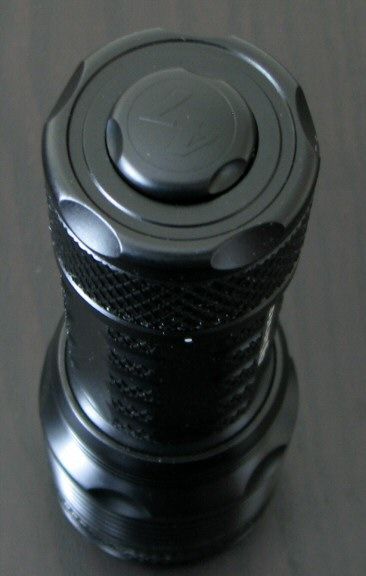

    Note the switch is not an actual clicky. Pressing the plastic button simply pushes forward the circuit board slightly. This allows contact for momentary-on when the tailcap isn’t fully tightened. When fully tightened, the tailcap is locked-on and the button has no effect. Scroll down to my interface section for a discussion.

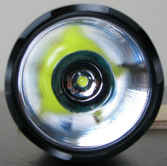

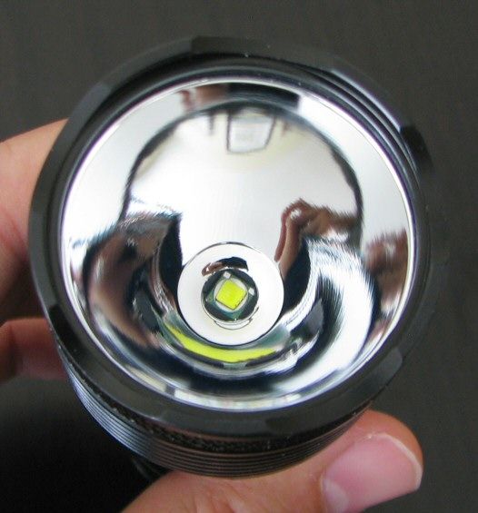

    The X10 uses the Cree XM-L emitter, well centered on my sample, with a smooth reflector (although there are some fine concentric rings in it). I don’t have a S12 to compare, but it looks like they are using the same build for the X10, with a flat area of the reflector right around the smaller emitter in this case.

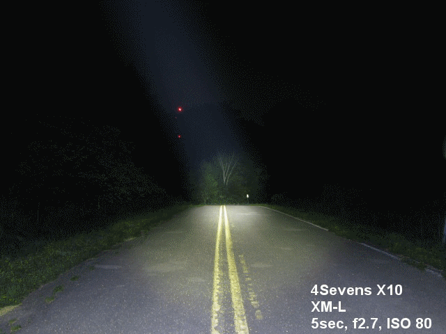

    UPDATE AUGUST 21, 2011: I have now done 100-yard outdoor beamshots, in the style of my earlier 100-yard round-up reviews.

    Both lights use a pressure-style switch. When the tailcap is fully tightened, the light comes on and stays on. With the tailcap loosened a quarter-turn or so, you can press the switch button to activate the light in momentary mode (i.e. release the pressure switch, and it shuts off).

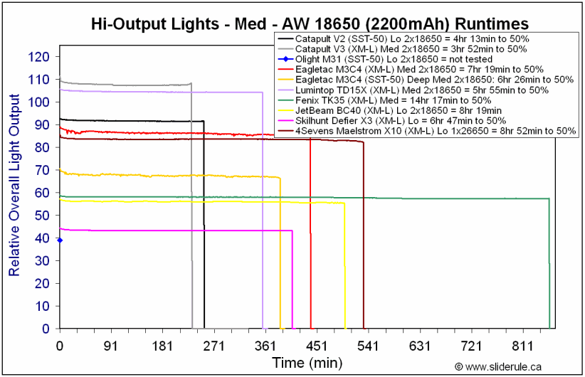

    Output/Runtime Comparison:
    Note: My relative output scale is not linear for output across this range. Please see my Summary Tables above for lumen estimates.

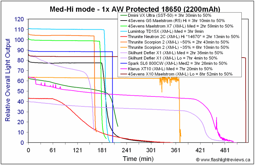

    Again, I'll start with the 1x18650 comparisons:
    Runtime was bang on with the 4Sevens 1.8 hour estimate on Hi (i.e. 1hr 48 mins). On Lo, runtime was considerably less than the spec (i.e. 9 hours instead of 15). However, my lumen estimate was double that reported for the light (i.e. 200 lumens instead of 100 lumens).
    A comment about the output level estimates – the X10 uses a partial regulation/step-down pattern over the run (likely a response to thermal management). Basically, the light seems to run mainly direct-drive, but with thermal regulation to step-down the light if it gets too hot. Under a cooling fan, using my crude conversion method (link above), I estimate the lumens to be ~770 at 3 mins into the run (i.e. ANSI FL-1 standard), but by 4.5 mins, it drops down to ~700 lumens. From 10-40 mins, it switches back and forth between ~670 and ~640 estimated lumens, before falling into a direct-drive pattern without thermal step-down for the rest of the run (until the protection circuit is tripped).
    4Sevens thus seems to be conservatively using the lowest “regulated” level for lumen estimate for this light, even though it spends most of the time above this level. But again, I don’t have a calibrated integrating sphere to say for sure – this is a relative comparison based on lumen estimates of other lights.

    Pressure switch/twisty only, no clicky switch. Mode switching design prevents signaling (i.e. flashing the tailcap jumps between output modes)
    Beam has noticeable artifacts and tint shifting on my sample, but these are really only issues at close-range.

    During the first 45mins it looks like the thermal regulation cuts in and out several times, it seems sudden and often during this part of the runtime do you think that would annoy you outdoors?
    Could the artifacts in the beam be because of the part that keeps the emitter aligned? I can barely make them out but the dark spots almost look like the same pattern as the emitter "seat".

    Great review selfbuilt. You're right...those are some noticeable artifacts around the beam up close, but I wonder if you'd notice it outside of white wall hunting?
    Interesting theory. Looking more closely, I can see the the base of the reflector is not perfectly flat (i.e. it has some curvature to it). But the curvature is consistent, I don't see any evidence of the "seat" poking through. More likely, I suspect the curved base of the reflector is picking up reflection from around the emitter die/dome (i.e. maybe from the four corners outside the die?).

    Regarding the corona - we've experimented with so many prototype reflectors and eventually we settled for the best compromise. The warmer tint actually comes from sharper angle of incidence - if you think about it the light coming at 180 degrees actually travels through more phosphor thus causing a warmer light. Light coming perpendicular from the die will be the coolest. Pretty much every single LED we've worked with in our labs has this characteristic. Maybe one day they'll be able to make dies that are convex and not flat - they the problem of delta tint would be solved.
    Until then we have to make engineering compromises to make up for the current flat-square LED paradigm. There are two distinct ways to ease this delta tint in the corona. 1) add stippling/orange peel at the cost of throw 2) use a different foci for the reflector area around the LED which has the highest incident angle.
    Since our target was to make the shortest (stubby) thrower we opted not to do the orange peel as that takes away from the spot intensity and angle. We changed the foci of the reflector area just around the LED, thus spreading out that part of the reflection.
    I had some test reflectors that do now have this foci adjustment and trust me the corona is more pronounced in shape as well as tint. So the product reflector eases the tint shift while maintaining throw.
    Sorry I got a little technical here and probably said too much (competition is always watching and reading notes) but I felt to disclose this to my cpf family

    Quote Originally Posted by 4sevens View Post
    if you think about it the light coming at 180 degrees actually travels through more phosphor thus causing a warmer light. ... There are two distinct ways to ease this delta tint in the corona. 1) add stippling/orange peel at the cost of throw 2) use a different foci for the reflector area around the LED which has the highest incident angle. ... Since our target was to make the shortest (stubby) thrower we opted not to do the orange peel as that takes away from the spot intensity and angle.
    Thanks for joining in David.
    Your explanation makes sense. I have seen some tint shifting before in coronas, though not usually this pronounced. But of course, the far more common solution that most makers have opted for has been texturing the reflector (one imagines a cheaper option as well ).

    I'm impressed how efficient the driver is - you get roughly the same lumenhours out of 1x3900mAh as the 2x2200mAh lights, without the hassle of cell PCB protection jumping in (always at too low voltage IMO), and finding a pair of balanced cells.

    I suspect it has more to do with cooling - all my runtimes are done under a cooling fan.
    ti-force has done a nice analysis of various cooling options on the S12 and X10 in his review, and you can see it drops lower with less cooling. Although he didn't test a cooling fan specifically, I know from my own experimentation that a fan provides better cooling that a full-contact hand grip for hand cooling. So I suspect I would have had lower numbers if I hadn't used a fan (based on ti-force's results). And of course, my lumen estimates are computed, not direct measures in a calibrated sphere, so the degree of uncertainty in the measures is high.
