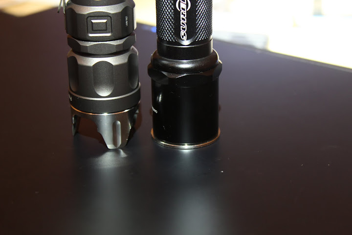

    I have a couple jetbeam bezels and my first SF 6P just arrived. I will let you know if they fit back and forth tonight. Right now Im at work.
    EDIT: Yes, they fit.
    Here is the original bezel from the Jet-III M on the surefire 6P. The outer diameter of the bezel is 2mm (1mm each side) wider than the body diameter.
    Here is the Jetbeam strike bezel on my 6P

    Whoa crap... 1mm hanging off the sides is ugly... I just ordered 2 Jet 3M bezels... Now beginning to question my purchase... Hopefully they'll fit the Cryos and the new FM bezels I have coming in a little better....
