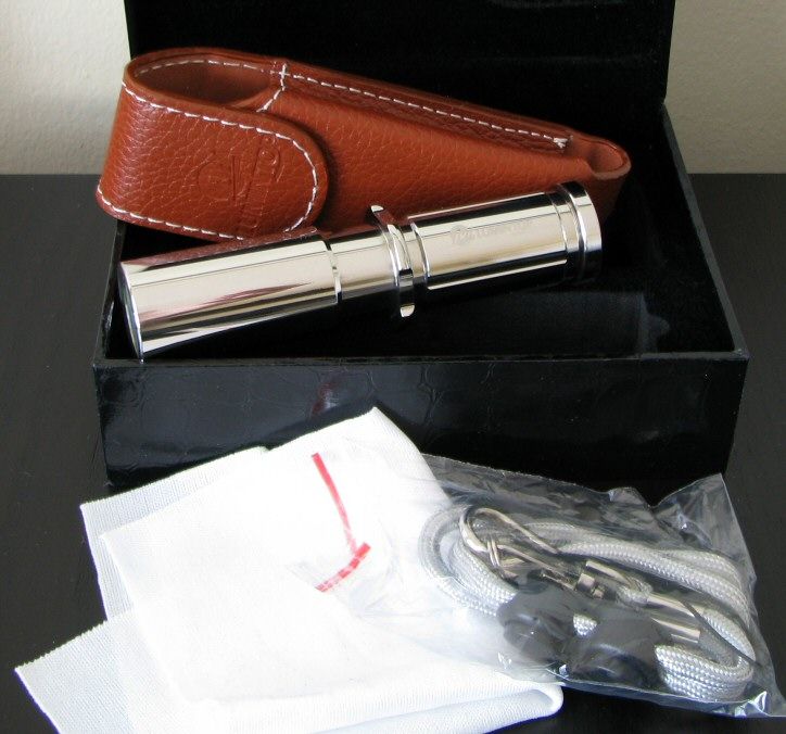

    Packaging is high-end, clearly designed as a presentation item. FYI, I note that Lumintop can apparently do custom engraving on these (check with them directly for more info).
    Inside the black faux-snake skin box with spring hinge, you will find a nice quality leather belt pouch with concealed magnetic closing flap, microfiber cleaning cloth, and good quality wrist lanyard. There were no extra o-rings or manual on mine (both which I suspect was an oversight).

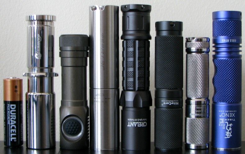

    From left to right: Duracell AA, Lumintop Silver Fox, Zebralight SC51, JetBeam E3, Crelant 7G1, NiteCore D10, 4Sevens Mini AA Titanium, Xeno E03.
    Silver Fox: Weight: 98.1g, Length: 94.2mm, Width (bezel) 21.7mm, (grip-ring) 25.8mm
    JetBeam E3: Weight 105g, Length 101.0mm, Width (bezel) 21.5mm
    Thrunite Neutron 1A: Weight: 60.4g, Length: 105.6mm, Width (bezel/tail) 22.0mm
    Sunwayman V10A:: Weight: 58.1g (no battery), Length 100.6mm, Width 23.1mm (bezel)
    Weight seems about right for a stainless steel light.

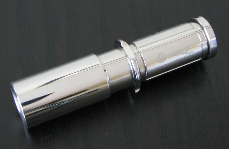

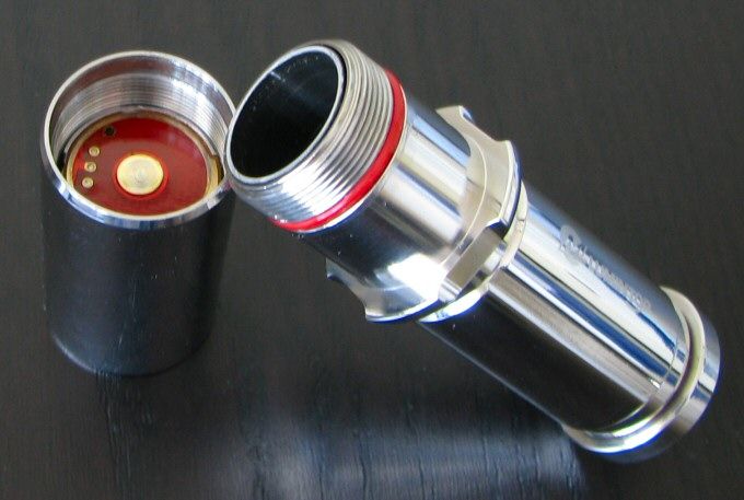

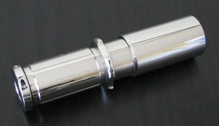

    As mentioned, the Silver Fox body is stainless steel. As with most SS light, there is an interior sleeve that holds the battery and connects to the head.
    Lettering is a subtle light gray against the polished background, very classy looking. While there is no anodizing to speak of, the built-in grip ring helps with grip. It also serves as a very effective anti-roll device.
    Tailstanding is good. The Silver Fox has a lanyard attachment point in the base.
    The Silver Fox has a decent sized spring in the tail/body (not shown).

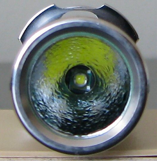

    The Silver Fox comes with a textured reflector (OP) and uses a XP-G emitter. The emitter was well centered on my sample.

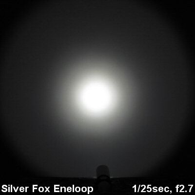

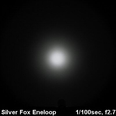

    Which brings me to the white-wall beamshots. All lights are on Hi on 1xAA Sanyo Eneloop, about ~0.75 meter from a white wall (with the camera ~1.25 meters back from the wall). Automatic white balance on the camera, to minimize tint differences.
    Thanks to fairly deep reflector, the hotspot is well focused and smaller than typical for a 1xAA light. Cool white tint was a bit purplished on mine.
    Here is a comparison of the Silver Fox on 1x14500, relative to 1xAA Eneloop.

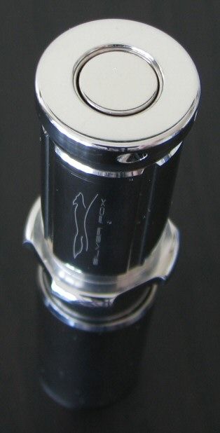

    The Silver Fox uses an electronic switch, with a fairly typical button feel.
    Press and release to activate the light on Lo. Press and hold the switch for 2 secs to switch to the Hi mode. Note that you can start the light in Hi by holding the switch down for 2 secs from the off state as well.
    There is a slight quirk in turning off Ė from the Lo mode, a press release turns the light off. From the Hi mode, a press release drops you down to Lo. From Lo, another press release turns off. I havenít figured out a way to turn off from Hi without going into Lo first.
    There is no memory mode.

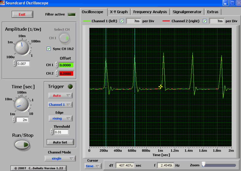

    PWM
    The light uses PWM for its low mode, but at a visually-undetectable frequency of 2.45 kHz.
    There is no strobe mode on the Silver Fox.

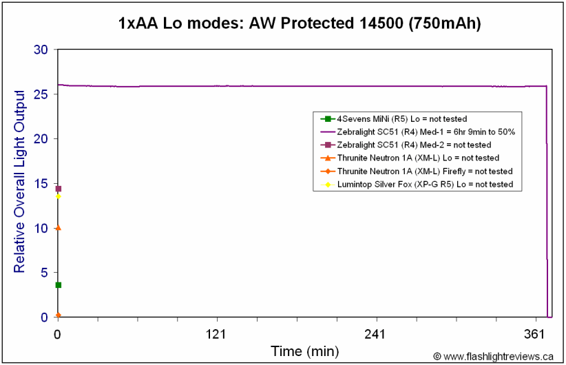

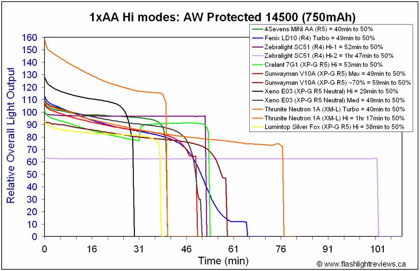

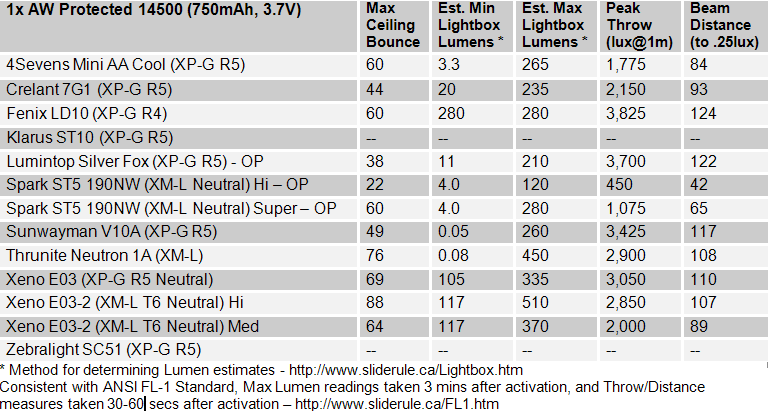

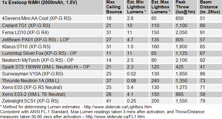

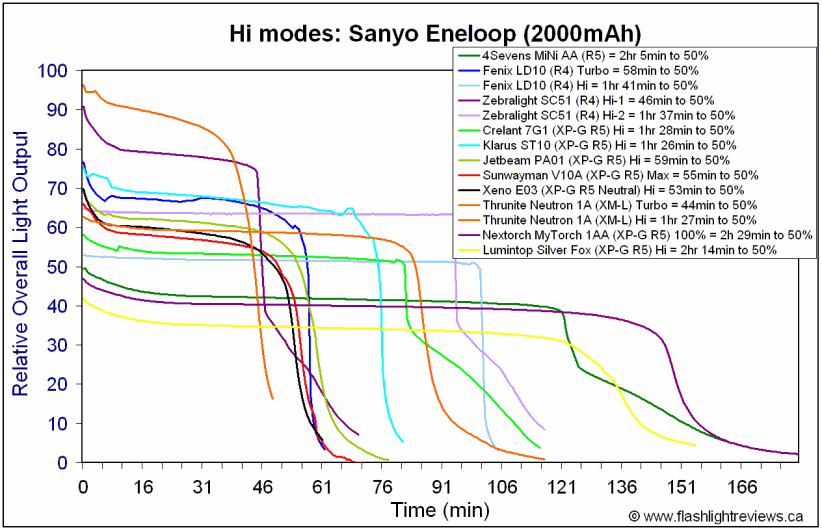

    Output on Hi is lower than most lights in this class (more typical of Med-Hi level), on both standard batteries and 14500. Throw is reasonable for the class.

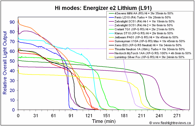

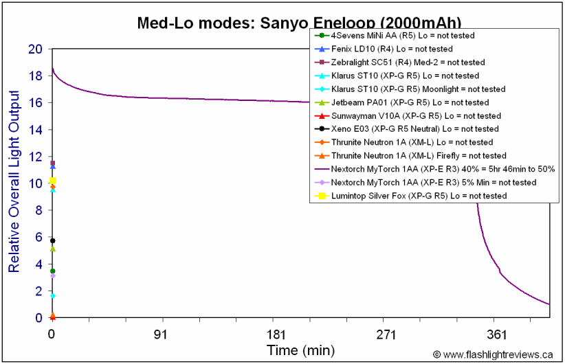

    Output/Runtime Comparison:
    On Hi, on standard batteries, the Silver Fox has lower output than most lights in this 1xAA class. Still, runtime is about typical for the less-heavily driven members of this class. A similar slight loss in efficiency is also observed on 14500.
    Stainless steel lights are heavier than aluminum ones (although the Silver Fox seems about typical for the SS class).
    Output on Hi is not as high others in this class, and there seems to be a relative drop in efficiency in this mode (but still fine in absolute terms).
