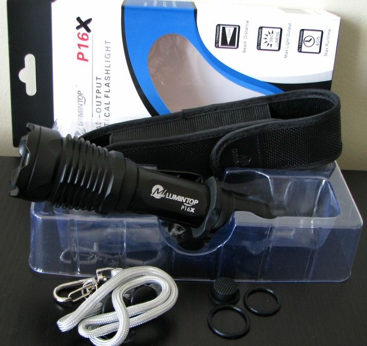

    Packaging is fairly typical. Inside the cardboard box, you will find the light (with removable grip ring and clip), good quality holster with closing flap, good quality wrist lanyard, spare o-rings and tailcap boot cover, and manual.

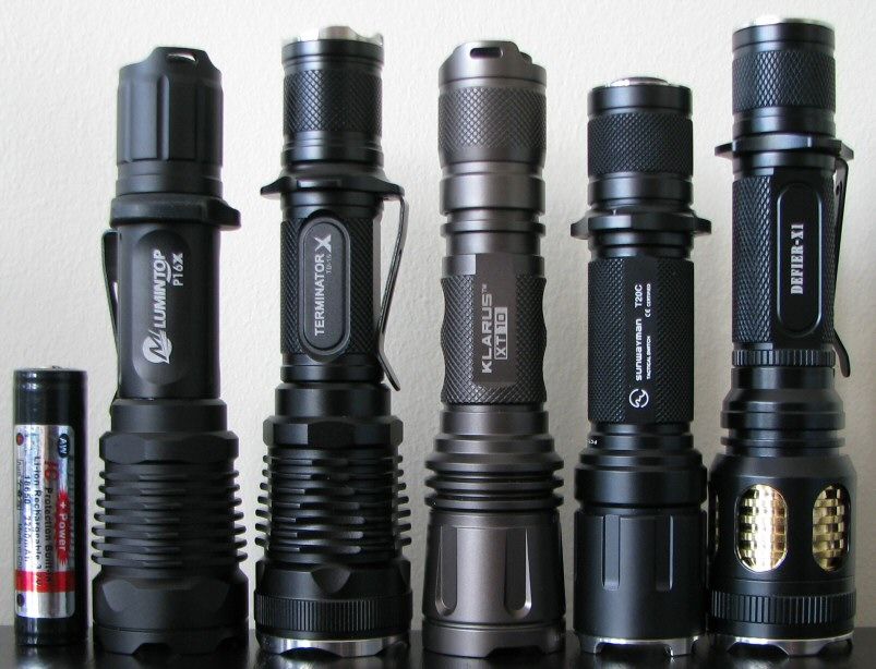

    From left to right: AW protected 18650, Lumintop P16X, TD15-X, Klarus XT10, Sunwayman T20C, Skilhunt Defier X1.
    All weights without batteries.
    Lumintop ED20: Weight 84.4g, Length 121.6mm, Width (bezel) 25.2mm
    Lumintop P16X: Weight 141.4g, Length 157.0mm, Width (bezel) 37.9mm
    Lumintop TD-15X: Weight 150.3g, Length 147.3mm, Width (bezel) 37.8mm
    Klarus XT10: Weight 121.3g, Length: 144.8, Width (bezel) 34.9mm
    Fenix TK15: Weight 131.1g, Length 147.1mm x Width (bezel) 34.0mm

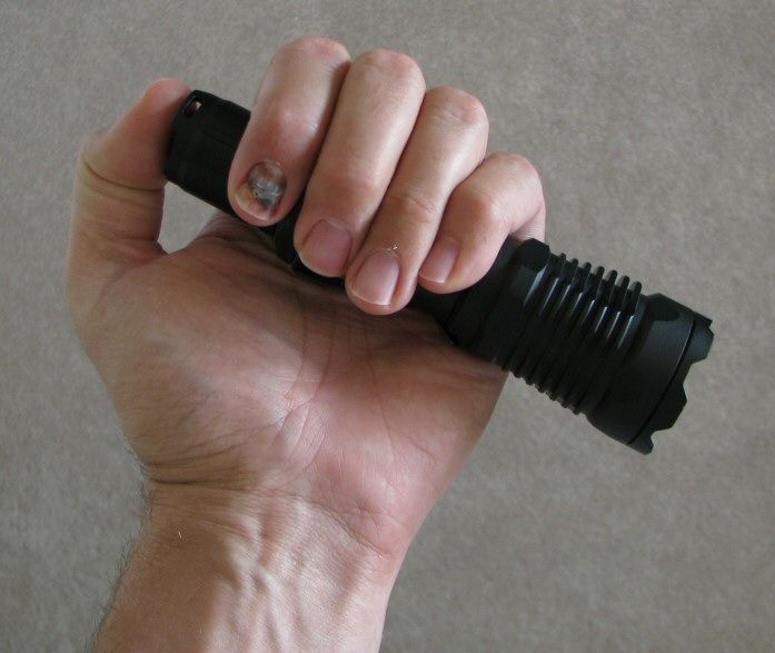

    The P16X is a reasonable size for this class of light.

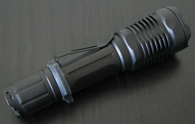

    Although external appearance is similar to the Lumintop TD-15X, there are a number of significant build differences.
    Anodizing is a standard flat black (presumed HA). There is no knurling to speak of, but flutes on the body and tailcap help somewhat with grip. The other design elements (i.e. head heatsink, clip, grip ring) help further. I found grip acceptable with the ring and clip installed, but would prefer some actual knurling.

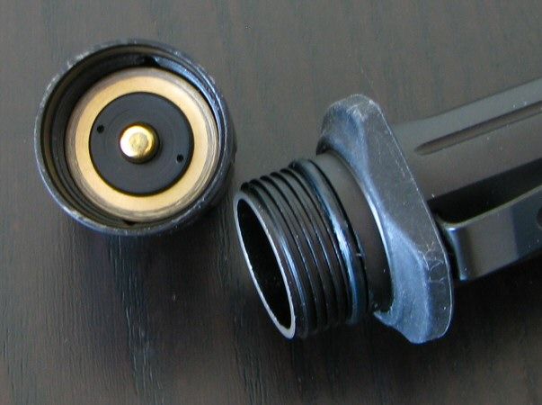

    Square-cut tailcap threads are anodized for lock-out at both the head and tail. Tailstanding is good. The P16X has lanyard attachment points in the tailcap.
    There is a small spring in the head, so high-capacity flat-top 18650 cells should work fine.

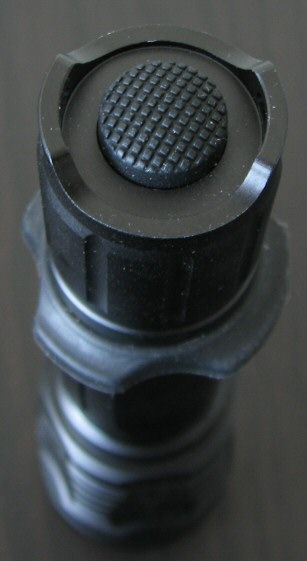

    The most distinctive aspect of this light is the tailcap – it uses a two-stage tactical design, with no clicky (i.e. press or tighten for Lo, press or tighten further for Hi). This is similar in concept to the Surefire L2-series lights. Scroll down to my UI section for a discussion.
    Technically, the light can tailstand, but is quite unstable (not recommended).
    For more information on the build and interface, please scroll down to my User Interface section to see a video review. I plan to offer these on new reviews from now on.

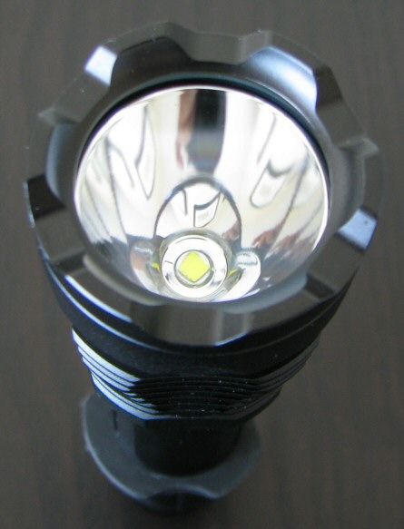

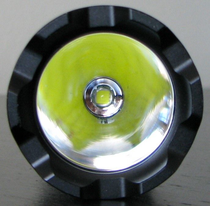

    The P16X comes with a smooth reflector (OP), and uses a XM-L emitter. The emitters were well centered on my samples. Note although my samples both came with a Cool White emitter, Lumintop informs me that Neutral White will also be available as an option.
    Which brings me to the white-wall beamshots. All lights are on Hi on 1x18650 (AW Protected 2200mAh), about ~0.75 meter from a white wall (with the camera ~1.25 meters back from the wall). For Cool White lights, I used the automatic white balance on the camera, to minimize minor tint differences. Daylight white balance for the Neutral White ED20.
    The P16X has reasonable throw for this size light and reflector, but not as great as some others in the class.

    The P16X uses a two-stage tactical twist-press tailcap, similar in function to the Surefire L2-series lights. There is no clicky switch on the light.
    To activate the light with a constant output, tighten the tailcap until the Lo mode comes on. Tighten further to activate the Hi mode. Loosen to return to the Lo, loosen further to turn off the light
    Alternatively, if the light is in Lo mode, you can press the tailcap button for momentary Hi. When you release the button, the light returns to Lo. If you unscrew the tailcap just enough to completely turn off the light, a soft-press will give you Lo output, and a hard press will give you Hi output. Unscrew the tailcap a little further, and a press will only give you the Lo mode. Unscrew even further, and a press will not activate the light (i.e. the light is locked out).

    That's just dust - it is most noticeable in the macro shots than in real life. It's harder to get rid of the dust with rubber, as the material is "grippy".
    And for that reason, I personally prefer it as a grip ring. It provides excellent grip, but also some give (i.e. so you won't rip the skin off your fingers if you try to force the light out of your hand). I guess it depends on how much absolute resistance you want - a metal ring won't give at all, if its securely fastened.

    I have just recieved my Lumintop ED20 and there is no mention of the LED tint (neutral white / cool white) on the packaging. How would I find out what LED I have ?
    If you are familiar with tints, you will be able to tell from the beam, or by looking at the emitter phosphor (neutral is warmer). Otherwise, you would need to compare it to a known cool white or neutral white light. I suspect it is likely to be cool white, if unlabelled.
