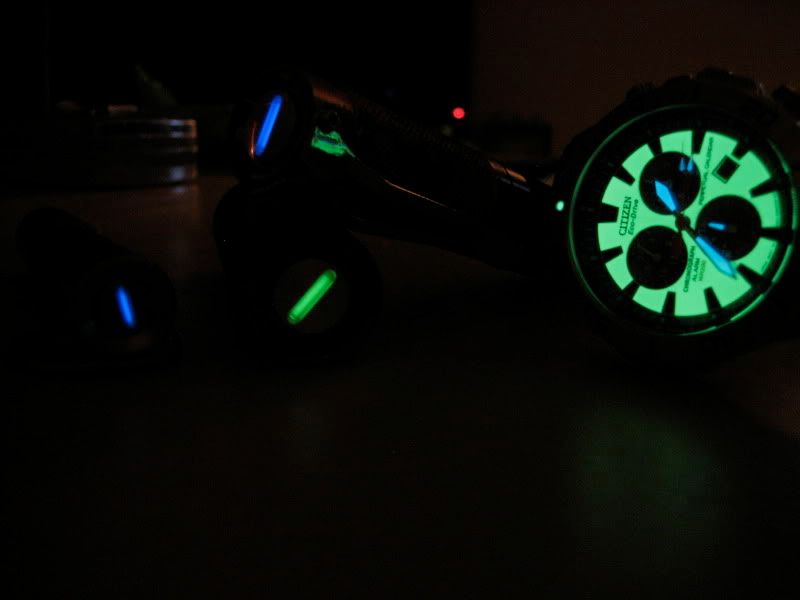

    Default Re: Tritium Decision...
    In this picture they look about the same. Is this what a real life experience would be?

    Not in my experience... not the blues, unless you've got a long-exposure shot like the one above. The green stands out right away in the dark - but not the dark blues. Those are dismal. Even with night adapted eyes (think four hours sleep, all curtains closed), I can barely see the blue tritium sitting on my desk 5-6' away, while the SMALLER green tube below it is brighter. Or the green tube the same size as the blue on a shelf 10 feet away.
    Quote Originally Posted by Haesslich View Post
    I agree completely with you, as you said, in regards to dark blue....barely noticeable. Ice blue, however is much much brighter....and while not as bright as green, is much more noticeable than say red, or the dark blue

    Default
    Quote Originally Posted by Titanium81 View Post
    Real life experience wouldn't utilize a UV light.

    Green has always been popular. The second most popular color today seems to be ice blue, but there have been no Government Studies on this
    Look closely at the blue trit above & it appears to be a 1.5x5.0mm size. The green trit looks physically bigger, like a 2.0x6.0mm, which is huge by comparison. If more light is your concern, go with a slightly larger vial & select whichever colors you like.

    Dark Blue? See my response above. Four hours sleep, total darkness, and I barely see the blue tube six feet away. Very dim glow. The green tube half it's height and thickness (aka 1/4 of the blue tube's size) set in a flashlight) is FAR brighter and is easily seen. The green tube the same size as the blue some ten feet away is also easily spotted despite the fact it points at me so I get only the end... But the blue is laying in the desk and shows most of it's length.
    That's how much of a difference there is between dark blue and green. Ice blues aren't nearly as bad.
    Are these pictures realistic or do they use some type of UV lighting or over exposure?
    A lot of those look a tad overexposed or under UV. The glow under lighting isn't usually that bright, not even with greens.... and the last photo in particular makes me suspicious. But ice blue's still brighter than dark blue, and night-adapted eyes shouldn't have problems spotting the green at all... or the yellow, given how that color catches one's eye. The ice blue isn't too bad, but as precisionworks' photo shows, it's about half as bright as the green.
