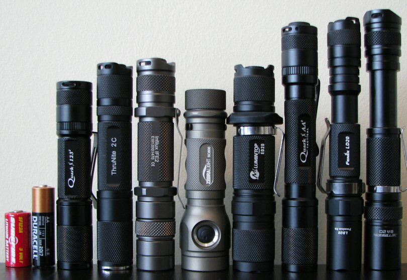

    From left to right: Surefire CR123A, Duracell AA, 4Sevens Quark 123-2 X, Thrunite Neutron 2C, Nitecore IFE2, Zebralight SC600, Lumintop ED20, 4Sevens Quark AA-2 X, Fenix LD20-R4, Jetbeam BC20.
    All weights with no batteries.
    Q123-2 X (Regular tailcap): Weight: 44.6g, Length: 112.7mm, Width (bezel) 22.0mm
    QAA-2 X (Tactical tailcap): Weight: 60.1g, Length: 149.1mm, Width (bezel) 22.0mm

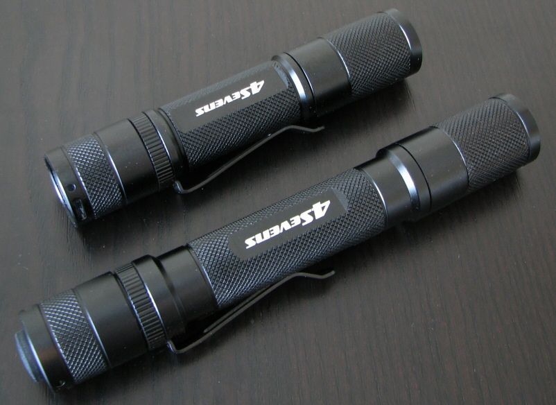

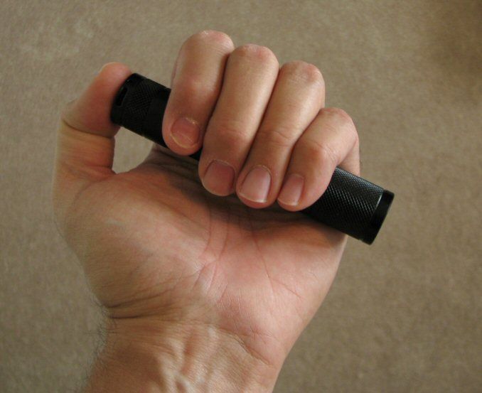

    The Quark series remains quite petite for their respective classes. You can see the Q123-2 X is slightly smaller than even the Thrunite Neutron 2C or Lumintop ED20. The QAA-2 X is slightly shorter than most of the competition.
    First off, note that build is unchanged with these new “X” versions of the Quark line. You can still lego (mix-and-match) heads, tailcaps and bodies across the whole line. That said, note that the Q123-2 uses a different head from the other models (i.e. QAA, QAA-2 and Q123 share a common head).
    Overall build quality remains high. Anodizing is type III (hard anodized), and lettering is fairly sharp and clear. Overall fit and finish is very good on both samples. There is a generous amount of knurling to help with grip (reasonably aggressive). Screw threads are square-cut, as before.

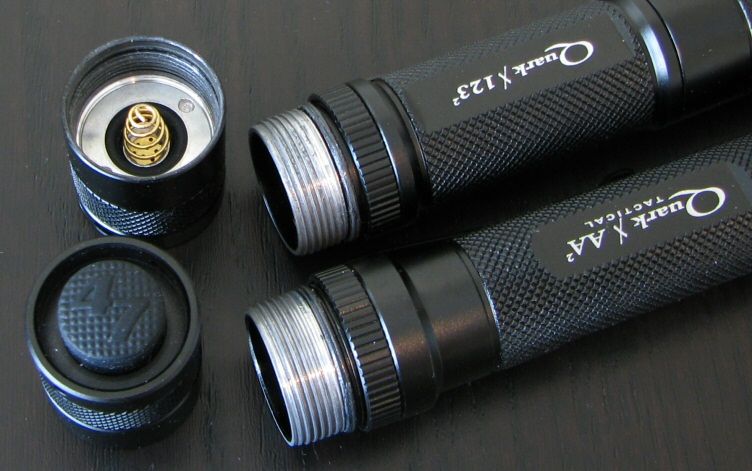

    Also as before, there is a removable single-direction clip, attached by default to either the "tail" region of the battery tube. However, since the head and tailcaps are reversible on the battery tube, you can "switch" the direction of the clip by simply exchanging the head and tail regions. The clip is secured in place by its own removable cover/grip ring.
    Note there is anodizing on the tailcap threads, allowing you to lock-out the light. Most lights use a double-coating of anodizing (i.e. on both the tailcap and body portions of the threads), but that would prevent you from switching around the body tube in this case. I recommend you be careful not to damage the single coat of anodizing on the tailcap threads.
    Battery tubes are wide enough to accommodate protected cells, although the Q123-2 X may not be able to take all protected AW 17670 cells (18650 certainly won’t fit).
    Regular versions use a standard reverse clicky, with a fairly typical feel (maybe a bit stiffer than some). The lights can tailstand on these Regular series Quarks. The Tactical versions use a protruding forward clicky switch, and are capable of momentary action (but of course, cannot tailstand).

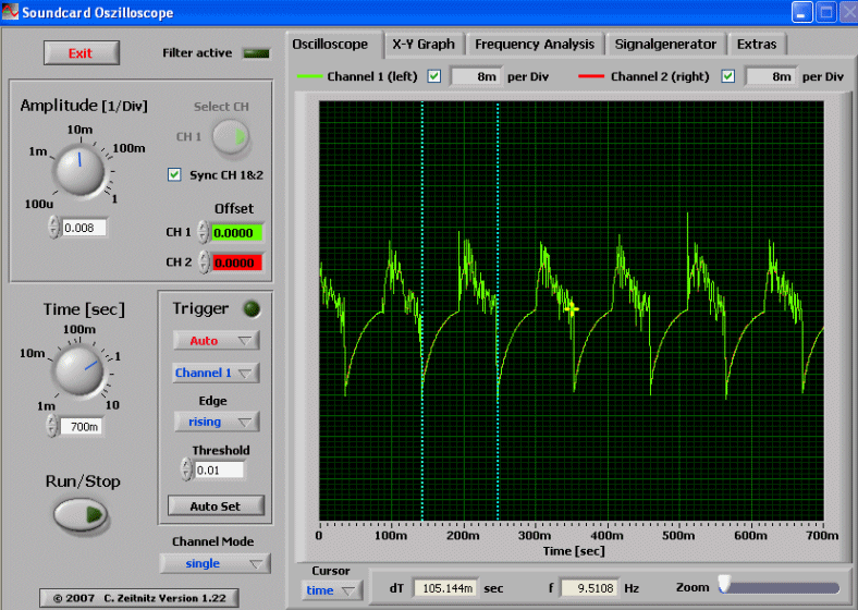

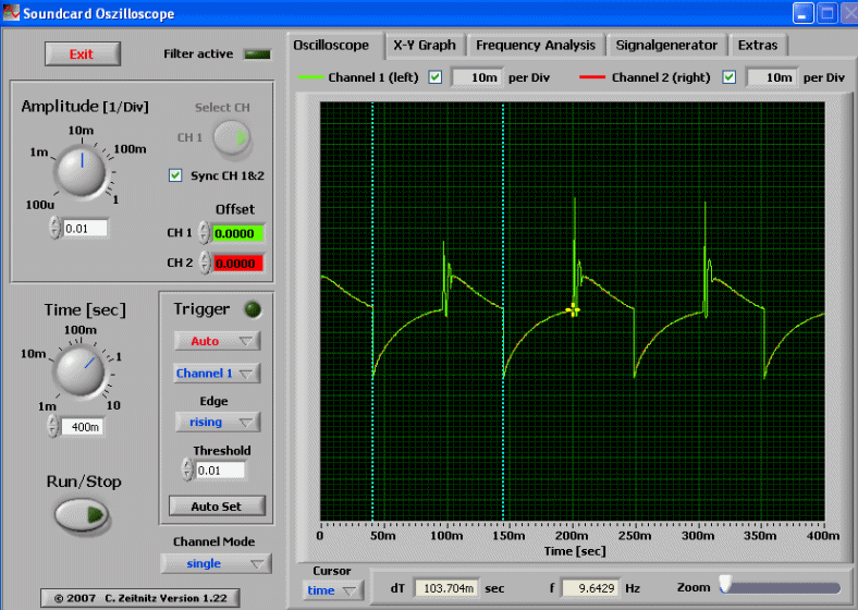

    PWM/Strobe
    Q123-2 X
    QAA-2 X
    Strobe was a rapid ~9.5 Hz on both lights.
    There was no evidence of PWM on any output level . As before, I believe the Quark X series lights are current-controlled.

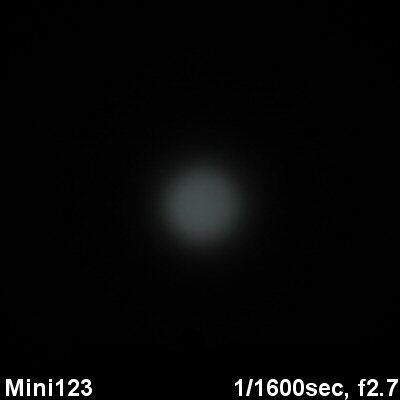

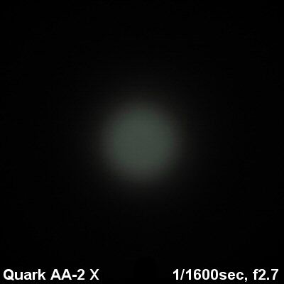

    As before, the Quark reflector has a light-to-medium orange peel (textured) reflector, to help smooth out the beam. The reflector is fairly small, suggesting these lights will not be great throwers. The opening of the base of the reflector is larger than before, to accommodate the larger XM-L die. Emitters were well centered on my samples.
    For white-wall beamshots, all lights are on 1x3.7V Li-ion (18650 or 17670) for Q123-2 X comparisons, 2xSanyo Eneloop for the QAA-2 X comparisons. Lights are about ~0.75 meter from the wall (with the camera ~1.25 meters back from the wall). Automatic white balance on the camera, to minimize tint differences. All beamshots taken immediately upon activation.
    Q123-2 X Comparisons
    QAA-2 X Comparisons

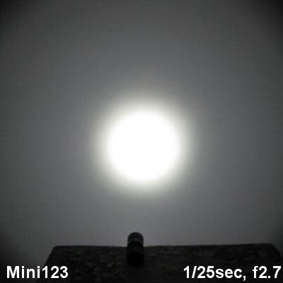

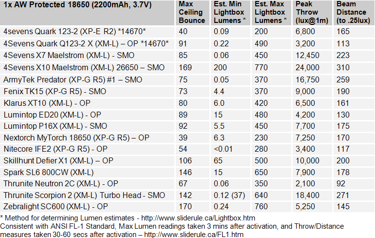

    As expected, the beam profile is fairly floody on the new X Quarks. Spillbeam width is similar to other Quarks models (and wider than the Thrunite Neutron XM-L models, for example)

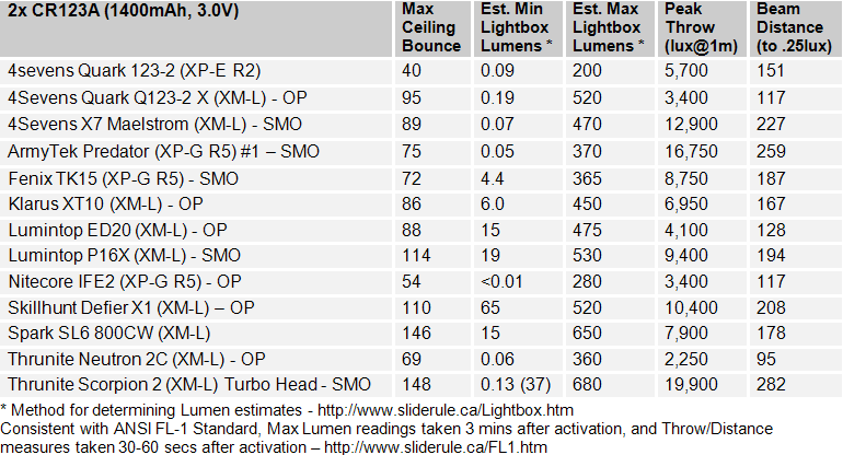

    QAA-2 X Comparisons

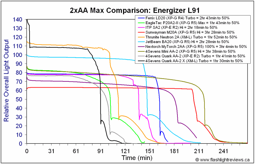

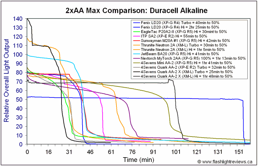

    Note: There is now a step-down feature just after 3 mins runtime on max, designed to help limit thermal issues on extended runs. For the Q123-2 X, output drops from ~520 estimated lumens to ~400 estimated lumens, while the QAA-2 X drops from ~400 estimated lumens to ~300 estimated lumens. I put the higher lumen values in the table, as that is what I measured at exactly 3 mins into the run (i.e. just before the drop).
    As you can see, neither light is a great thrower – but initial output is impressive for the class/size light.

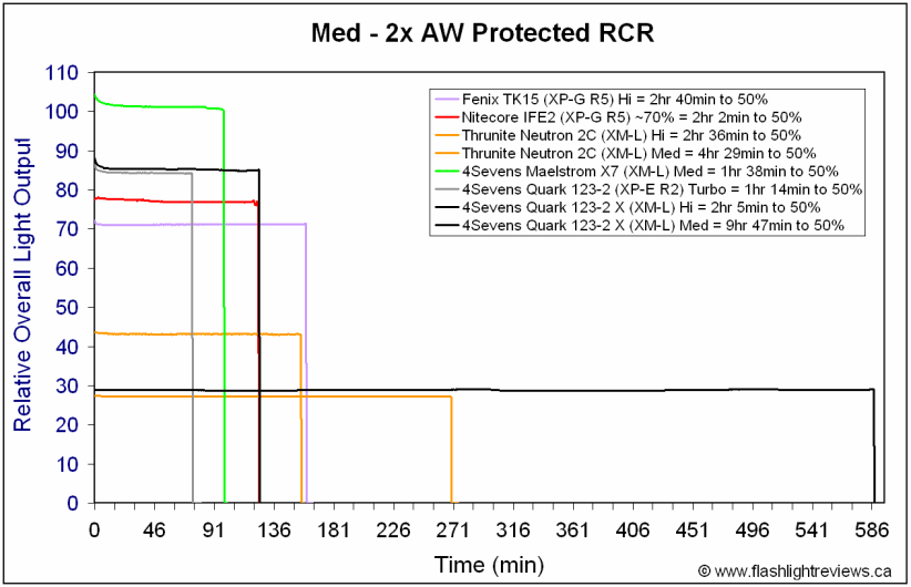

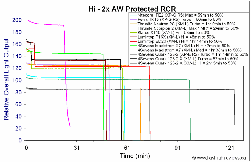

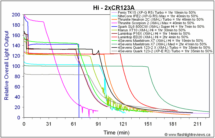

    Output/Runtime Comparison:
    QAA-2 X Comparisons
    For both lights, initial output is very high for their respective classes. You can see the step-down in output after 3 mins runtime on max.
    Runtime efficiency is typically top-of-class.

    In this case, the runtime efficiency of the Quark X models seems excellent at the levels tested. I was particularly struck by the runtime advantage on the QAA-2 X model on Hi (i.e. one down from Turbo). It is also the brightest 2xAA light I’ve seen yet (on Turbo).
    These Quark X samples both had smooth beams, with reasonably wide spillbeams (and well-centered emitters). Note also that XM-L emitters produce floodier beams compared to XP-G (when comparable optics are used), due to the larger die size of the XM-L. Subjectively, this will over make XM-L-based lights seem even brighter at close distances or in confined spaces, but will make them appear dimmer at further distances.
    The step-down feature after 3 mins on Turbo is a reasonable upgrade to the circuit. This is something I am seeing more and more often among XM-L lights, and it makes good thermal sense (especially in the case of small lights such as these). You can always restore max initial output by simply turning the light off-on or switching the bezel to low/tight, but I don’t recommend you do that on small mass lights.

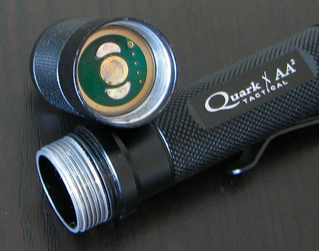

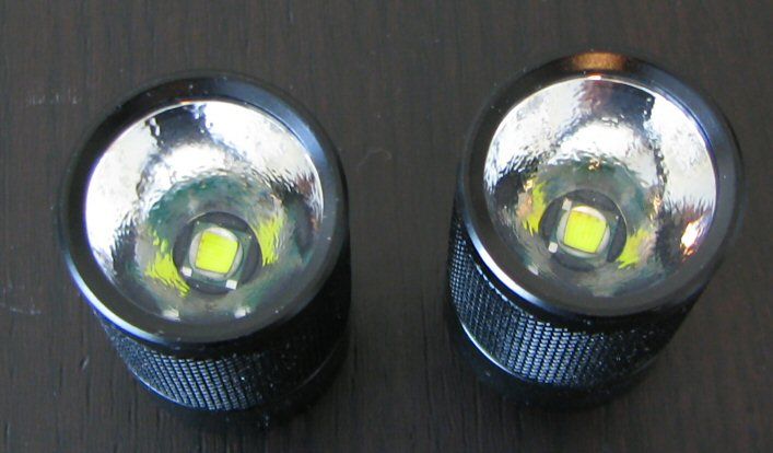

    I am looking at this photo:
    I am wondering why flashlight manufacturers don't use an isolation disk that covers the emitter and shows the dome part only. Frankly, I am a bit irked by that.
    Here's my olight sr50's sst-50 for comparison. Much neater don't you think?

    Quote Originally Posted by ganymede View Post
    selfbuilt,
    Thanks for the great review and your finger has healed!
    LUMINTOP ED20 also have clean implementation of XML:

    That shrouding would be just for looks. It makes sense to install as much reflector as possible.
    +that allows for some different curvature, (than a straight parabola) which helps to mix the color/light that comes from the edge.

    Thanks for the review! Would it be possible to add runtime on 17670 or 14670 for the 123-2? I would like to see the regulation with a single li-ion
    Default Re: 4Sevens Quark AA-2 X and 123-2 X Review (XM-L): RUNTIMES, BEAMSHOTS and more!
    Ok, here is the QAA-2 X on L91, on Turbo:
    Quote Originally Posted by Lagerregal View Post
    I will try to get to that soon (a little swamped with reviews right now). I don't have much to compare it to on that battery, but show it against typical 18650 lights. Hopefully sometime tomorrow ...
    Excellent review !!!!.
    Here you go:
    Note that output is just a touch lower on 17670, compared to 2x sources (i.e. ~490 estimated lumens at 3 min). Runtime seems good, considering the lower capacity of the 17670 cell.
    May 2009
    Germany, RLP
    39
    Here you go:
    Thank you!
    Thank you!
    Sorry, just realized there was an error in the figure legend. As you can probably tell, the solid black line in the new X version. I've uploaded a corrected legend for the graph.

    With 2x AW rcr123's is the graph showing the correct Est. Min. Lightbox Lumens of 2.3 or is it supposed to be .23?
    Hi Selfbuilt. Thanks for the awesome review again.
    Would it be possible for you to put up your lumens figures for the other output levels as well? Like low, medium, and high. I'm wondering whether there's also a large difference in the actual lumens figures you get for those other levels compared to 4seven's figures, like on turbo (400 vs 280).
