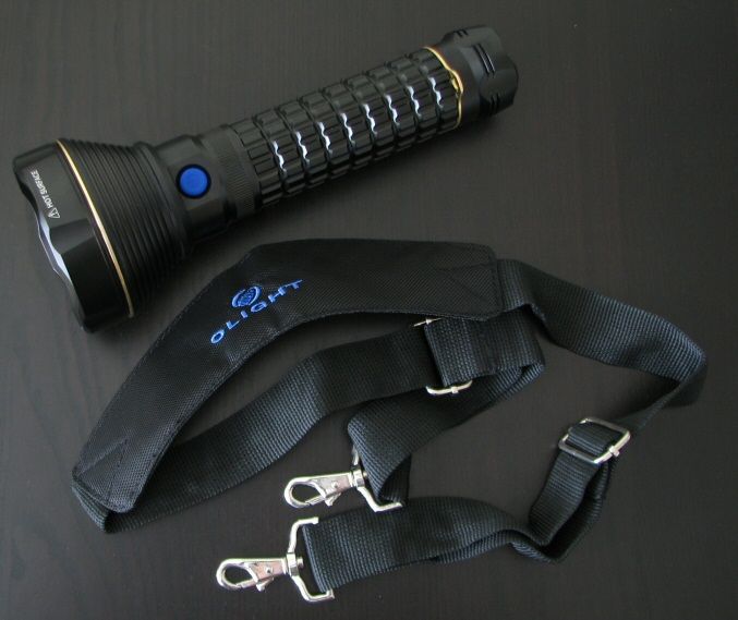

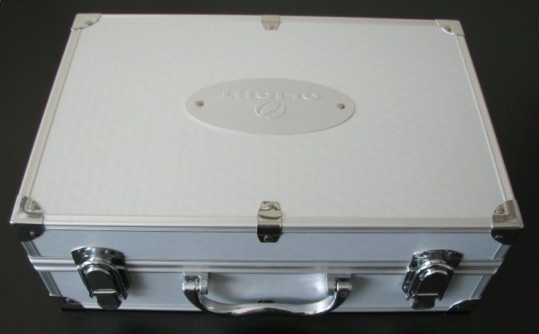

    Packaging is high-end for the Olight SR-series lights. Inside the large presentation carry case (with metal hinges and closing clasps) you will find the light, AC battery charger and cable, good-quality shoulder holster, battery pack cover, extra o-rings and manual – all securely packaged in cut-out foam.

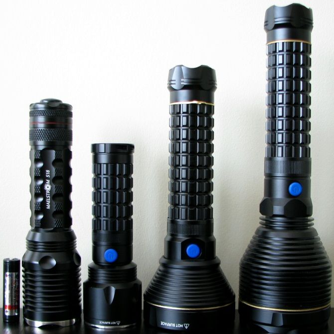

    From left to right: AW Protected 18650, 4Sevens S18, Olight SR51, Olight SR92, Olight SR90.
    Olight SR92: Weight: 1.15 kg (with battery pack), Length: 271mm, Width (bezel): 98mm
    Olight SR90: Weight: 1.6 kg (with battery pack), Length: 335mm, Width (bezel): 97mm
    4Sevens S18: Weight: 700g (800g with 6xCR123A), Length: 233mm, Width (bezel) 63.0mm, (tailcap) 25.6mm
    While still a hefty light, the SR92 is definitely shorter and lighter than the SR90 (which has a much larger head and reflector to focus the single SST-90 emitter). Note that the battery pack is common to both lights.

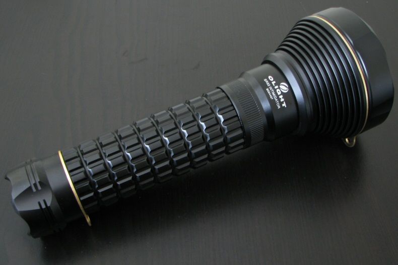

    Fit and finish remain excellent – there are no chips or marks in the anodizing on my SR92 sample. The gold-colored rings used to anchor the shoulder straps have some wobble along their length (i.e. not perfectly flat), but seem to be held in place fairly securely (you can rotate them to adjust the exact positioning). The shoulder strap is high-quality, and works well to carry the light (the shoulder pad is helpful in preventing it from falling off your shoulder).
    As before, lettering is sharp and clear, in bright white against the dark black gloss background. Ridge detail is fairly high on the handle, so grip is good.

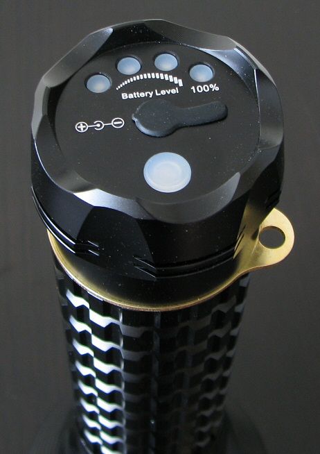

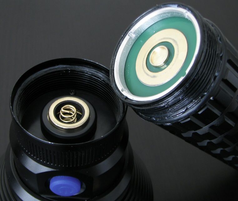

    The battery pack/handle comes with a contact cover (for use when not screwed into the head). Also, you can purchase additional battery packs (which can be charged independently of the head). It is good to be able to cover the contacts when not in use. Note the tailcap is removable from the rest of the handle/battery pack as well.
    The charger attaches at the tail-end of the light (just under that rubber protective strip – similar to what you will find on a lot of camera ports). Also on the tail is a battery read-out gauge. Press the bottom button, and up to 4 green LEDs light up to let you know the relative charge status of the battery. Along with the no-light condition, that means five possible states - each of which is linearly distributed along charge capacity (i.e. 4 lights means 80%+ power remaining, 3 lights is 60-80%, 2 lights is 40-60%, 1 light is 20-40%, and no light means less than 20%).
    As before, the SR92 battery gauge seems fairly accurate – as long as you only test when not running or charging the battery. If the light has been in use recently, you should wait a few seconds after turning off/disconnecting, in order to get an accurate reading.
    The light can tailstand with the tailcap installed.
    Although the switch acts like a reverse-clicky, it is in fact a momentary switch that is programmed to turn the light on/off when you release it. As such, there is bound to be a small standby current drain when the battery is connected, but it is probably insignificant. You can twist the head one and a half-turns to lock-out the light.

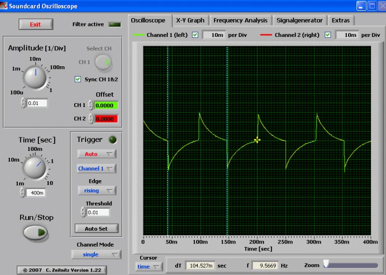

    PWM/Strobe
    Strobe on the SR92 is a typical fast "tactical" strobe at 9.6 Hz. This is the same as the early SR90 I reviewed.
    There is no sign of PWM on Lo, I believe the SR92 is current-controlled.

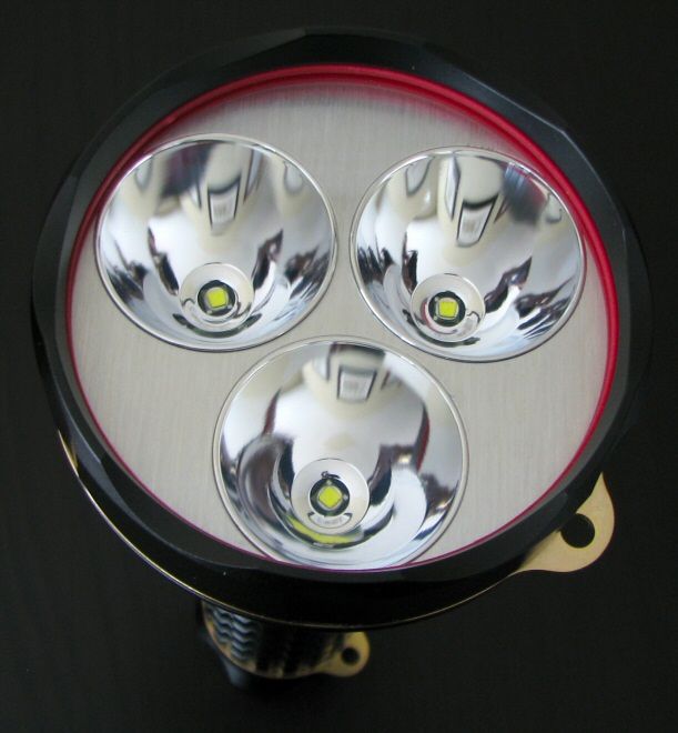

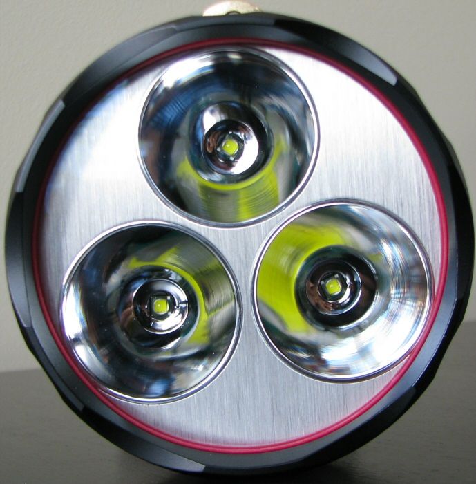

    The SR92 uses 3x Cree XM-L emitters (T6 bin according to spec), each within its own defined reflector well. Each reflector has a smooth finish, and is not very deep. I would expect reasonable throw at a distance, but nowhere near the original SR90 (with its huge deep reflector and single SST-90 emitter).

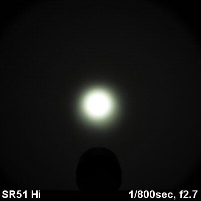

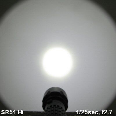

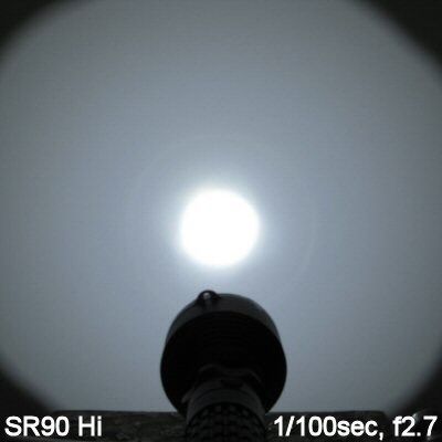

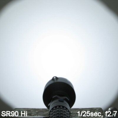

    And now the white-wall beamshots. All lights are on max output, on their typical battery configuration. Lights are about ~0.75 meter from a white wall (with the camera ~1.25 meters back from the wall). Automatic white balance on the camera, to minimize tint differences.
    The SR92 puts out a lot of light – slightly brighter than my SR90, although it is hard to compare up close (given the very different beam profiles). Obvously, this distance is not enough to allow the three individual emitter beams to converge.
    Note the SR92 beam is not as green as it seems in the pics above, but it definitely tends to the warm side of cool white. In contrast, my SR90 sample has a definite cooler beam (cooler than typical for cool white). Again, don't make a big deal about tint in these beamshots - your sample could vary considerably.

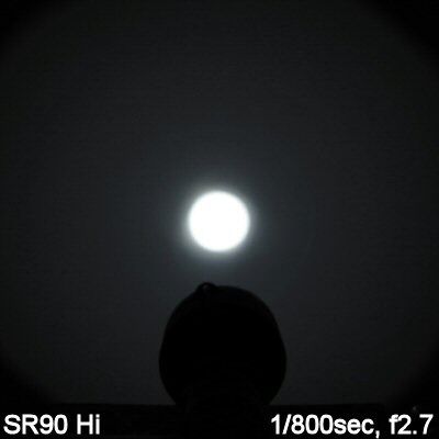

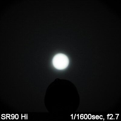

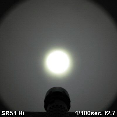

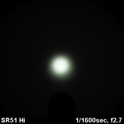

    I have now done 100-yard outdoor beamshots, in the style of my earlier 100-yard round-up reviews:
    Clearly, the SR92 puts out a lot of light – it just isn't as focused as the SR90. I think you should be able to see from these shots that the SR92 puts out more light overall than the 4Sevens S18 or Olight SR90. Scroll down to my Summary Tables for a more explicit comparison.
    Again, you can see the wider (and brighter) beam on Lo on the SR92.
    Overall output is hard to compare among these massive S&R type lights, especially given the divergent beam patterns. However, my ceiling bounce numbers match what I see by eye – the SR92 is definitely brighter than the SR90 or 4Sevens S18.
    My lumen estimates are very rough here, but I would estimate the SR92 comes on ~1800 lumens, and drops to ~1750 lumens at 3 mins. In contrast, I estimate my original SR90 is ~1500 lumens at ignition, and ~1400 lumens at 3 mins.
    Throw is a different matter – you can see the SR92 can't come anywhere near the heavily focused SR90 (i.e. closer to the smaller S18).

    Looking at how the triple LEDs are placed you see how much more refined this light is compared to the TK70.
    I don't have a TK70 to compare, but the head of the SR92 is impressive. They clearly have put a lot of thought into how to produce a pleasent multi-emitter beam pattern. But of course, it is not a great thrower in this configuration.

    Quote Originally Posted by Enzo View Post
    I wonder what you mean by that. The reflector in TK70 is designed for much more thrown than the SR92.
