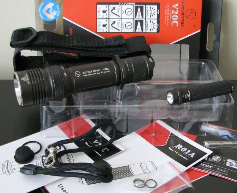

    Light comes with a good number of extras. Inside the packaging you will find the light, belt holster with closing flap, wrist lanyard, spare o-rings, tailcap button cover, and manual. Special bonus included with the light is a 1xAAA keychain light, with extra o-ring, small split-ring, and manual.

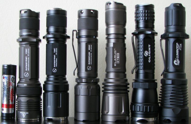

    From left to right: AW Protected 18650; Sunwayman V20C, T20C, M20C; Klarus XT-10; Olight M20; Lumintop P16X
    Sunwayman V20C: Weight: 117.4g, Length 133.0mm, Width (bezel) 32.2mm
    JetBeam RRT-21: Weight: 137.3g, Length143.3 mm, Width (bezel) 33.8mm
    Sunwayman T20C: Weight: 118.3g, Length 136.8mm, Width (bezel) 32.0mm
    Nitecore IFE2: Weight: 65.1g, Length 127.1mm, Width (bezel) 23.6mm
    Lumintop P16X: Weight 141.4g, Length 157.0mm, Width (bezel) 37.9mm
    Klarus XT10: Weight 121.3g, Length: 144.8, Width (bezel) 34.9mm

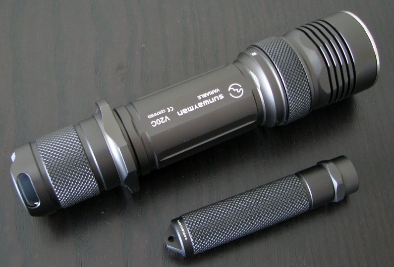

    The overall weight and dimensions of the V20C is about typical for this class, perhaps a bit on the small side compared to some lights.

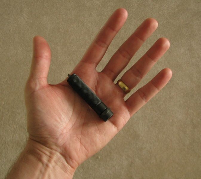

    Both the 1xAAA R01A keychain light and main V20C light are high quality. As always, anodizing is superb on my Sunwayman samples – a rich dark gray. Labels are clear and bright white.
    Overall build is similar to a number of earlier Sunwaman lights, except for the added presence of knurling on the tailcap and control ring of the V20C. Knurling is of reasonable aggressiveness. With the removable grip ring installed, I would say overall grip is good. There is generous knurling on the R01A.

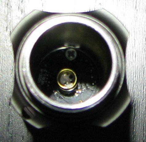

    Screw threads are square-cut and anodized on both lights, allowing for lock-out. I'm impressed that they managed square threads on the R01A – I don't think I've seen that before on a 1xAAA light.
    There is a spring on the positive contact plate in the head of the V20C, so higher capacity flat-top cells can be used.
    The V20C can tailstand.

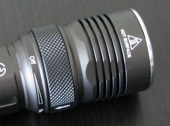

    There are clear detents and labels on the magnetic control ring for Off, Max, and Strobe.

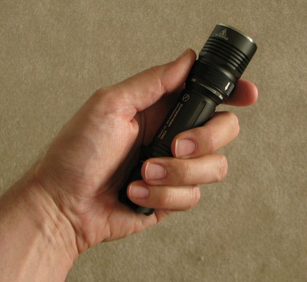

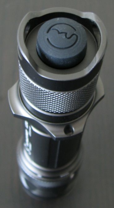

    The V20C has a forward tailcap clicky - press and release for momentary on, click for locked on.

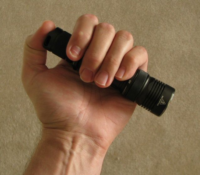

    Mode switching is controlled by the magnetic control ring in the head. The V20C features a continuously-variable interface – you control the output level by twisting the ring. You can select your desired mode while the light is off.
    The ring traverses a little over 1/4 of the circumference of the light. When holding the light in front of you, turning the ring clockwise (i.e. to the right) increases the output level. There is a clear and firm detent just below the minimum output, which is a standby "Off" mode. There is another clear detent at the Max mode. A little further past Max is another detent for the Strobe mode.
    The arrowhead on the control ring helps you line up the mode you are in, and the control ring has good grip thanks to the knurling.

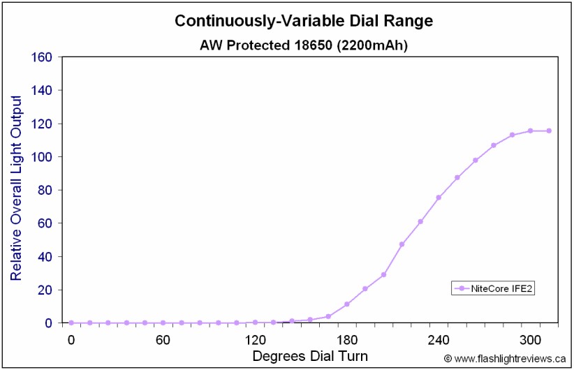

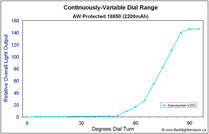

    Ramping Pattern

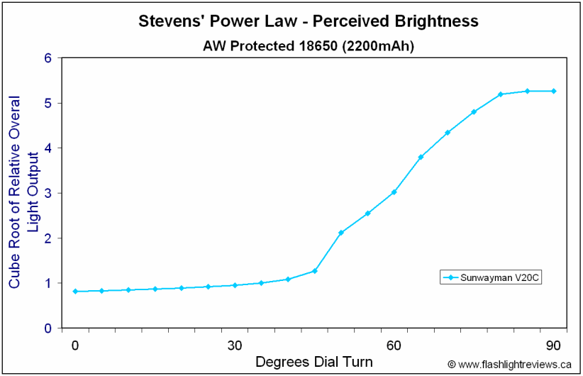

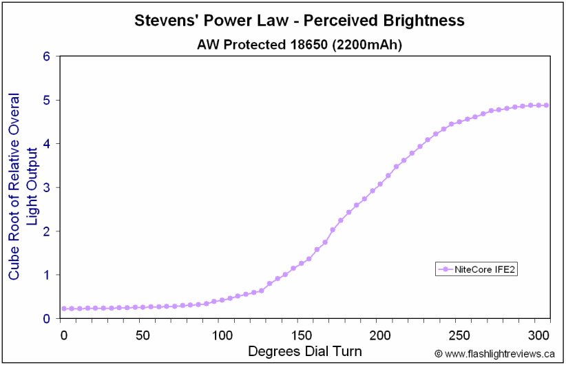

    The V20C uses what is basically known as a "visually-linear" ramp. Generally, here on the forums, that has been taken to mean a logarithmic ramp as opposed to an actual circuit-linear ramp of outputs. The reason for this is that we perceive brightness in a non-linear way (actually, not just brightness - most of our sensory perceptions are non-linear). This is part of why twice the lumens doesn't appear twice as bright to us - lumens are an objective (linear) measure of output, and our subjective perceptions are not linear. A logarithmic adjustment has long been used to try to compensate for our relative visual perceptions (e.g. the stops of camera are logarithmic).
    However a logarithmic adjustment is not entirely accurate – it is just a rough approximation of how our eyes and brain adapt to varying output levels (and one based on Victorian-era science at that). More extensive scientific research over the last several decades has revealed distinct power relationships that better correlate to our various relative sensory perceptions. For perceived brightness, the currently accepted linearization method is actually a cube root of output. For a full discussion of this - including detailed graphs and primary literature references - please see post #3 in my Sunwayman V10A review.
    To put that in practical context, here is what the V20C looks like in my lightbox, compared to two other lights of the same class that also use ramping control rings.

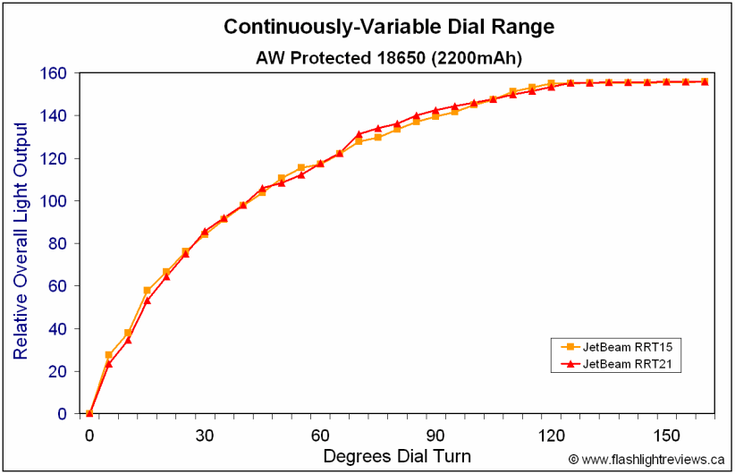

    The V20C has a similar pattern to the Nitecore IFE2, which differs from the JetBeam RRT-21/15. Looking at the above graphs, it may appear to you that there is something wrong with the V20C and IFE2 – nothing happens over the early portion of the ring. In fact, the light is adjusting the output – it is just that it does so in a non-linear fashion, starting at really low levels and slowly ramping up.

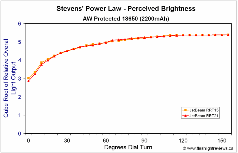

    A much better way to depict how we perceive this change is to plot the lightbox output on a cube-root scale, the Stevens’ power law relationship:
    This is what you can expect to see when you handle the lights. The V20C is very similar to the IFE2, in that you will spend a lot of time at the lower output levels upon initially turning the ring. This gives you very good dynamic control of the relative perceived brightness of the lights. Note also that like IFE2, the V20C goes to a much lower minimum output than most lights (see my Summary Tables later in this review for some lumen estimates).
    As many of you will have noticed, the V20C and IFE2 don't look entirely "visual-linear" on the graphs above (or in real life ). Again, I suspect the reason for this is that the ramp is actually logarithmic in circuit design, whereas we actually perceive relative brightness at something closer to a cube-root power relationship. Still, logarithmic is better than a regular circuit-linear ramp, which really doesn't match our relative perceptions at all. In the case of the RRT-21/15 above, you can see that you will spend most of the range of the dial choosing between near-maximal outputs.
    Personally, I prefer the nearly "visual-linear" logarithmic ramp of the V20C and IFE2, as they provide a better subjective experience – plus greater control over a wider dynamic range (thanks to the lower Lo modes). You just have to recognize that logarithmic doesn't fully correspond to how we perceive light, especially at the really low levels.

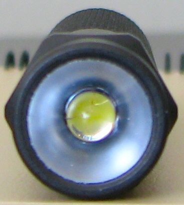

    The V20C uses a Cree XM-L emitter (well centered on my sample). Reflector is a light orange peel (textured reflector). Given that the reflector is fairly deep, I would expect throw to be pretty good for this size XM-L-based light.

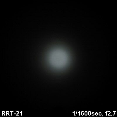

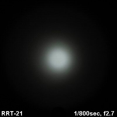

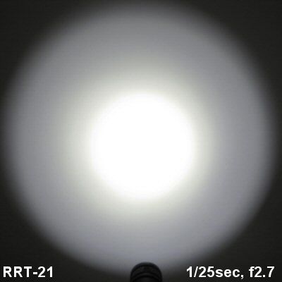

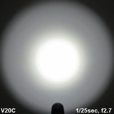

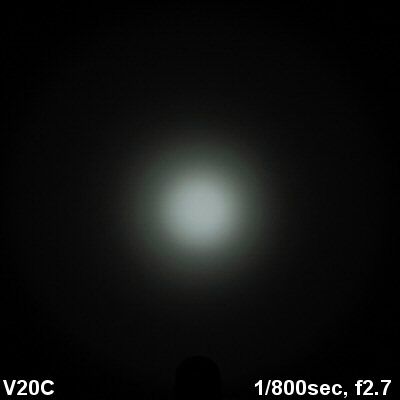

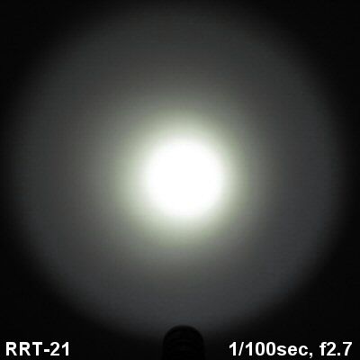

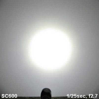

    And now the white-wall beamshots. All lights are on max output, on 1x18650. Lights are about ~0.75 meter from a white wall (with the camera ~1.25 meters back from the wall). Automatic white balance on the camera, to minimize tint differences.
    Beam profile of the V20C is remarkably similar to the JetBeam RRT-21. An overall balanced beam for a XM-L light.

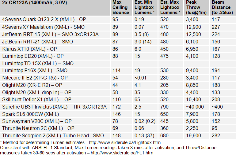

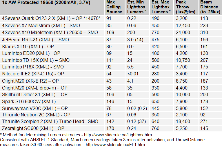

    Sunwayman's ANSI FL-1 max output estimate seems very believable to me – but the beam distance (throw) seems rather over-stated. As expected from the beamshots, overall output and throw are very similar to the JetBeam RRT-21 – just a touch lower on the V20C. Again, a good balanced beam, but not a heavy thrower.
    The V20C can do much lower Lo outputs than most lights – even lower than the rated 0.5 lumens in my testing. I’ve put two sets of Min values in the tables above for the recent ramping lights; the first number is the minimum output when ramping down the light (before hitting Off), the second number in brackets is the lowest output when ramping up from Off. Many of these lights come on at a slightly higher output than they can ramp down to.
    Output/Runtime Comparison:
    V20C runtimes are excellent - about what you would typically expect to see for a good-quality, defined-level 2xCR123A/1x18650 XM-L-based light. Considering the V20C is continuously-variable (with a much greater range of outputs), that is very impressive.

    Given the recent release of the JetBeam RRT-21, I am sure a lot of users would like to know how it compares to the V20C.
    I don't normally make direct commentary comparisons, but this is an unusual situation - these continuously-variable lights have almost identical beams, similar max output, and virtually identical output/runtime efficiencies at all levels. When you consider both builds are very high quality, how do you choose between them?
    The main difference is the V20C has a "visually-linear" ramp with a much greater number of low levels (absolute min output is much lower). It also has a much lower standby drain (although that shouldn't matter, as you should always store the light clicked off or locked out). The traverse of the control ring on the V20C is also a lot less than the RRT-21 (i.e. about half), and the RRT-21 lacks any labels on its ring. The V20C is also marginally smaller, so may be easier to pocket.
    Personally, my ideal is probably somewhere in-between these differences (i.e. I like the ring traverse length of the RRT-21, but wished it had the visually-linear ramp and lower outputs of the V20C). I also personally like a minimum of labeling.
    At the end of the day, I don't think you would go wrong with either – performance and overall build is comparable, so it really comes down to the specifics of the control interface. I recommend you decide on your relative preference for the ring characteristics and overall build styling.

    Selfbuilt,
    In your video review, you mention that many new variable output designs are using continuously-visual ramping circuits. Could someone give me a list of lights that ramp in this way for 1x18650s besides the Nitecore IFE2 (which is discontinued?)? Thanks!
    Jonathan
    6,936
    Default Re: Sunwayman V20C Variable (XM-L, 1x18650/2xCR123A) Review: RUNTIMES, BEAMSHOTS, VID
    Quote Originally Posted by Jon_tom View Post
    There is not a lot in the 1x18650 class with "visually linear" control ring ramps, but Nitecore, Sunwayman and Jetbeam have all been known to use them on some models (although the Jetbeam RRT-15 an RRT-21 were not visually linear). The Crelant lights (press and hold ramps) are fairly visually linear.
    I'm currently testing the Nitecore SRT7, and it has an interesting version of a "visually linear" ramp. I'll know more when I complete that review - working on the testing now.
    Oh, and
    Oh, and
    Thanks so much for your reply! I'm looking forward to the whole SRT series so I'm excited to hear your working on a review.
    And thanks for the welcome.

    I just received my V20C. And I throughly enjoy it.
    It is not as bright as others but plenty bright enough.
    H main reason I got it was he variable adjustment ring. This should be a standard, all the diff button operations of most of the flashlights are a pain.
    I really liked Nitecore design and now I see the SRT7 is out with an adjustment ring, a ton of throw, and a nice kudo of the different color modes. Arghh....
    You should do a review of the lights with variable adj rings....
