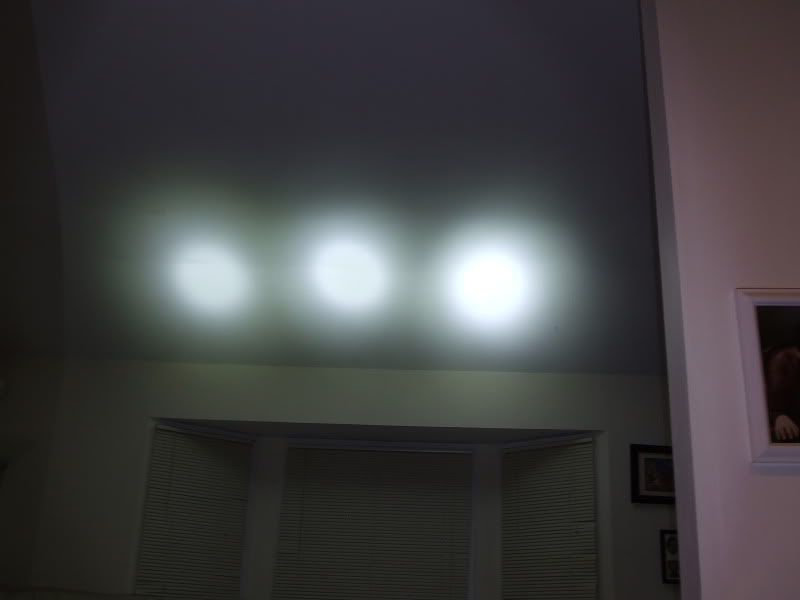

    Here's some indoor whitewall beamshots of XMLs in the various reflectors. Unfortunately, drive currents differ, so direct comparisons of intensity are not possible.
    First up. An XML in the V-65C reflector a 3.4A on the left, followed by XMLs in two Mag Rebels at 4.2A and 5.0A in the middle and on the right. You can see how the beam profiles are nearly identical:

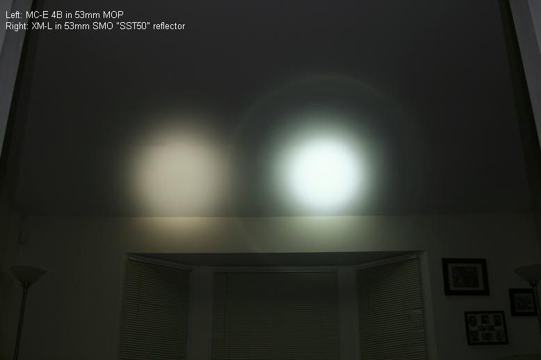

    Next, the SST-50 reflector, on the right. JPG compression made the hotspots blotchy, but this photo demonstrates the corona of this reflector very well:

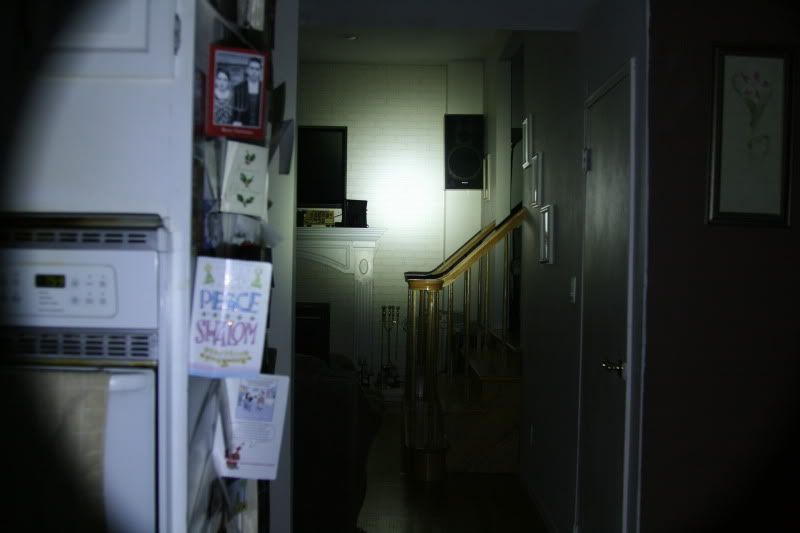

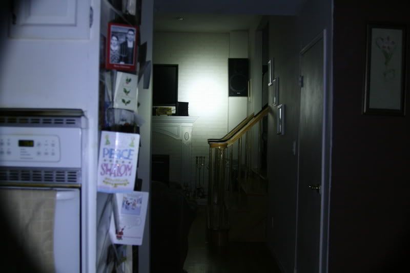

    And some more shots against a brick wall:
    Mag Rebel, 4.2A drive current:
    SacredFire V-65C, 3.4A:

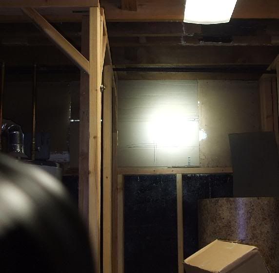

    Finally, this is a neutral white XML driven at 3.5A in a reflector identical to the SST-50 reflector, only with the LED opening bored smaller for the XML...
    From 12ft:
    Up close, on very low current (the one on the RIGHT):

    Wow, thanks for all that great info Techjunkie. When I look at the 3rd and 4th beamshots it actually looks like the sacredfire's hotspot is brighter than the maglite's on my moniter. Does it look different on yours?
    By the way have you ever done lux readings with any of these lights? If the sacredfire's reflector is really that good I might buy it. One other I noticed though is that the sacredfire is an XR-E based light. How come the reflector works so well with the XM-L?
