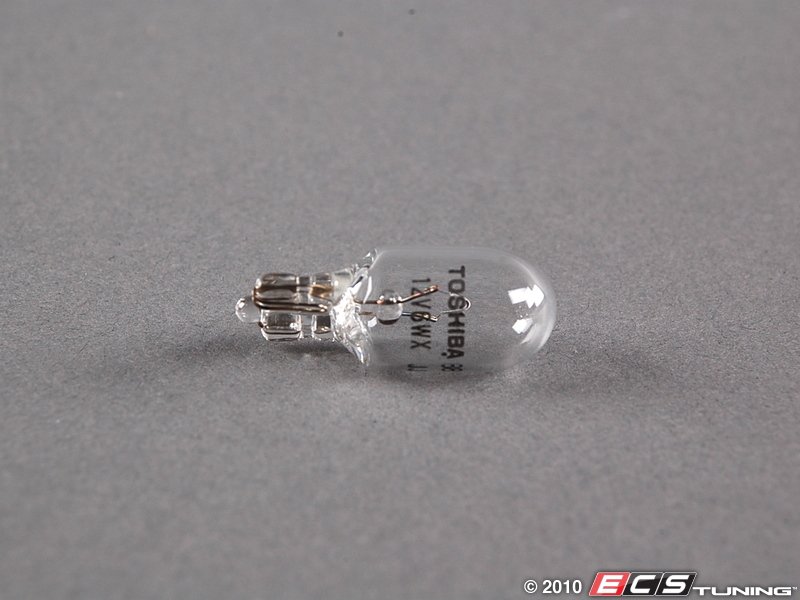

    So I was looking into replacing my OEM dome lights with LEDs, so I wanted to search the OEM bulb specs to form a basis for comparison...to see just how much output would be lost in going to LED over the incandescents. To my surprise, I've uncovered a wedge bulb that is brighter than even W5Ws!
    Here is the site that helped me to locate the bulb:
    http://realoem.com/bmw/showparts.do?...69&hg=63&fg=30
    Then with some googling, I found specs on this bulb:
    http://html.alldatasheet.com/html-pd...1/1260XLF.html
    So it's 6W and xenon gas filled, and rated at 85 lumens. It fits where your typical 194, 168, or W5W normally would. And it should be easily/cheaply purchased at any BMW dealer. Suffice it to say, I won't be replacing these with LEDs anytime soon! But I thought I would pass along the find to anyone who wants to try these out to brighten their wedge bulbs. I'll be experimenting with these on my wife's car.

    New source, but not new bulb. Osram #2886X is the 6w Xenon 85-lumen direct replacement for W5W, been the favorite upgrade replacement for W5W (168, 194, etc.) for quite a few years. 9mm bayonet-base version (replacing T4W) is 3886X, and double-ended festoon version (replacing C5W) is 6486X. All of them are about $4/ea at Candlepower and probably other vendors, too; I hesitate to imagine what BMW charges for it.

    Concerning the pictured bulb, is it going a bit too far to remove the labeling from it? You know, because it does add a bit of shadowing to the light and all that. What is the recommended process to do that with?
    Wow...that's a level of obsession I haven't experienced. Maybe denatured alcohol would remove it? Personally, I wouldn't bother.
    Default Re: Interesting find...BRIGHT sidemarker wedge bulb found
    Time/usage will take care of that writing on the bulbs all by itself.My Infiniti Q45 came from the factory with Toshiba bulbs installed everywhere,and the wedge bulbs writing on them has faded so much that it is almost impossible to see. {good quality bulbs too, as almost every one of the interior bulbs{and outside side markers & tag lamps} are still original at 16 years and 283,000 miles of usage !
