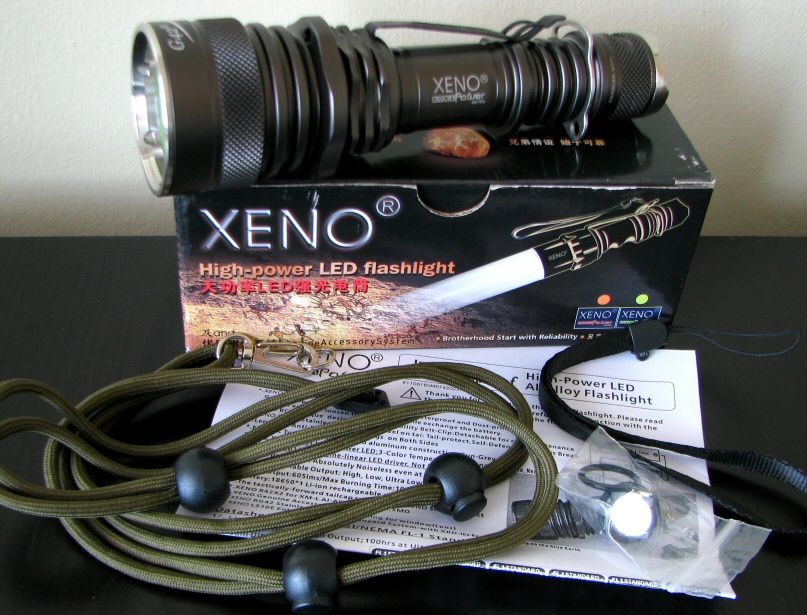

    Packaging is fairly basic (I wouldn't really call this a gift box ), but the number of accessories are reasonable. Along with light (with lanyard ring and sturdy clip attached), you get an extended-length paracord lanyard, simple nylon lanyard, extra o-rings, extra switch and manual.

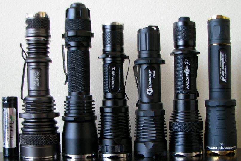

    From left to right: Redilast Protected 18650; Xeno G42, Thrunite Scorpion V2 Turbo; Lumintop TD15X, P16X; 4Sevens X7; ArmyTek Predator
    Xeno G42: Weight: 224.3g, Length 161mm, Width (bezel) 46.6mm
    4Sevens X7: Weight 146.9g, Length: 151.5mm, Width (bezel): 38.7mm
    Scorpion V2 with Turbo Head: Weight: 188.3g, Length: 171mm, Width: 41.0 (bezel), 37.0mm (tailcap grip ring)
    TD-15X: Weight 150.3g (no batteries), Length 147.3mm, Width: 37.8mm (bezel)
    The overall weight and dimensions of the G42 are typically slightly larger than most "thrower" class XM-L lights. I would expect above-average throw, given the size of the reflector.

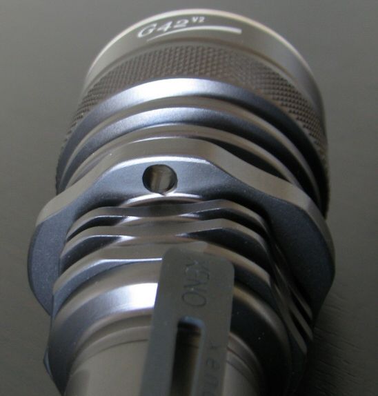

    The G42 has a very distinctive design, with a more rakish appearance than most lights.

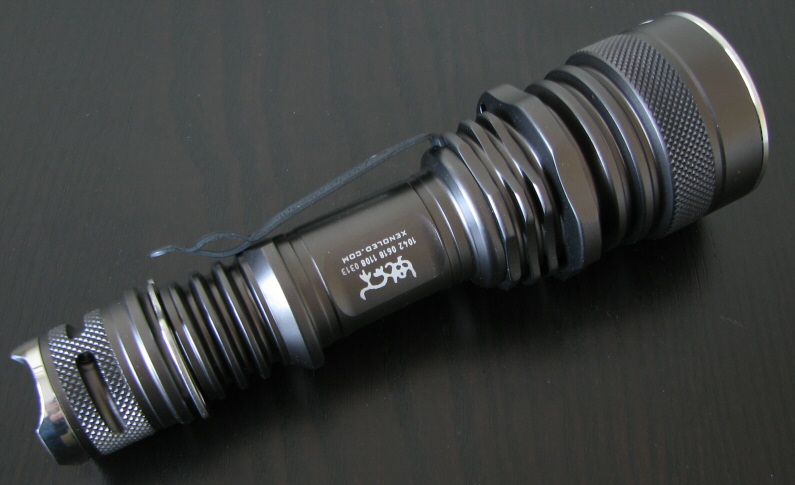

    Let start with overall build – the G42 has a lot of raised concentric rings around the body of the light (presumably to help with grip). There is a built-in clip that seems quite sturdy and high quality. It is apparently removable, but you have to completely disassemble the light to do it (i.e. remove the pill, etc.), which is not recommended.
    Light has excellent quality anodizing, in a dark grey finish that is very reminiscent of recent Sunwayman and JetBeam lights. There are two bands of knurling, one around the bezel and one around the tailcap. Both are fairly aggressive. I would say that grip is definitely good with this light!
    Light features stainless steel bezel and tailcap rings (flat on the bezel, scalloped on the tailcap).

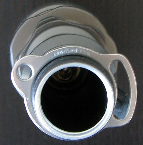

    Some distinctive features for lanyard attachment:
    The G42 has a LOT of places to attach a lanyard, both on the removable ring, and built-in to the body/tailcap housing.
    The G42 also has a lot of labels, although most of these are fairly inconspicuous, as you can see above.

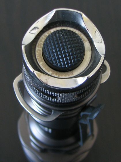

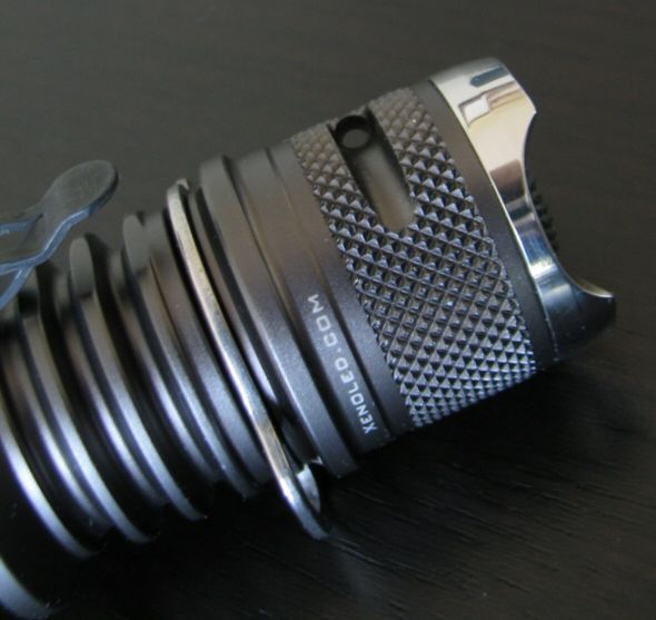

    Fairly traditional tailcap switch (forward clicky), in a solid tailcap end piece. Note the square-cut screw threads, fully anodized for tailcap lock-out.

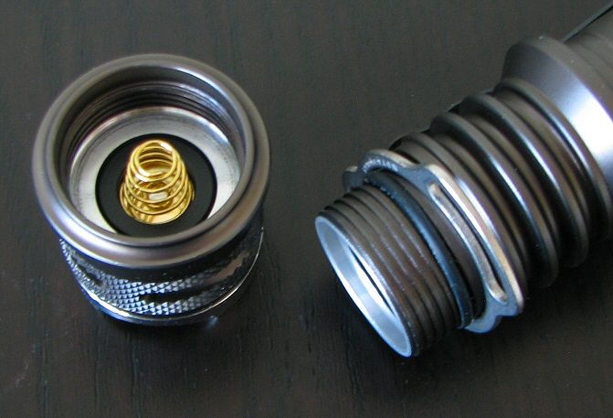

    There is also a spring in the head, allowing you to use the newer high-capacity flat-top 18650 cells. All my flat-top 18650 cells worked fine in the light.
    The G42 uses a forward tailcap clicky - press and release for momentary on, click for locked on.
    Mode switching is controlled by rapidly flashing the tailcap when the light if off. Sequence is Hi - Med – Lo, in repeating sequence. Just press further for locked-on activation once you find the mode you want.

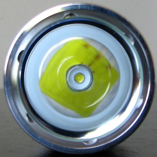

    The new G42 uses a Cree XM-L emitter, well centered on my sample. My sample came with the Cool White version of the XM-L, but Neutral White and Warm White are also available. Reflector is smooth and deep, likely to produce good throw.

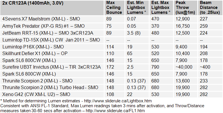

    The Xeno manual report ANSI FL-1 values for this emitter as 605 lumens max output and 22,8000 lux @1m (300m beam distance). Although I would estimate my sample is a little lower in output, the throw doesn't seem far off.

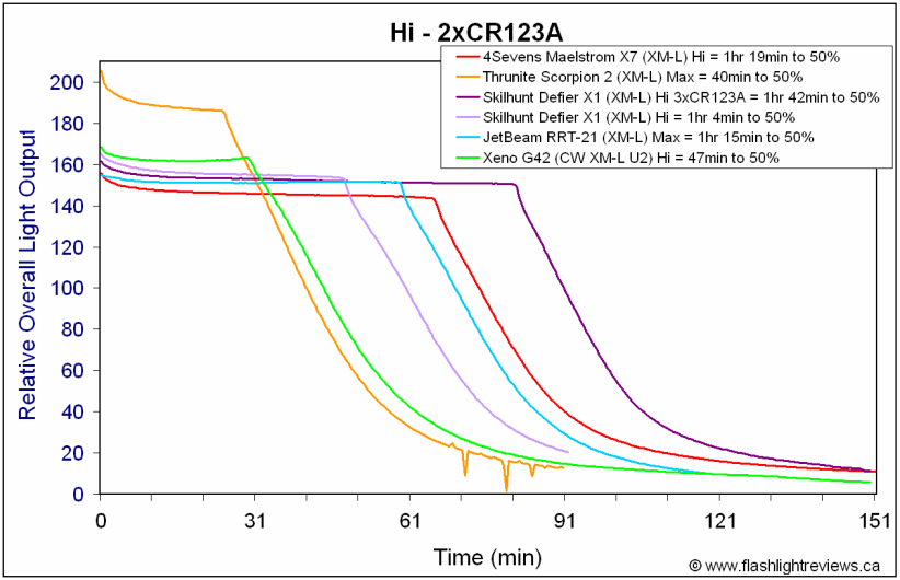

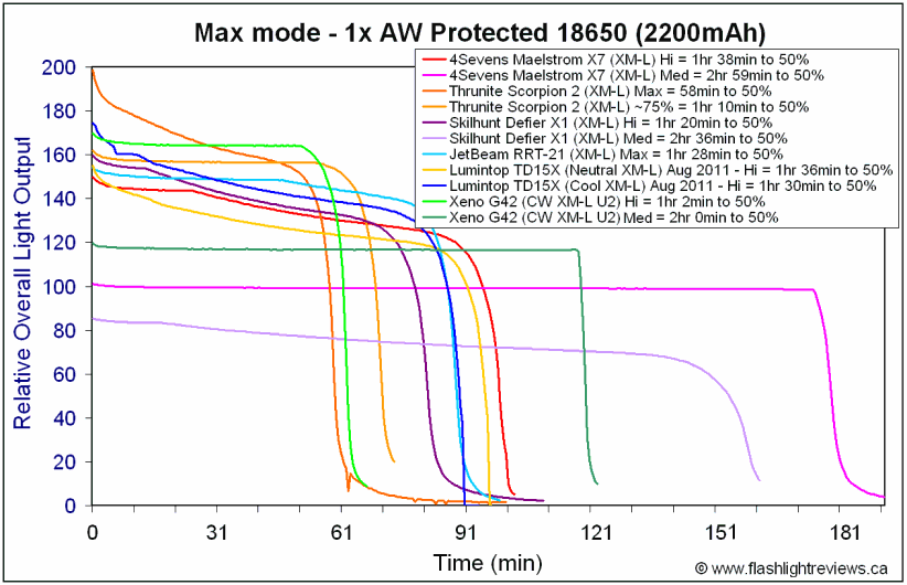

    Output/Runtime Comparison:
    The G42 is fully regulated on both 1x18650 and 2xCR123A (note 2xRCR not supported, which may have something to do with it). Runtime is reasonable, and consistent with Xeno reported specs on a 2600mAh battery.
    Light cannot signal in momentary mode, as flashing the forward clicky from Off advances through the output modes.
    2xRCR (16340) Li-ion is not supported.

    Aside from the build elements, the really distinctive feature of the light is the reflector – it has the best throwing beam I've seen for an 18650-class XM-L-based light. One feature of Xeno I really like is the availability of multiple tint bins (in this case Cool White U2, but Neutral White T5 and Warm White T4 are also available).

    Yes, just the throw/beam distance values from the manual to the review. The manual's lumen estimates are apparently ANSI FL-1.
    As you will see, my throw measurement is pretty close to the reported 22,800 lux @1m (300m beam distance).
