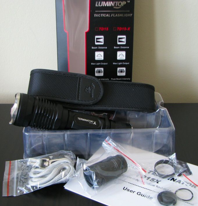

    Basic packaging hasn't changed much either – the light comes with a removable lanyard ring and clip (attached), and includes one battery tube extender (CR123A length), wrist lanyard, decent quality holster, spare o-rings and boot cap, and replacement cover for the attached pocket clip.

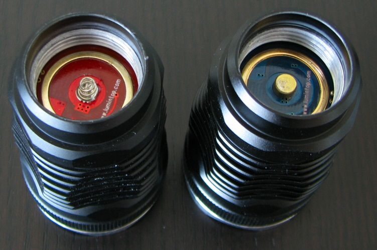

    So what has changed in the overall build? Aside from the option for a Neutral White emitter, the only change I noticed is in the contact plate in the head:
    Left is the new TD15X (with a red circuit board and spring on the positive contact), right is the original TD15X (with a small raised contact point).

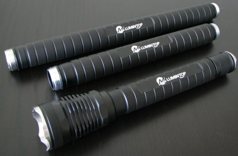

    Something new that Lumintop has sent along are dedicated battery tubes for 2x18650, 3x18650 and 4x18650. This latter size is a surprise to me, as I didn't think the circuit support that many cells.
    To date, they have only released these in the Asian market, but I understand they are interested to see if there is significant interest in the Western market as well. So speak up if you would like to see these offered at a vendor near you …

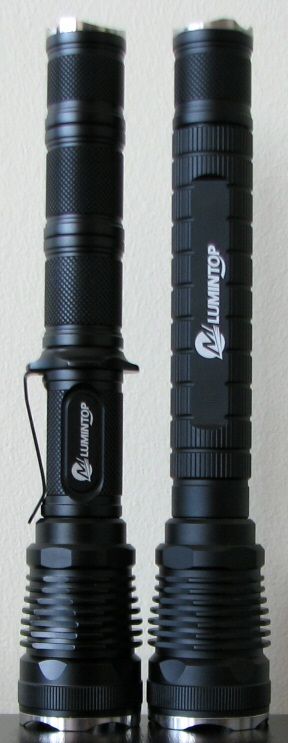

    Shown above is the 2x18650 body tube, compared to two extenders on the regular body tube.
    One nice feature is not having to worry about getting multiple extenders. I found the 2x18650 and 3x18650 worked well with all my various length cells. I haven't tried running the light on the 4x18650 battery tube.

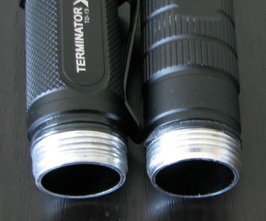

    Screw threading is of course exactly the same on these body tube replacements (i.e., you use the existing head and tailcap). Note the lack of anodizing on the tailcap end of the tubes. You should still be ok for lock-out given the anodizing within the tailcap, though.
    One thing these dedicated 2x, 3x, and 4x battery tubes lack is a clip or grip ring attachment point. While they have some ridge detail to help with grip, they lack dedicated knurling.

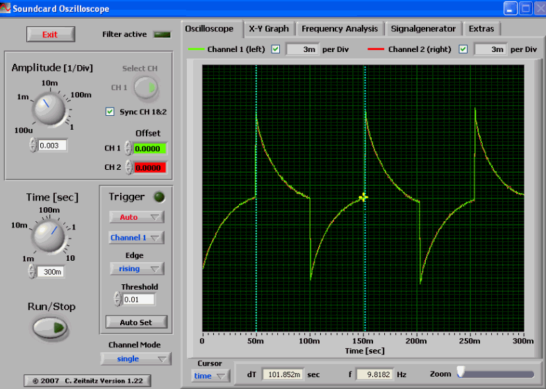

    PWM/Strobe
    As before, no sign of PWM on the TD15X – I believe the light is current-controlled for its Lo/Med modes.
    Strobe is unchanged from previous, 9.8 Hz on this sample.

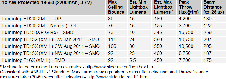

    First, here's a comparison of the original TD15 (XP-G R5) and Cool White TD15X from my original review:
    TD-15 (XP-G R5) on the left, TD-15X (XM-L) on the right.

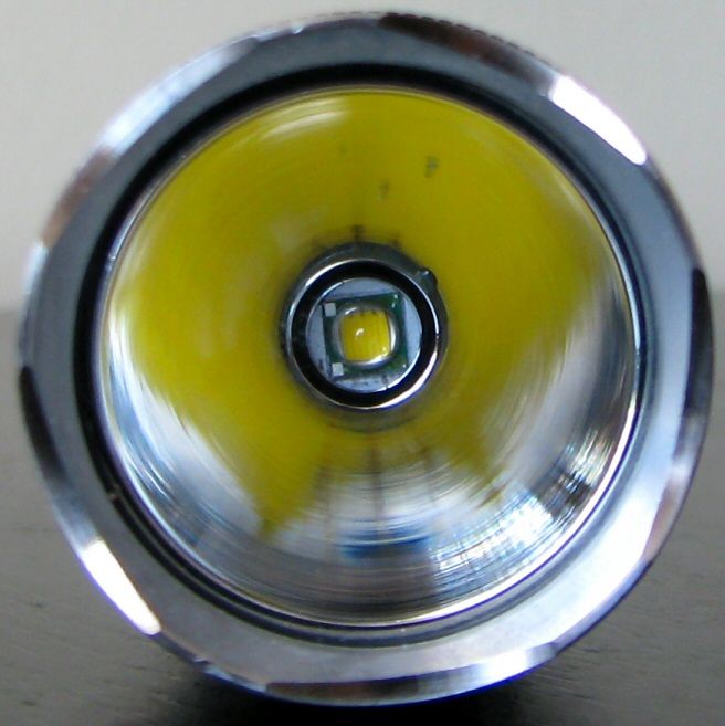

    The new samples don't look any different, but here are a few pics of the Neutral White emitter version:

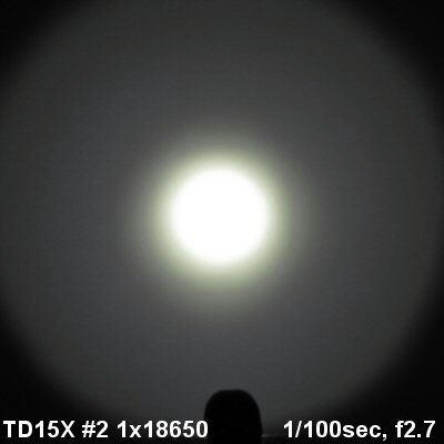

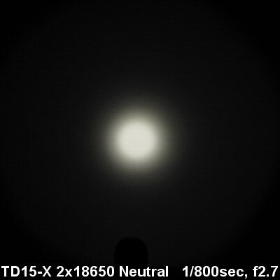

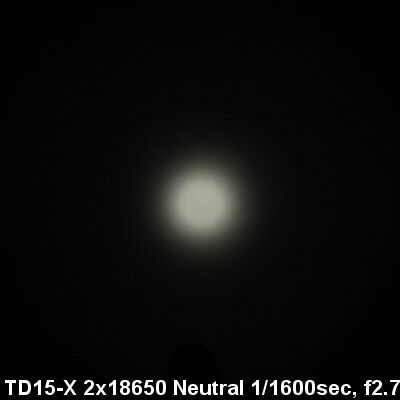

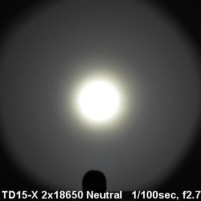

    Below I'm showing the new Cool White sample on 1x18650 ("TD15X #2"), followed by the Neutral White sample on 2x18650 ("TD15-X Neutral"), on max output, on 1x18650. Lights are about ~0.75 meter from a white wall (with the camera ~1.25 meters back from the wall).
    Sorry, I think I had the camera on automatic white balance (at least for the cool white shots), so tint differences are minimized. In real life, both the Cool White and Neutral White versions are comparable to other lights using these designations.
    Scroll down to my summary tables and runtimes graphs for more info.

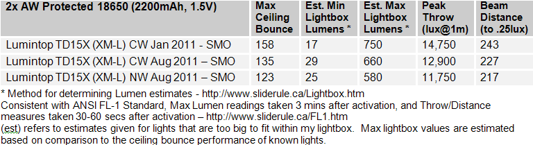

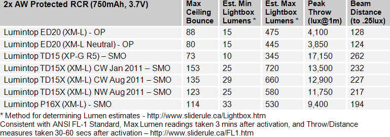

    I find my more recent Cool White version is not driven quite as hard on 2x battery sources as my original sample, but is otherwise pretty comparable. The Neutral white version has slightly lower output and throw, as expected.
    Output/Runtime Comparison:
    On 1x18650, the newer TD15X Cool White seems largely unchanged from my earlier TD15X Cool White.
    On 2x and 3x battery sources, there has been a clear change from the original build – the output now steps down after 5 mins runtime on max. This gives considerably longer runtimes now.
    In my original review of the TD15X, I expressed concern about the sustained drive levels on 2x and 3x battery sources (and the concomitant heat produced). With the new step-down feature at 5 mins, these concerns are largely assuaged.

    New dedicated 2x, 3x and 4x 18650 battery tubes have only minor ridge detail to help with grip (no clip or grip ring attachment point).

    Thanks for the update. Do you know if there any way to determine if one's TD15x has the step-down feature based on visual examination? I have a NW TD15x and it has the red circuit board like the "August" sample you show but the small raised contact point of the older version. Just wondering if Lumintop gave you any info, or if it could be presumed that if it doesn't have the spring on the lamp side, then it probably doesn't have the step-down. Seems a shame that it is so difficult to determine differences in circuit design that are rolled into ongoing production without test equipment.

    Do you know if there any way to determine if one's TD15x has the step-down feature based on visual examination? ... Seems a shame that it is so difficult to determine differences in circuit design that are rolled into ongoing production without test equipment.
    No, where is no way to tell externally. I've tested physically identical versions of the P16X (where they sell both circuits as options).
    But there's an easy to tell by using a stop-watch (or even a regular watch). The step down occurs at exactly the 5 min mark on my samples. All you need to do is start the timer (or pick a conveninent time to start), and begin watching the light output as the you near the 5 min mark. You will visually notice the step-down when it occurs, if it is there.
