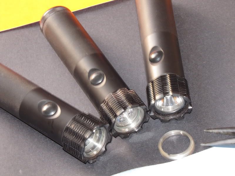

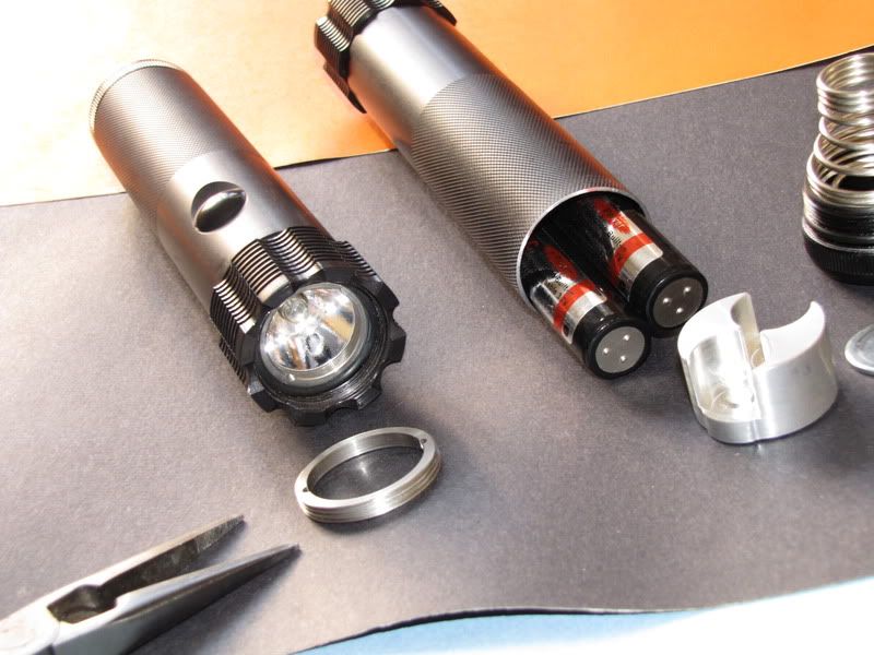

    Use a pair of needle nose pliers to install lamp module and lens.

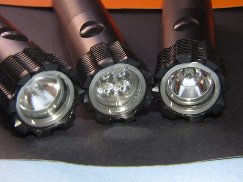

    Installed P60 on left, installed quad on mid picture and installed WA1111 on right picture.
    Hi folks, here is another creation from Fivemega.
    I have made very limited quantity of these and there will not be more. So it's your choice to grab one or regret for ever.
    A completly modified M*g D body with custom made D26 (P60 style) head, completly semi gloss (almost matte) hard anodized.
    Body is shortened and dual bored with integrated battery holder to accept 2 18650 in parallel for total of 4.2 volt. No serial version available but for 8.4 volt application, possible to use 4 IMR 18350 (all cells are positive in/negative to tail side)
    Head is custom made from one piece solid aluminum to accept any P60 stlye lamp/LED module.
    There is no bezel to cover head. module is directly seated into cave metal which is outside finned for maximum colling. There is no threads (gap) to interrupt heat transfering.
    There is one small stainless steel ring to hold lamp module and one little bigger stainless steel ring to hold UCL lens and of course high quality UCL lens from flashlightlens is included.
    There is one o'ring under lens, one o'ring on head and one o'ring on tail cap same as M*g

    2P 18650 host is designed for long run and can't take 4AA holder without boring.
    However, if bore out the barrel, 4AA will fit and work.
    Using 3100mAh 18650 cells you will get 6200 mAh @ 3.7 volt or 22.94 Wh
    Using 2700mAh AA cells you will get 2700mAh @ 4.8 volt or 12.96 Wh
