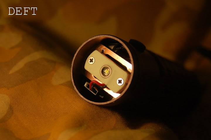

    Well I wasn't there when these lights were being fielded but you can clearly see the DEFT of solidly beating them. Look at the trees behind the pole. Notice the saturation of the colors and how you can see things back there that cannot be seen with the other lights. The DEFT was designed for spotting at distances far exceeding the target of those photos.
    I'm blown away at how well the VPT did against the SR90. Looks to me that it beats it despite being much smaller which is very hard to do. Seems I will have to amend a recent post. Good job Lamda.

    Quote Originally Posted by saabluster View Post
    Well I wasn't there when these lights were being fielded but you can clearly see the DEFT of solidly beating them. Look at the trees behind the pole. Notice the saturation of the colors and how you can see things back there that cannot be seen with the other lights. The DEFT was designed for spotting at distances far exceeding the target of those photos. I'm blown away at how well the VPT did against the SR90. Looks to me that it beats it despite being much smaller which is very hard to do. Seems I will have to amend a recent post. Good job Lamda.
    Here they all are. No question the DEFT is the best thrower I have and the VPT is the best reflector LED light yet. The VPT with the aspheric, no reflector, looks like a tv projector image but brighter. I think that's what the sst LEDs are being used for in some applications. I think it really looks less bright than the image shows it to be. VPT is much better with the reflector, it would take an enormous lens to collimate that die.
