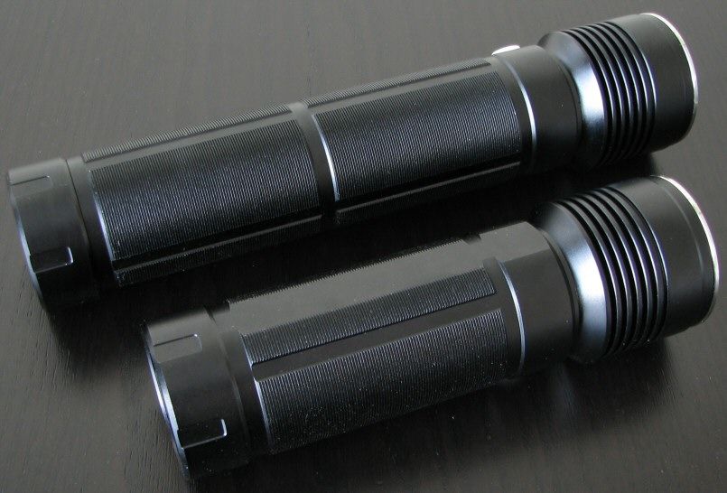

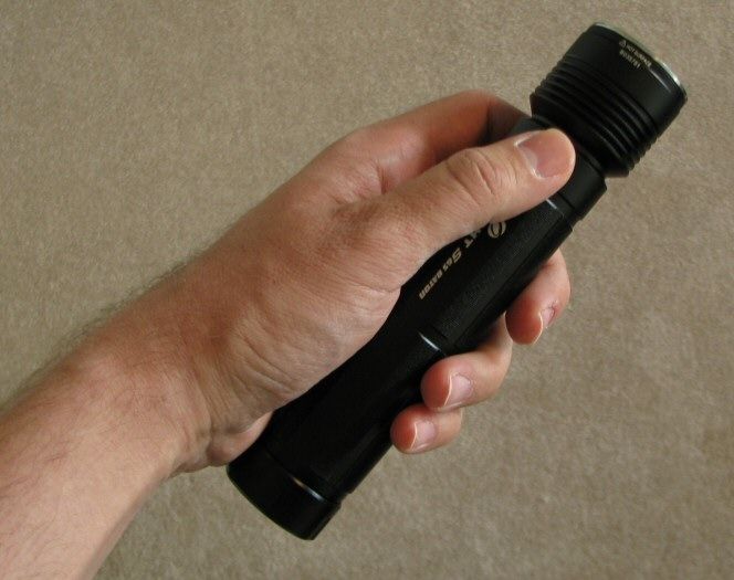

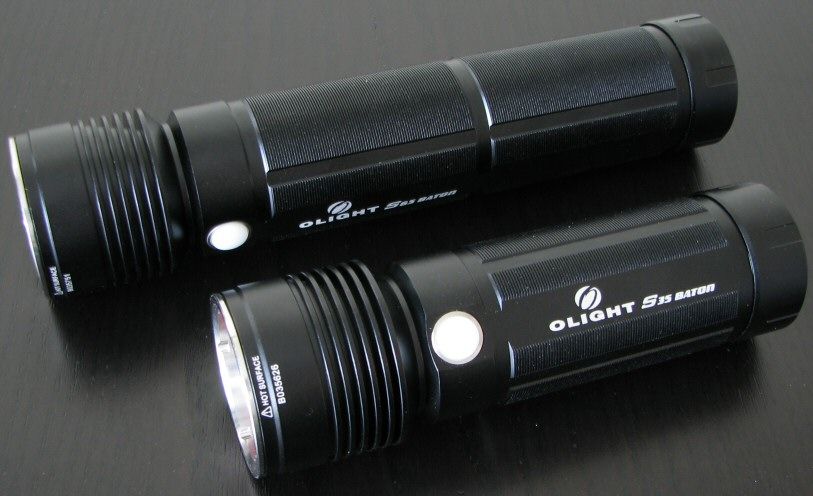

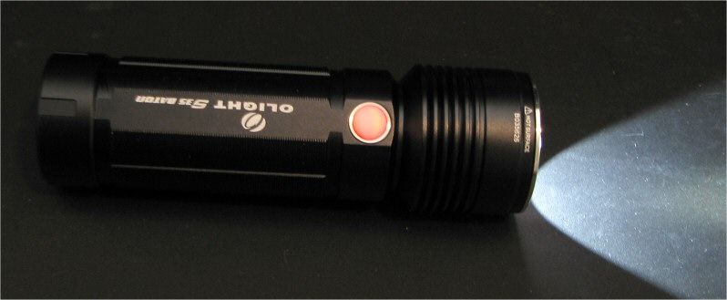

    As you can see, the Baton lights are quite petite for their battery configurations. They are smaller than I expected.
    Build is distinctive, with an overall cylindrical shape. Anodizing is glossy black, and there were a few chips on the screw threads on my samples (which are anodized for tail lock-out). Labels are bright white against the black background.
    There is no real knurling as such, but Olight uses a series of fine ridges along the bodies of both lights (similar to the Fenix TK45). Lights may be slippery when wet.
    Lights can tailstand, and there is a recessed lanyard attach hole on the tail. Lights have a flat stainless steel bezel ring
    Lights use an electronic switch, located near the head. The switch appears white, but actually has a red LED underneath that lights up as a low battery warning indicator.

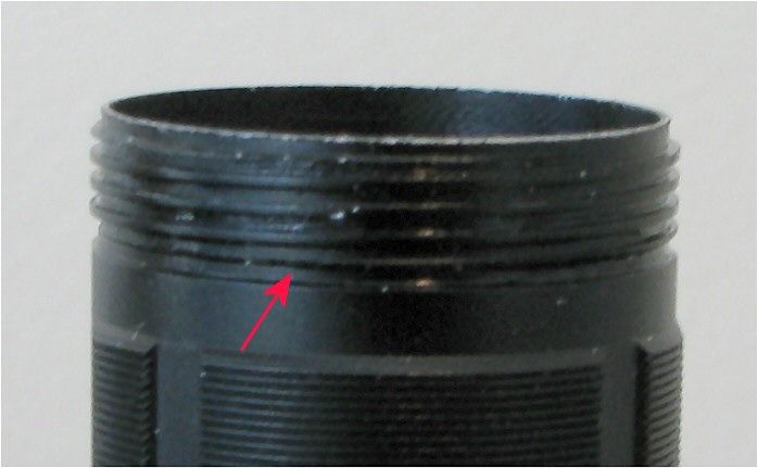

    Lights use square-cut screw threads, anodized for lock-out. Threads feel somewhat "gritty" on both models, and there are noticeable nicks in the anodizing on both lights. There was also a minor defect on my S65 - a narrowing of the distance between the last two threads - resulting in increased stiffness when screwing down the tailcap/battery carrier.
    You can see this in the photo above – to the right of the arrow, the thread distance is consistent. But to the left of the arrow, the bottom-most thread runs in closer to the one above it. With extra lube, I found this wasn't too much of a problem (but it was quite stiff upon arrival).
    Note also that I don't see o-rings anywhere on the body tube. I presume these are integrated into the tailcap/battery carrier.

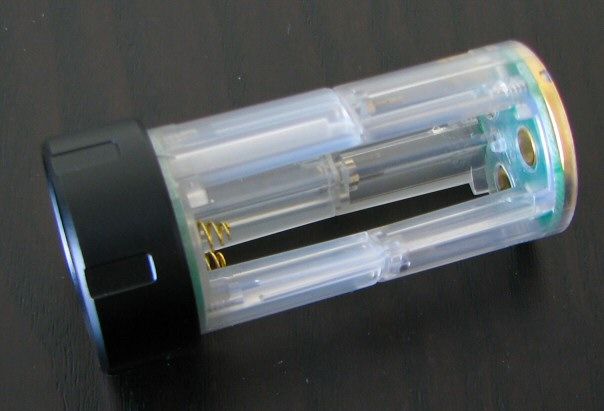

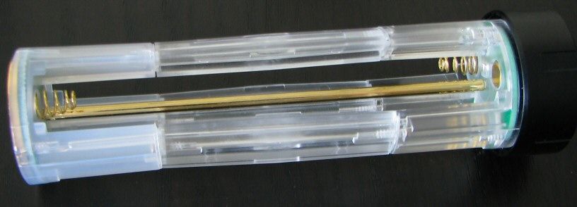

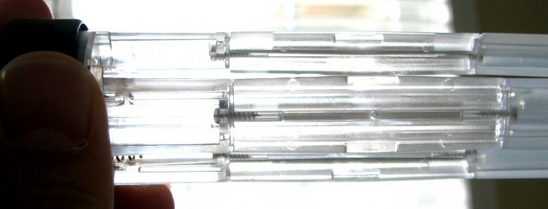

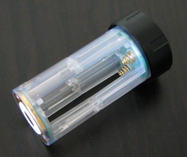

    The carriers are mainly plastic, composed of multiple segments screwed together. I presume this design was to facilitate manufacture, as it allows similar parts to be manufactured for both carriers. However, it results in a less sturdy-looking 6xAA carrier (i.e. you can see above how the segments don't line up perfectly on my S65 sample). But it should hold together fine given the screws built-in to each seam.
    The lights use an electronic switch for on/off and mode control. Press and release for constant on.
    Mode switching is controlled by holding down the electronic switch. The lights will cycle between Lo – Med - Hi, in repeating sequence. Simply release the switch to select your desired mode. The light has mode memory – if you turn it off/on, the lights return to your previous level.
    There is a "hidden" strobe mode, accessed by double-clicking the switch when on. Double-click again to return to constant on.
    Lights use the typical Olight "soft lock-out" - if you hold the switch down from On, after three cycles of output modes, the light turns itself off. It can not be turned back on until you rapidly press the switch three times. This is a soft lock to prevent accidental activation. However, I always recommend you store lights fully locked out at the tailcap when not in use (see Standy current below).

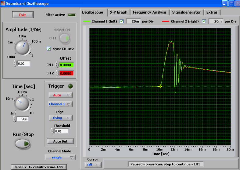

    PWM/Strobe
    There is no sign of PWM that I can see, at any output level. Either they are using a frequency that is too high for me to detect, or the light is actually current-controlled as claimed.
    Strobe was measured at 9.7 hz on both the S35 and S65. As revealed by the oscilloscope traces, the strobe pattern shows a rapid oscillation at the beginning of the On signal, shown in more detail below.

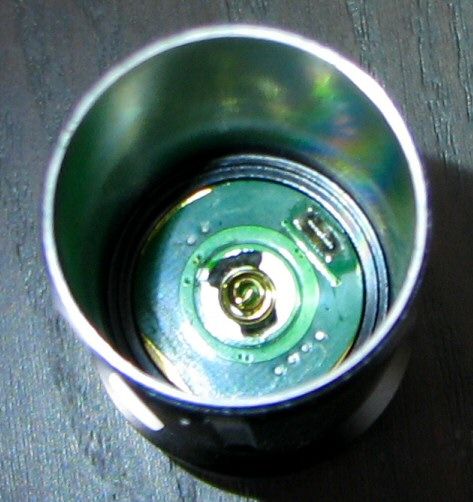

    Standby drain
    Since the switch is an electronic switch, there needs to be a standby current when the battery carrier is fully connected. Measuring this current is not simple, however, given the negative contact point is buried deep in the tailcap below the carrier. When connecting all contact points as best I am able, my DMM gives me an initial current draw in the high tens of uA (i.e. <100 uA), that quickly drops down over a few seconds and settles at 6.3uA on the S35 and 5.8uA on the S65. Since both lights appear to place the cells in series, that would translate into 36 and 39 years respectively, on a 2000mAh NiMH cell.
    Note I don't have my usual degree of confidence in those numbers, given the the more complicated wiring setup needed. Also, I'm not sure what the outside metal ring on the top of the carrier is doing, if anything. There is a plastic ring in the head of the light that blocks access of this metal ring to anything that I can see (although it is possible that contact might still occur with a protruding solder point on the contact plate in the head). I have tried to connect the outside carrier ring to that solder point with no apparent effect - you need to establish negative contact between the terminal at the base of the tailcap and the body of the light for a current to flow.
    Although most Olight models (including these lights) come with a "soft lock-out" of the switch (to prevent accidental actiation), you need to lock out the light at the tailcap to actually break the current.

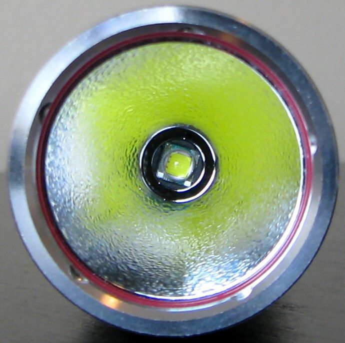

    The S35 and S65 seem to use an identical head. Below the stainless steel bezel ring is a red o-ring, holding the lens in place. The reflectors have a medium orange peel (textured) finish. Both lights use a Cool White XM-L emitter, well centered on my samples. I would expect a fairly smooth, well-balanced beam.

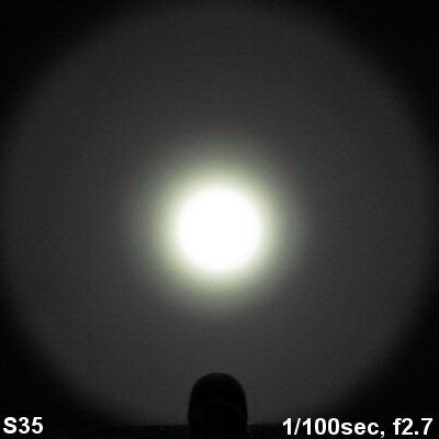

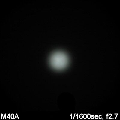

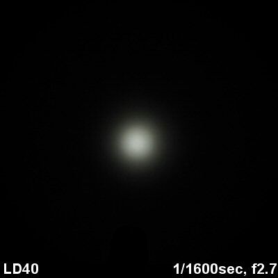

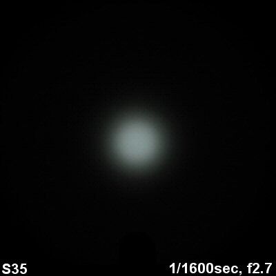

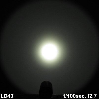

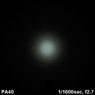

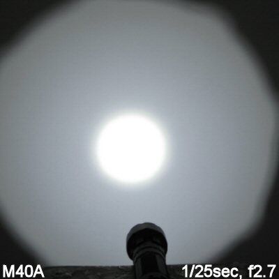

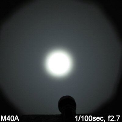

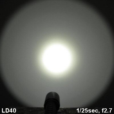

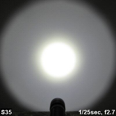

    And now, what you have all been waiting for. I have only done the S35 beamshots below, since the patterns are comparable – only overall output changes.
    All lights are on Sanyo Eneloop NiMH, at the maximum supported number for the given models (3x or 4x). Lights are about ~0.75 meter from a white wall (with the camera ~1.25 meters back from the wall). Automatic white balance on the camera, to minimize tint differences.

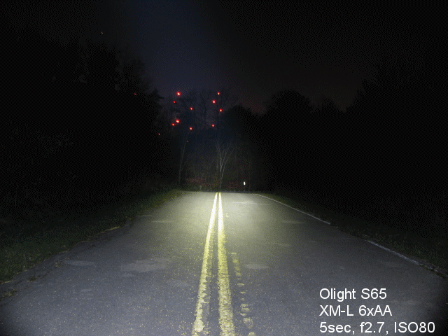

    And now for the outdoor shots. In this case, I have used the S65, since greater output is needed at a distance.
    (sorry, the PA40 above should say 4xAA, not 8xAA). These beamshots were done in the style of my earlier 100-yard round-up review. Please see that thread for a discussion of the topography (i.e. the road dips in the distance, to better show you the corona in the mid-ground).
    As you can see, the S65 is significantly brighter than the MC-E-based ITP A6 or the JetBeam PA40. Scroll down to my Summary table for some comparison output and throw numbers for all the lights.
    EDIT: if you are curious about those red lights in the background, see my post #6 below

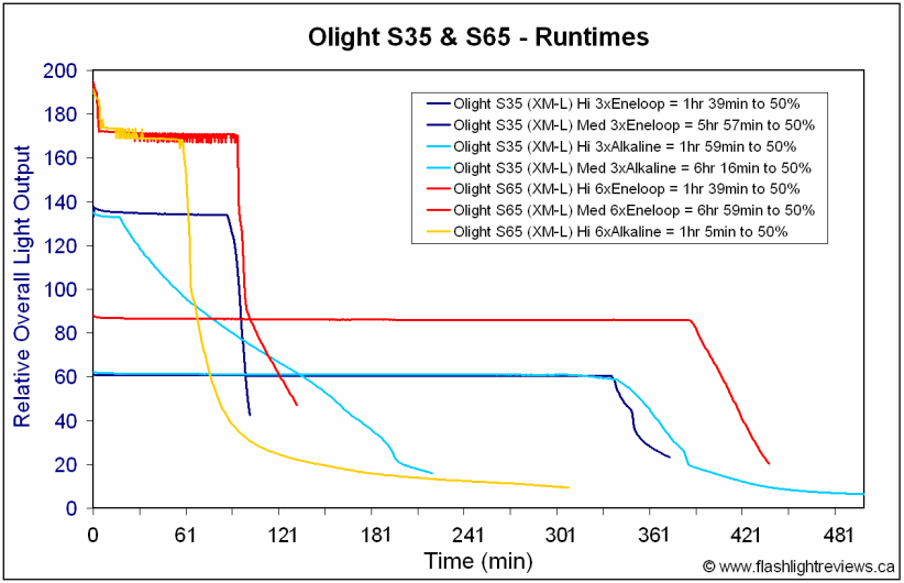

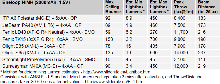

    My summary tables are reported in a manner consistent with the ANSI FL-1 standard for flashlight testing. Please see http://www.sliderule.ca/FL1.htm for a description of the terms used in these tables.
    The 3xAA S35 is close in output to the XM-L-based 4xAA lights, and the 6xAA S65 is similar in output to the 3xXP-G-based Fenix TK45 (8xAA). The older ITP A6 (MC-E, 6xAA) is closer in max output to the 4xAA lights.
    Throw is relatively good for the Baton lights, in keeping with their relative size and XM-L emitter.

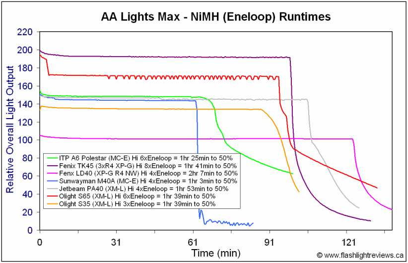

    Output/Runtime Comparison:
    The S65 is well suited for either NiMH or Alkalines, at all levels. I was impressed to see the regulation pattern be maintained for so long on Hi on 6x alkaline. Note that there is an intial drop-off in max output over the first few minutes, followed by a long regulated period.
    The S35 is able to maintain regulation a lot long on Hi on NiMH compared to alkaline. But overall performance is still reasonable. At Med output levels, you can see NiMH and alkaline typically perform similarly on the S35.
    I am happy to report that manufacturer ANSI FL-1 lumen estimates seem quite accurate for both lights. Reported runtimes are actually quite conservative – especially on Med mode, where I got much longer runtime than the specs show.
    Baton-series runtimes are definitely very good for their respective battery and emitter classes. The 3xAA S35 typically performs as well as many 4xAA lights.
    Overall build of the lights is fairly smooth, and grip is relatively low. Lights also roll easily.
    I have no idea of final packaging, but I doubt a clip would be included (no obvious attachment point).
    Lights use a plastic battery carrier, integrated into the tailcap. Design seems flexible enough, but long-term stability is unknown.
    Lights use an electronic switch, and therefore require a stand-by current when fully connected. Current seems low enough to not be a concern (i.e. apparently several decades before the cells would be drained), but I generally recommend you store the light locked-out when not in use.
    There were inconsistencies in thread distance on my S65 sample, leading to increased resistance. Threads felt "gritty" on both samples, with obvious nicks in the anodizing.
    It is nice to see the expansion of the multiple-AA-class of high output lights – a frequently under-served flashlight constituency.
    3xAA and 6xAA are unusual battery multiples, but the performance here suggests you get a lot of bang-for-your-buck on the Olight Baton models. Runtimes handily exceeded manufacturer's specs on both lights, with accurate lumen estimates.
    Spacing of output modes is good, with three standard output levels and a "hidden" strobe mode. Given the excellent output/runtime efficiency, Olight is clearly using a good-quality constant-current circuit. Regulation is impressive on all battery sources and levels, even on alkalines.
    Build design is distinctive – I don't think I've ever seen such consistently cylindrical bodies (i.e., the Batons are well named ). Despite the name, I wouldn't suggest using these as personal defense weapons - they are much smaller than I expected, and relatively thin-walled. Personally, I would have preferred a few more grip elements, as they are somewhat minimalist in external styling. But I am glad to see tailstanding has been maintained, with a lanyard attachment point.
    The location of the control switch near the head will be good for traditional consumers (i.e. standard under-hand grip). The low battery indicator built into the switch is a clever idea, although I typically found it activated fairly late in the lifespan of the cells (i.e. output had already dropped out of regulation). Still, I'm always glad to see warning indicators included as secondary features (i.e. much better than flashing in the main beam).
    Despite some thread issues on my samples, the overall builds seem ok – certainly a step up from the earlier ITP A6. However, the lights do use plastic battery carriers, and the bodies feel a lot less substantial than the typical Olight higher-end lines (e.g. M-series lights).
    That said, performance, beam profile and user interface are all well-designed and well-executed. I could see these lights being popular with traditional consumers (i.e. non-flashaholics, who use only standard alkaline cells ).

    Thanks Selfbuilt, great review as always. I was really wanting one of the S65's but purchased a Neutral PA40 while wating for reviews. I think I made the right choice but the side switch would be nice.
    I have been wanting to ask, What are the red lights or reflections in the tree in the beam shot photos?

    Thanks for excellent reveiw. Selfbuilt!
    What whiteoakjoe ask about seems like trimmings on a Christmas tree to me.

    Quote Originally Posted by whiteoakjoe View Post
    Yes, I get a lot questions about those (some find them to look "spooky" - more Halloween-ish. ).
    They are actually red aerial warning lights mounted on a series of non-directional radio beacons in the distance. NDBs are used as markers for aviation or marine nagivation (I believe the former in this case, as the Coast Guard runs a series of NDBs a few kms east of this location). In this case, there are seven towers located about 650m away in a clearing.
    As you can tell by the images in the wiki link above, these types of simple beacon towers are typically too thin to see with the naked eye at those distance during the day. Here is my control shot taken in July, when I was scouting the location, where there is no sign of them:
    The problem is at night - the top-most red warning lights of the nearest towers extend just over the top of the trees, and so always show up in the photos. But the problem gets a LOT worse at this time of year, when most of the leaves have fallen. Now, almost all of the warning lights along the length of towers shine through.
    Incidentally, you might have noticed another artifact in these pictures. These three shots were actually taken in sequence, about 1 min apart (in order: S65, A6, PA40). Notice that small white dot in the upper left-hand corner, that seems to be slowly moving down and to the right?
    According to the Google SkyMap app on my Android phone, that's the star Arcturus - the fourth brightest star in the night sky, and brightest star in the northern hemisphere. Good thing I took these photos in the right sequence, or the star would have been zig-zaging the night sky. FYI, these shots were taken pointed almost due North.
    The joys of nighttime photography!

    What would the S65 high output run look like, on alkalines, if you test at 0-5 Celsius versus room temperature 20-25C
    The S35 on high, on alkalines, looks disappointing, only 20 minutes before it drops out of regulation (again at room temperature, right?)

    Quote Originally Posted by MichaelW View Post
    I was going to ask if you run the crAA 14505, does that turn the S35 into a S65? or does it let the magic smoke out
    I imagine it would damage/destroy the circuit, since it was likely never intended to take 3x 3.0V cells. However, it's possible the S65 and S35 use the same circuit, so it could turn the S35 into S65-like outputs, if supported. Hard to know - but I don't intend to take the risk without clarification from the manufacturer.
    What would the S65 high output run look like, on alkalines, if you test at 0-5 Celsius versus room temperature 20-25C The S35 on high, on alkalines, looks disappointing, only 20 minutes before it drops out of regulation (again at room temperature, right?)
    I don't imagine it would make much of a difference on the S65 (may be worse, as alkalines don't function well at low temperatures). The effect you are seeing above for the S35 is unlikely to be temp-related - rather, the chemistry of alkalines doesn't allow for sustained runtime at high drain levels. The S35 on max is just too much of a load for 3 cells - personally, I'm surprised it last the 20 mins regulated.
    Regarding the 'identical-ness' of the heads, did you see if the S65 will work with half the number of cells, via substitution of spacer AA [null cell] where a normal cell goes?
    It may work, if indeed the heads are the same. (would need 3 null spacers, one for each channel pair). However, I don't have 3 null AA spacers to test.

    Then you need a contribution for your null-battery fund
    Well maybe 2x 14500 + a null cell for a 'guilt free' pocket rocket S35

    Any idea why you got almost 6 hours on medium when all the published specs indicate 3.5 hours?
    S35 Specs:
    • Output (Lumens): Lo: 20, Med: 120, Hi: 380
    • Run Time (Hours): Lo: 240, Med: 3.5, Hi: 1.5, Strobe: 3

    6,936
    Default Re: Olight Baton S35 & S65 (XM-L, 3xAA and 6xAA) Review: RUNTIMES, VIDEOS, BEAMSHOTS
    Quote Originally Posted by edpmis02 View Post
    S35 Specs:
    Don't know why their runtimes specs are so low, but the 120 lumen spec seems bang on for my sample.
    Note also that ANSI FL-1 uses a more generous (to the manufacturer) standard of time to 10%. On alkalines, I would estimate you get would something more like 7 hours to 10% (although I didn't run it that long).

    I have been doing a simple runtime test on the S35 on the lowest mode.
    The runtime was between 50 and 59 hours (it went out over night unfortunately )
    After around 1,5 days the light was only putting out ~ 50%
    I was using (dont laugh ) Ikea's 2000 mAh rechargeable batteries called "Ladda" (swedish for rechargeable I think).
    (Ikea batteries was among the best in a danish independent scientifical test of 28 batteries. There were as good as sanyo eneloops... but thats another story)

    Quote Originally Posted by amokkos View Post
    Thanks for the numbers, and
    For those wondering, runtime would presumably have been longer on alkalines (i.e. they do better than NiMH at low discharge rates). Also, ANSI FL-1 standards are to 10% original output, further benefiting alkalines (with their slow discharge curves).

    your are right about the alkalines longer runtime to 10% but alkalines suck in almost any other parameter except for selfdischarge.
    Im doing a rough runtime test right now on max (to compare with your meassurement) just to make sure that its not the batteries or my S35 thats malfunctioning.
