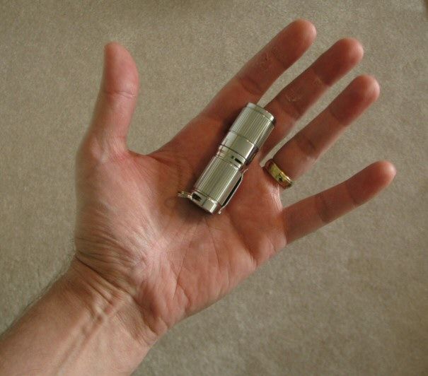

    Olight i3: Weight 13.2g, Length: 71.9mm, Width (bezel): 14.0mm
    ITP EOS A3: Weight: 11.6g, Length: 69.7, Width 14.1mm (bezel)
    Illuminati Aluminum: Weight 13.9g (with keychain clip), Length 68.8mm, Width 14.0mm (bezel)
    Klarus Mi X6: Weight 16.2g, Length 72.9mm (battery installed), Width 12.8mm
    4Sevens Preon 1: Weight 15.3g (with keychain clip), Length 75.6mm, Width 14.0mm (bezel)

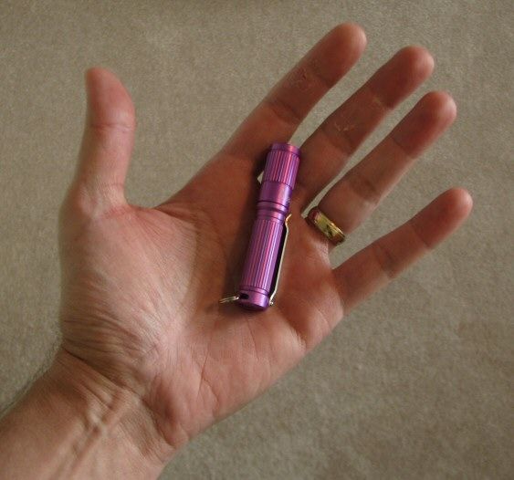

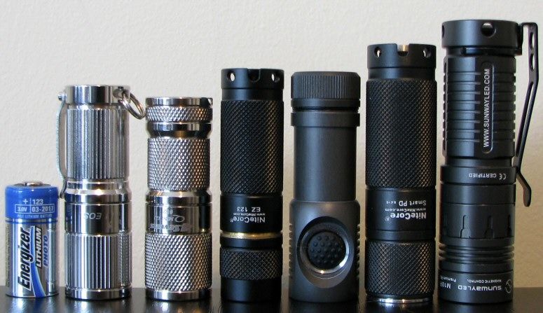

    From left to right: Energizer CR123A,Olight i1, 4Sevens Q Mini 123 Titanium, Nitecore EZ123, Zebralight SC30, Nitecore EX1, Sunwayman M10R
    Olight i1: Weight 48.1g, Length: 63.9mm, Width (bezel): 20.4mm
    Jetbeam BC10: Weight: 46.6g, Length: 90.3mm, Width (bezel): 23.2mm
    Thrunite 1C: Weight: 45.2g, Length: 91.5mm, Width (bezel) 22.0mm
    The stainless steel adds extra weight – I would expect the aluminum version to be in the range of other lights this size.

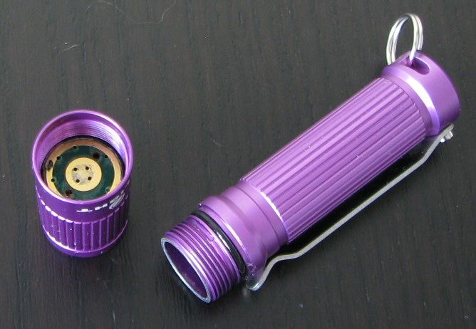

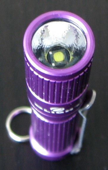

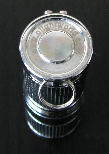

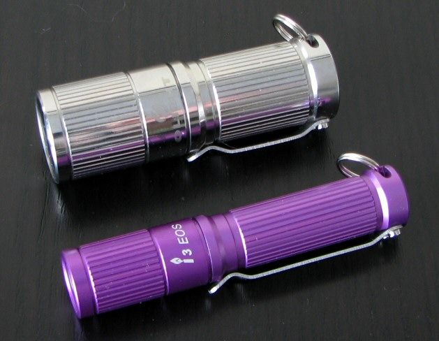

    Build is very similar to the earlier ITP A1 and A3, reviewed previously.
    The ITP lights had a built-in split-ring attachment point on the tail of the light, which prevented tailstanding. The new attachment point causes a split-ring to stick out from the side. While this now allows tailstanding, it prevents the lights from hanging freely. It also makes the lights slightly taller.
    The other major change is the addition of a sturdy clip, firmly attached by screws. This is a definite improvement over the earlier models.
    Otherwise, little has changed in external styling or choice of materials/anodizing colors. Like the earlier ITP lights, there is no knurling to speak of – the newer Olight i-series lights have the same length-wise ridge detail. Grip is ok, but not as "grippy" as actual knurling. I found the stainless steel i1 difficult to twist one-handed. Finish was good on both my samples – no chips or blemishes.

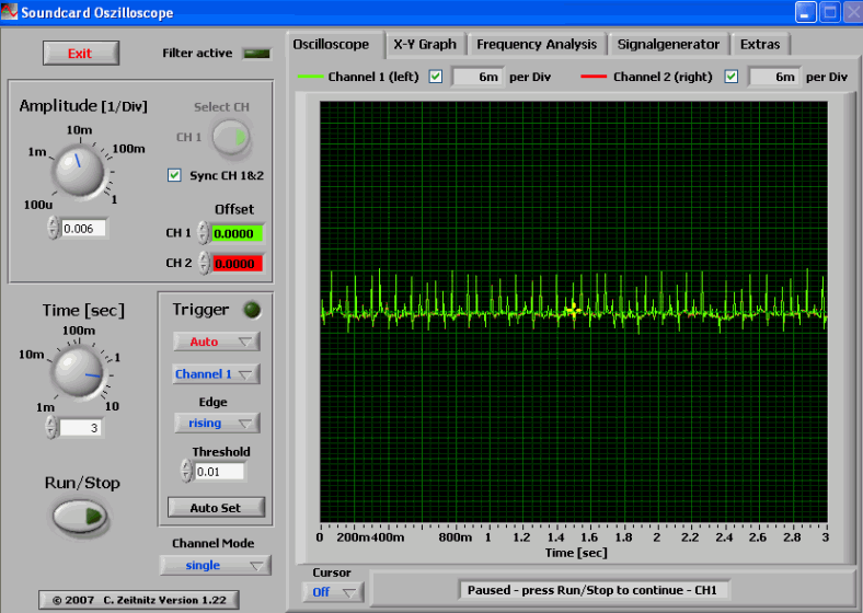

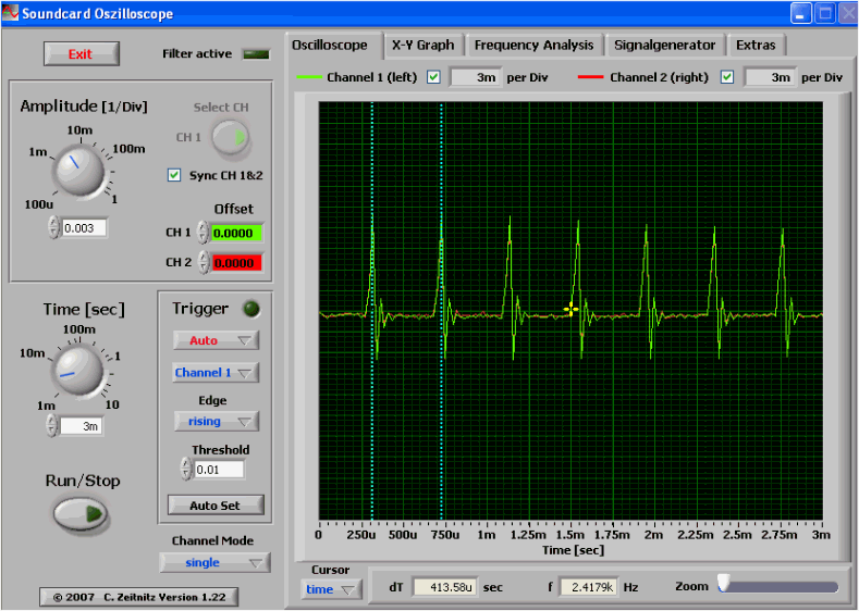

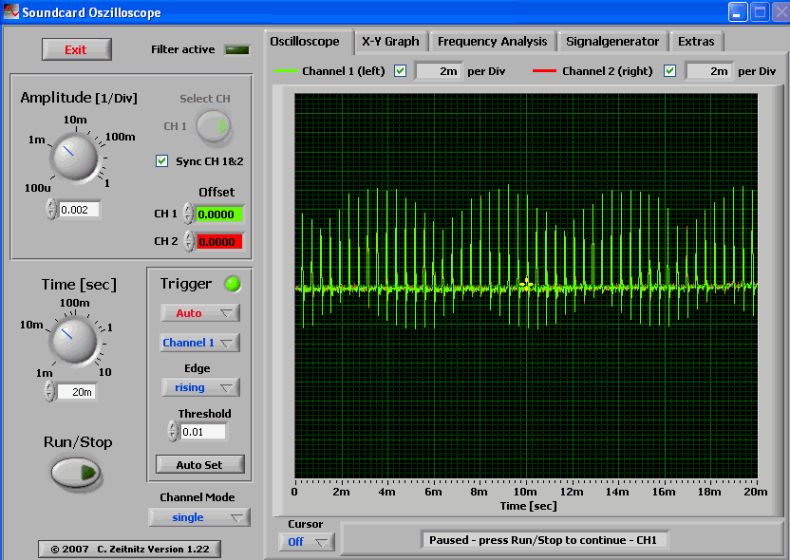

    PWM/Strobe
    The new i-series lights maintain the same high-frequency PWM on Lo/Med as the later generations of the ITP A-series lights (i.e. about 2.4 kHz). This is not visually detectable – the lights are flicker free in practice.
    I detected some high frequency noise on my i1 sample on Lo/Med, separate from the reoccurring PWM signal. But again, this was not visually detectable.
    There is no strobe mode on either light.

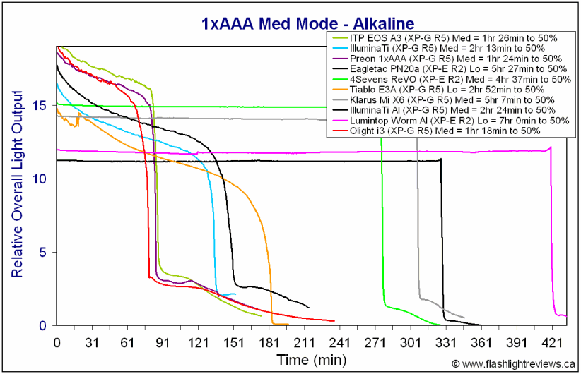

    Olight i3
    All lights are on Sanyo Eneloop 1xAAA NiMH, about ~0.75 meter from a white wall (with the camera ~1.25 meters back from the wall). Automatic white balance on the camera, to minimize tint differences.

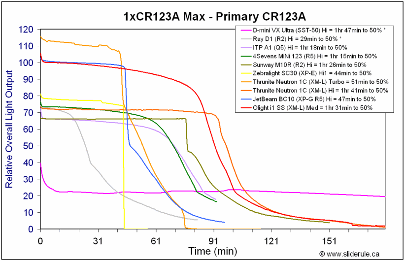

    All lights are on AW protected RCR, about ~0.75 meter from a white wall (with the camera ~1.25 meters back from the wall). Automatic white balance on the camera, to minimize tint differences.
    My summary tables are reported in a manner consistent with the ANSI FL-1 standard for flashlight testing. Please see http://www.sliderule.ca/FL1.htm for a description of the terms used in these tables.
    Olight i3
    Olight i1

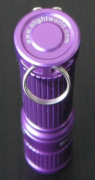

    Overall external build of the lights remains fairly smooth. Although the fluted ridges lengthwise along the lights help with grip, they are not as grippy as actual knurling. I found the stainless steel i1 very hard to use single-handed.
    Keychain split-ring attachment point prevents the lights from hanging straight down. However, the lights can now tailstand.
    1x3.7V Li-ion sources are not recommended on Hi in either light, due to the excessive drive levels and heat produced. There is particularly a concern for 10440.

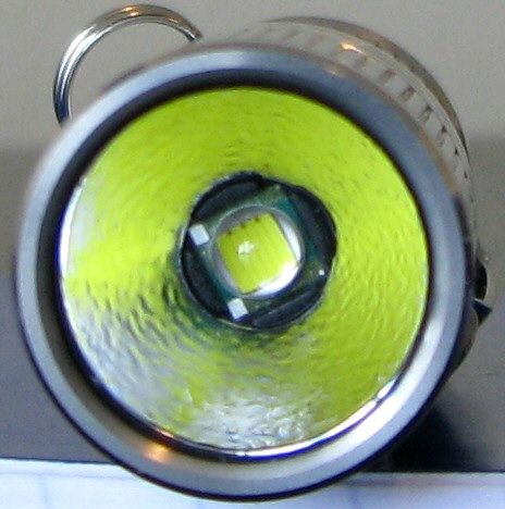

    Circuit/emitter-wise, not much has changed – although the i1 now comes with a XM-L emitter. Performance was very similar to my XM-L-equipped Thrunite Neutron 1C on 1xRCR, but my i1 was a definite stand-out over-achiever on 1xCR123A.
    On my i3, Hi output seemed a little lower than my earlier ITP A3 sample - but still in the range of other lights with comparable circuits and XP-G R5 emitters (e.g. Illuminati). Performance on Med-mode was unchanged from the earlier version of this light.

    from what i can see, the i3 performs worst of all (even worse than the A3). in comparison, the worm and 4Sevens have the best graphs.
    I wouldn't make too much of that - it could just be an issue with this i3 sample. I would expect performance to be generally unchanged from the later-model versions of the A3.

    I've used my Olight i1 as EDC now for 6 months.
    When people say don't use Hi mode for more than a few minutes, it's kind of a moot point.
    When you put a freshly charged 4.2v AW RCR123, it will get very warm (not hot), but if you hold the light in your hand, it dissipates the heat quite well.
    After that RCR123 has seen 5 minutes of use, turn it on Hi later or the next day, it does not get very warm, because the RCR123 is no longer 4.2v.
    Observe the sharp decline of the curve after 5 minutes of use of a freshly charged 4.2v RCR123.
    I've had similar results with AW IMR 16340s.
