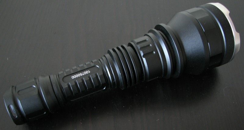

    Original 1st gen sample:
    Revised 2nd gen sample:
    The original sample came wrapped in bubble-wrap with no packaging. The revised sample came is traditional cardboard box, with cut-out cardboard packing inserts. As before, I received the light (with extender tube), a reasonable quality wrist lanyard, single-stage tailcap, and a new engineering sample of the multi-mode tailcap.
    I do not know what the final packaging will be like, but I understand from Niwalker that the shipping lights will only include the single-stage "tactical" tailcap. You will be able to purchase a multi-level "general" tailcap, pressure switch, the diffuser as optional accessories.

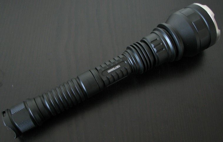

    All dimensions are given with no batteries installed (standard tactical tailcap for NWK750 samples):
    Niwalker NWK750: Weight: 392.3g, Length: 264mm, Width (bezel): 59.0mm
    Niwalker NWK750-II: Weight: 396.8g, Length: 264mm, Width (bezel): 59.0mm
    Sunwayman T40CS: Weight: 296.7g, Length 227, Width (bezel): 63.5mm
    JetBeam BC40: Weight: 226.3g, Length: 224mm, Width (bezel): 48.5mm
    Thrunite Catapult V3: Weight: 434.8g, Length: 254mm, Width (bezel) 58.0mm, Width (tailcap) 35.1mm.

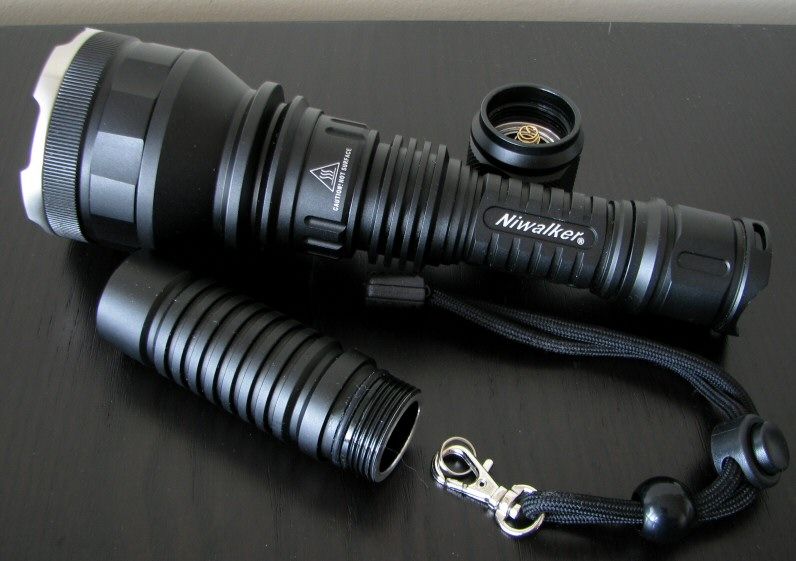

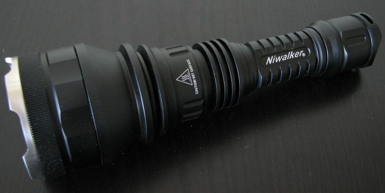

    The 2nd generation NWK750 is not appreciably different in its overall size or styling – it remains definitely "beefy", reminiscent of the Thrunite Catapult and the older Tiablo ACE-G/A10-G lights. As before, wthe extra length of the NWK750 seems to be due in part to the deeper than typical reflector.

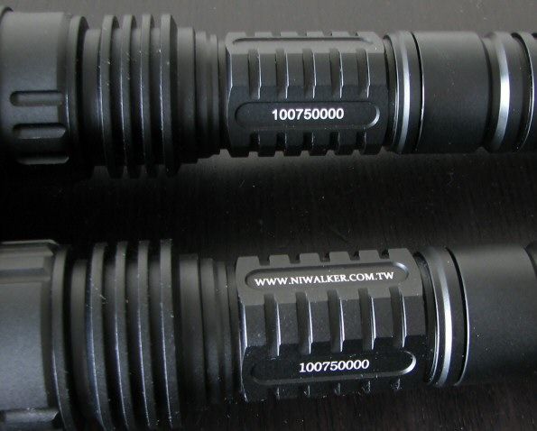

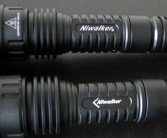

    The only external features that have changed are some of the labels, as shown below (1st gen on the top, 2nd gen on the bottom):
    The 2nd generation sample has a revised styling for the Niwalker name and logo, and a link to their website on the body (previously on the tailcap). They also seem to have removed the hot surface caution warning.

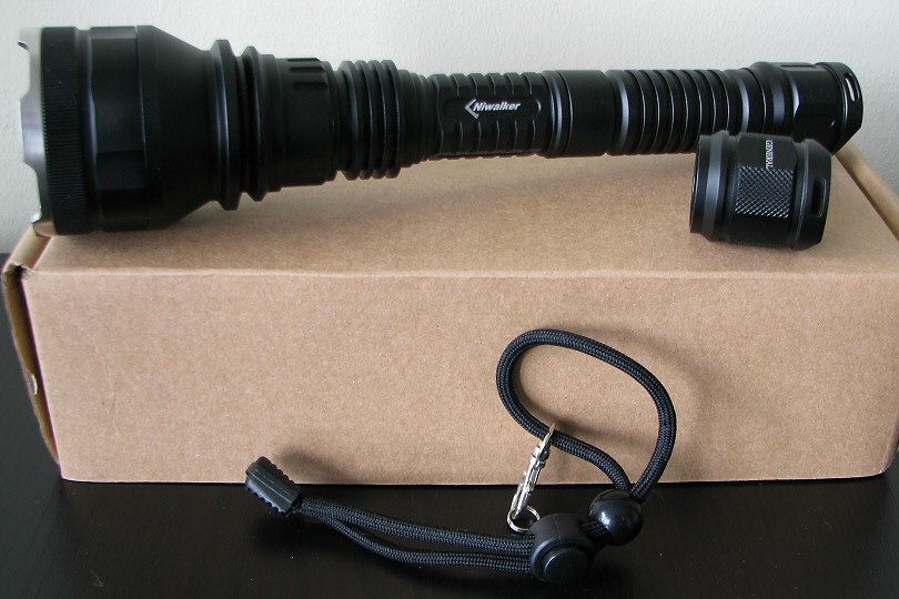

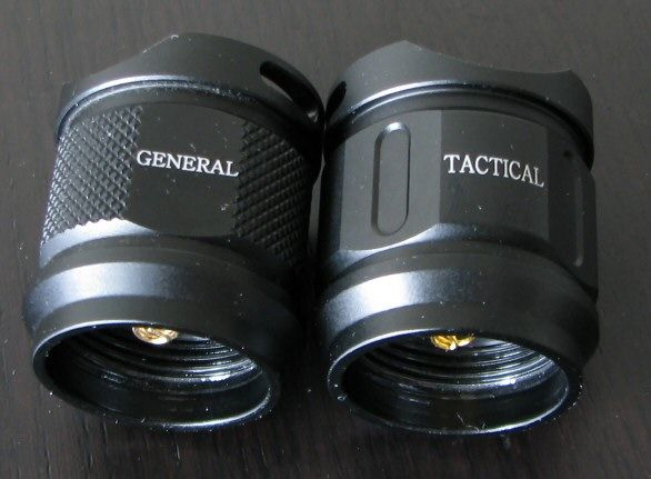

    One other change is on the tailcap – the two tailcap samples they sent me on the 2nd generation sample had "tactical" (single-stage forward clicky) and "general" (multi-mode reverse clicky):
    Otherwise, build remains very solid as before (sorry for the dusty shots above). While the NWK750 is not quite as thick-walled as the Catapult, this is definitely one of the most solid lights I've seen.
    Anodizing remains a matt black finish, with no nicks or scratches on either of my samples. There is no real anodizing to speak of on the body, although there are a series of concentric ridges to help with grip. While grip is certainly reasonable, I would prefer actual knurling. The "general" multi-mode tailcap has some knurling on it.
    There is a clip/lanyard attachment point on both tailcaps. Light can tailstand, and my 2nd generation sample is no longer wobbly as the first was (but of course, that may vary). Screw threads are anodized for tailcap lockout. Although the threads are standard triangular cut, they seem fairly thick and of good quality.

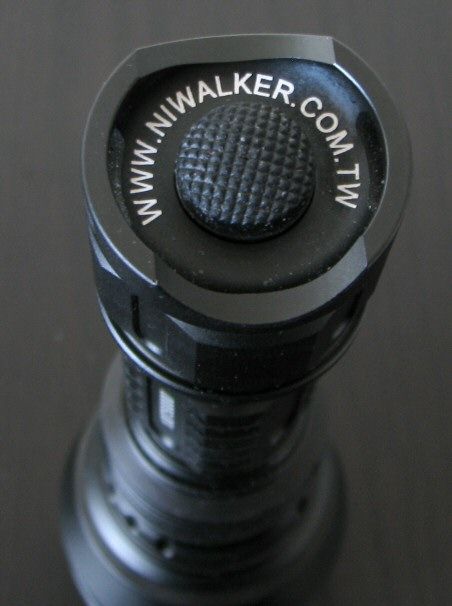

    Standard tailcap remains a single-stage forward clicky switch. An engineering sample of the multi-mode tailcap was included, but it is still a three-mode reverse clicky. They plan to offer a revised multi-mode interface, with the choice of two sets of output modes (see below for a description). I understand an optional continuously-variable tailcap is also in the works, but have no further details.
    The standard switch is simplicity itself – it is a forward tailcap clicky, so press for momentary on, click and release for locked on.
    The engineering sample multi-mode tailcaps they sent me for evaluation used a reverse clicky, and cycled between Hi > Lo > Strobe > Off, in repeating sequence. On my samples, you have to wait ~4 secs before turning the light Off, or it will instead advance to the next mode (this is too long, IMO). There is no memory mode, the light always comes back on at Hi (I would prefer a memory mode).
    The design of the multi-mode tailcap is still in development. Niwalker informs me that the final version will likely have two sets of modes. They plan to set one mode as Low (5%) – Med (30%) – High (100%), and the other mode as Low – Med – High – SOS - Strobe. This multi-mode switch will have mode set memory, and you will be able to switch between the mode sets by pressing and holding the switch for two seconds.
    Niwalker has explicitly asked for feedback on this proposed multi-mode switch design, so please speak up!
    For a more detailed examination of the build and user interface of the two switches, please see my video overview:

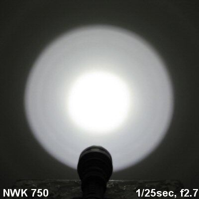

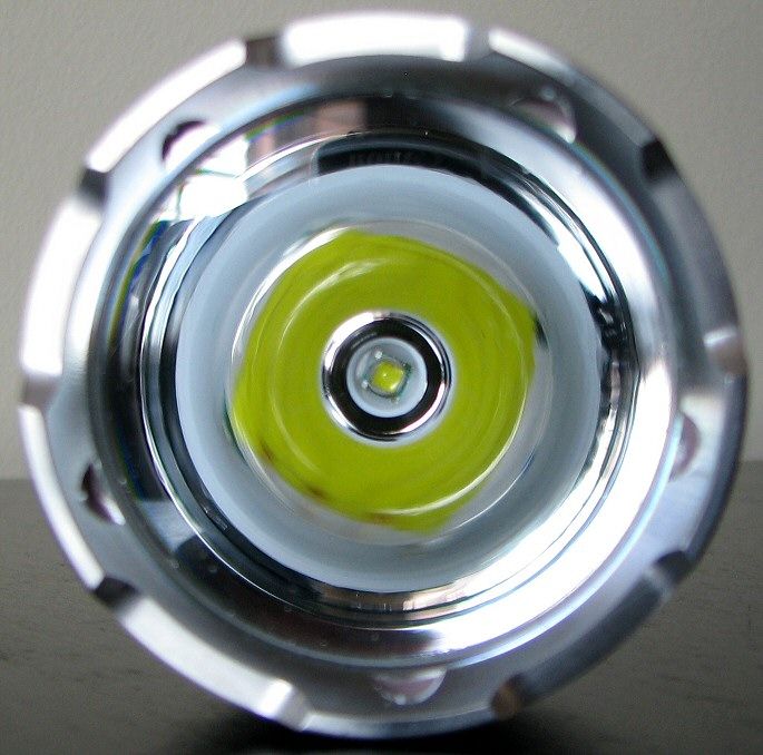

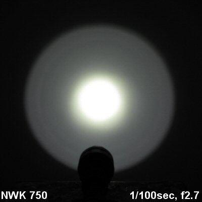

    The NWK750 uses a Cool White XM-L emitter, well centered on my samples (with a white centering disc around it). Reflector is smooth finish and extremely deep – one of the deepest I've seen (likely accounting for the overall length of the NWK750). Throw is likely to be very good. My second generation sample doesn't look appreciably different from the first.
    And now, what you have all been waiting for. All lights are on 2xAW protected 18650, about ~0.75 meter from a white wall (with the camera ~1.25 meters back from the wall). Automatic white balance on the camera, to minimize tint differences.
    Note: The revised 2nd generation NWK750 is labeled as "NWK750-II" below, and the 1st generation sample is just "NWK750".

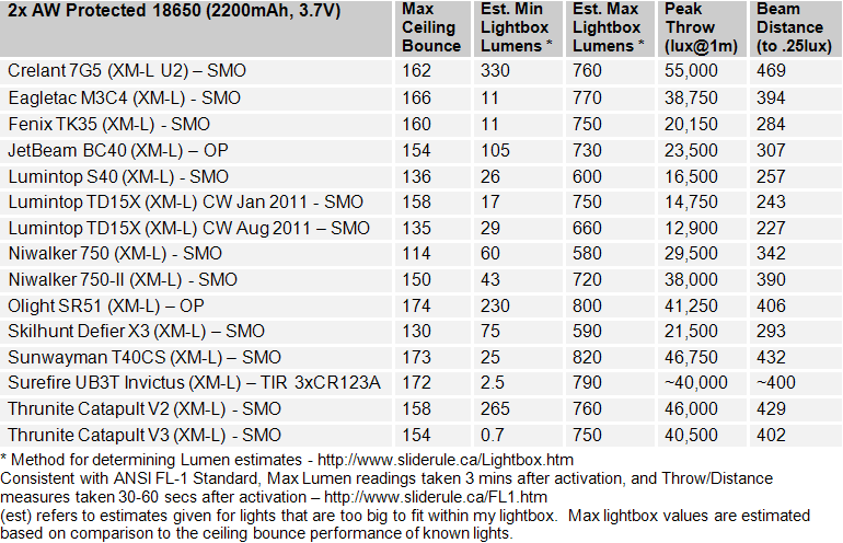

    The revised 2nd generation NWK750 seems to have a little more output, resulting in slightly greater throw.
    For outdoor beamshots, these were done in the style of my earlier 100-yard round-up review. Please see that thread for a discussion of the topography (i.e. the road dips in the distance, to better show you the corona in the mid-ground).
    To start, here was the original NWK750, compared to the Thrunite Catapult V3 and Sunwayman T40CS.
    The original NWK750 appeared to be slightly under-performing for the class. The revised NWK750 now performs as expected, and is very close to the Catapult V3:
    As before, spillbeam width is narrower than typical, due to the deeper than usual reflector.
    My summary tables are reported in a manner consistent with the ANSI FL-1 standard for flashlight testing. Please see http://www.sliderule.ca/FL1.htm for a description of the terms used in these tables.
    There you go – the revised NWK750 is now back up to what you would expect for overall output and throw. Very similar to the Thrunite Catapult V3.

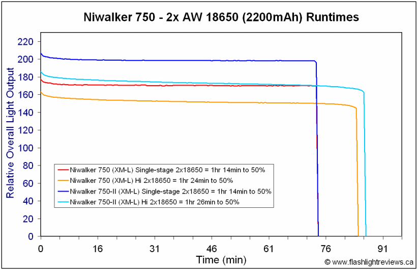

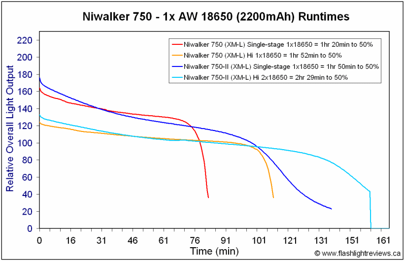

    Output/Runtime Comparison:
    Note: "Hi" on the NWK750 runtimes below refers to the Hi-mode of the multi-mode switch. The single-stage switch (which would give max output only) is labeled as such.

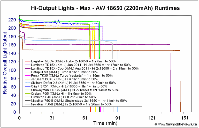

    Let's start with a comparison of the 2nd generation engineering sample to the first:
    Niwalker has clearly fixed the issue with the low output on the first sample – the revised 2nd generation sample now has higher output for the same runtime.
    On 1x18650 battery sources, output hasn't appreciably changed – but runtime has improved on the revised 2nd generation version.
    So how does this new sample stack up compared to other lights in this class?
    The NWK750 is now performing right where I would expect it to. On the single-stage tailcap, performance is remarkably similar to the Thrunite Catapult in output/runtime, as well as throw and beam pattern.

    Consistent with the output/runtime results, this new sample is driven to the same level as before. So whatever the original circuit issue was that was limiting performance, it has been fixed.
    And as you can see, the NWK750 is drawing approximately the same initial battery current as the Thrunite Catapult, JetBeam BC40, or Sunwayman T40CS – and as a result, has equivalent runtimes.

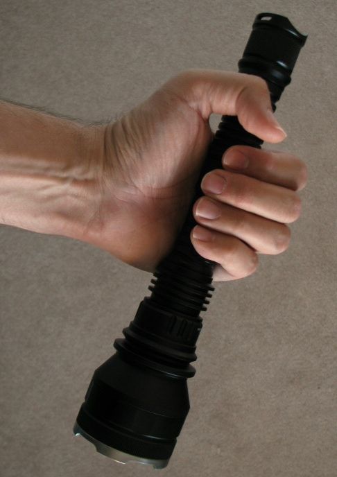

    Light rolls easily, as there are no indentations to serve as anti-roll stops.
    The light lacks knurling as such, although the various build elements do help with grip.

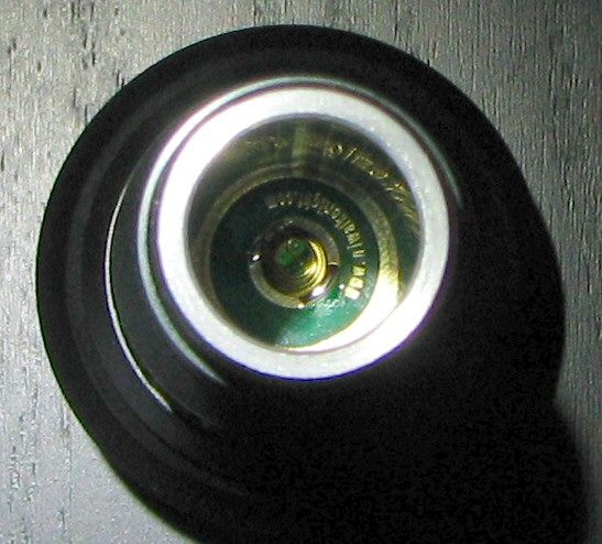

    The original first generation sample sent to me had a circuit issue limiting max output. This has been corrected on the second generation sample. Output, runtime and throw are now all comparable to the Thrunite Catapult V3 on Max.

    The only build features that have changed are with some of the labels, as shown below (1st gen on the top, 2nd gen on the bottom):
    As before, the engineering sample multi-mode tailcap they sent me used a reverse clicky, and cycled between Hi > Lo > Strobe > Off, in repeating sequence. But the design of the multi-mode tailcap remains in development, and they are still soliciting feedback from members here.
    For outdoor beamshots, the revised NWK750 now performs as expected, and is very close to the Catapult V3:
    The revised NWK750-II is now back up to what you would expect for overall output and throw. Very similar to the Thrunite Catapult V3.
    Tailcap current draws are unchanged on this 2nd generation sample (i.e., still 1.55A as before). This is comparable to other lights of this class. So whatever the original circuit issue was that was limiting performance, it has been fixed.
    I am glad to see they have resolved the earlier problem with the circuit. Output, runtime and throw are now all comparable to the Thrunite Catapult V3 on Max.
